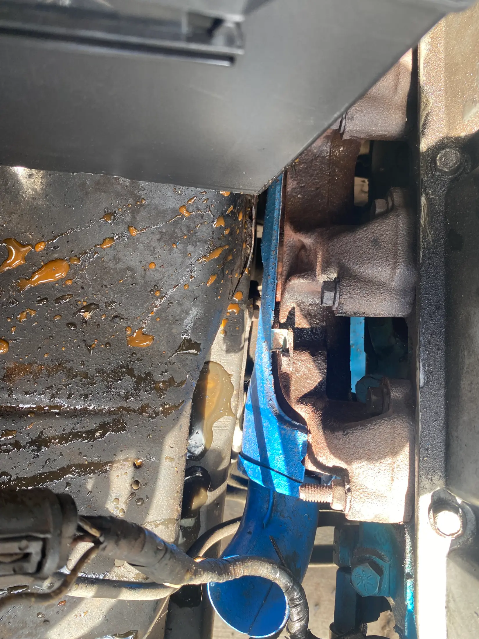

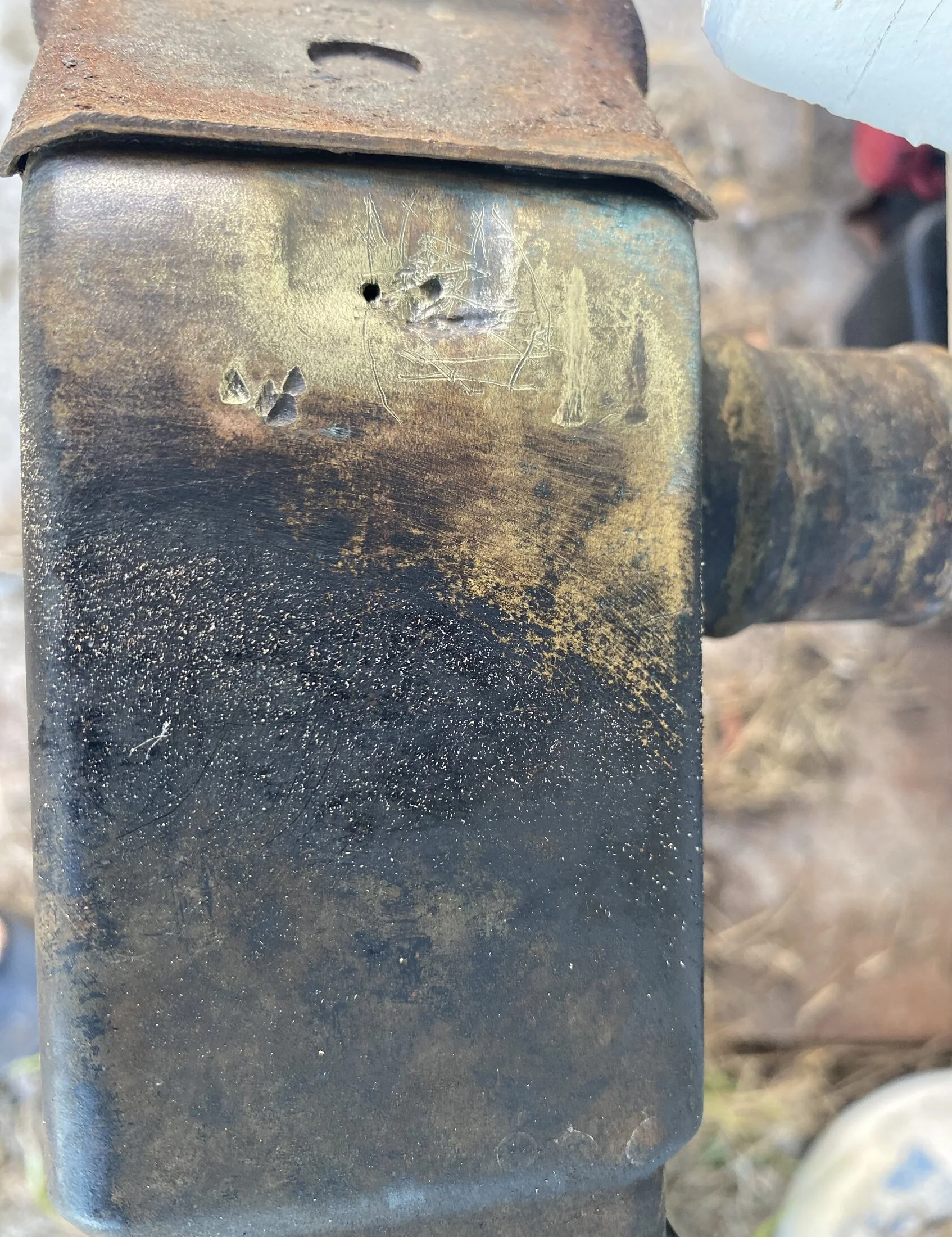

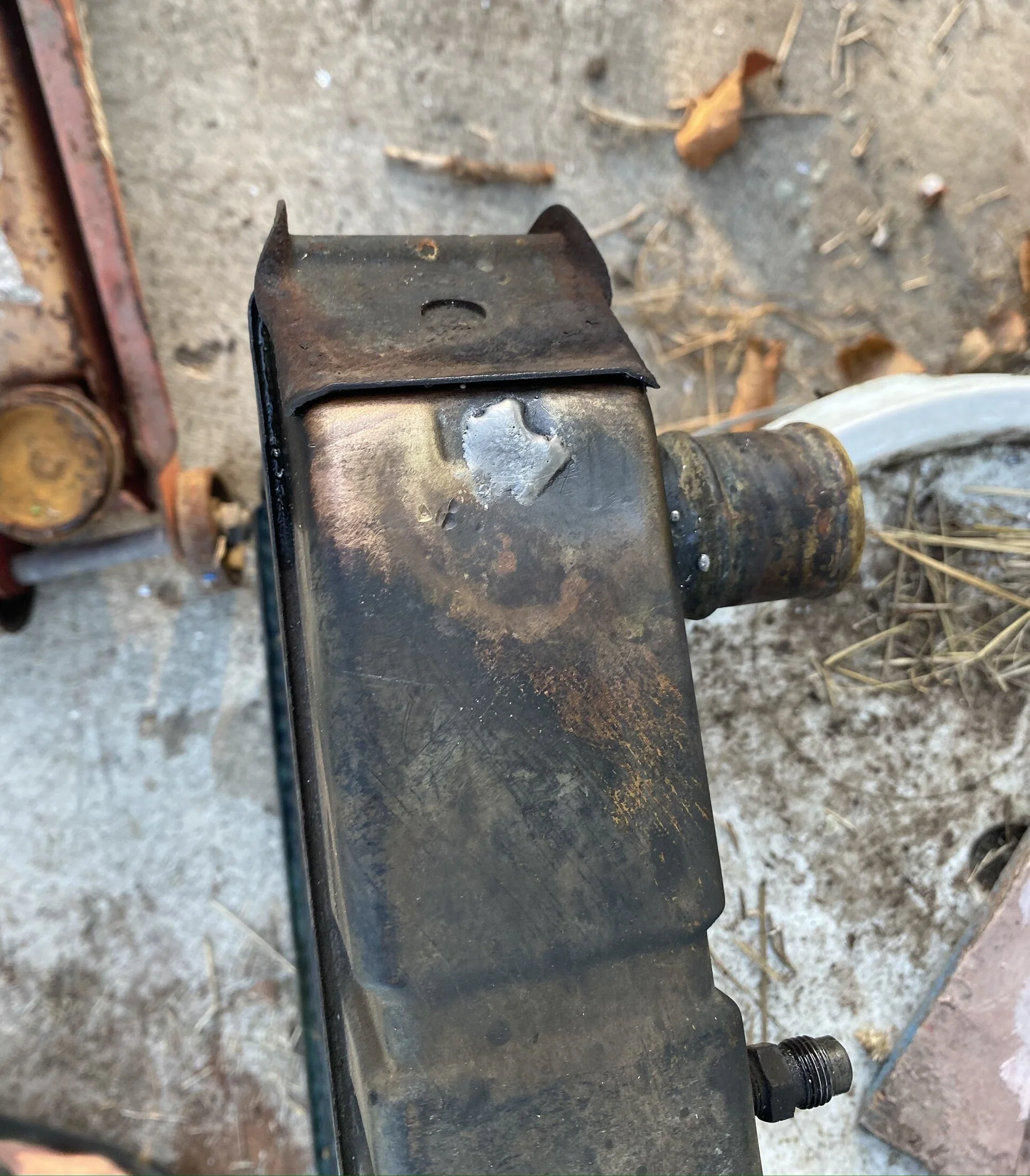

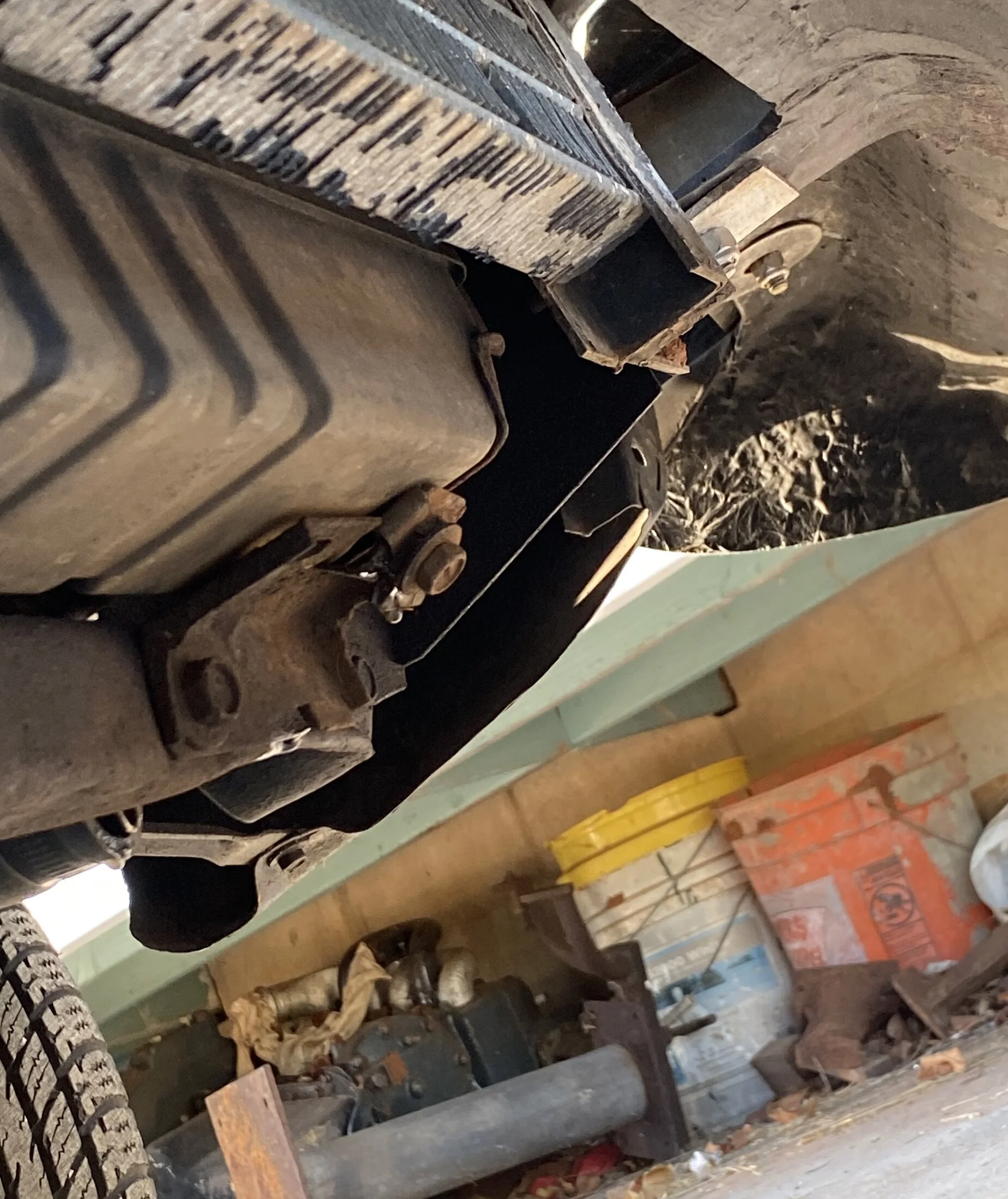

Today the car took a piss. Its leaking out bottom radiator.
Right where bolt is touching it.
The bolt got bent up and touched radiator there making pin holes.
I soldered the spot up, then resembled the cooling system and can’t seem to bleed all the air out.
I put water in and it blows it out to puke tank.
One new thermostat and radiator cap later, before it heats up it blows past cap to overflow.
With cap off radiator full it blows water out and has bubble stream in top tank.
I’m thinking head gasket is blown.
Oil is clean no milkshake or volume changes.
Exhaust is clean no visible exhaust gasses white, blue, or otherwise at tailpipe.
Think I need a test or is head gasket the problem?

Was it puking water out before the hole in the rad happened? If not, it would be strange for a head gasket to go at that exact time as the other.

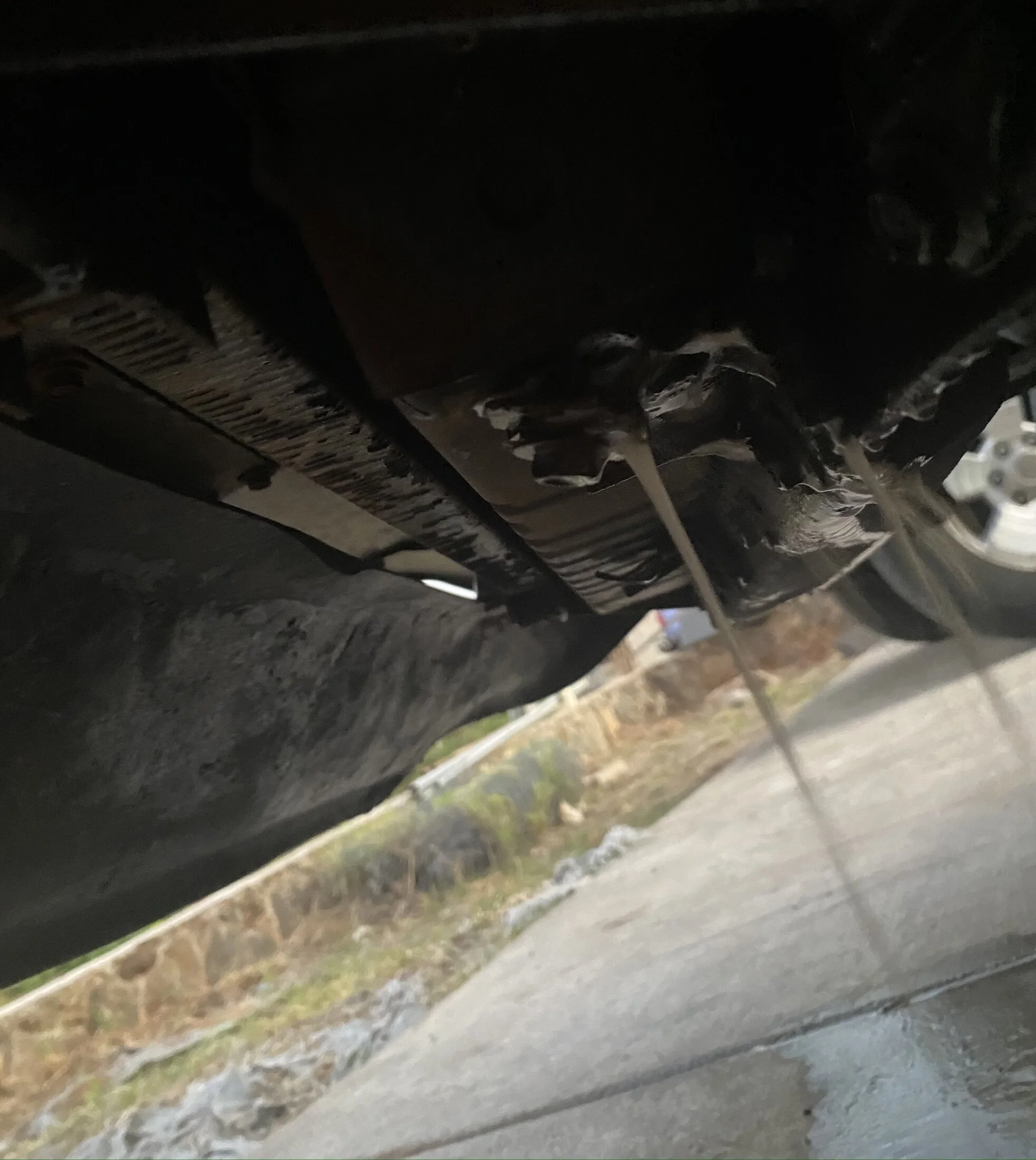

Indecision! due to budget constraints, time constraints, and its been F-N Hot outside, no chance of self healing, wish I could rub the rust off it, dang, ... so...
Been watching C-list and B face for a replacement 289/302 because I'm worried about block/head being cracked.
Probably an unfounded worry.
Found one possibility of a somewhat fresh machined but un assembled 302 but been sitting and kind of cost prohibited for a pile of someone else's problems.

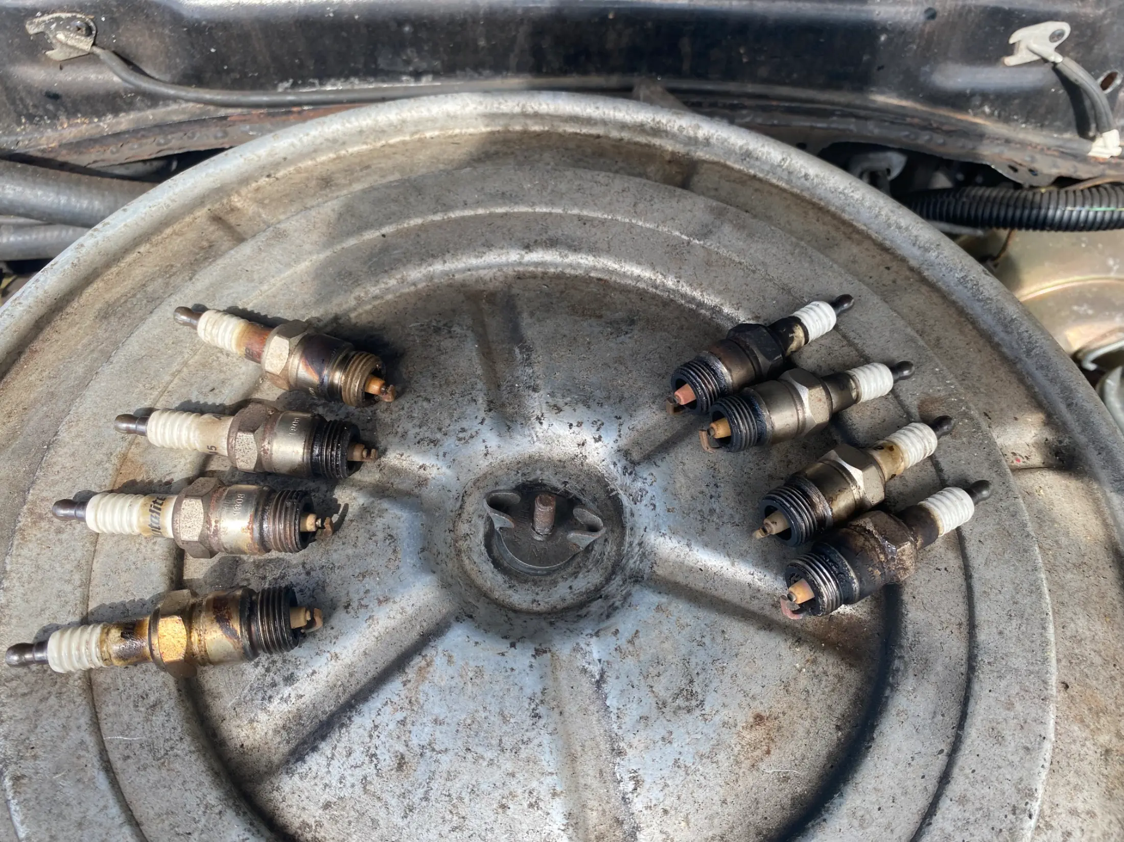

Pulled plugs out
#2 looked wet -this is bad
Spun engine over for number 1 test and water splashed out of 2 and 3 holes
Bummer
That water looks rusty
Hope its just the gasket between 2 & 3
