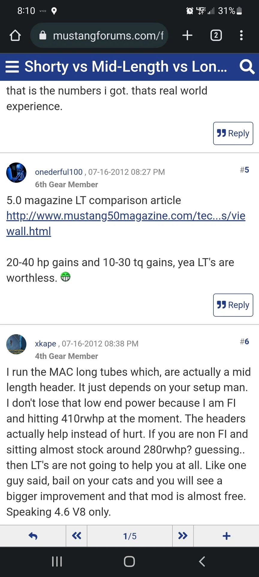

I believed long tubes were always better until I read this article. There was another on in one of the popular mustang mags years ago, too. The shorties made more power in the streetable range due to exhaust scavenging. I'm sure that design and tube size had a lot to do with that. Wish I could find the old paper article.

Yeah I read that. On that application it made power all across the board but if the design of the headers was different the result could be different. That's what the old paper article was saying. I found ( what I think is the article )but the link does not work.

Now that I've had time to really think about it...I think the mid length won the challenge in all categories. It was probably due to design. Headers have come a long way over the years. The designs have definitely changed with newer technology and manufacturing processes. Back when that article was written the E cam was probably hailed as the best street camshaft.

https://www.motortrend.com/how-to/1406-long-tube-vs-shorty-headers-pipe-dreams/
Engine Masters did an episode on a higher hp engine than that article and the gains were expontenially better as expected.
