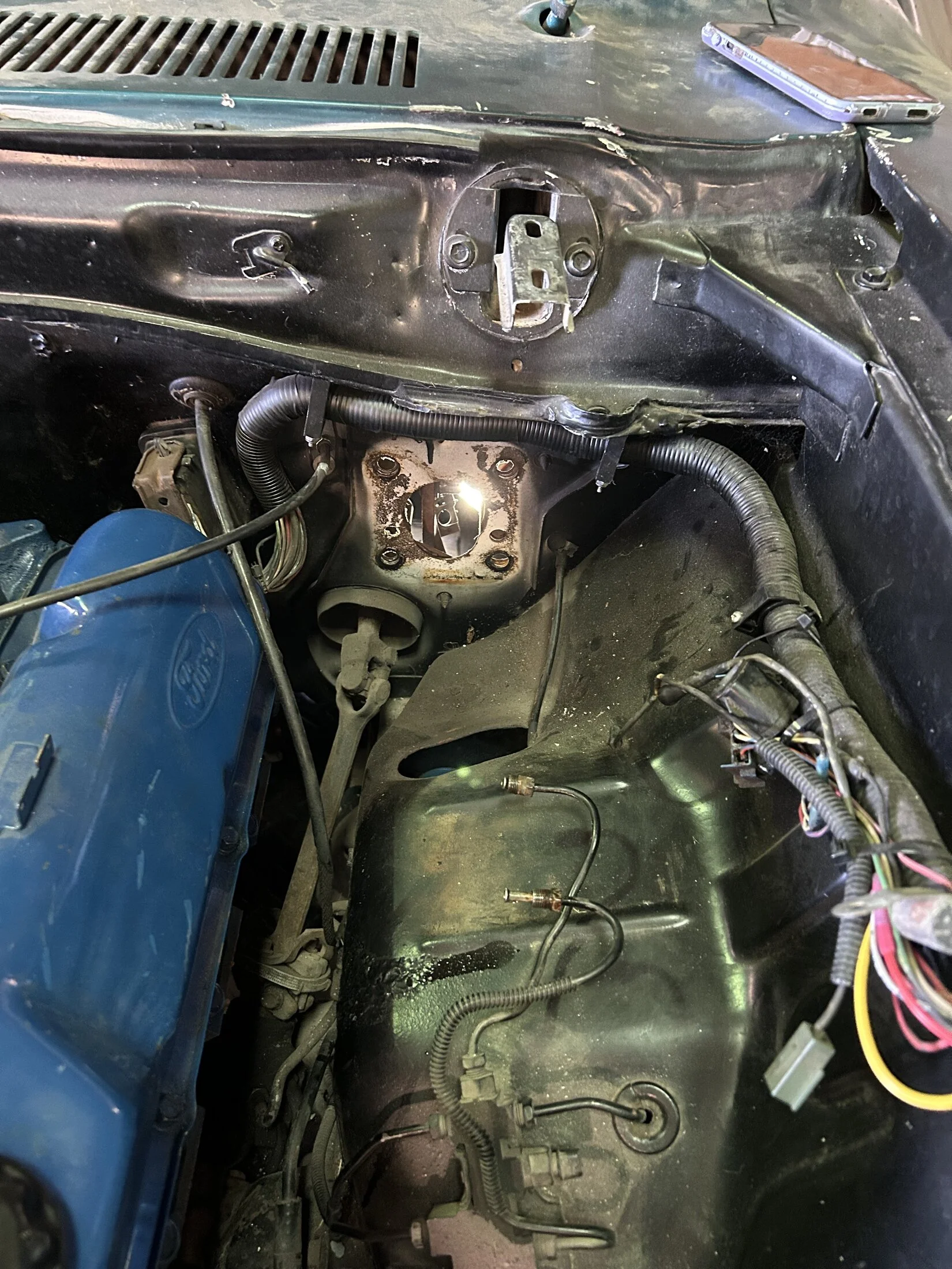

Pulled the booster. It certainly looks like I can shift the hole thing over one inch.

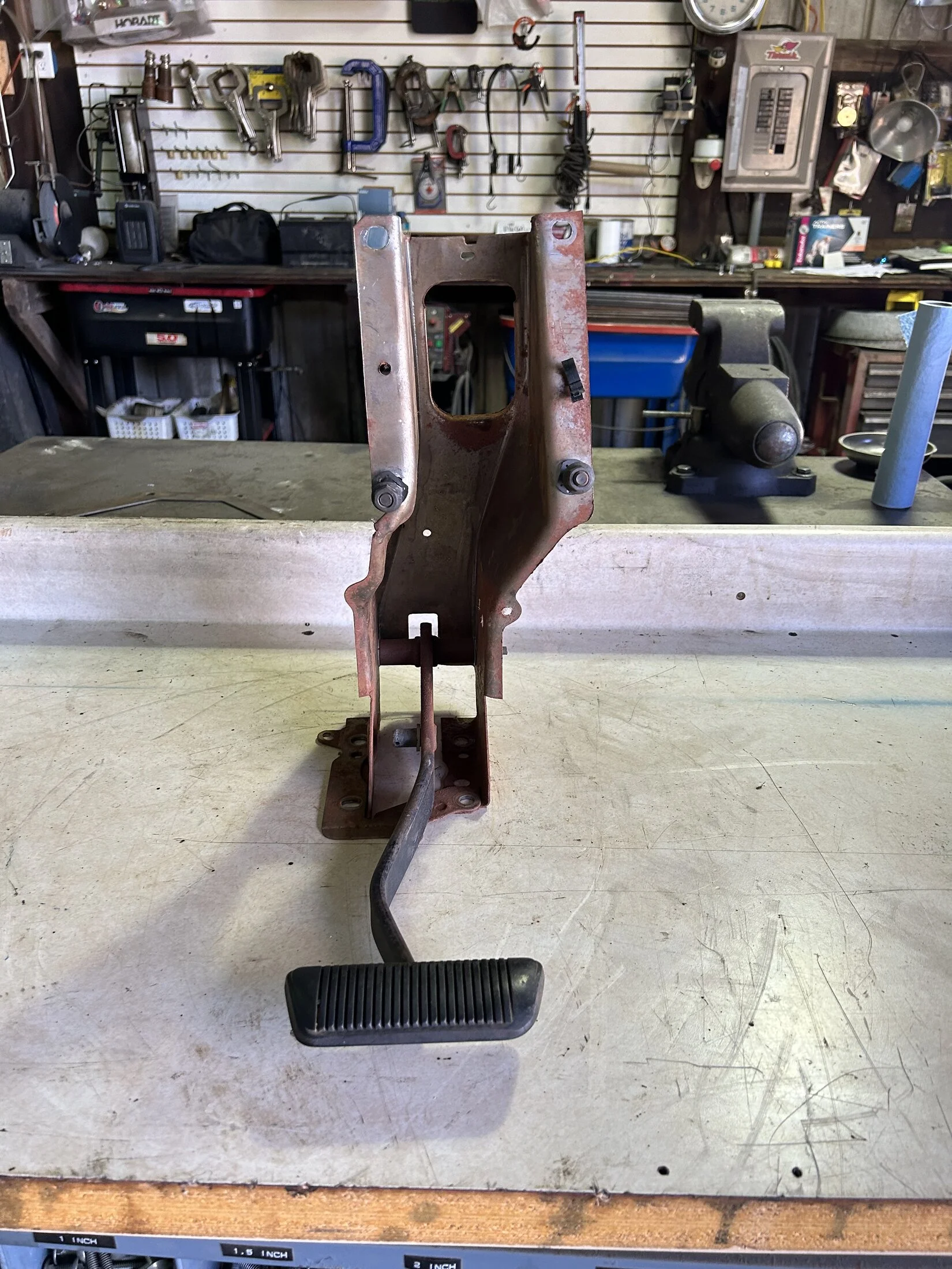

Got the brake pedal and bracket assembly out. Looks simple enough to move everything over an inch. This will obviously move my brake pedal over an inch as well. But if it feels or looks funny, I can always heat up the brake pedal arm and snake it back over to the original position.

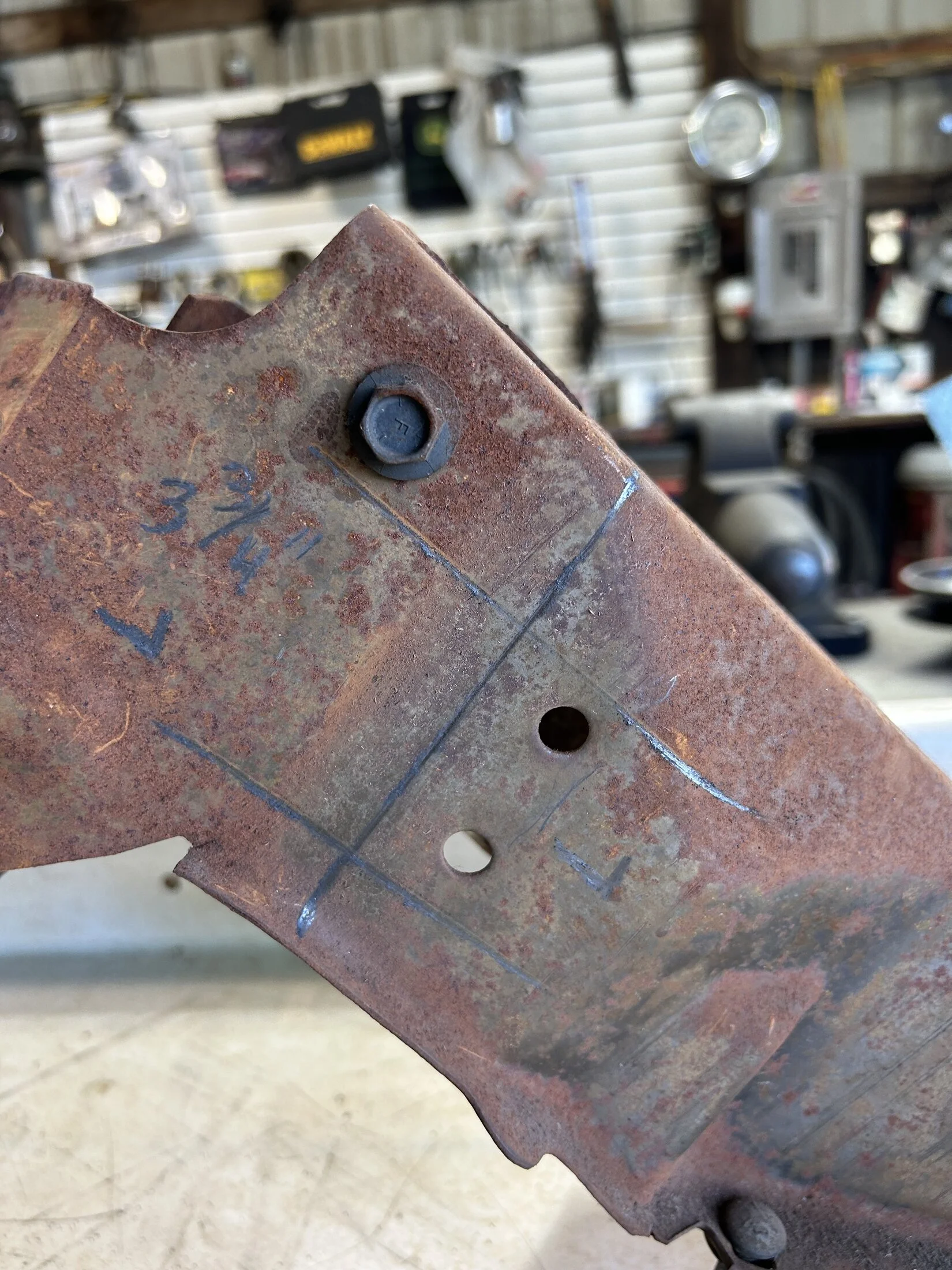

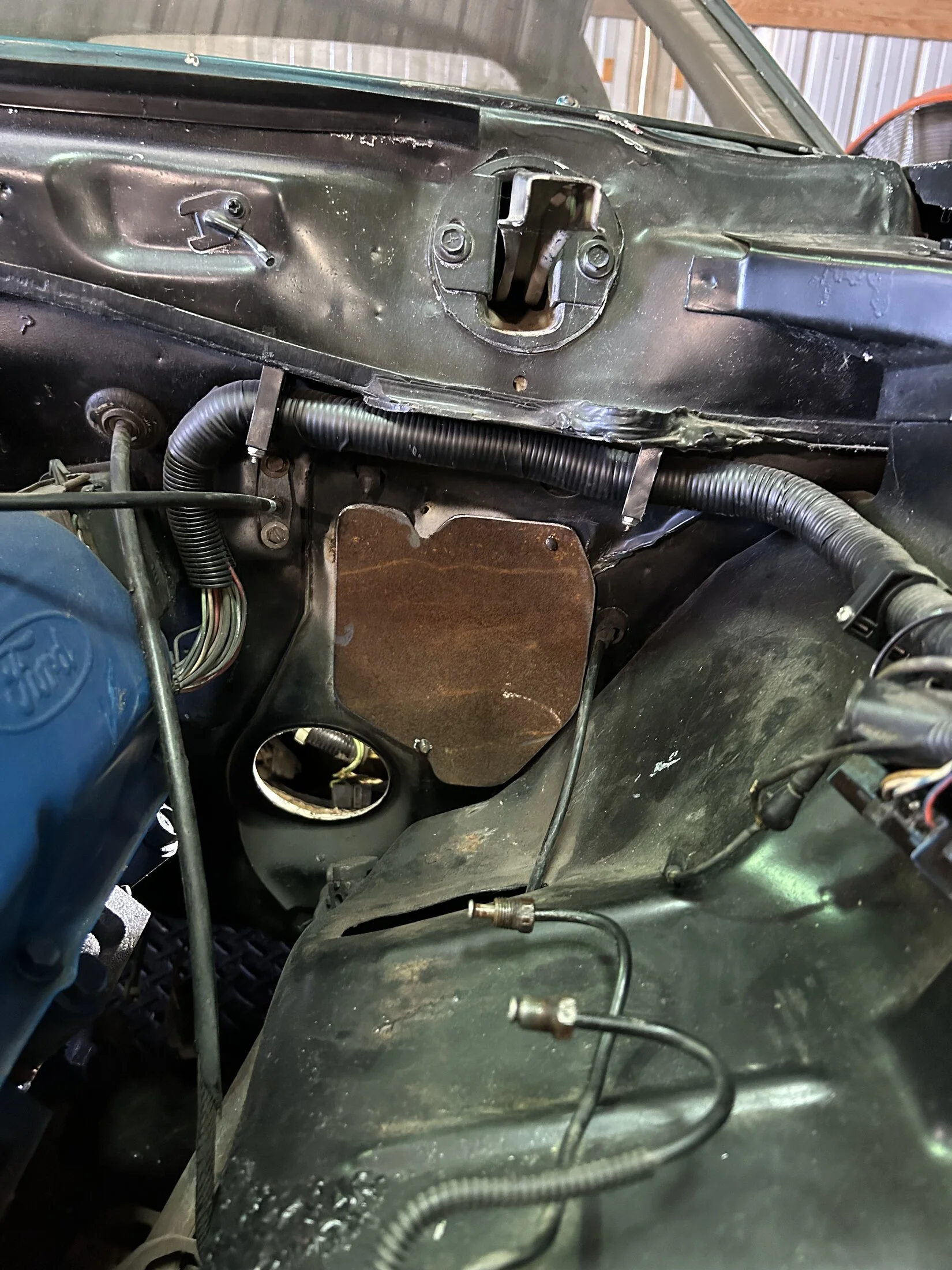

Marked where the cut and ultimate shift left will take place. The only potential interference issue I saw was with the windshield wiper assembly. The motor and arms are right in that area. But my calculations show I should be good. Plus I could always clearance the bracket if necessary.

Oh boy. No turning back now. Hope it works out as well as I’m in visioning. I’ll rough it in and test fit before full weld up.

Before 1 inch shift to the left modification.
After 1” shift to left.

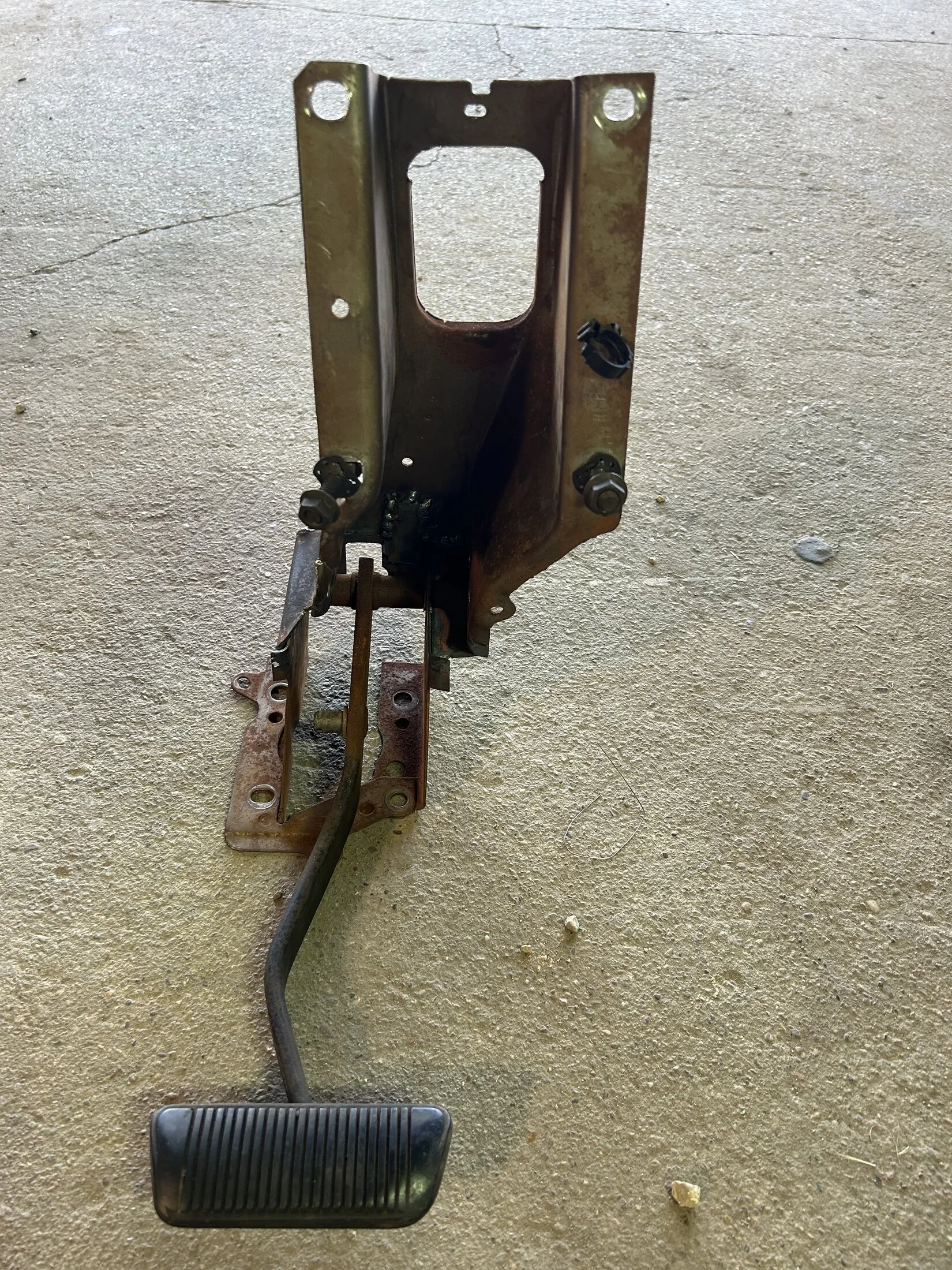

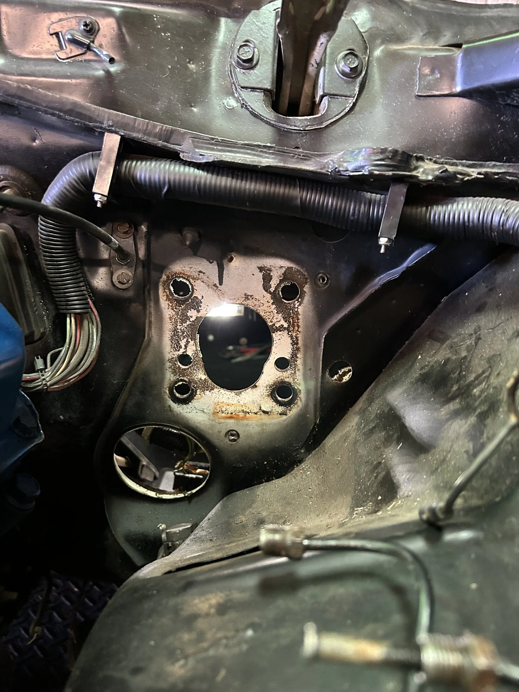

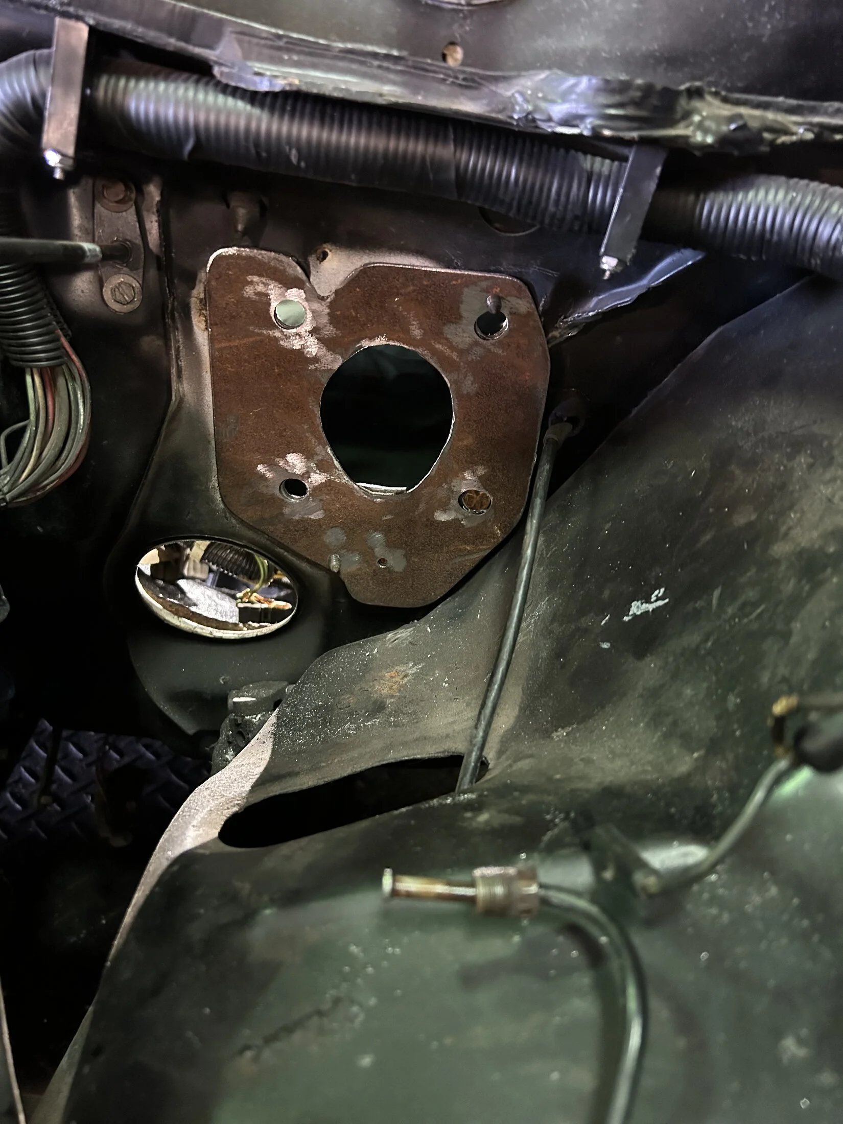

Original booster mounting location.

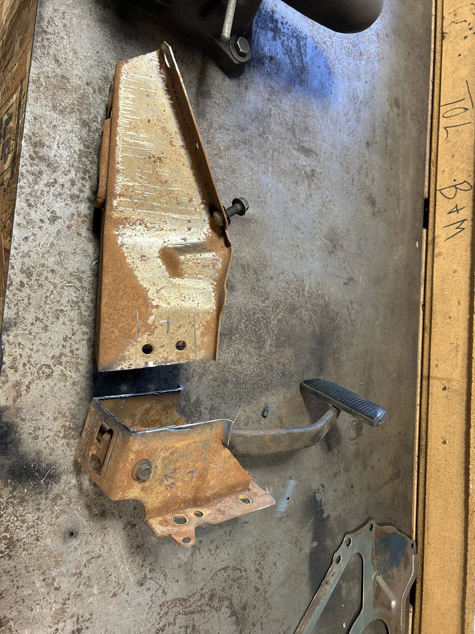

New support bracket to strengthen the area and relocate mounting holes 1” towards the drivers fender.
New mounting holes shifted 1”

I now need to clearance the inner fender well to allow the brake boosters new location to work. I’m going to notch the fender well and weld in a new piece. Honestly, from my mock ups, it looks factory. I bet unless I tell someone I moved it, they won’t even be able to tell.

LILCBRA said:
How'd you get it's location all figured out before your final weld?
With the engine sitting in the factory location on the factory mounts, I have just enough clearance from the brake booster to be able to remove the valve cover. I measured the center line of my car and the engine sits exactly 1” off center to the drivers side. I figure if I’m moving the engine 1” towards the drivers side, then I should only have to move the brake booster 1” outbound to maintain the same clearance. I also didn’t want to get greedy and move everything too far that it would look weird. So I decided to move every mounting hole exactly 1” outward. Then I moved the center line of the brake pedal outward exactly 1”. Only trick to that was clearancing for the brake switch and making sure the modified bracket didn’t interfere with the windshield wiper motor mechanical arm. Going one inch did not. Any further and it would have. I built a plate to reinforce the brake booster mounting area and then drilled all holes one inch further towards the drivers fender. I also moved the hole for the booster arm that attaches to the brake pedal exactly 1”. I then cut the brake pedal bracket and shifted it exactly one inch towards the left. This allowed the front of the bracket that bolts to the steering column to remain in the original position and the back of the bracket that bolts to the booster to be 1” further offset. Welded it up with angle iron so it is even stiffer than factory. Steering column bolts back together in factory location but the brake pedal and brake booster are shifted 1” out now. I thought the brake pedal would feel and look odd. But it doesn’t. I actually like the new location better. When I wear boots, I used to get hung up on the brake pedal while pushing the accelerator. Seems to not be an issue anymore.
I did mock everything up to make sure I like it. Forgot to get pics of that. But as soon as I notch the fender well, I’ll get everything cleaned up, painted, and put back together. I’ll get good pics of it then.
Honestly this was a pretty simple solution to the power brake booster clearance issue. I feel this is the way to go for this engine swap.

I don't think I worded my post clearly enough, but I think you answered me here:
What I meant was how did you ensure that the bracket would fit after you welded it? Did you have the firewall more or less mocked into place then bolt that piece of the bracket in place, then have the other half bolted to the steering column before you tacked it, removed it, then finish welded it? Or did you weld up the bracket then locate the mounting holes from that? What I'm guessing is that you located the booster where you wanted it, then mocked and tacked it before final welding outside the car?
And I think I'd agree with you about the brake pedal - there's not a lot of room between it and the accelerator pedal in stock form. I'd think that moving it over would make it a little more comfortable to operate.

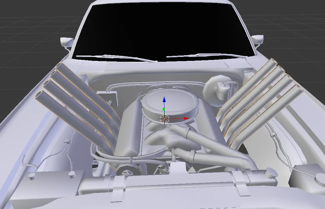

78 Mach1 said:
With the transmission installed, exhaust looks almost impossible. Oh boy. I’m not sure what to do at this point.
An exhaust idea for ya...
And you'd be keeping the hole in the hood centered...
Reactions: 2Blue2
Will need flappers on them
Yes, I tacked it in place and mocked it up to ensure everything cleared. But I pretty much new it would. Everything just shifted one inch. Probably one of the easiest mods I’ve done. Was very straightforward.
With only going 1 inch over, I new the firewall holes just needed to be drilled one inch over from there original location. Everything lined right up. I did mock it up to confirm, but it went really smoothly.
