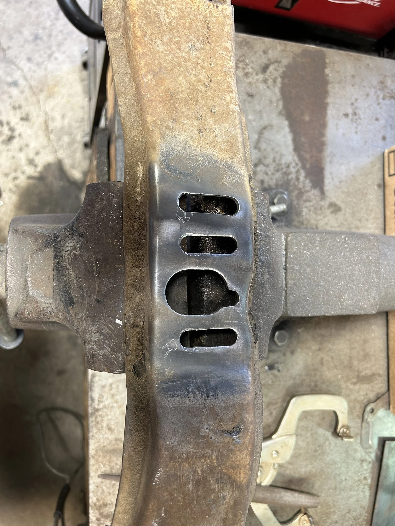

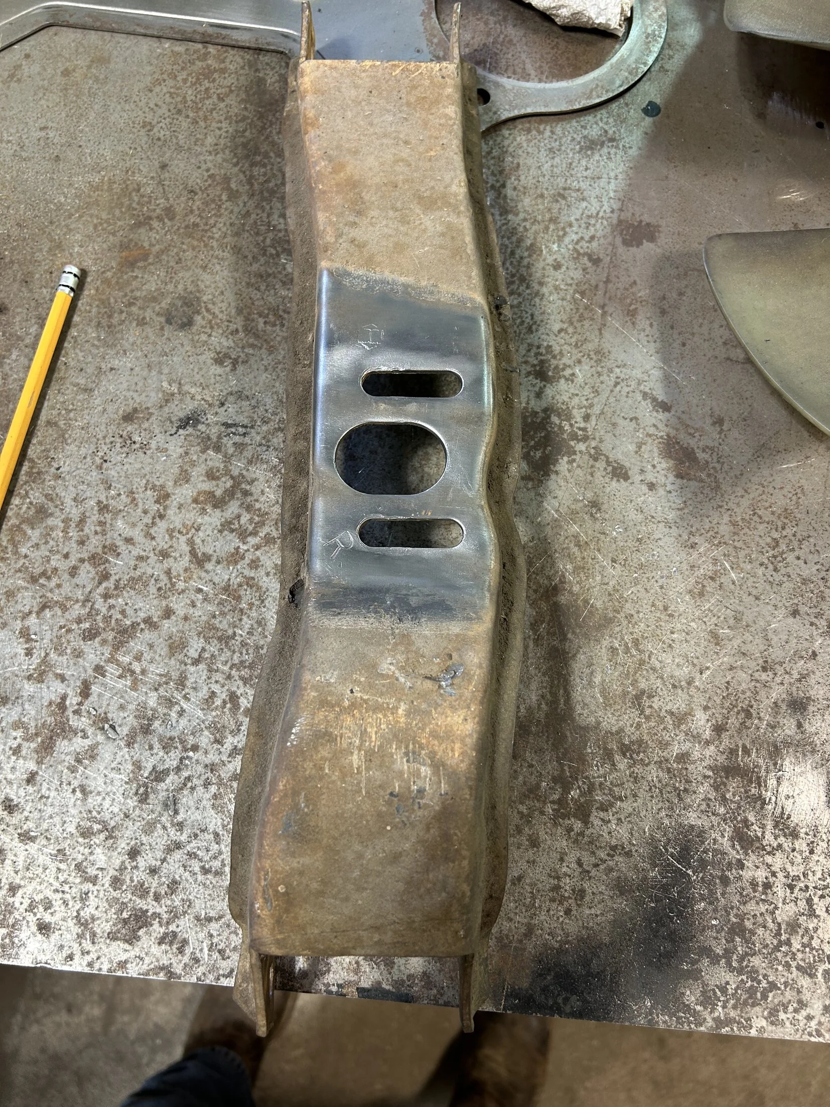

It’s been a week since making any progress because I was on a business trip. But I finally am back at it. Moving the tranny over was my next step.
Pulled the transmission cross support and cleaned up the area I’d be working in.

Cut the new slots 1” to the drivers side but that put one right in the large center hole.
So I decided to plate over it.

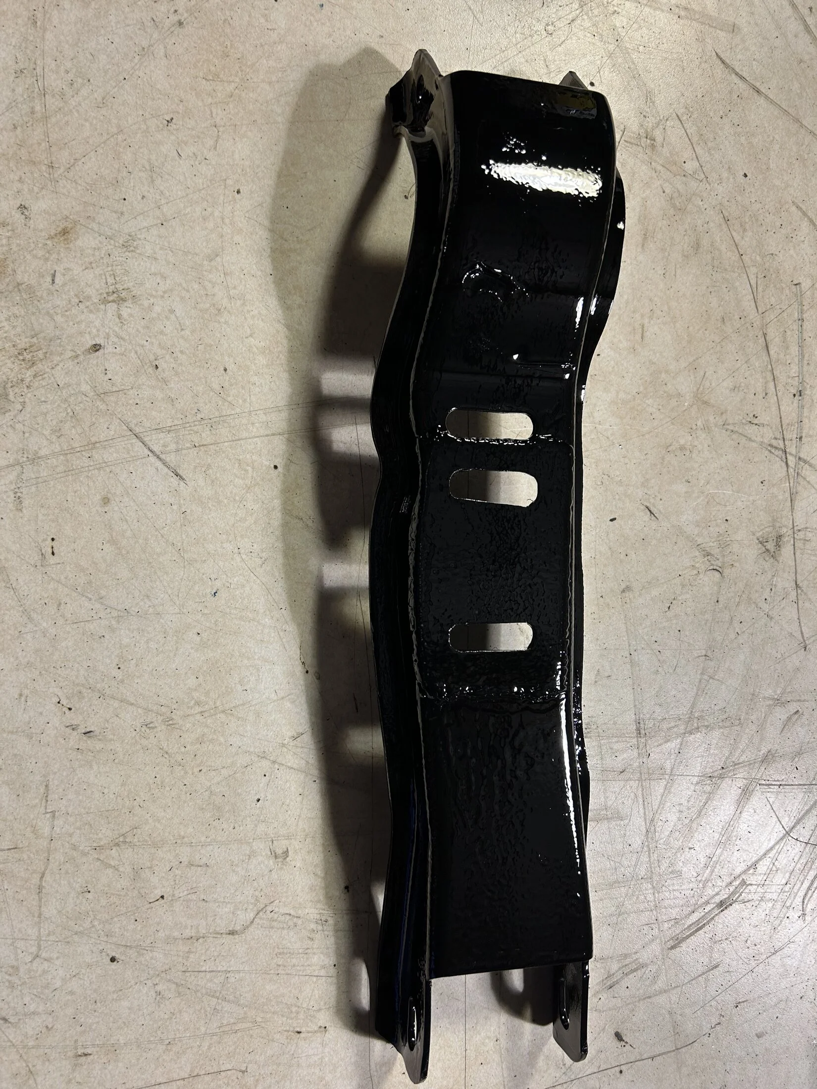

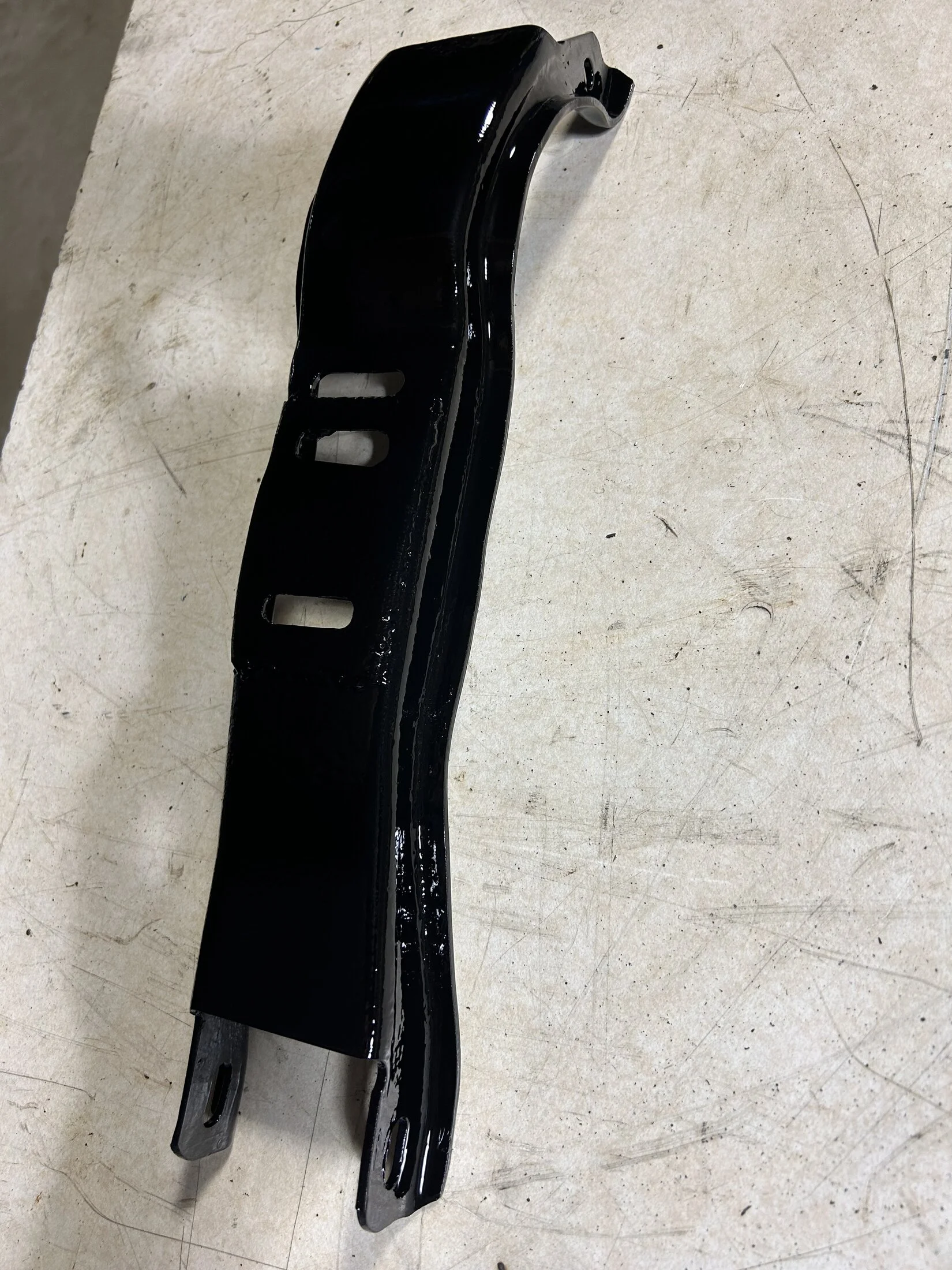

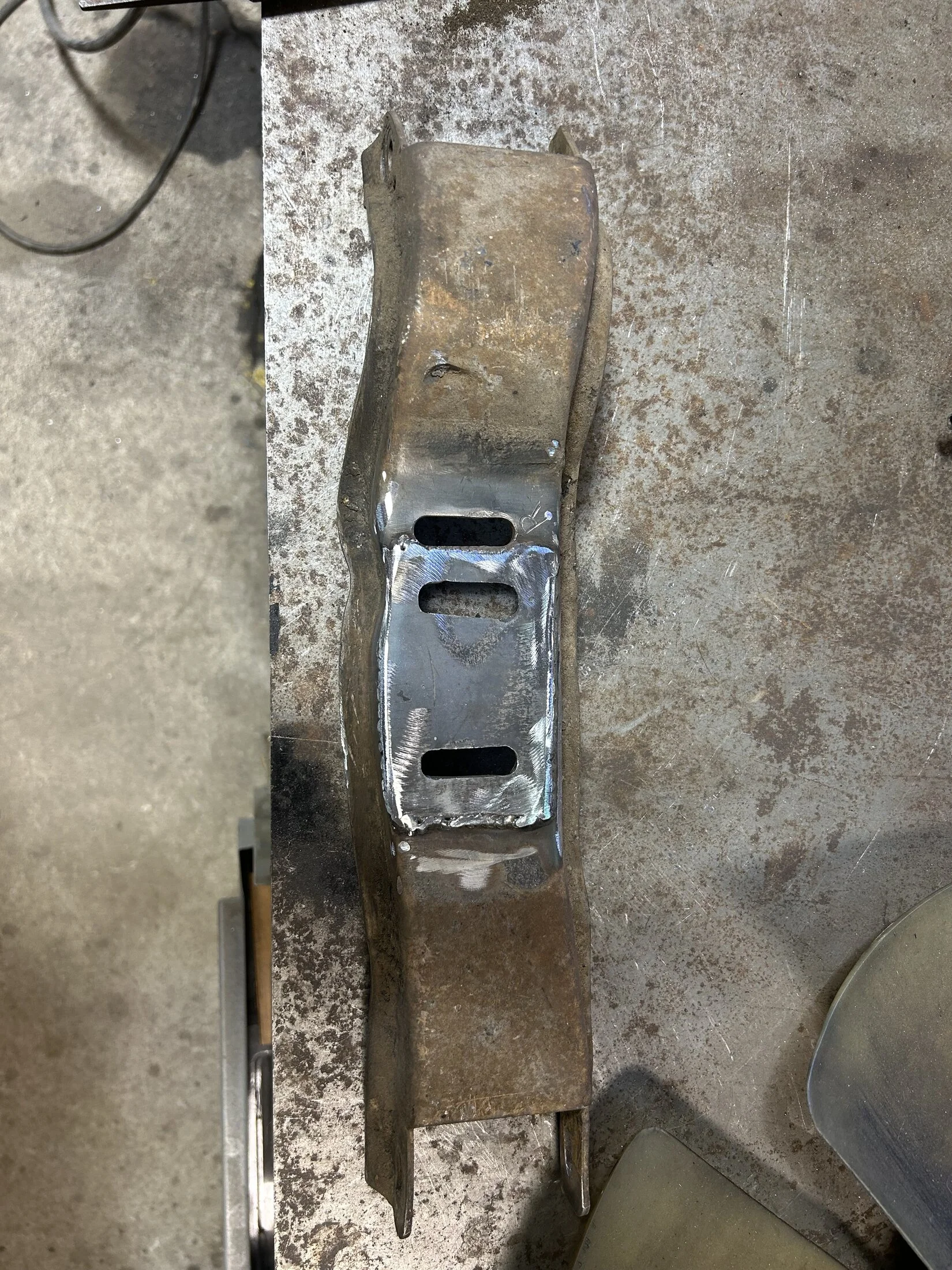

Here’s the finished product. Fits perfectly. I left the one original slot just in case I ever want to reuse this in the factory original position.
I’ll get this reinstalled and then make temporary plates for the motor mounts to hold the engine in place while building the motor plate.

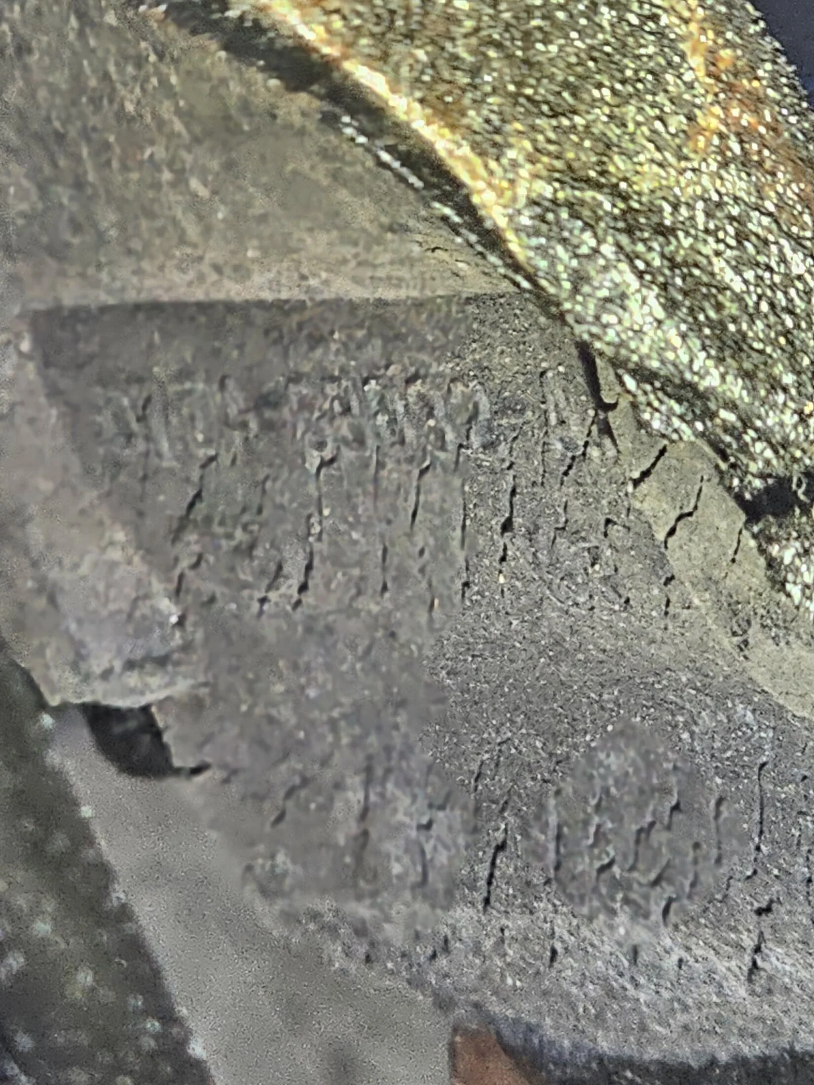

This is a pic of the driver side mount in my car. I didn't see a part number on the passenger side but I didn't crawl underneath to look.

Lolcbra I think I can pick out D7ZA-6B032-A. If that is correct, that does match one of the part numbers on mine. I could try that on the drivers side and see if it makes sense.

That was why I even bothered sharing it. It's hard to get a good pic of the part number with it in the car, the oil filter is in the way. But I figured since I could make out a "2" as the last numerical digit it should help give you some point of reference, especially since you have 2 different part numbers and this seems to match.

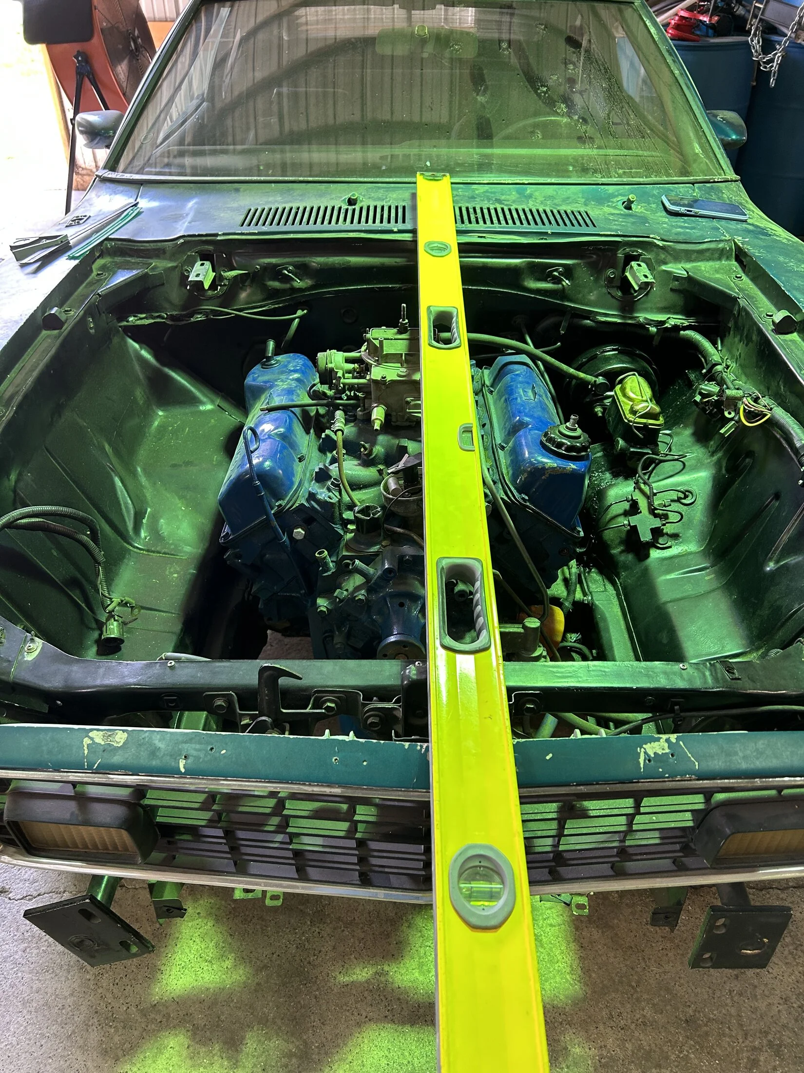

Here’s where the motor sits currently with the tranny mount shifted over 1” and with factory mounts in factory locations. I’ll move it with migshift brackets and see where it ends up next.
