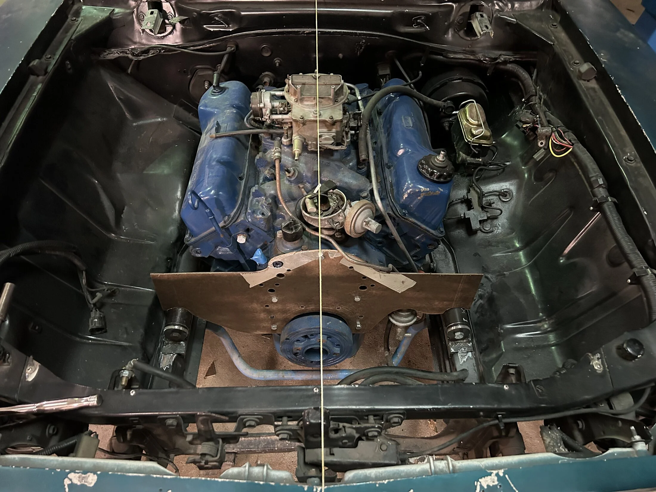

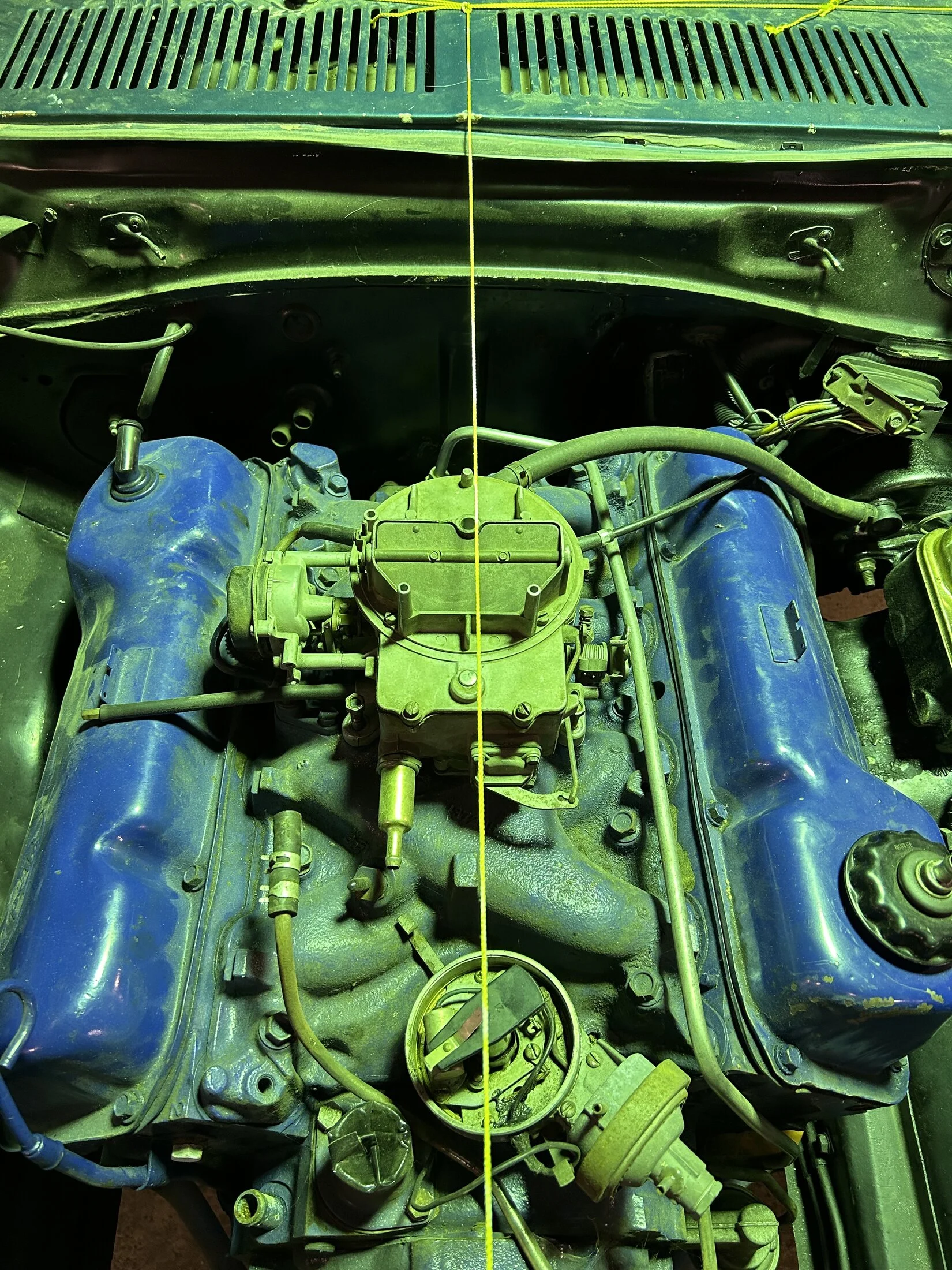

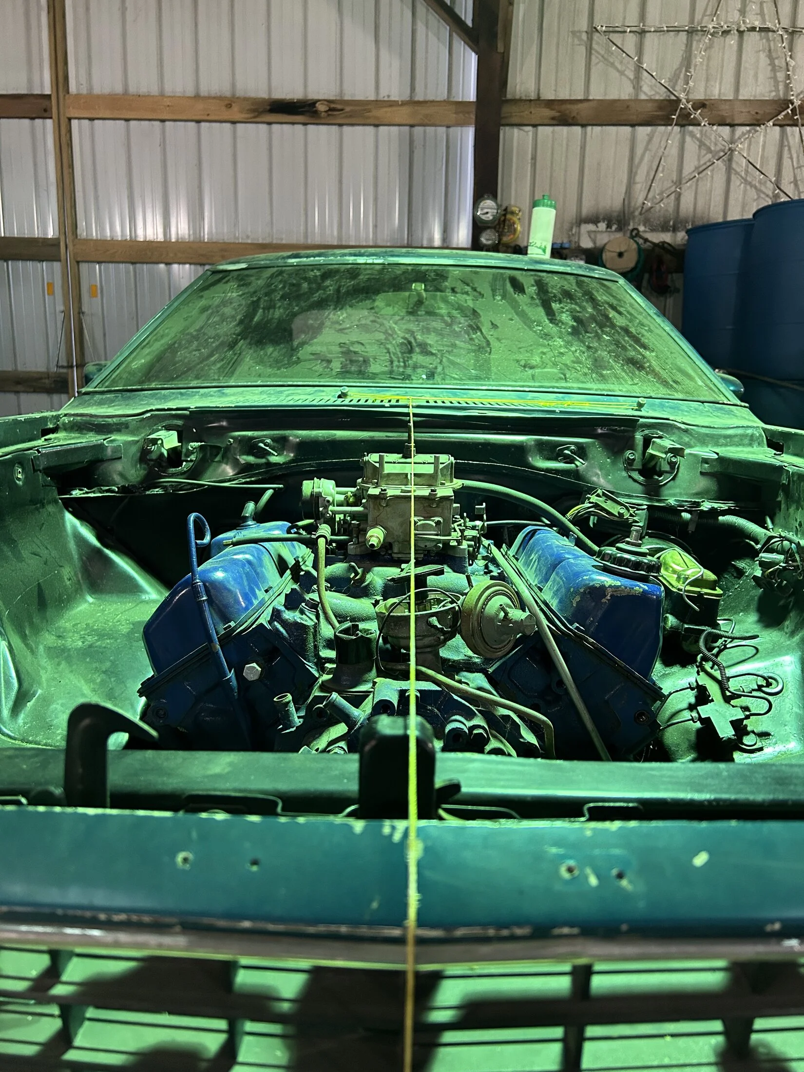

I was able to build temporary adapter plates to the factory motor mounts and get the engine sitting in square and centered. Well almost. It’s off by 1/16”. But I doubt anyone will notice that. I may be able to correct that with the motor plate.
Sorry about the green tint in the pictures. The light over the engine bay makes everything have a green tint In pictures for some reason.

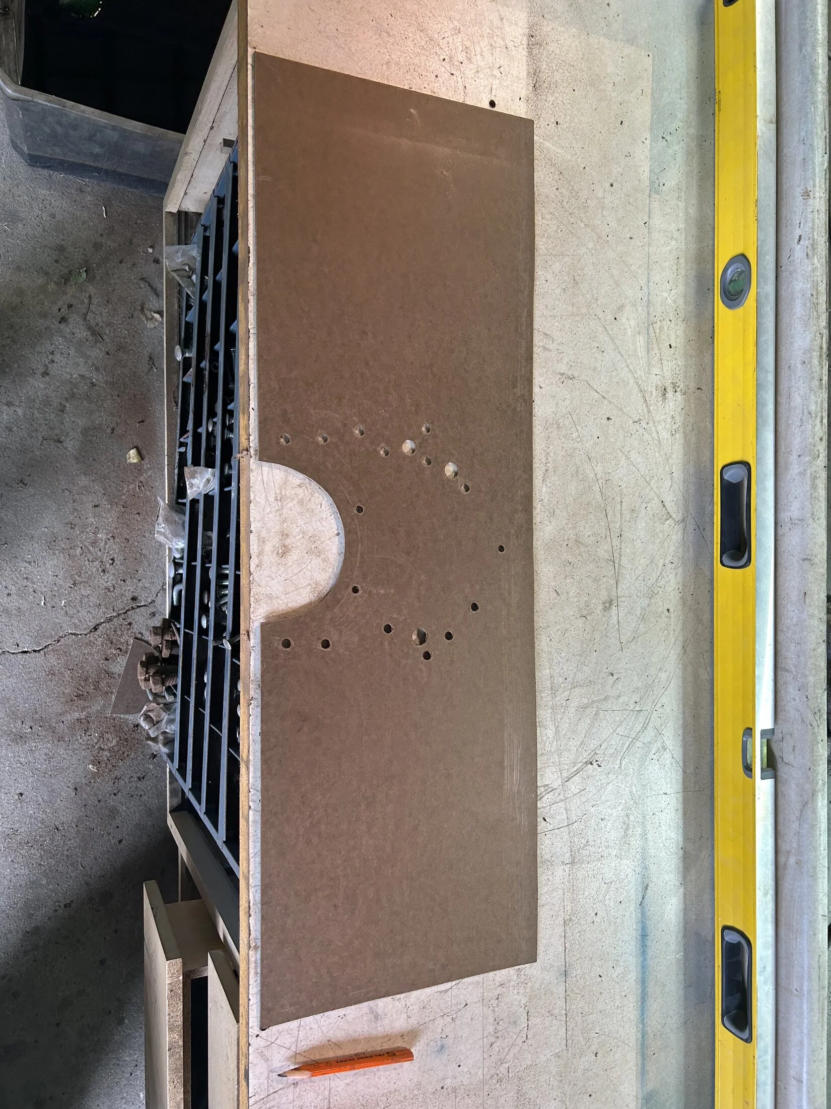

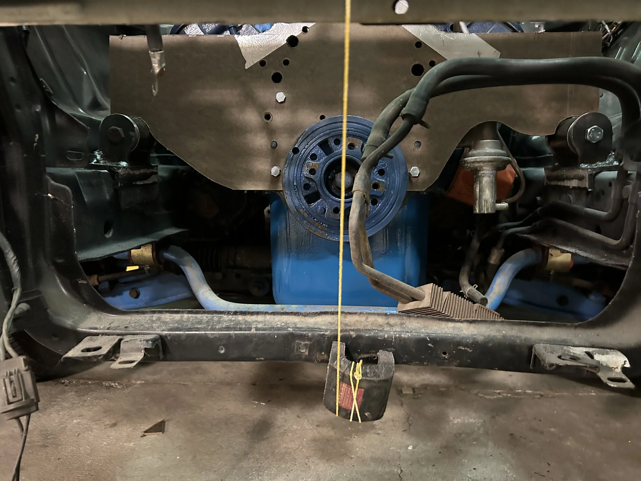

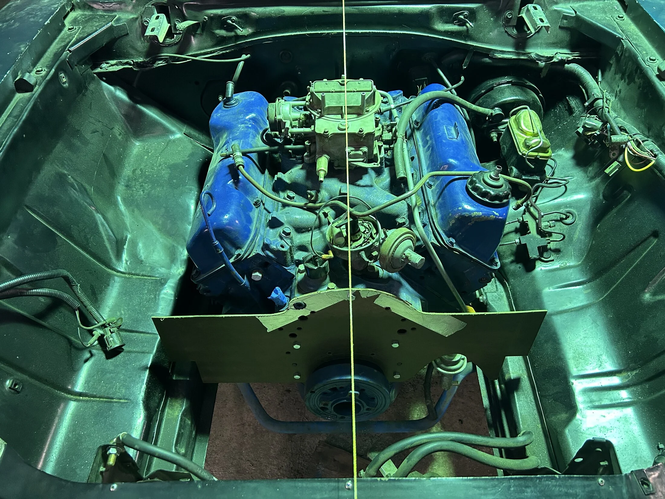

Started making my template for the motor plate.

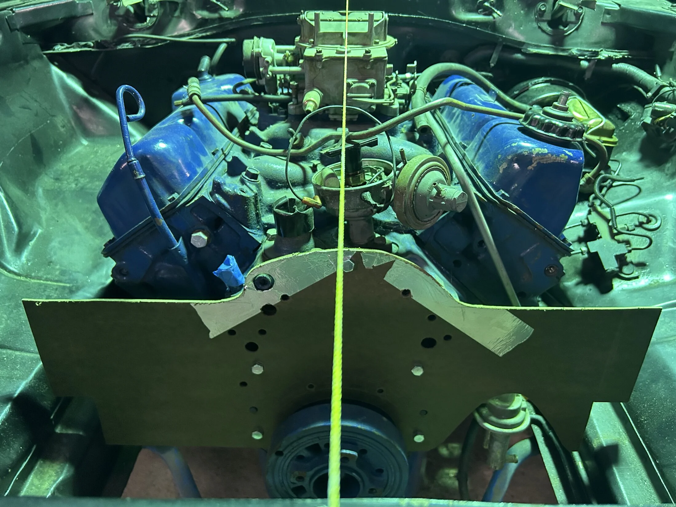

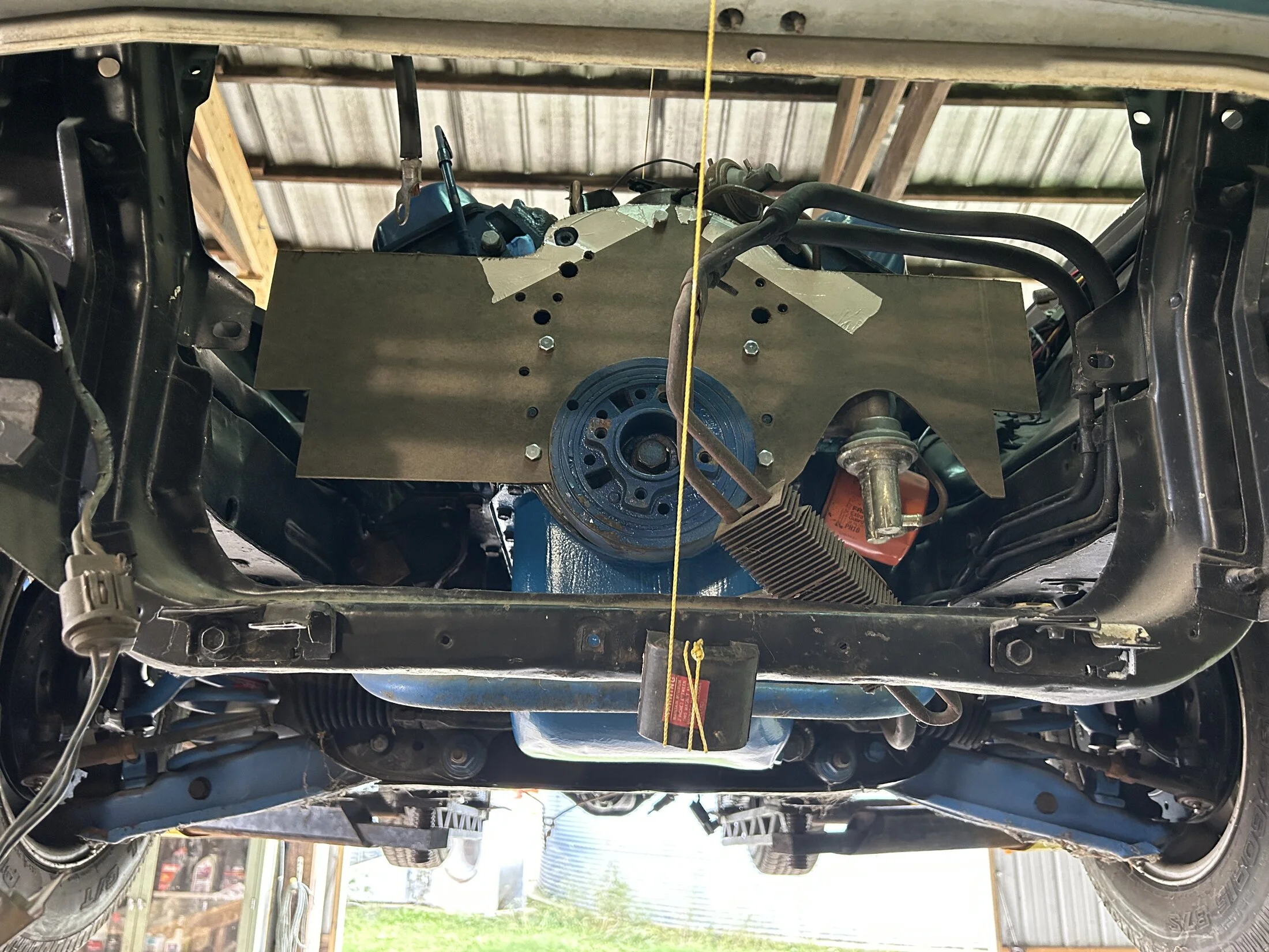

Here is the motor plate template in place. This is pretty close to what the final will look like with the exception of the outer ends. I can’t do the final shape on them until my bushings and DOM get delivered. That should be early next week.

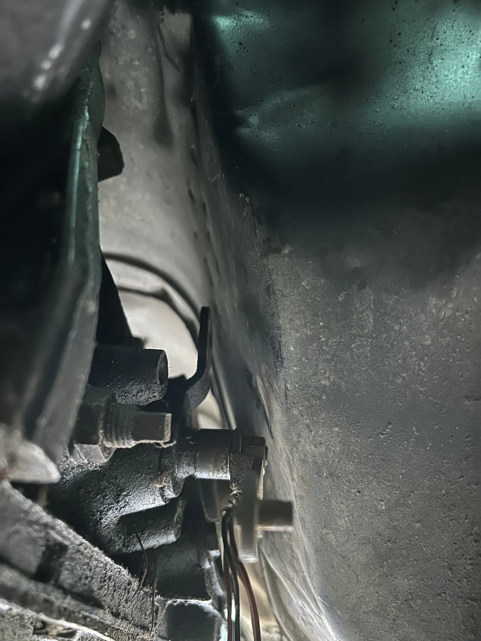

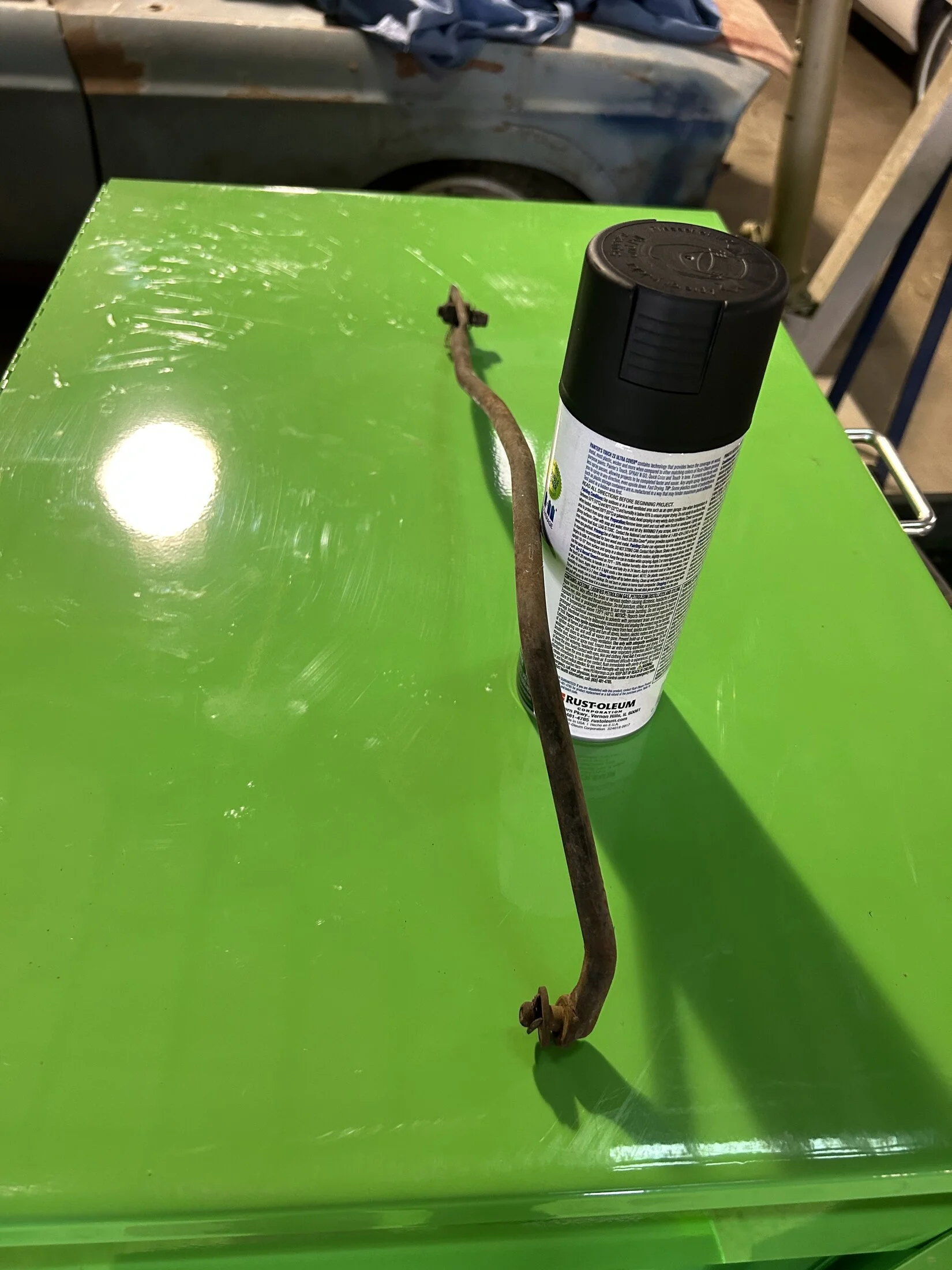

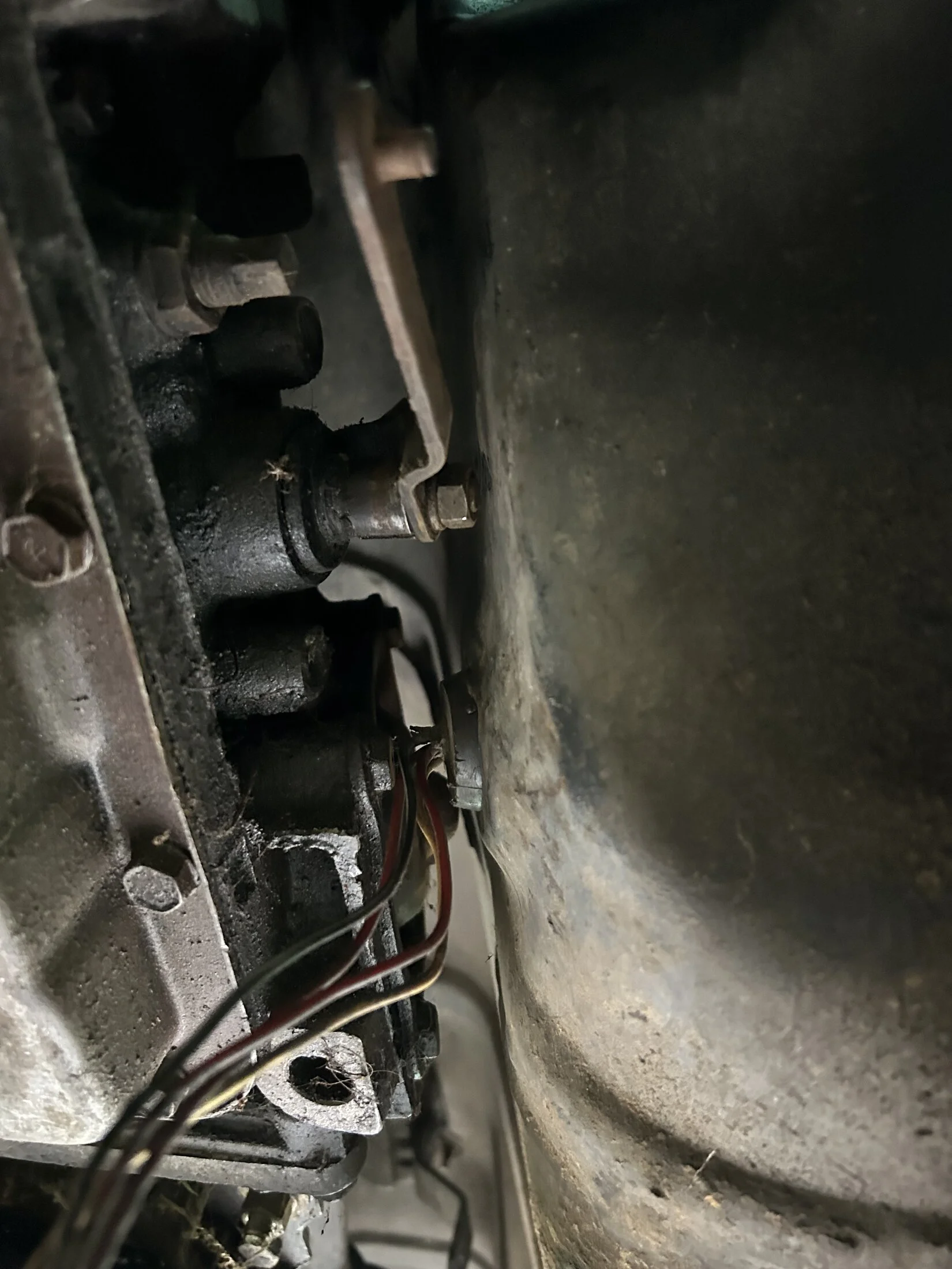

Since I’m at a stopping point waiting parts for motor plate. I decided to look at the tranny clearances. It was moved 1” over with the engine, so there’s no surprise I have slight clearance issues with that.
The shift rod rubs the tunnel and the neutral safety switch can’t come off in the car. So I have to clearance that.
My plan for the shift rod is to just turn the end the opposite direction. That will allow it to clear no problem.
The neutral safety switch is more difficult. I only need about half an inch. Although it goes against my normal quality of work, I may just have to clearance that with a hammer. I hate to do that. But for half an inch, it doesn’t make sense to pull the hole interior and section the floor.

Hammer clearance ing is a time honored tradition!
Lots of good progress. The oil pan looks to have lots of ground clearance .

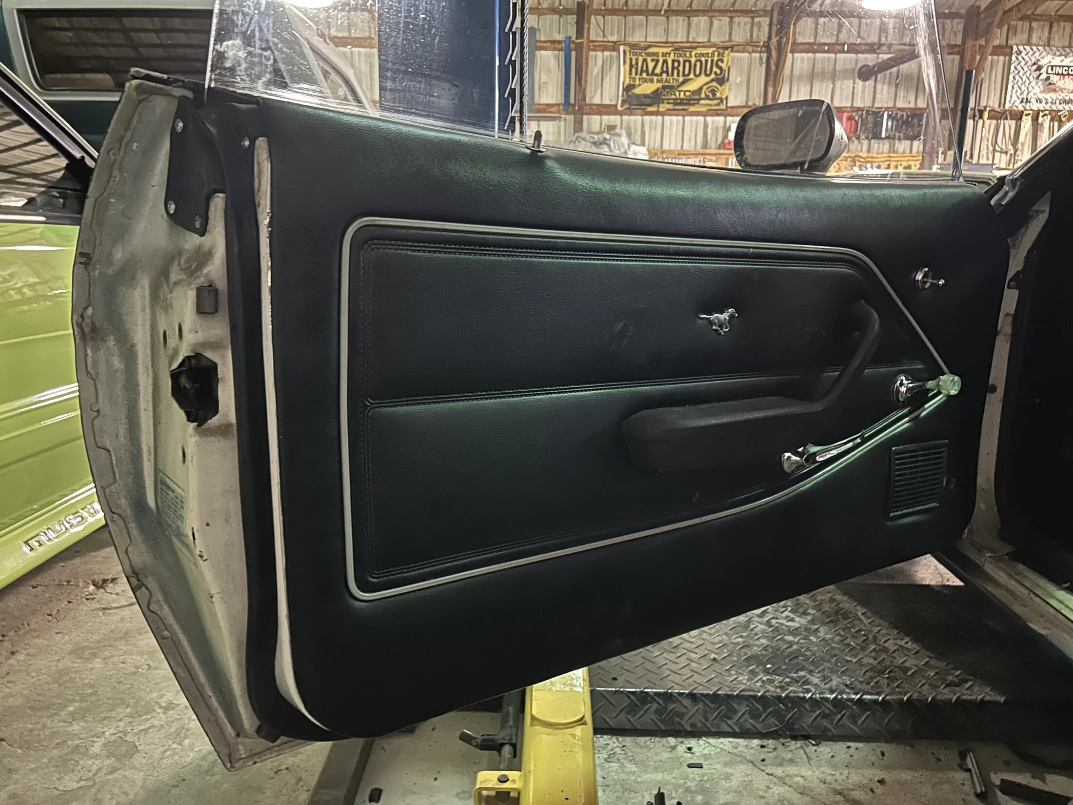

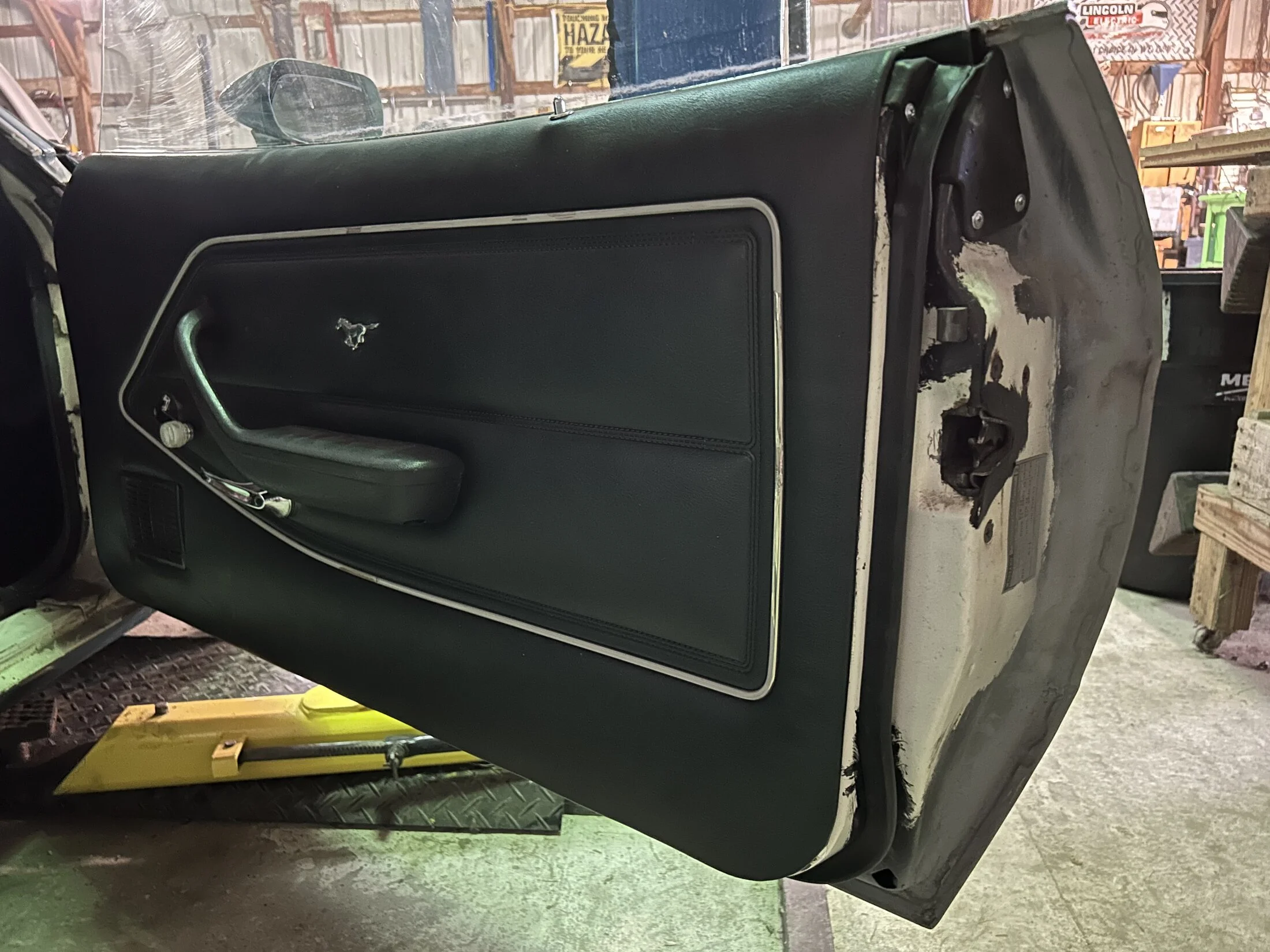

Not a big job. But still well worth it. While I am waiting for parts on the motor plate. I decided to go ahead and install my new door seals. These we’re unavailable for a couple years during COVID. But as soon as they became available again, I ordered a set. They’ve been sitting in the hatch for several months now. I used this down time and installed them. Doors shut like brand new now.

Sweet, no more door rattles.

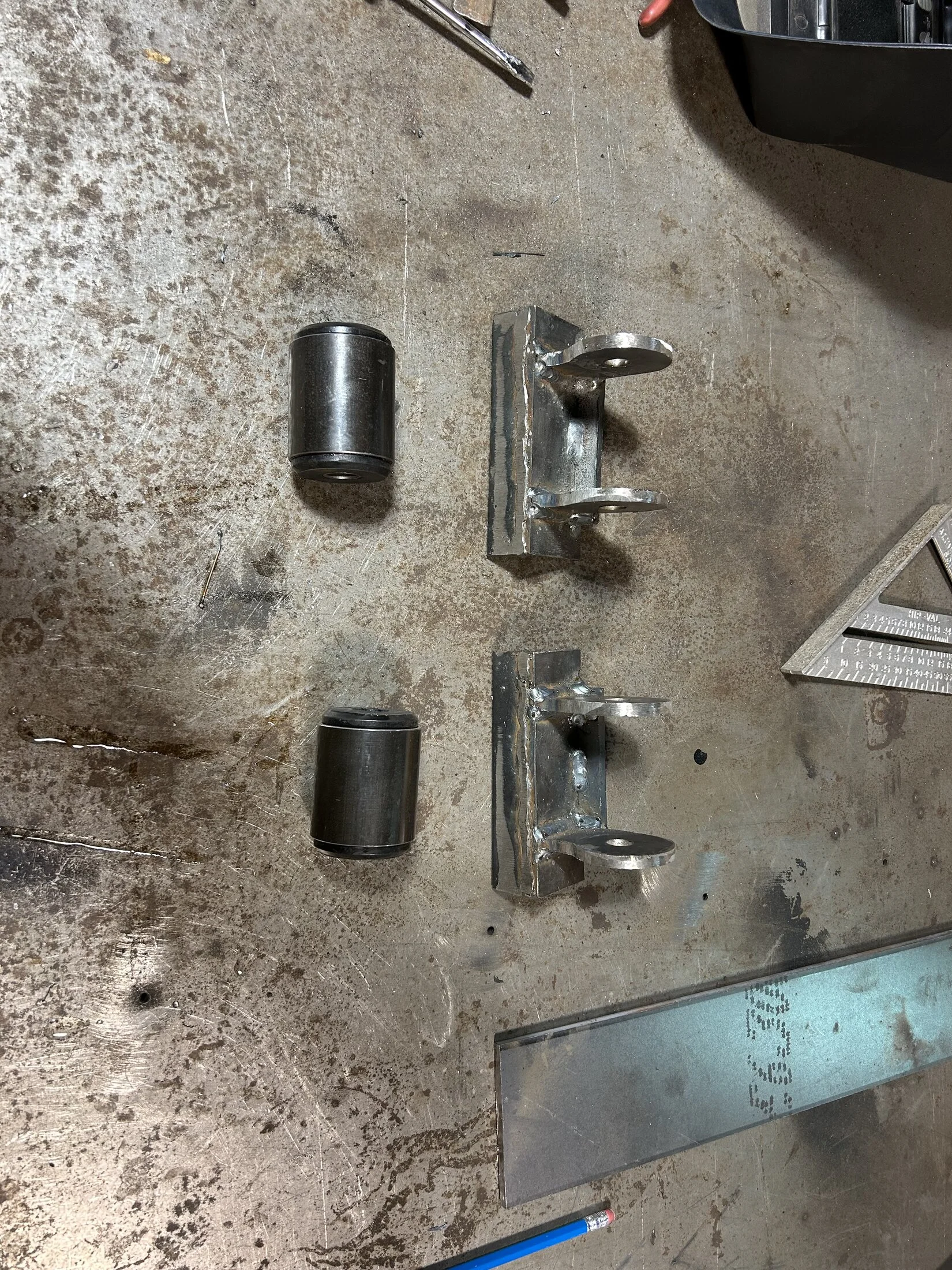

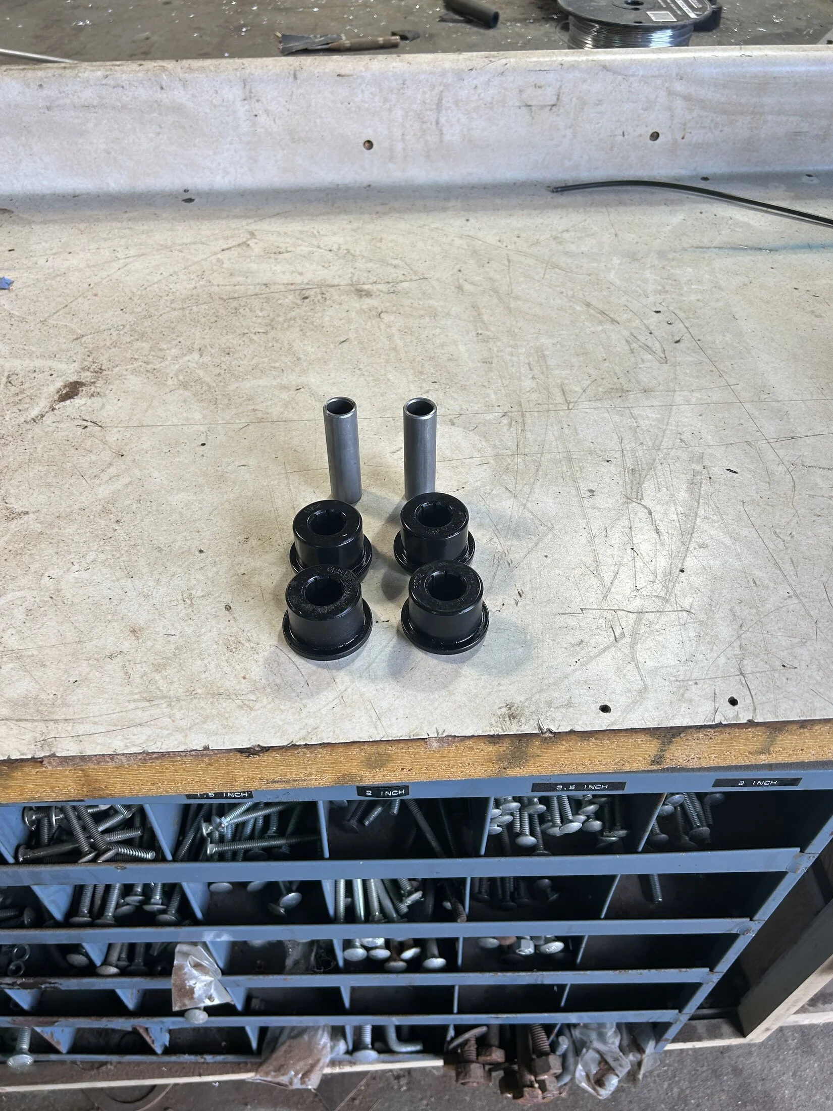

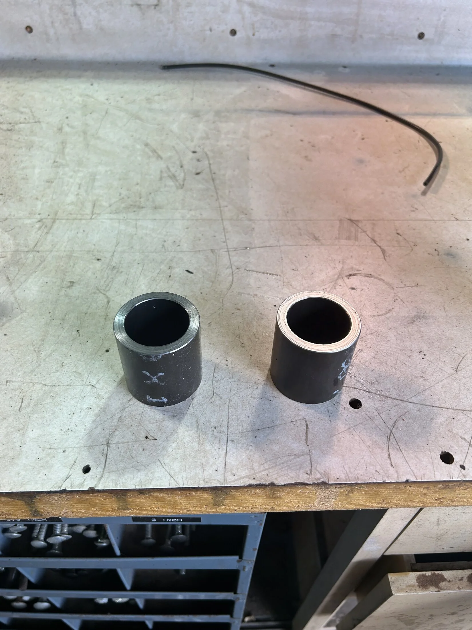

Made a little more progress this weekend. My bushings finally came in.
Cut the round stock to length.

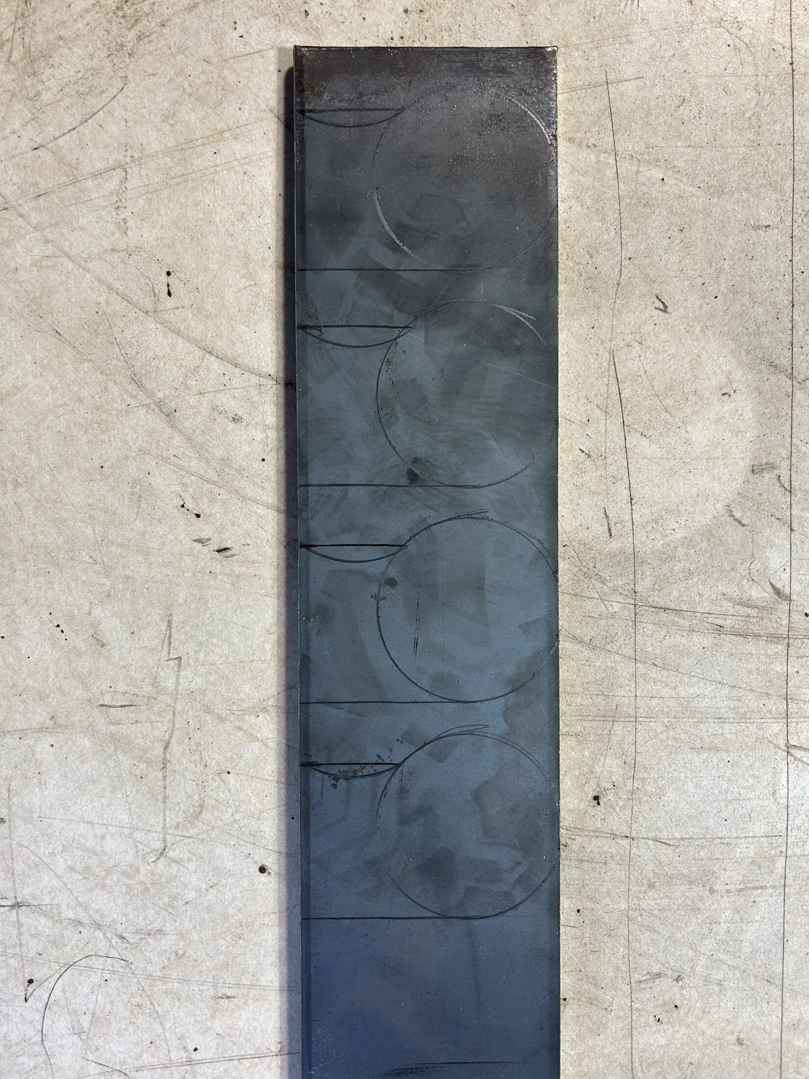

Layed out brackets on 1/4” steel.

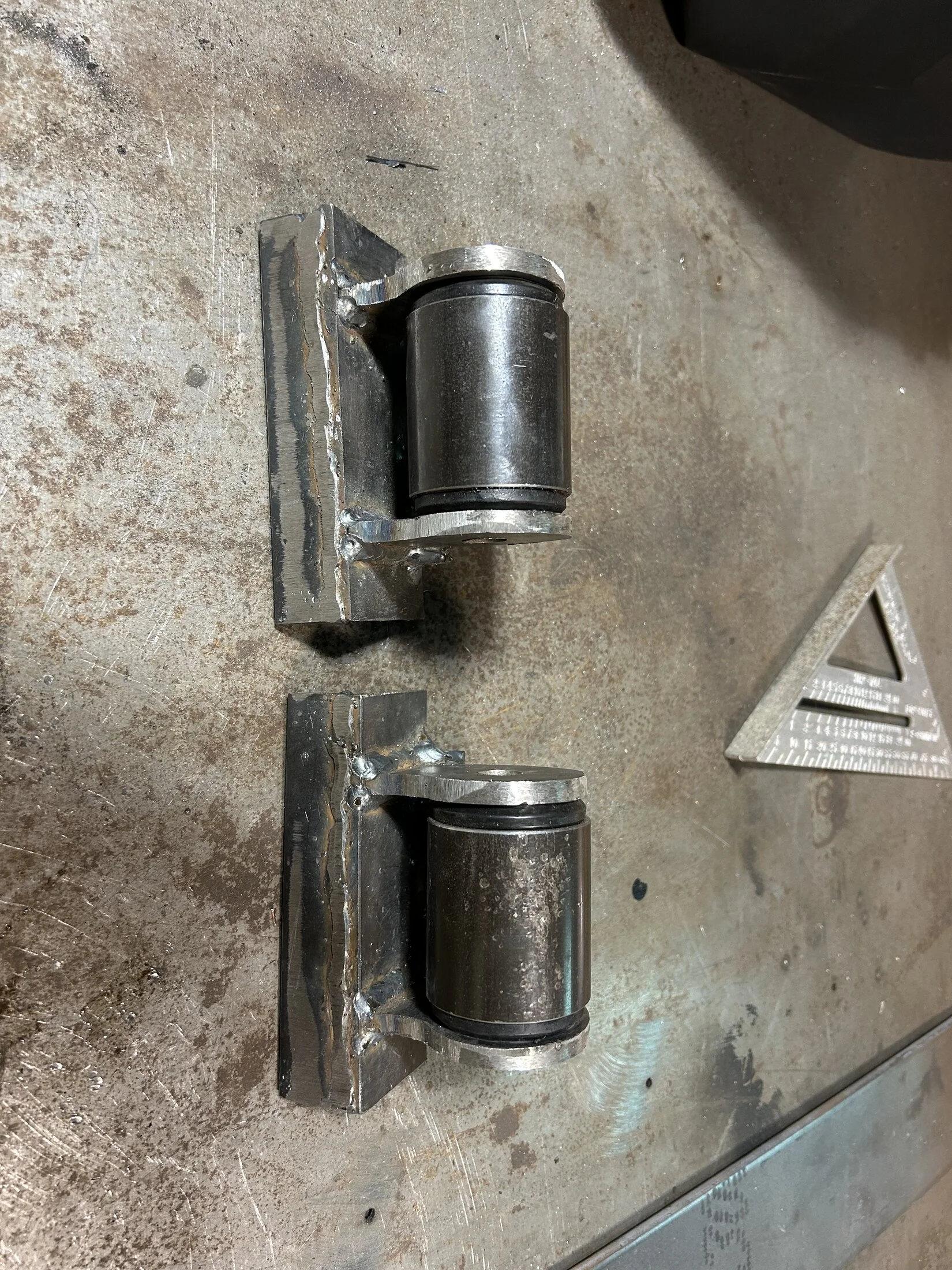

Cut all pieces out and welded them up
Here they are mocked up on the frame rail.

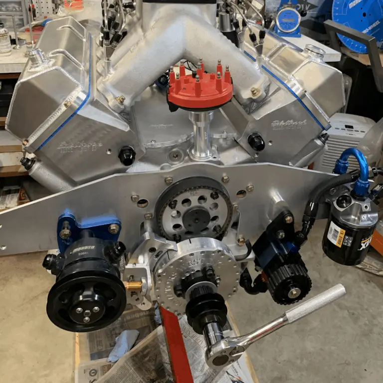

Would stuff like this from Vincent performance help at all?
I know its on a windsor but...
Reactions: Mcmahst
