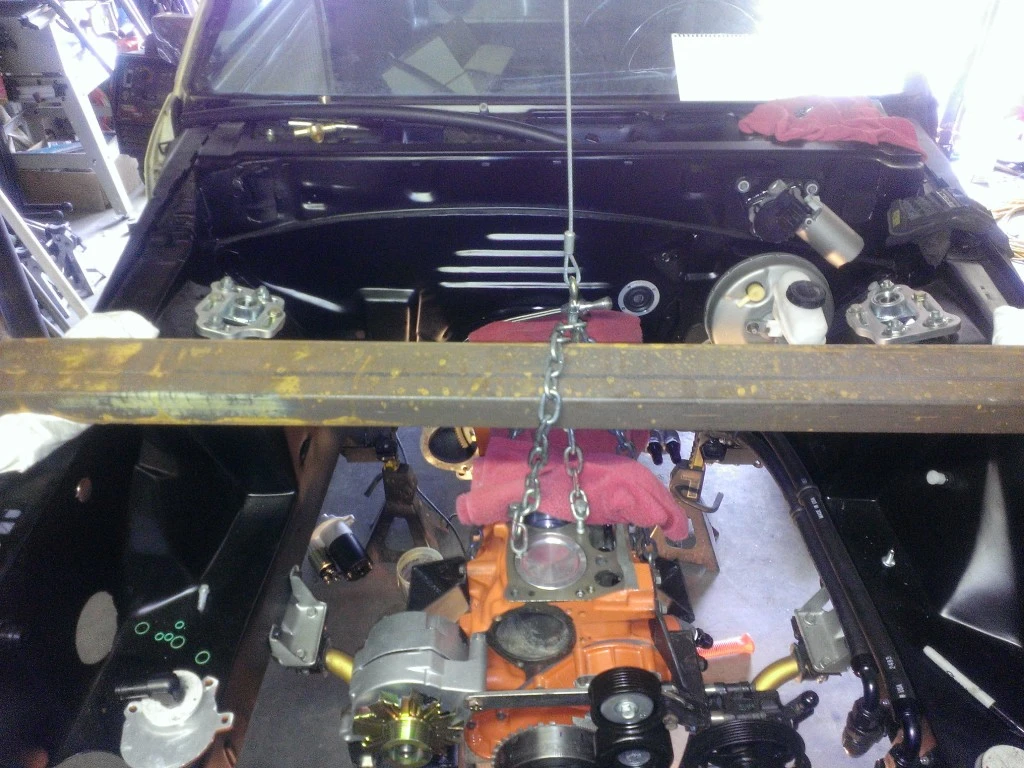

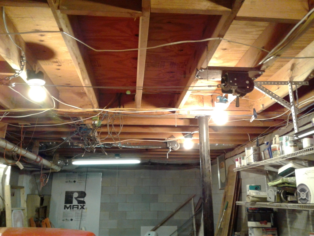

Meh,......100 bucks is all it cost me to put a "No post" lift in my garage..
2 HF boat winches are all it takes to lift the car in the air.... Just the thing when you need to lift something, but don't want the "clutter" of having to deal w/ some post, or apparatus blocking your complete access to the underside of the car.
All it takes is a horizontal span of wood/metal to spread out the lift point load and you'll be doing things you never thought possible before....

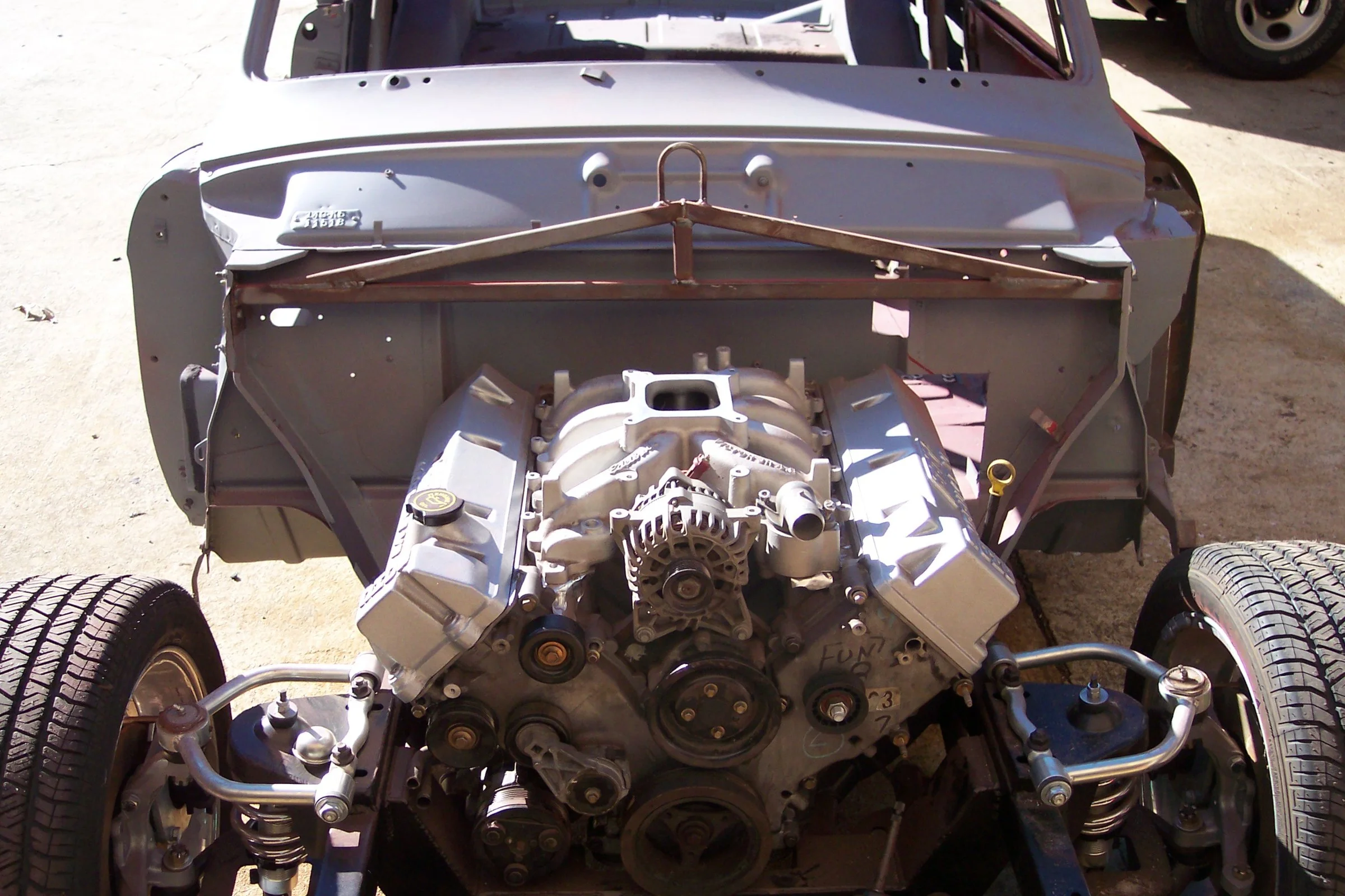

lifting 1953 Studebaker bodies off of their frames, so that you can transfer the body over to a rotisserie:
Then putting it back on the frame, when you decide that street rods are a pain in the ass and sell the car to a guy in Texas...
(anybody recognize the engine?.....where have we seen that thing before?)
Nothing will make your life simpler....Experience the raw terror as you wonder how much additional weight your floor joists can support before you pull either the living room or the guest bedroom floor down on top of your head, while an undetermined weight of an all steel body shell hangs in the air so you can roll the chassis back under the thing.....
You don't need no stinkin 2 or 4 post lift,......All you need are bigger balls and a Harbor freight..:nice:

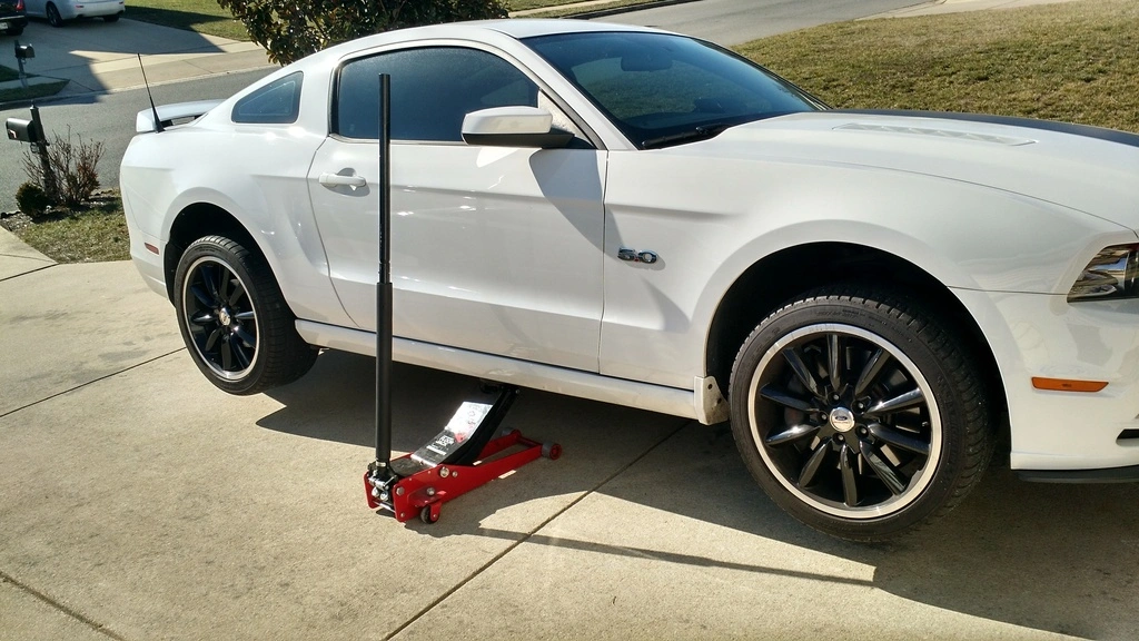

I was interested in a quick jack for a while. I can't put a permanent lift in my garage due to space constraints. I finally found someone that had one at the track. They are great for doing brakes/suspension work. But, you have to crawl under the car from the front or back when it's up which isn't ideal.
I put jacking rails on my 2014. They really make getting the car up on jack stands quick. I can have the car up in just a few minutes. Just jack up a side and throw the stands under, repeat on other side.
I used to do the Fox from front/back and had to have the long low jack etc. If I get another fox, first mod will be jacking rails. So much frigging easier.

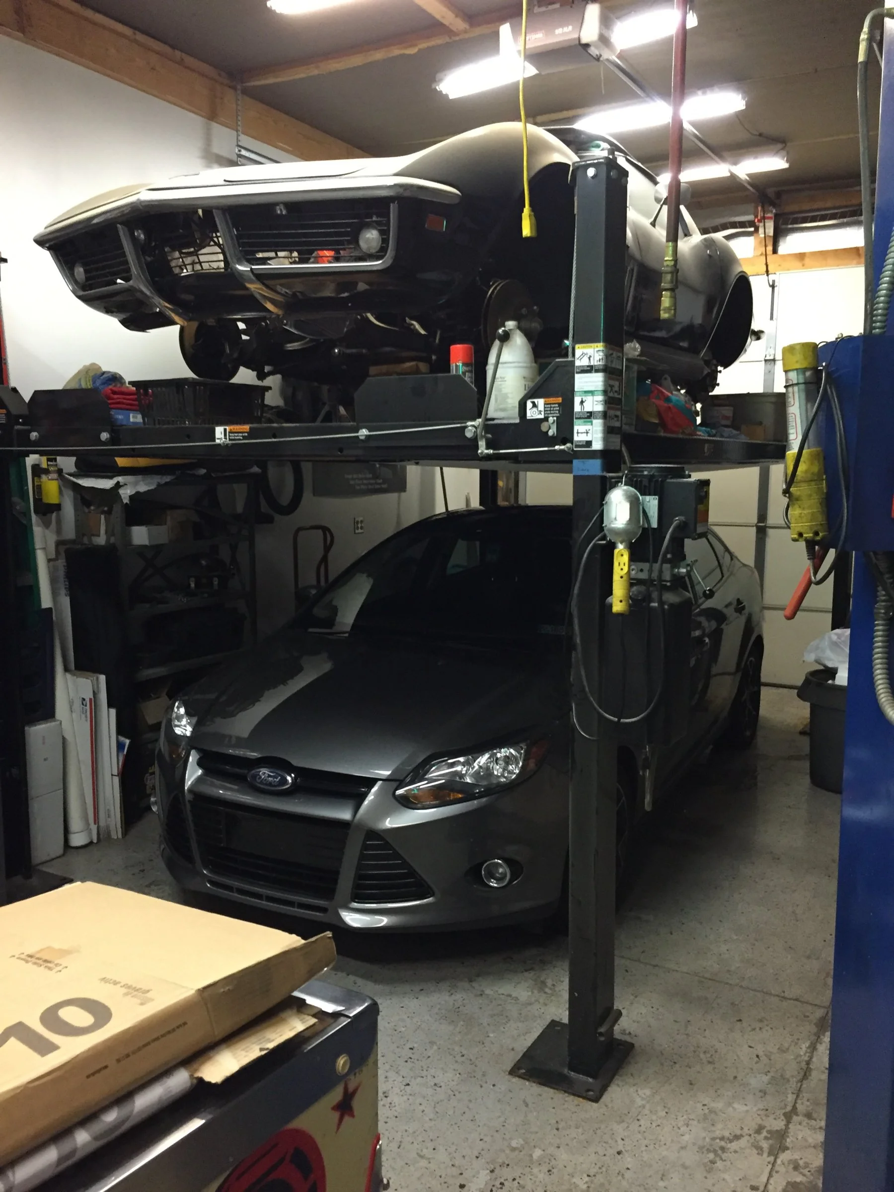

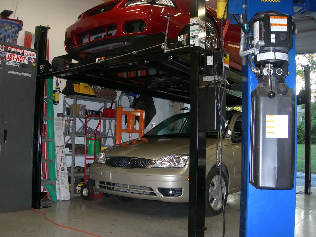

I'd recommend going to a four post lift vs the quick lifts. You're not really getting enough use to make it worth while. 4 posts usually have wheels so you can wheel the car outside your garage too depending on your location/grade. I've had a Direct Lift 4 post for 9-10 years now. It's mostly for storing my friends Vette and my wife's daily parks underneath. So I haven't really used it much to comment but I personally prefer 2 posts which is what I use for my general lift duty. (Bend Pak Asym.) You don't have to drill for the 4 post.
4 Post also give you place to store crap. Which I guess could be a negative too.
This is the 4 post I have minus extra length. I got it for around 2200 from Greg Smith back then. A little more than you want but it's worth it.
I agree 4 post. Anyone know anything about that brand. I want something trustworthy if I'm going to be under it working. Or if I park another car under it.
Just helped a friend install his new Atlas Garage Pro which is identical to the DL one I put in 10 years ago. Not too much has changed, but the price if you can pick up is 2195. It took 4 of us to remove the ram ramp and took 3-4 hours putting it together. If you don't want the extra height one, you can pick it up in store for 1999. Pretty good deal. Fortunately we were able to pick up in Delaware which has no tax.
