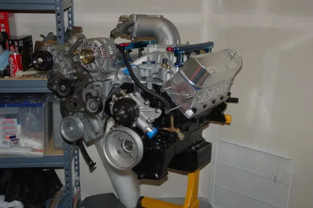

On stand with Old S-trim mocked up.

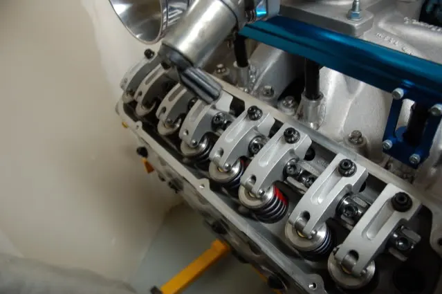

Rockers

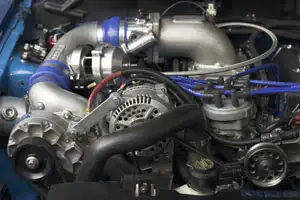

In car with YSi

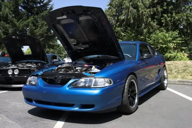

With holes in the hood to clear... Tried my best to fit it under a stock hood... Almost made it.
At the Mustang Roundup 2008

anymore details on what it is? heads/cam/inj etc.
410w non roller converted to roller (Link bar lifters)
All forged
Mild Comp supercharger cam (I forget the specs... would have to find my cam card)
Trick flow Highport Race CNC heads 225cc , 70cc combustion chambers
Custom Jesel Pro Series rockers with a 1.8 ratio (To make up for the mild cam)
Spyder intake with A LOT of porting to mate up to the Highports
60lb injectors with a full fuel system
Etc...

The SQ-trim was on their briefly for mock up but i never ran it. The YSi was in the works since the beginning of the build. I was advised by a reputable tuner that a S-trim would not feed the 410 all that well and would be pushing its efficiency range just to make any real boost. Whereupon he sold me a YSi...
Quite the upsell... lol.
However, i am super happy with the big head unit and it's not a lazy blower like some say.
