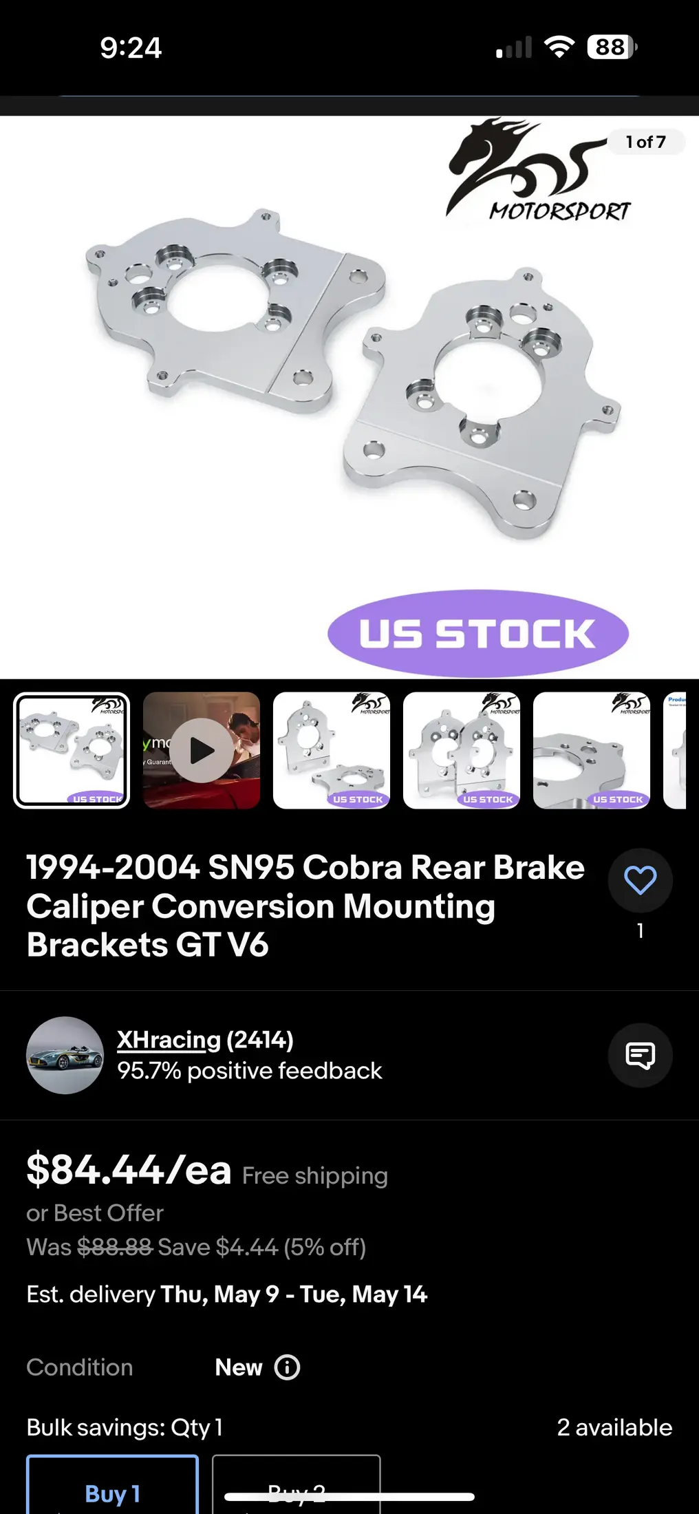

Or the cheaper LMR kit. The difference being the axle brackets in the Ford kit are cast iron, and the LMR brackets (which are sold on eBay for under $100 by a Chinese vendor) are aluminum. Also no rotors

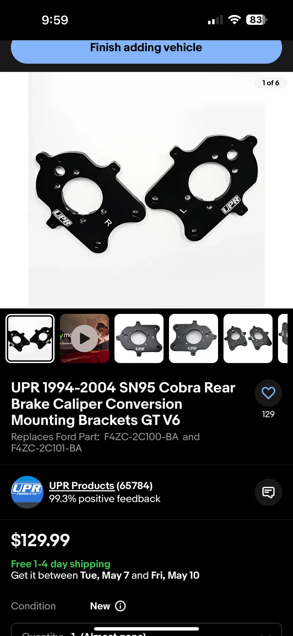

I have the same thoughts. Might be overblown, but I have no data to say if it’s a good idea or not. Lots of aftermarket rear big brake kits use aluminum adapter brackets.
Since you already have rotors, dust shields and hardware, you can simplify further.
The rear cobra brackets (aluminum) all over eBay for cheap.
Or the UPR ones
The the anti-moans are optional. You can try it without them, and if you have moaning, add them later

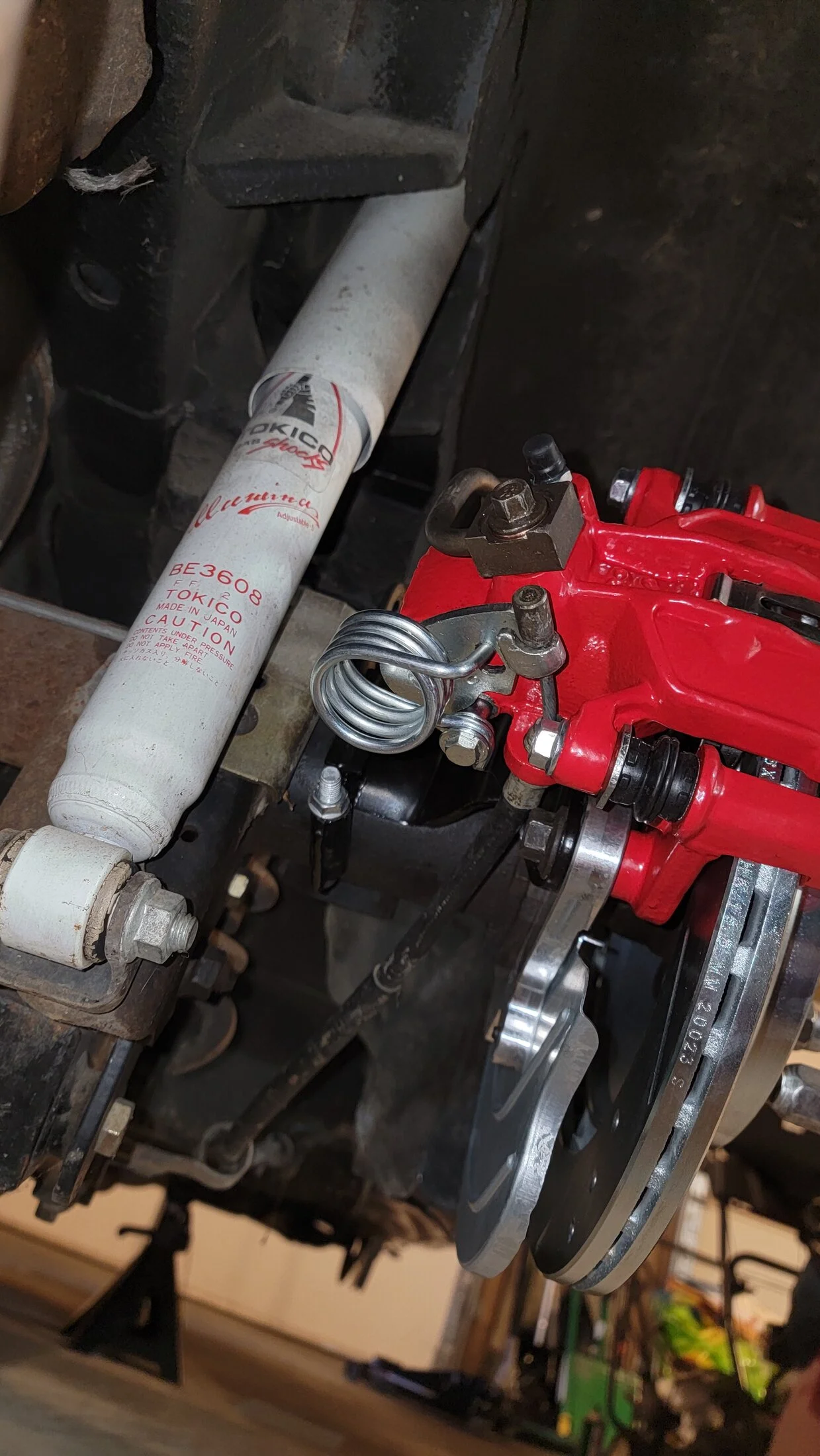

I went down to finish up the job this morning, I left the parking brake cables for last thinking it would be a 10 minute job. It seems like I have to cut a notch in the moan brackets now so the cables can fit.. is this normal? Or am I doing something wrong here? I needed to pull some slack out so they would reach, they reach the hole but can't go in because they hit the brackets.
From another thread:
Shaolin Crane said:
E brake cables, there is a possibility that you can re use your factory e brake cables by relocating the brackets so they dont make contact with the wheels, what i did was buy some steel zip ties and attach the brake cable to the calipers and zip tie the loose part of the cable to the lower control arms, then relocate the bracket by drilling 2 holes one for the screw and one for the retaining fold (you'll see what i mean when you get down there) if you go this route you do not need to modify your e brake cable, now this isnt guaranteed to work(worked on my 88 but not my 87)
Reactions: DeathProof88

Well, I feel dumb..I had the moan brackets on the wrong side.
