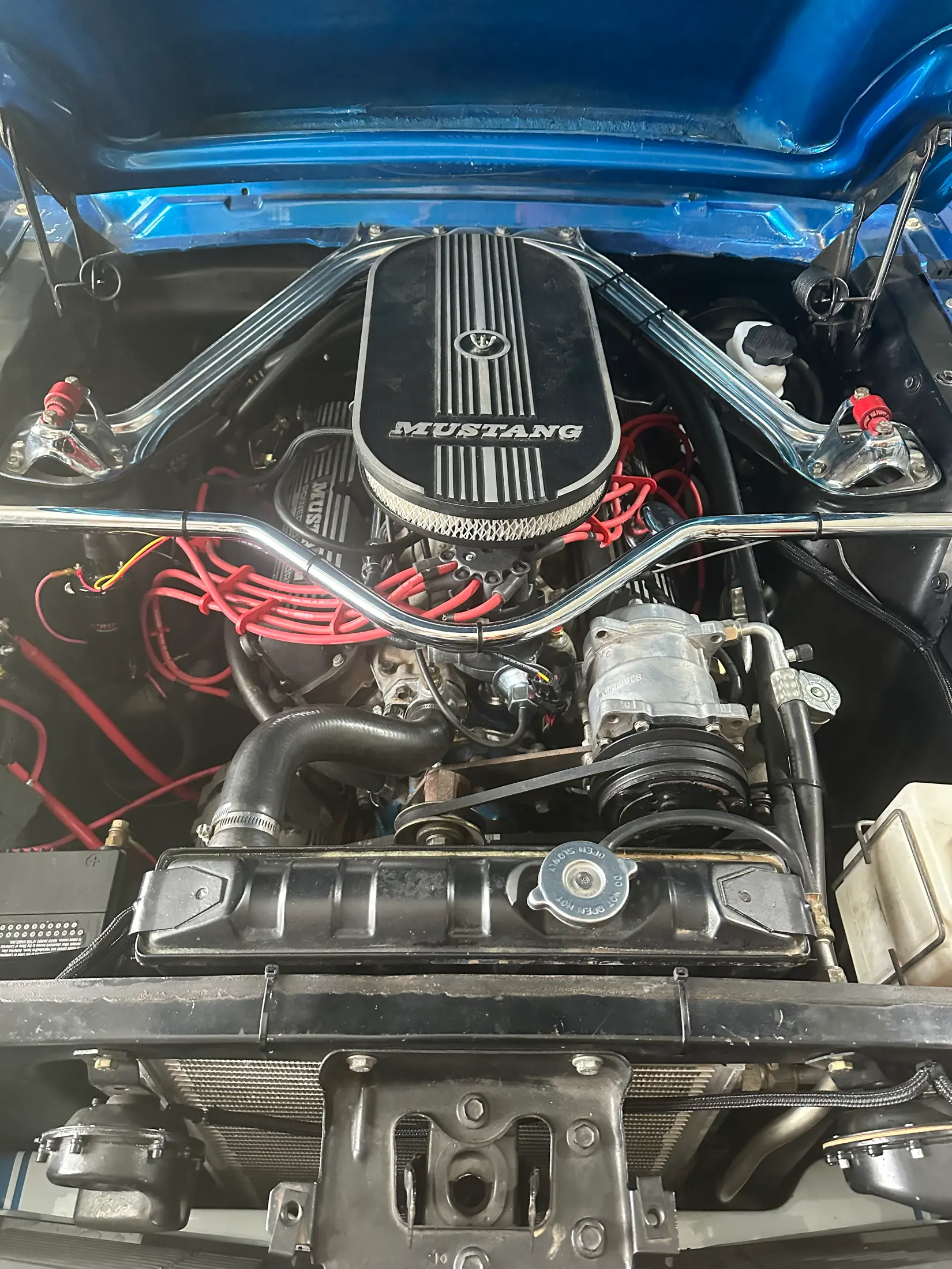

10 * set and 25 all in is a little weak IMO, see if the vacuum rises at 12* idling.
Post a pic of the engine showing distributor and carb detail please.

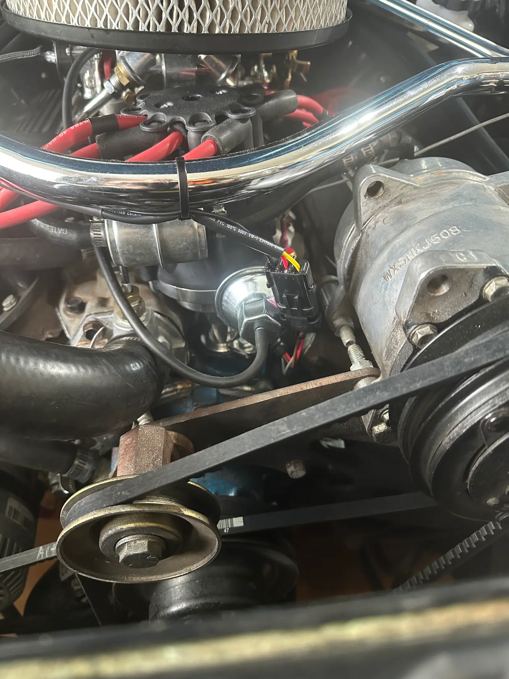

I'll get more later. Temp gauge sensor in water neck bung. Fan on/off sensor behind distributer in manifold. Moved coil off of engine to the pass side shock tower. I will say that the carb is black from it running rich for so long.
