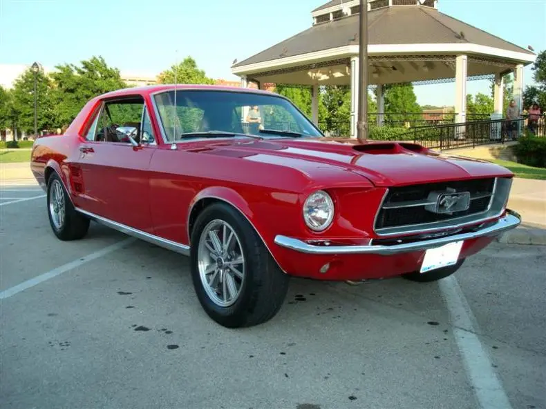

Two things... this is an update on the car... been a WHILE. Got it inspected, insured and started driving it see if anything showed up. So far, nothing except what I need help on...
This is a EFI converted and it is falling on its face right off idle. It backfires and fires in the exhaust, and just runs bad right off idle. I have a feeling the injectors need help, but I am open to anything.
Thanks for the help and enjoy the pics.
