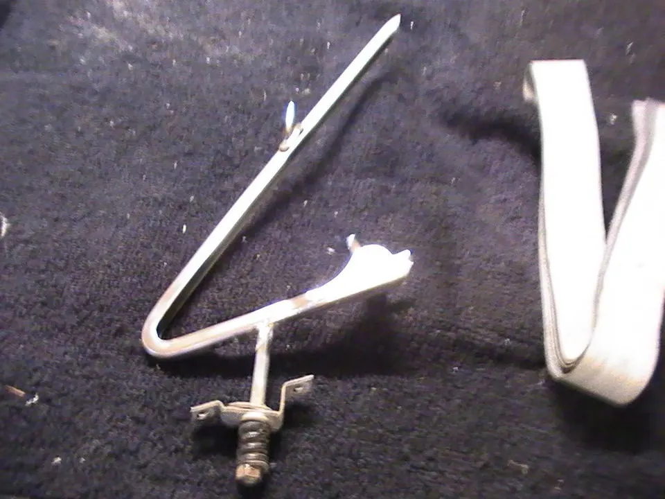

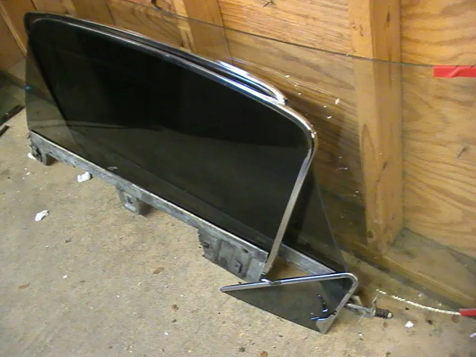

I took the door glass to have it installed to a local glass company who gave me a good price. When I arrived with the glass and the frames with the old glass already removed, they agreed on the price of $20 for each piece. I talked with the installer and asked him to protect the pieces as this is an old car. The installer said "That is off of and old Mustang, isn't it?"
I left there impressed and felt assured that everything was OK. You could image how I felt the next day when I called and they said that he had broken one of the pieces. He broke the lower swivel pin off the driver side vent window.
Long story short, they offered me a $20 refund at their main office. I was asking them to pay for a replacement piece. While giving me the refund the lady said "You got a good price!" Then it hit me. The old saying of "You will remember the poor quality long after the low price is forgotten."
I fixed it with Silver solder, flux and buffing. Tried to break it back off. That thing is not going anywhere. I will finish the glass install myself.

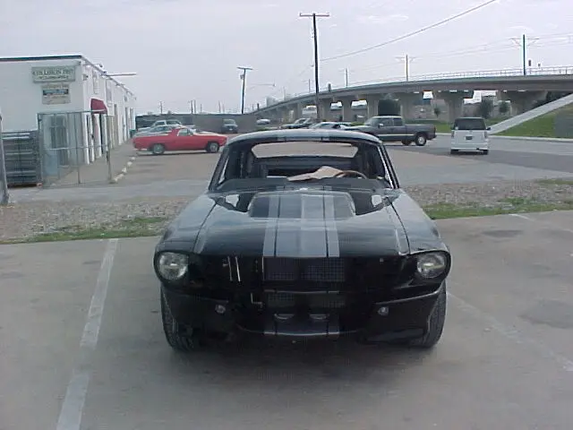

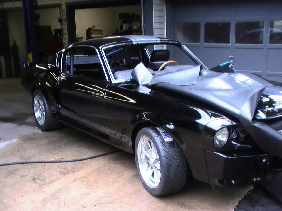

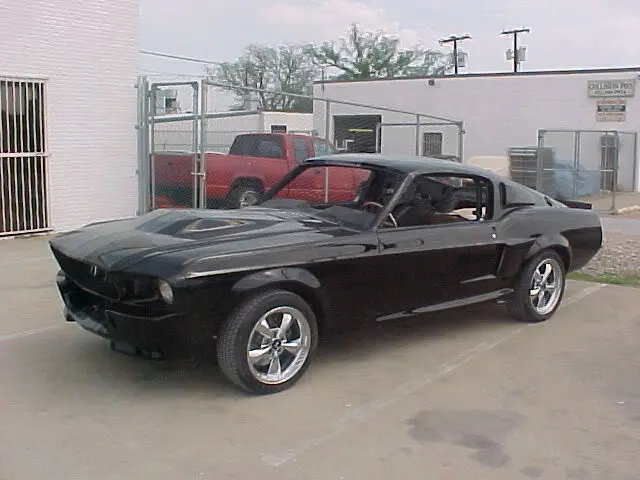

Well, 15 days later and it is still not finished!!!!!
Only things left are the GT500E Stripes, driver door handle, rear light panel (I was told it was being installed as we were talking), rear quarter panels (shouldn't take long, I know they are finished but might not be painted), and the rear bumper.

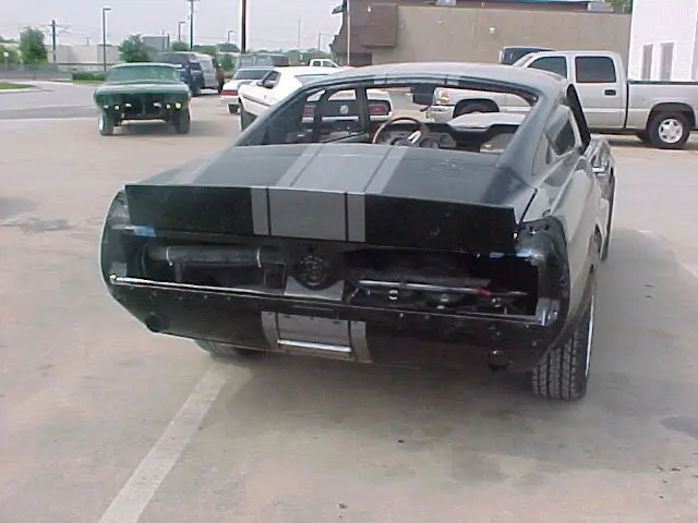

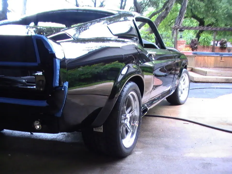

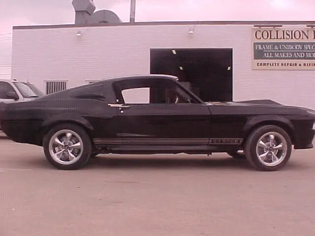

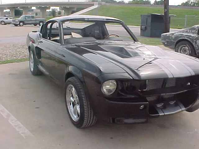

GT500E stripes are on!
I was told (you know how that goes) this AM 4/23, that the car would be delivered to me on Wednesday.
He has to buff the GT stripe area, paint the inside of the doors, put on the rear tail panel, end caps, bumper (supposedly all painted and striped, funny how I am not seeing pictures of that area) and driver side door handle.

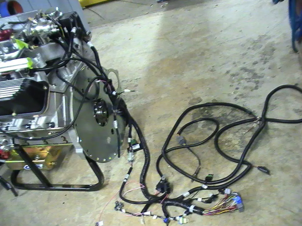

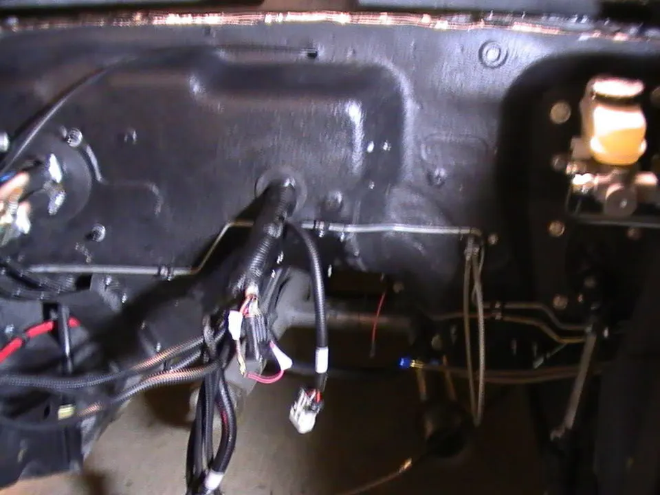

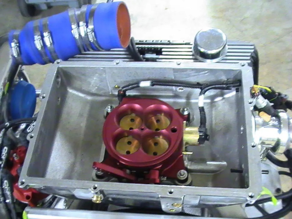

A pic of the throttle body & EFI Harness. Harness looks pretty intimidating at first. But once you go over the connections a few times, it is pretty straight forward. There is just a lot of it!

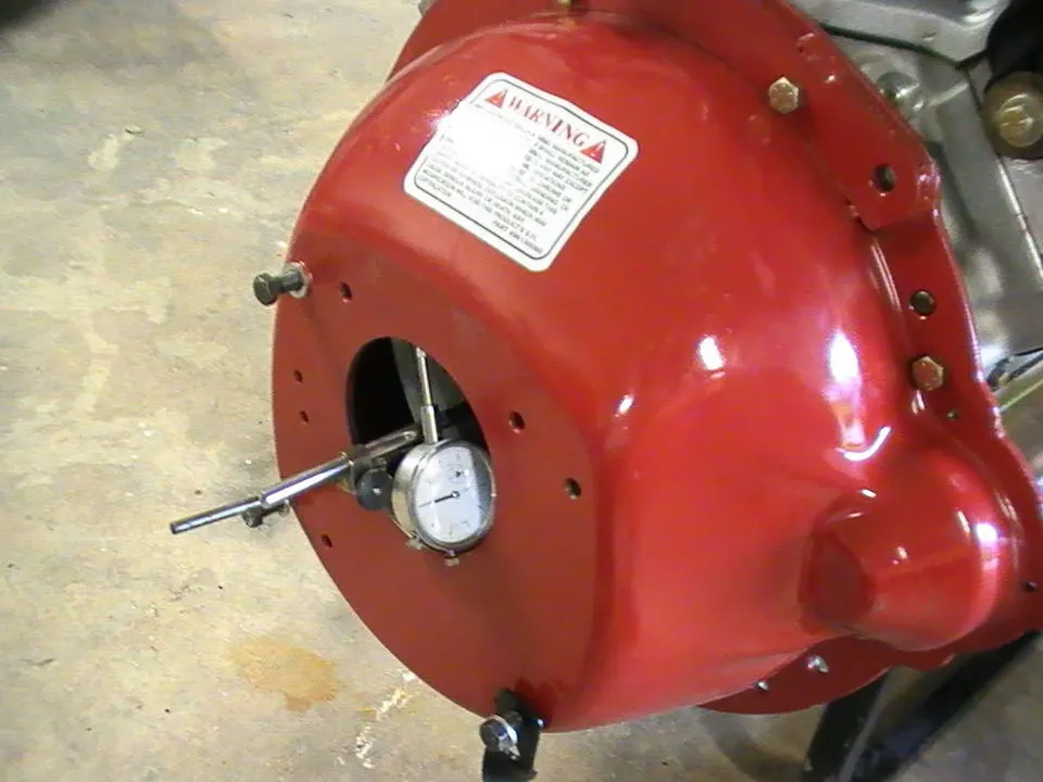

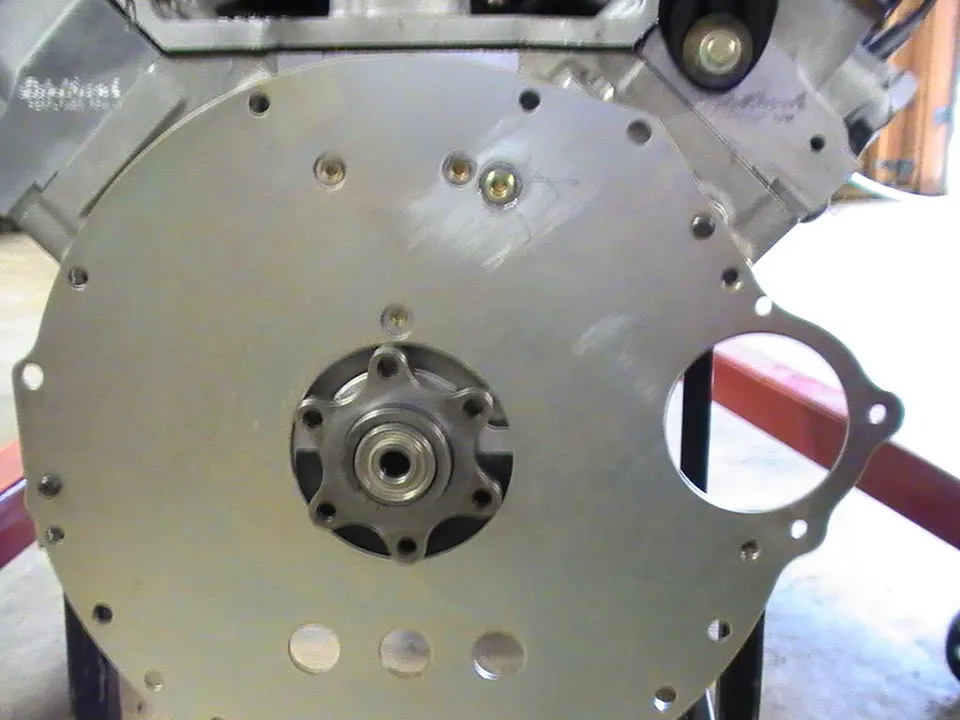

I installed the backing plate. Had to drill out a hole where Keith Craft put in a plug that was sticking out.

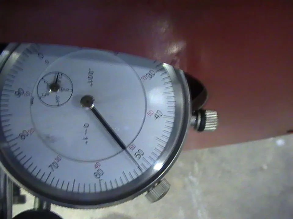

Then I installed the bell Housing without the clutch or pressure plate to check the transmission centerline alignment. Good thing I did. I will have to replace the dowel pins with offset dowel pins. It was .050 total off. Divided by two (center) and I need the .025 (closest .021) pins.
If you do not do this procedure, you can have "pilot bearing wear, main shaft bearing wear, difficulty in shifting, and in extreme cases breakage of transmission gears and cases".

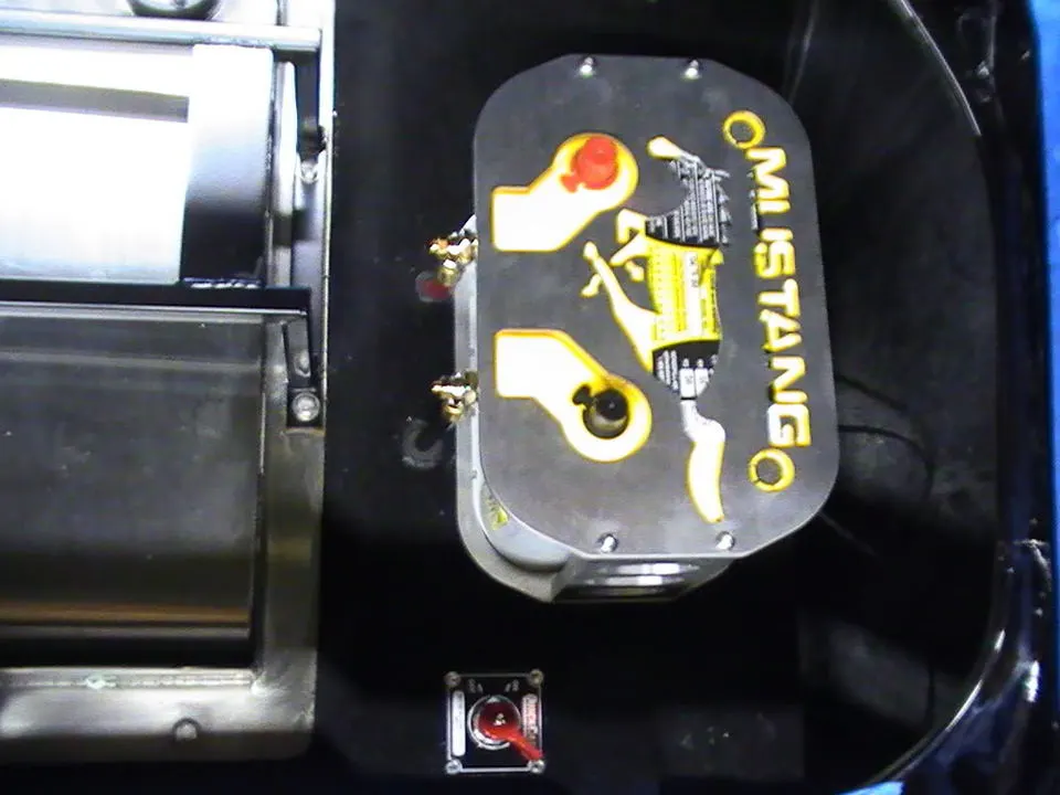

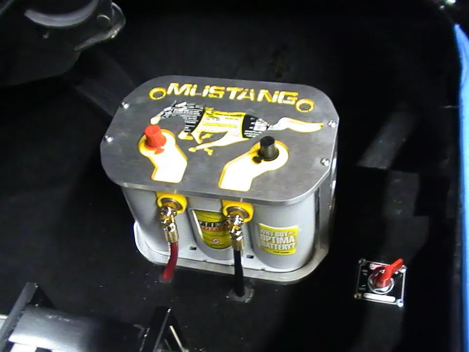

I installed the battery box and remote disconnect, and got them wired.

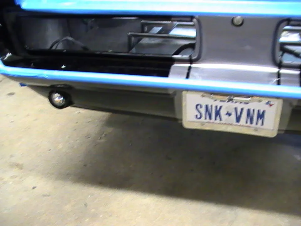

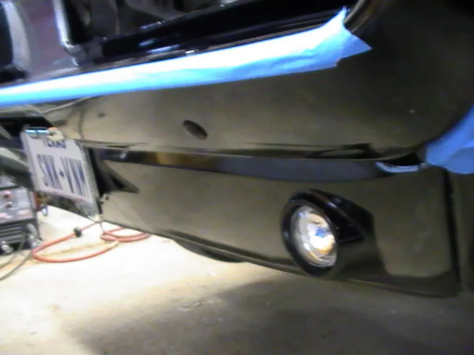

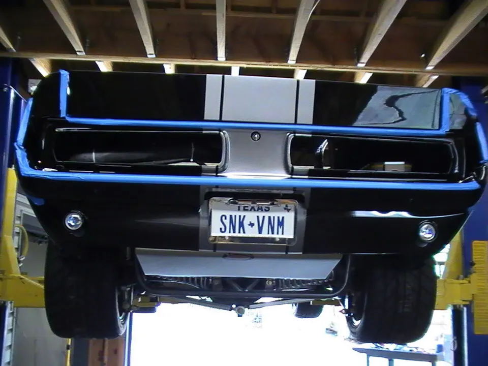

I once was told that Unique Performance "glues" the PIAA backup lights in the rear valance. They can be mounted using the included brackets very easily.

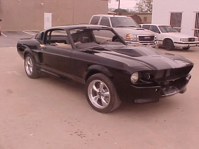

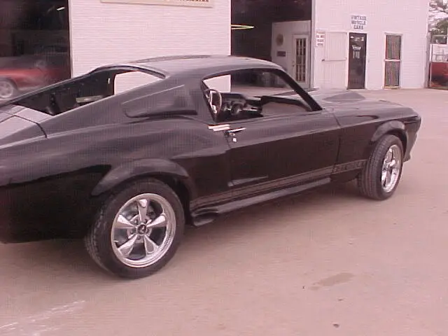

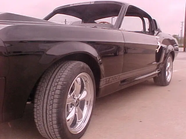

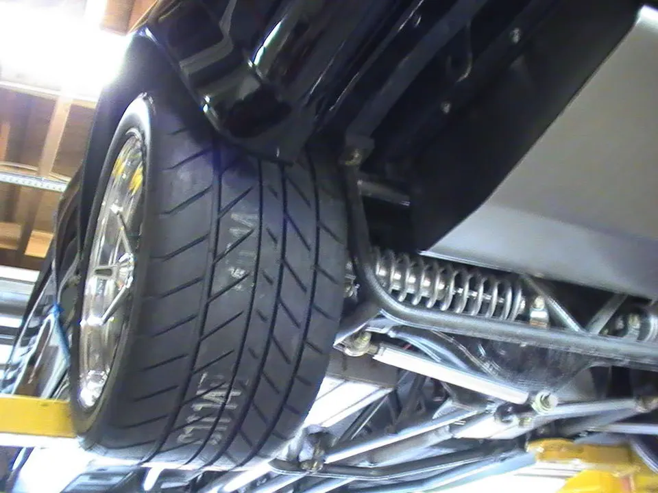

Wheels & Tires

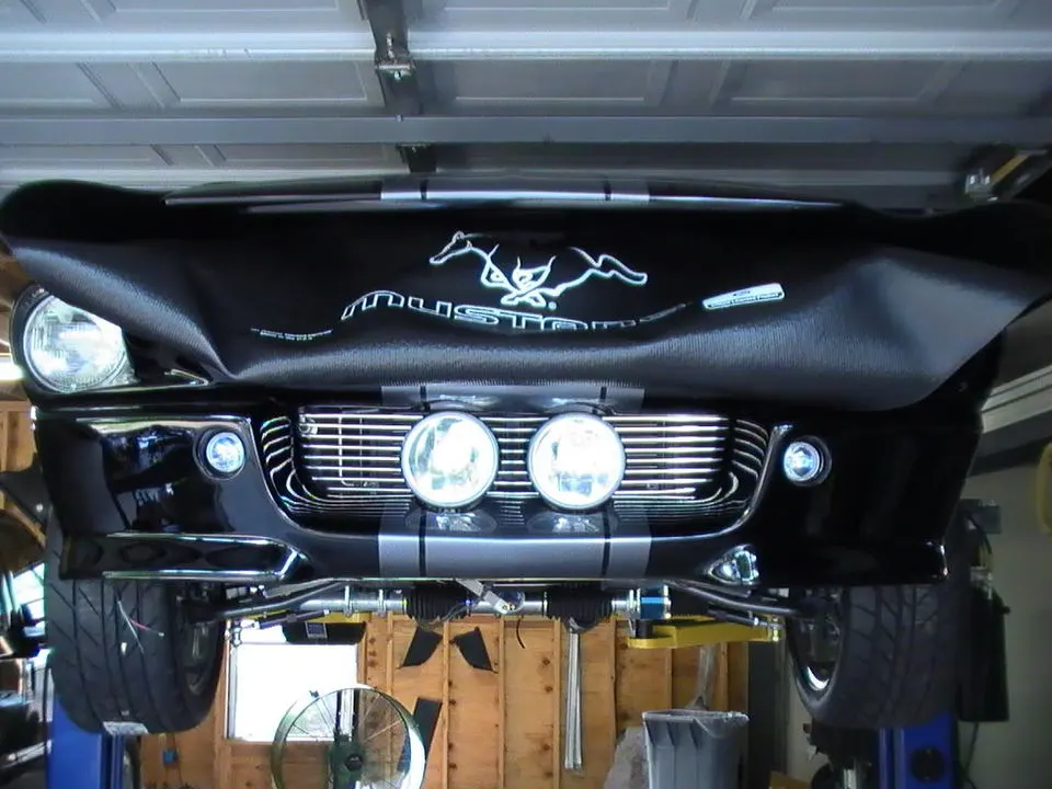

Wheels & Tires mounted. And a little more....

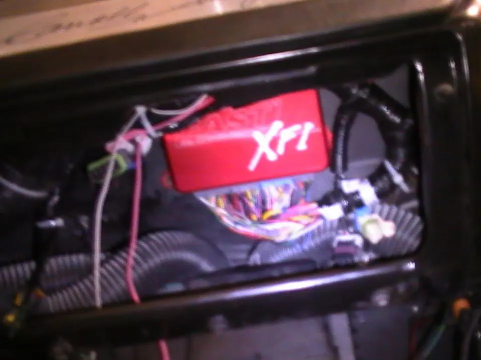

XFI Installation

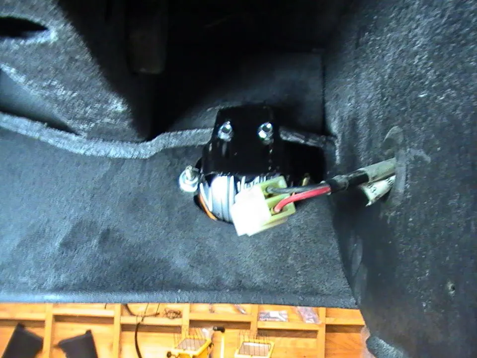

Installed the FAST XFI box behind the glove box. it fits pretty well back there. Along with all that electrical harness. I also Cut a hole in the firewall for the wiring.
And I finished the alarm system mounting, but not all the final electrical connections. For an old man like me, all that bending over, laying upside down, under the dash is tough!

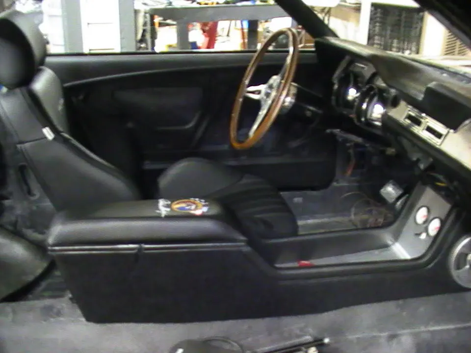

Shelby Center Console
geostang351 said:
Where did you get that center console from? Did you have to modify it to fit those gauges in?
Looks great!
The gauge mounting holes were already there and fit perfectly. I purchased the console through Unique Performance. But I would rather have a non GT500E console than to deal with UP again.
