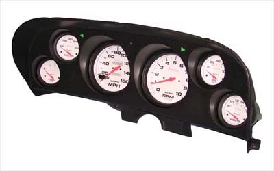

Thats what I had in mind. Similar to the JME part but made from sheetmetal. Room for speedo and Tach in the center, with maybe 4 smaller guages outside. Look at the JME part for the configuration. I have an extra bezel I could send for the screw hole pattern and size measurements. Let me know what you think.
That would be interesting, but it would be flat for the most part.
The JME dash retains the stock look with the compatibility of using Autometer gauges and having a few extra gauges. Is the flat, sheetmetal, NASCAR-esque type dash that bolts into the stock location what you had in mind?
Dave

*Just a little update for all those interested*
I received the old, faded bezel from Clark in the mail on Monday and I talked to Jeff and we'll be meeting up probably Monday, after the holiday weekend, so he can take delivery of the bezel and get to work on it. I'll also be giving him the measurements of the center A/C vent in the dash to get a gauge pod in there.
More updates to come. Feel free to PM me, contact me on AIM, or post here for any questions, comments, rants, and raves.
Dave

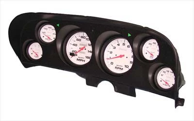

Here is my update.
The main design is finished. All the numbers are in. Problems, the edges are flat, if I hem (roll over) the edges, it will look alot clear but the bottom corners won't be clean. I can also fillet (radius) the edges to give a smother look through out the entire part.
I'm currently working on the setup with 2 guages setup. This parts is a lil more difficult since there are viewing angles and shifter interferance to factor in.
