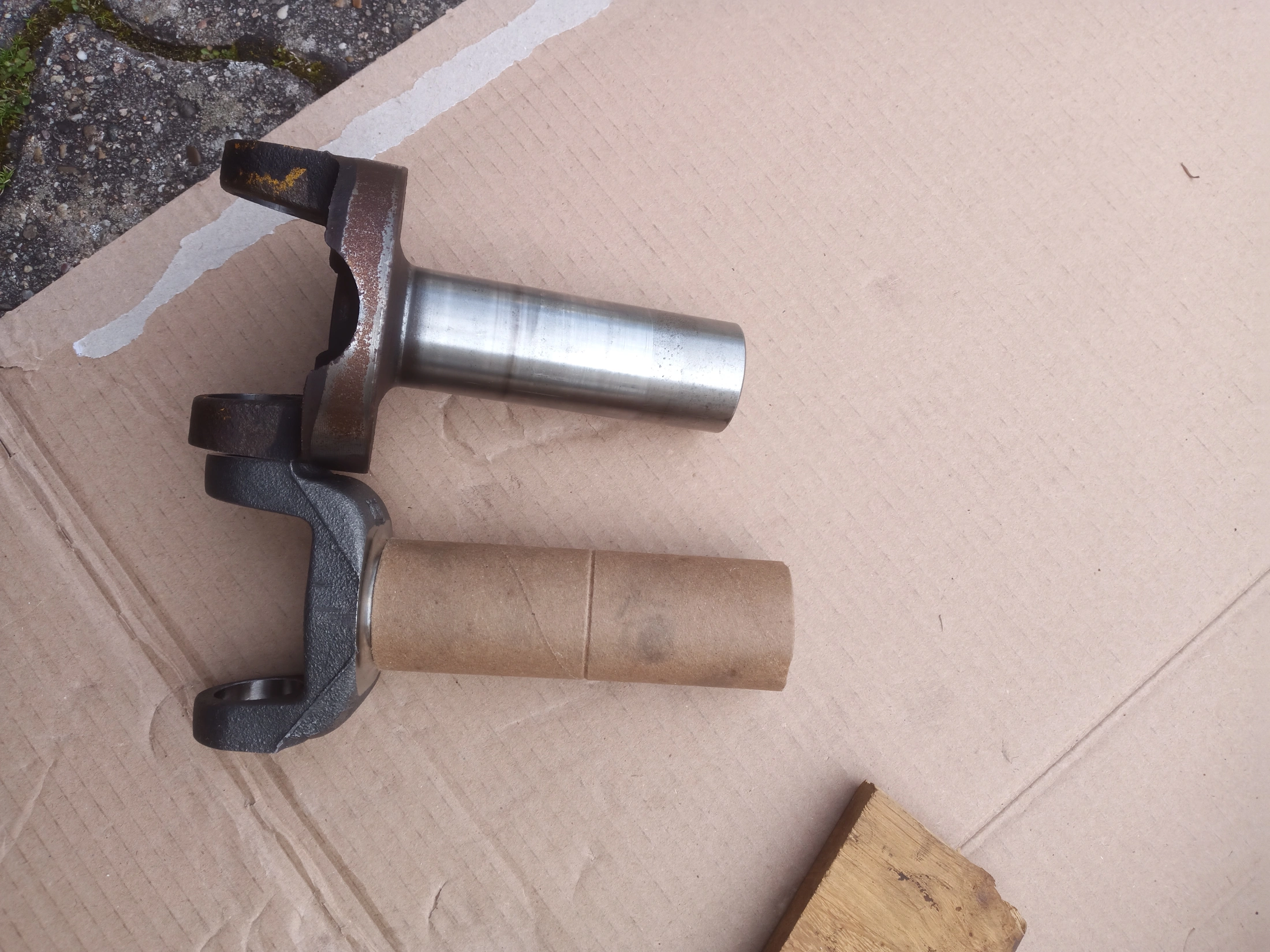

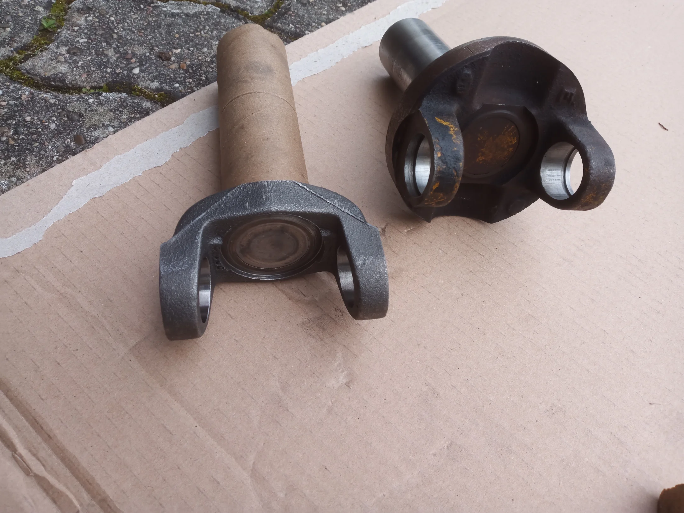

The slip yoke is a little longer than the stock one. And because it doesn't have the damper element its more slim the the stock one. Which is good because it reduces rotational mass (better response). But it fits.

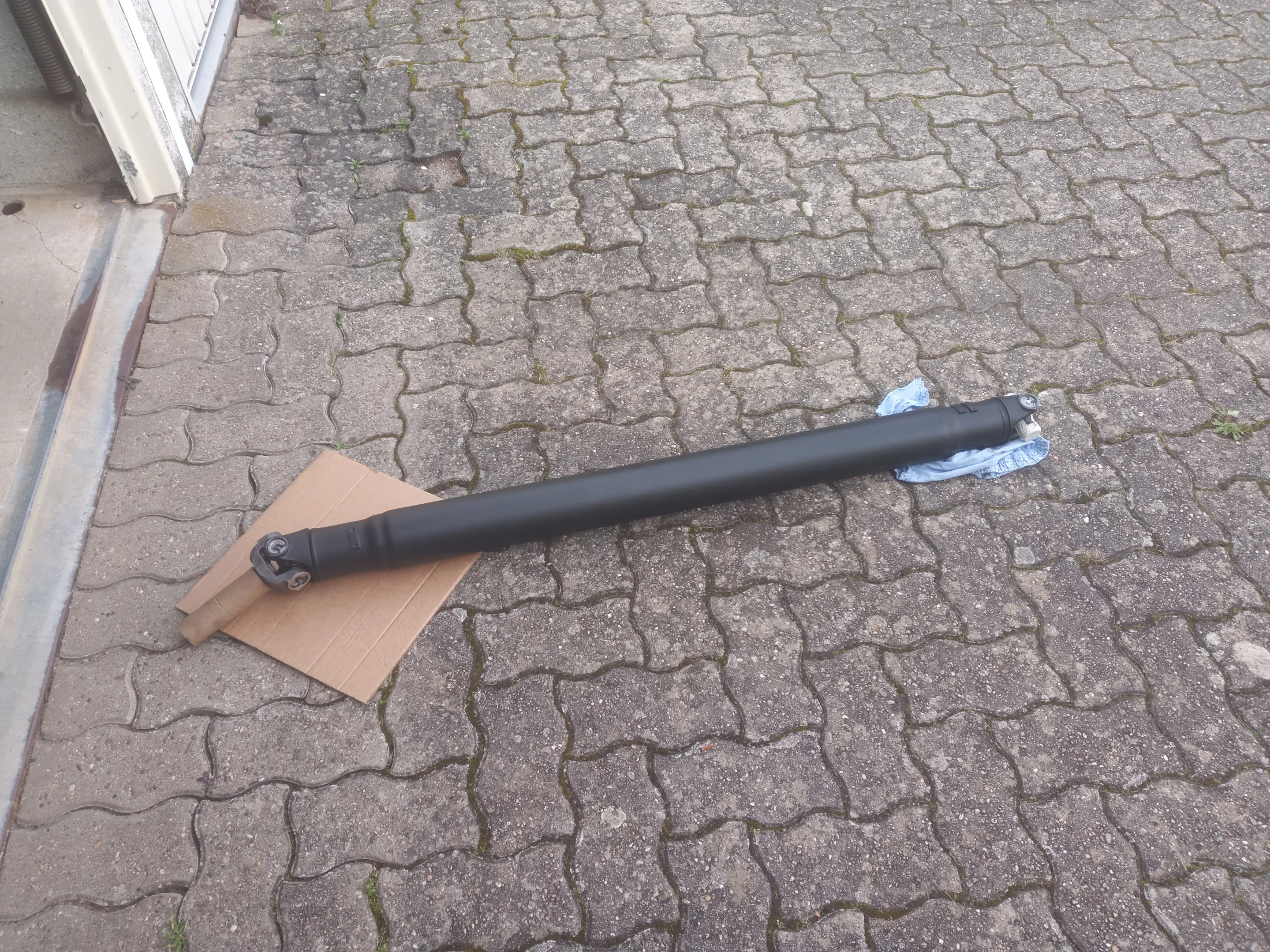

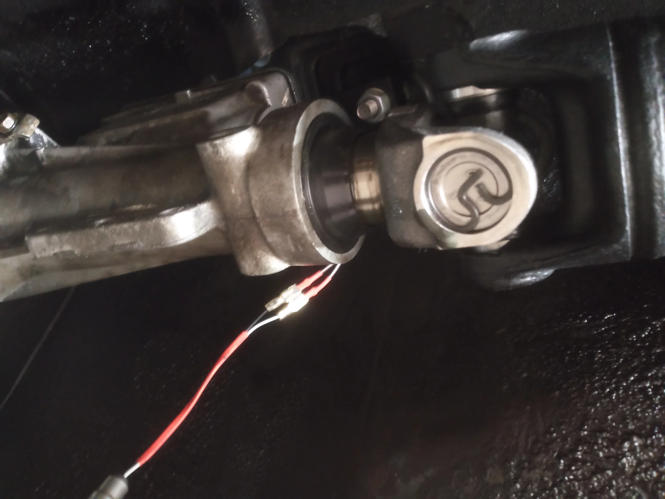

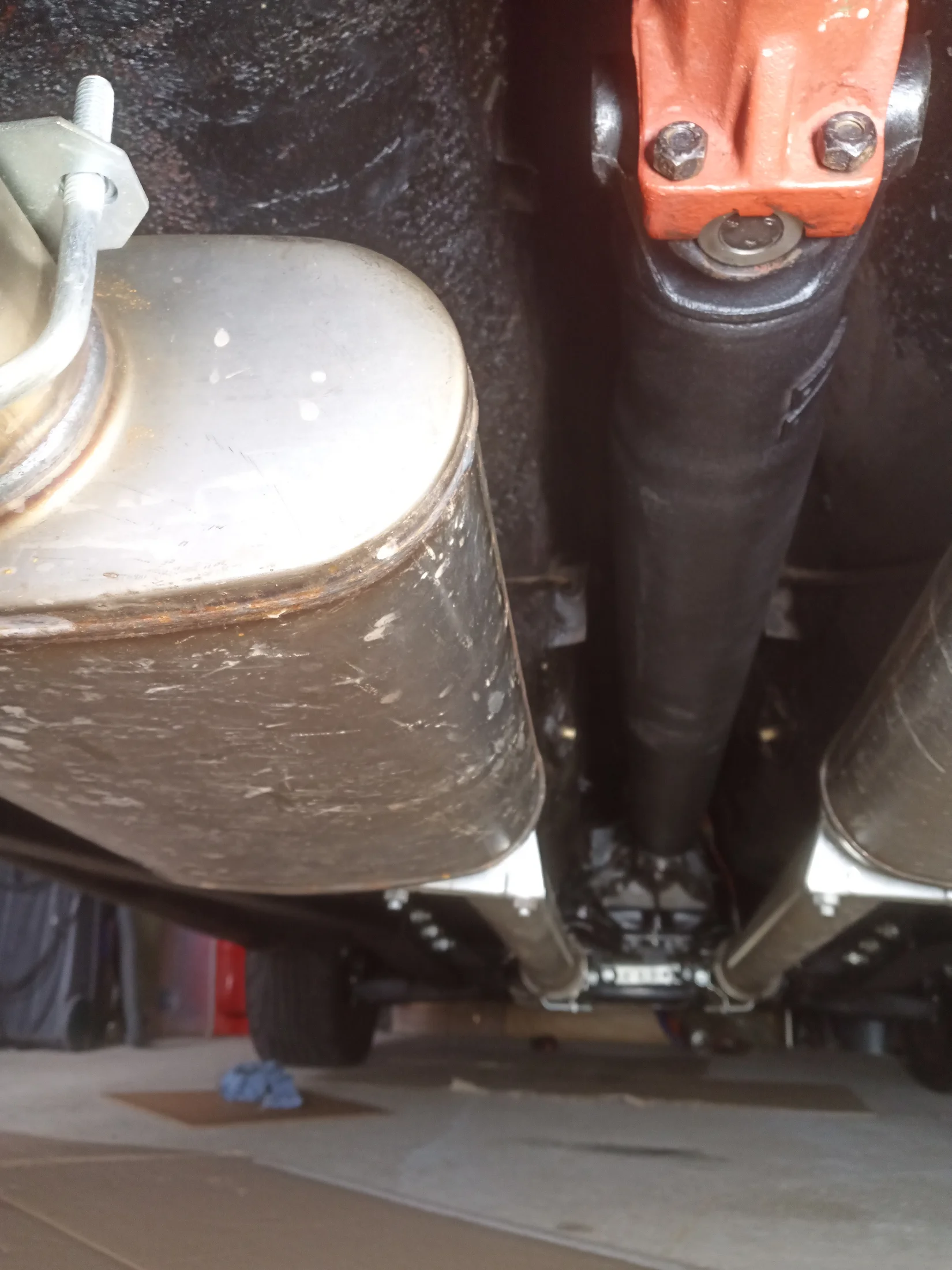

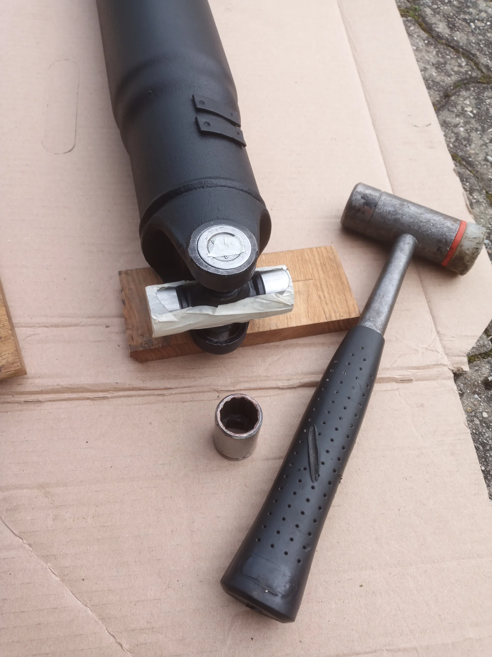

The second important thing in the interwebz beside talking BS in forums: pictures of big long and stiff shafts!
And just to get it right: @2Blue2 asked for this kind of pictures...
Here a comparison of the old original yoke (with removed damper) and the new one from dana spicer
