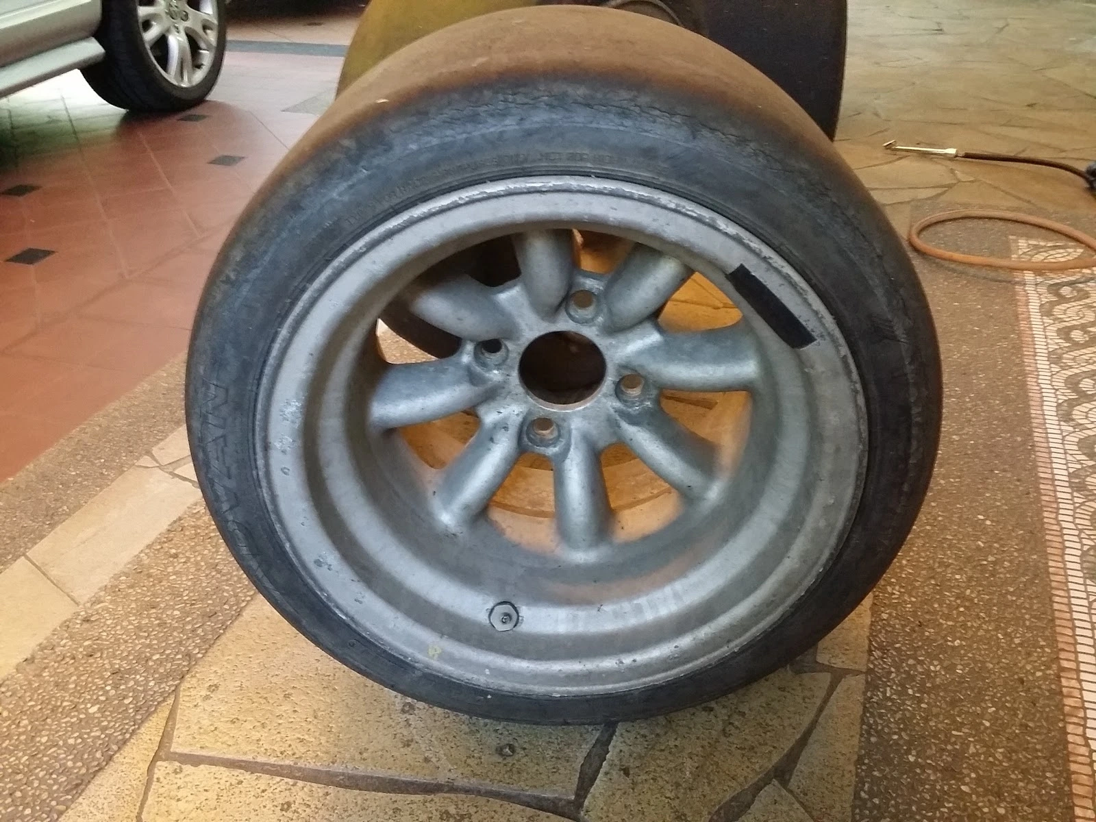

I found some steel wheels from an modern french car
I kind of like these. Especially if you could do trim rings and dog dish hubcaps. would like to see them at 7 inches wide though.
Once you convert to 5 lug then the choices for 15 inch rims and tires ~ the world is your oyster.
Those black wheels with trim rings and a nice center cap would look good imo. The trick is finding the rings and a cap to work with them. Depending on the size of the center hole, you may be able to find something to protrude through there and use chrome lug nuts, that may not be too bad?

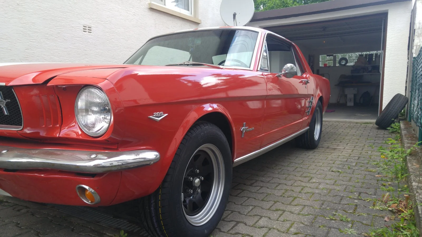

My personal opinion on the Cragars - I don't like them. They just look weird to me with 4 lugs and spokes....
On my 66 the new steel wheels came in a silver paint. I painted the middel section black and used chrome lug nuts. I like that style very much. But its a 15x7 with about 4' backspacing. That wheel fits with an 225/60 R15 awesome to that car.
From what i read here in this forum this size of wheel fit also very well to the Mustang II, but they aren't available with 4 lugs...
I think i will go the "french wheels meet american car" route even if they are just 5.5 wide (that the only downside for me). There are so many tires available in 195/50R15 and perhaps i choose some winter tires that perform also very well in rain.
Then i have the option to run 205/60R13 Toyo r888r semi slicks on the cragars for summer :cool:

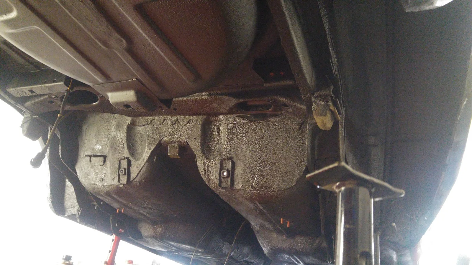

Here is the finished unterbody 90% of the unterbody protection is the original one, that was refreshed with the fluid film product

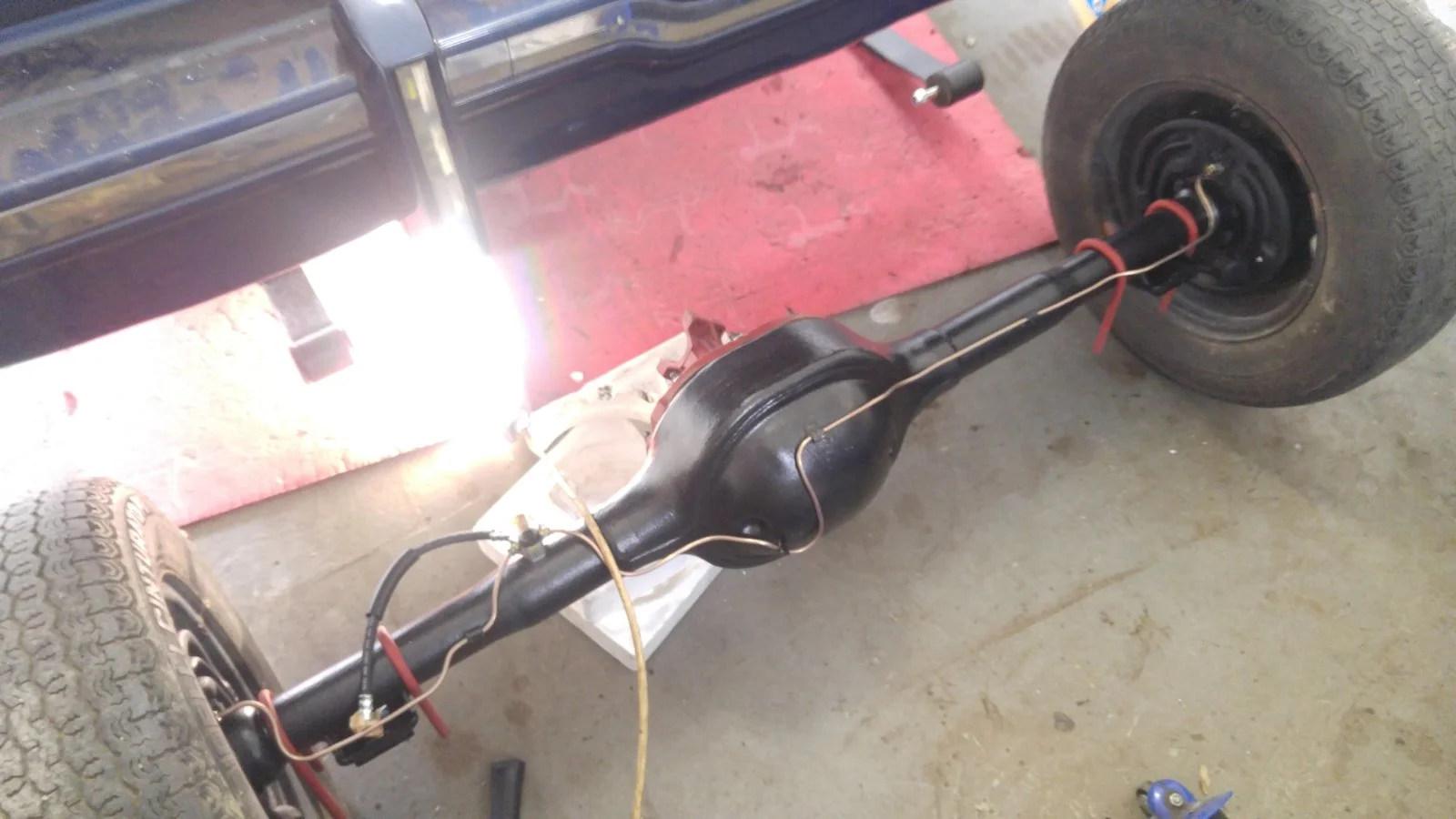

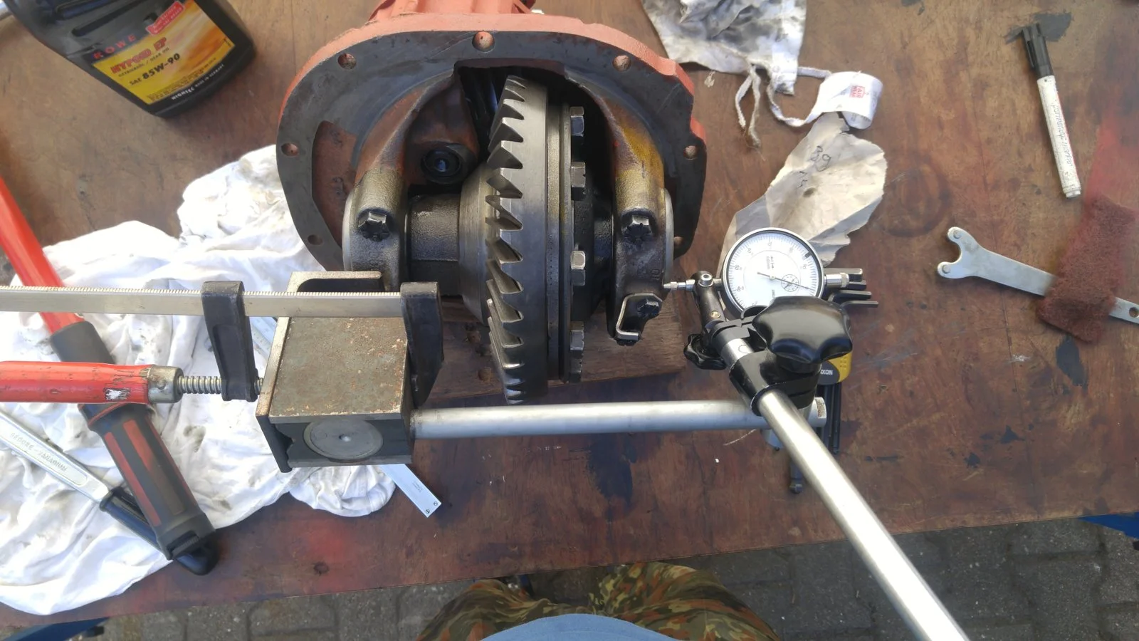

Here is a picture from rebuilding the 3rd member (It has the 2.78 ratio from my 66 Mustang, which should work very well with the small tire diameter and the T5 tranny)
Here is the rebuild rear end (i like the look of the cunifer brake lines very much)

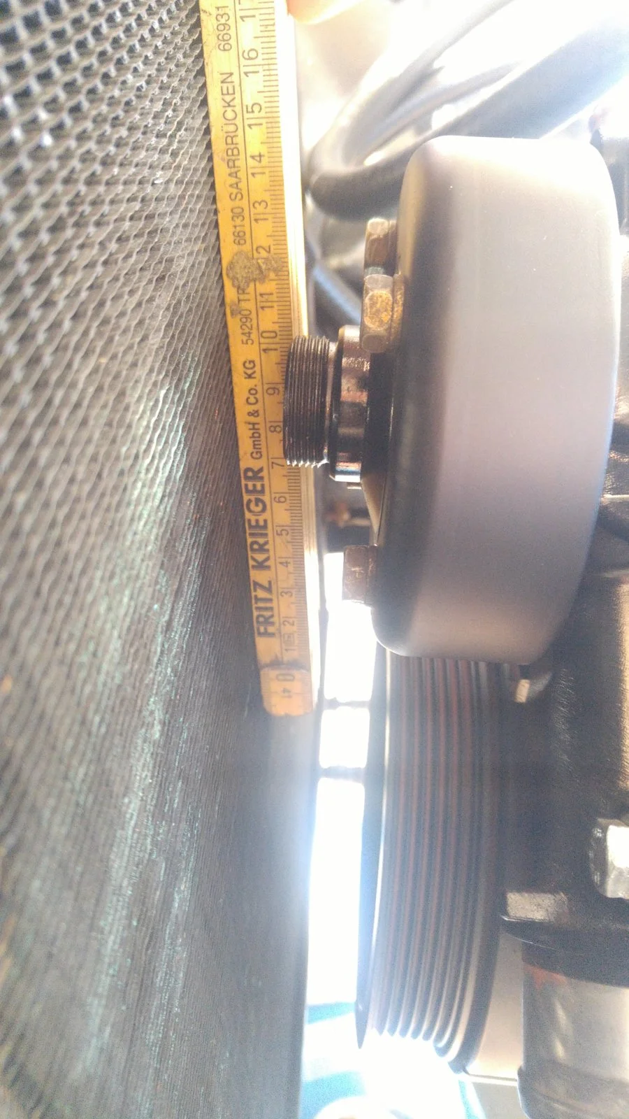

The explorer 5.0 front dress of the engine gives my enough room (about 0.5 to 0.75 inch) in the 74 mustang to use the radiator at the stock position (I will use an electric fan in front of the radiator)

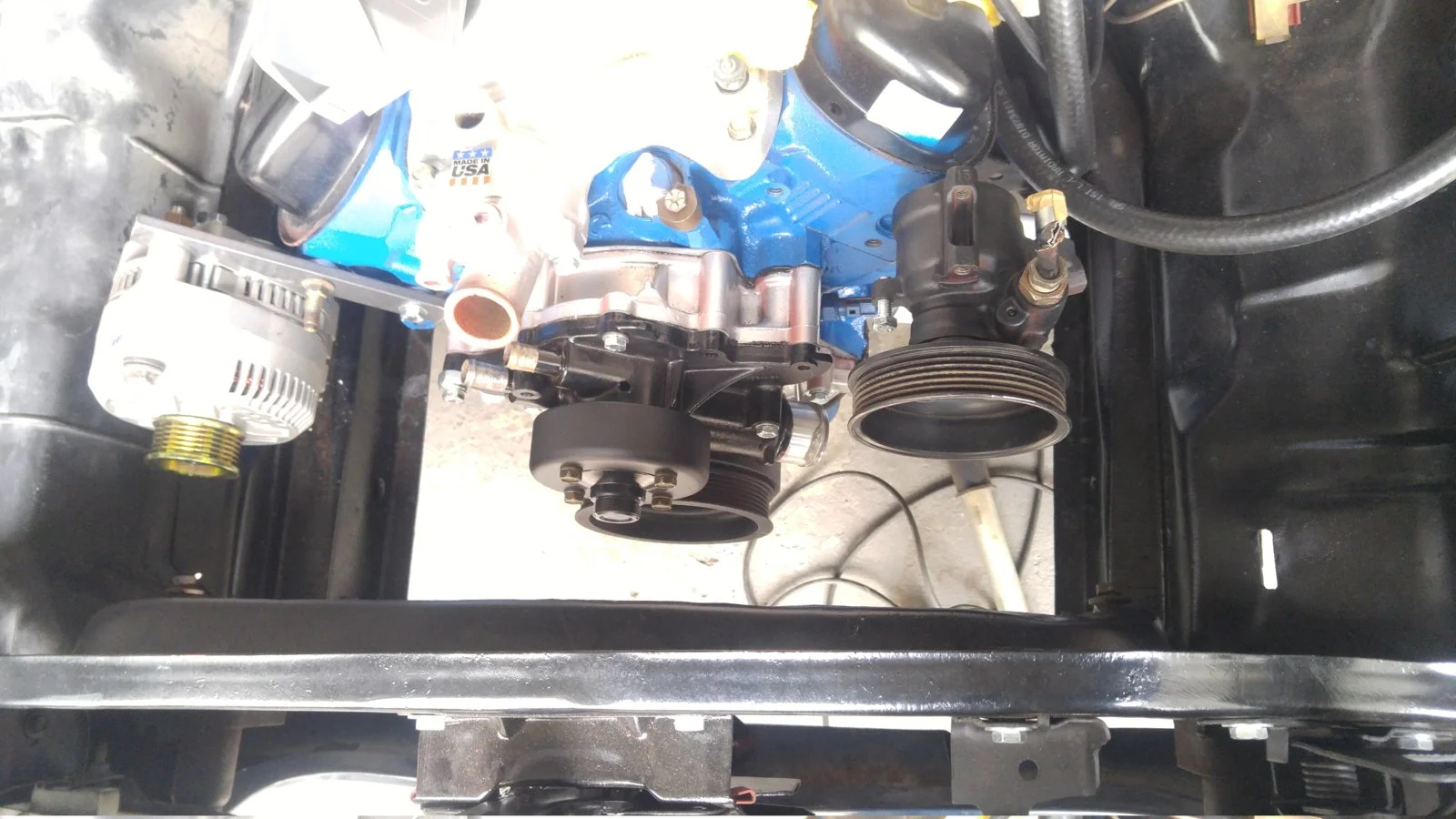

And here is the power steering pump and the alternator mooked up. The explorer engine front forces me to put the alternator more beside the engine than in front of the engine... but i guess it will work. I need to to further bracing on the pump and alternator and and the tensioner will be on the pump side.
The silicon hoses are ordered, but i need to order stainless steel pipe to finish the connecting pipes inbetween. I also need to put a sensor bung into the lower hose/connecting pipe to have a thermo switch for the e-fan.

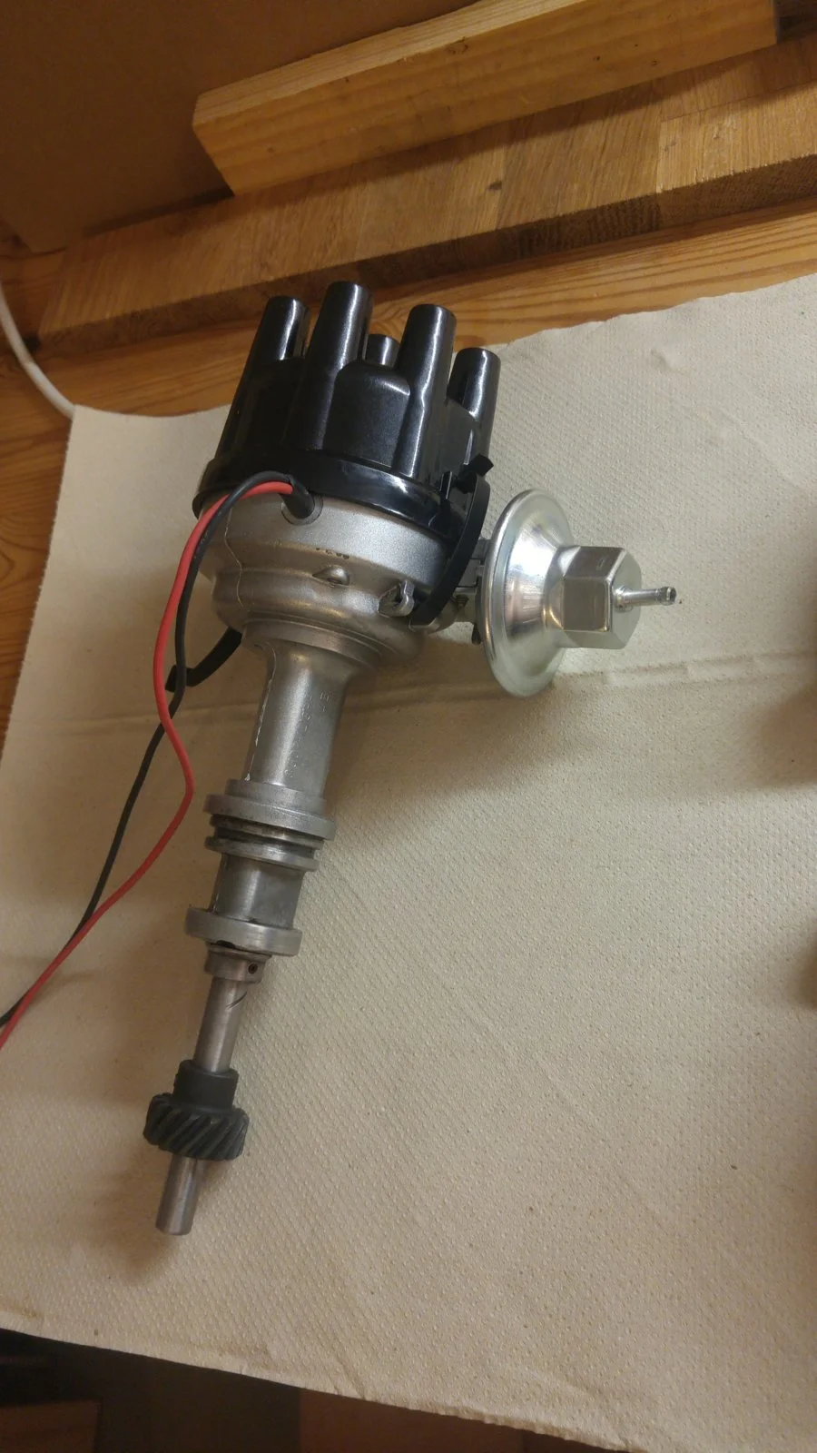

Distributor is finally ready for installation. I reduzed the gap of the "18L slot" by welding and grinding to get a "10L slot". I want to set 14-16° static advance + 20 mechanical advance.

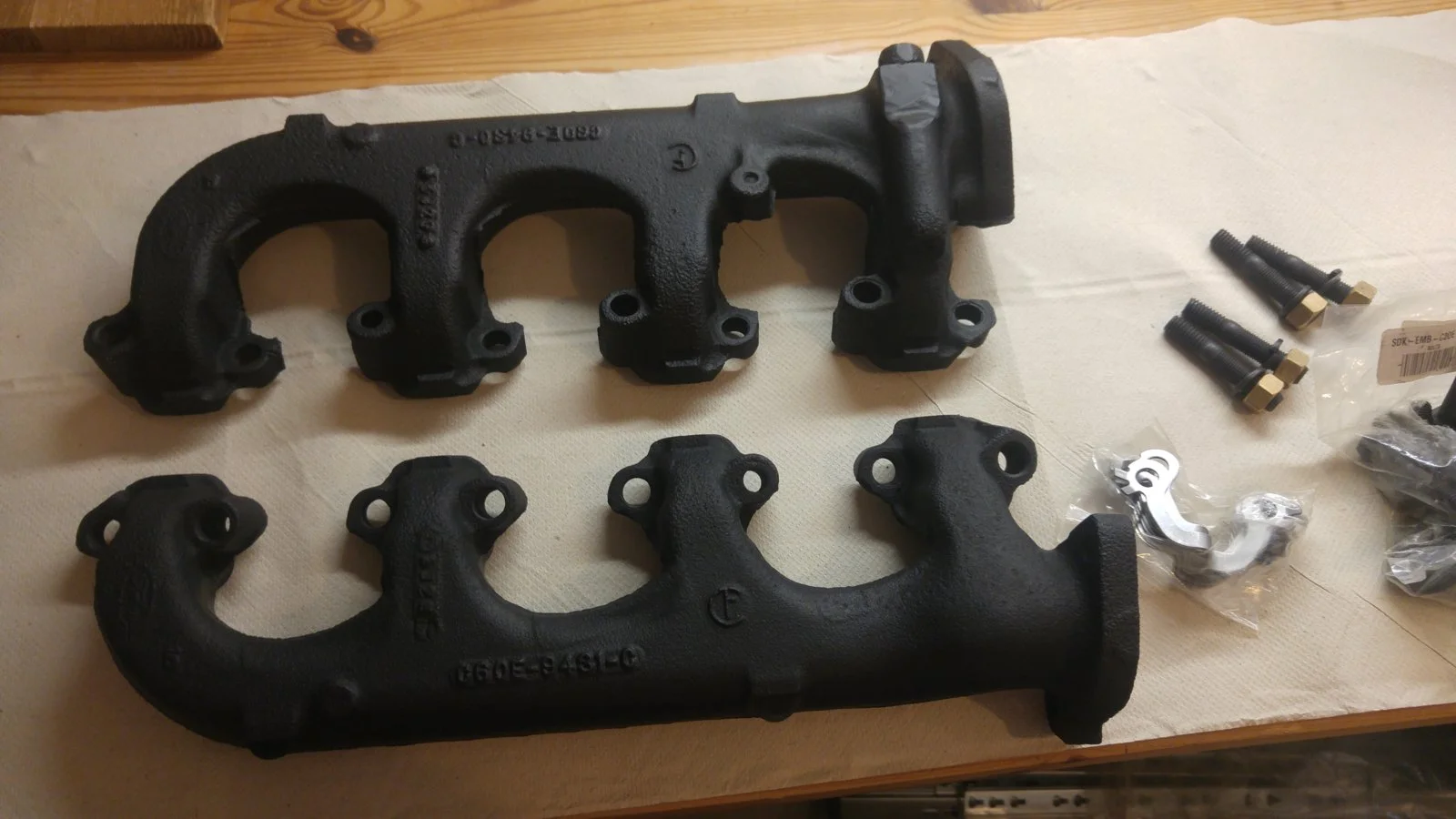

My 289 exhaust manifolds are also ready for installation: painted and the hardware arrived from summit racing.
