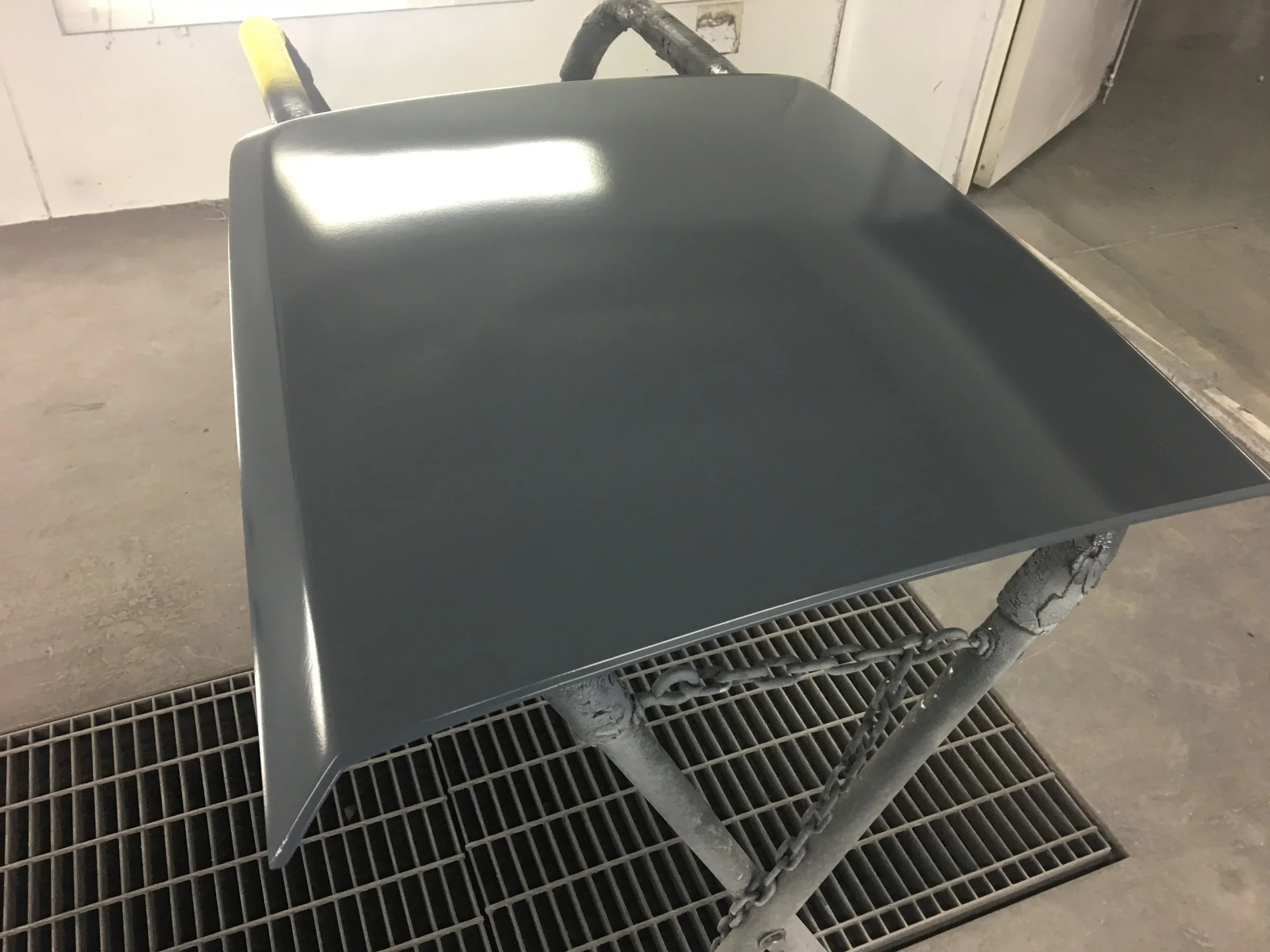

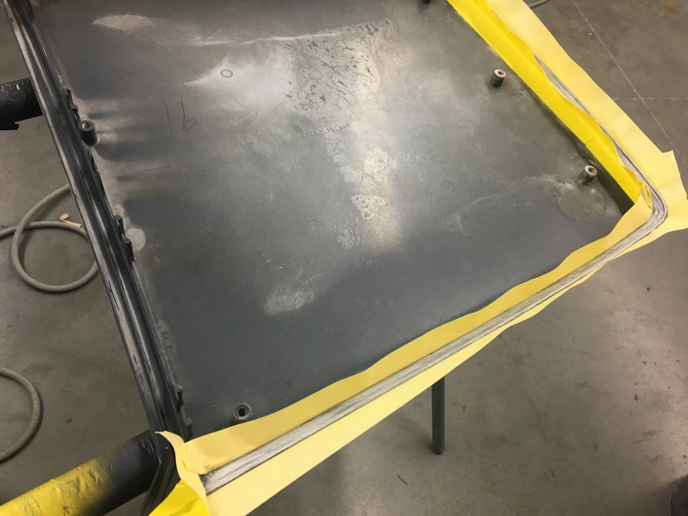

In primer, tomorrow I'll modify it to be able to use two sided tape.

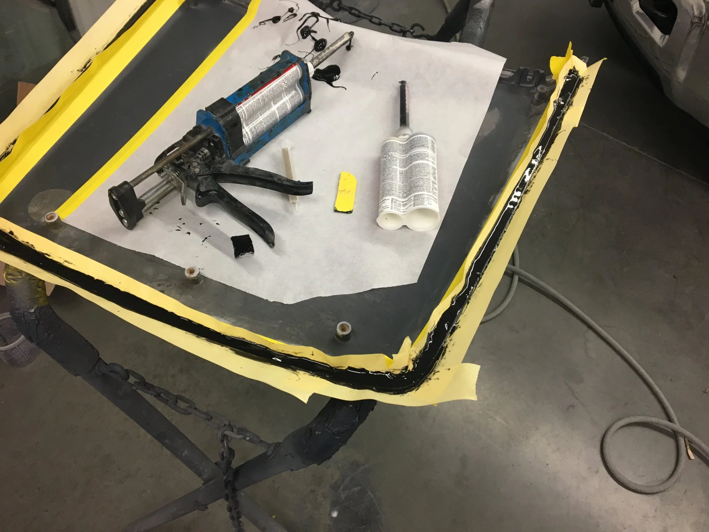

I sanded the inside edge of the scoop with fourty grit. Cleaned it and made a form for the PBA with 2" tape.
Then sprayed plastic adhesion promoter and spread out the PBA.
Hopefully by noon I can start trimming it with a new razor.

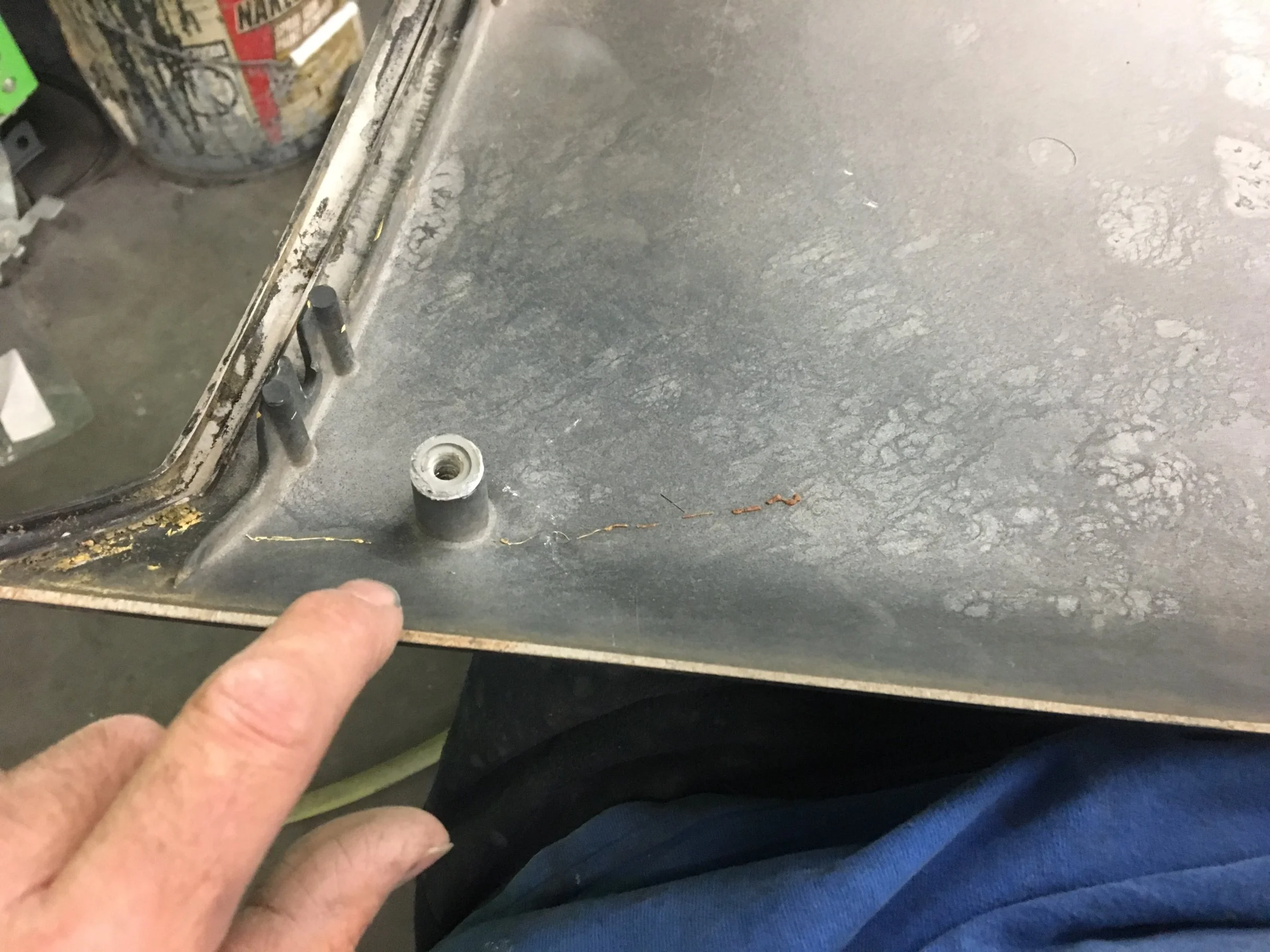

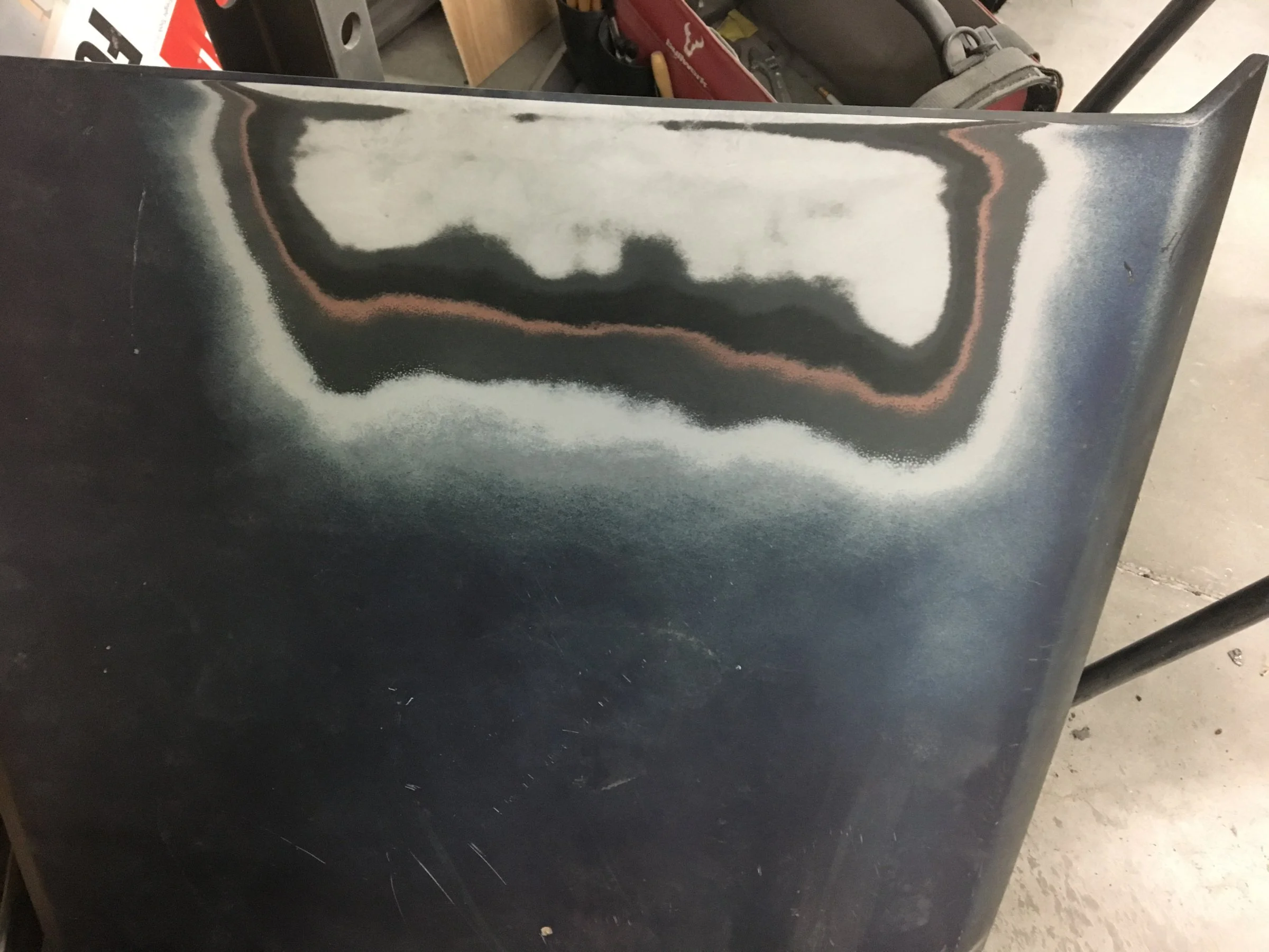

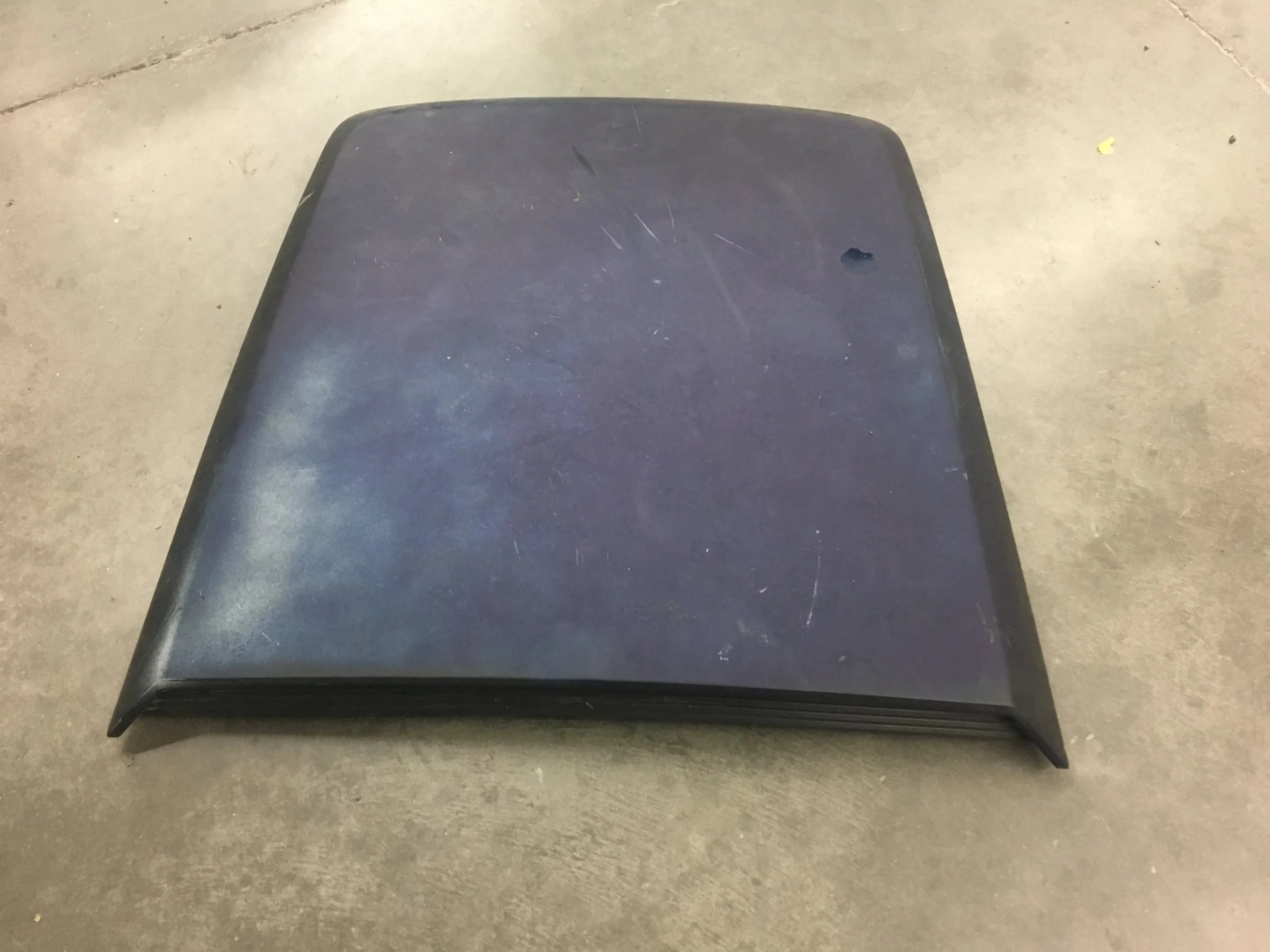

I got the hood scoop this morning, yes, I know I was supposed to get a hood with it. The hood had a rot hole under the scoop. The hood wasn't the type that came with the hole from the factory, so I just got the scoop.
I still payed the guy $80 for it and I'm happy with that.
It's been painted a few times. I'll strip it, primer and block it, then paint.
I'll be two sided taping it to my hood. I'll need to build up the edge with some PBA to give the tape a "shelf" to stick to since the edge is just to small to offer solid adhesion.
