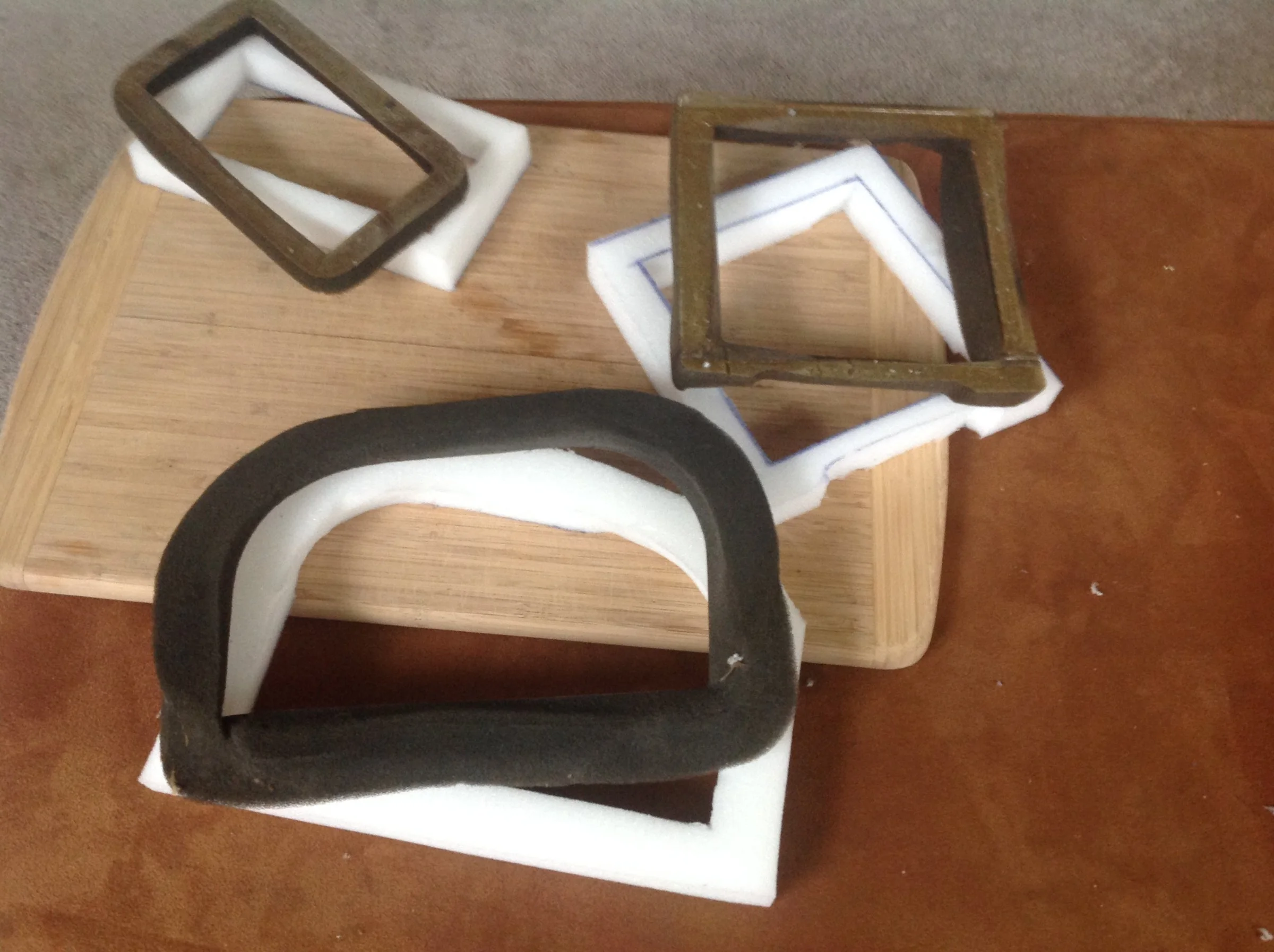

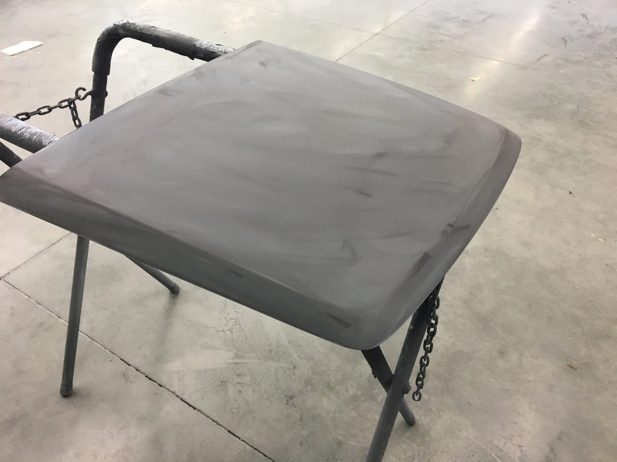

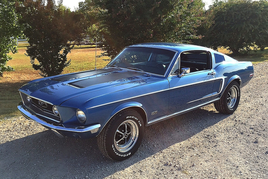

So I got the edge built up for the two sided tape and smoothed. I blocked the original primer and had one area that I had to put polyflex on. I was able to block out the waves around the stud posts.

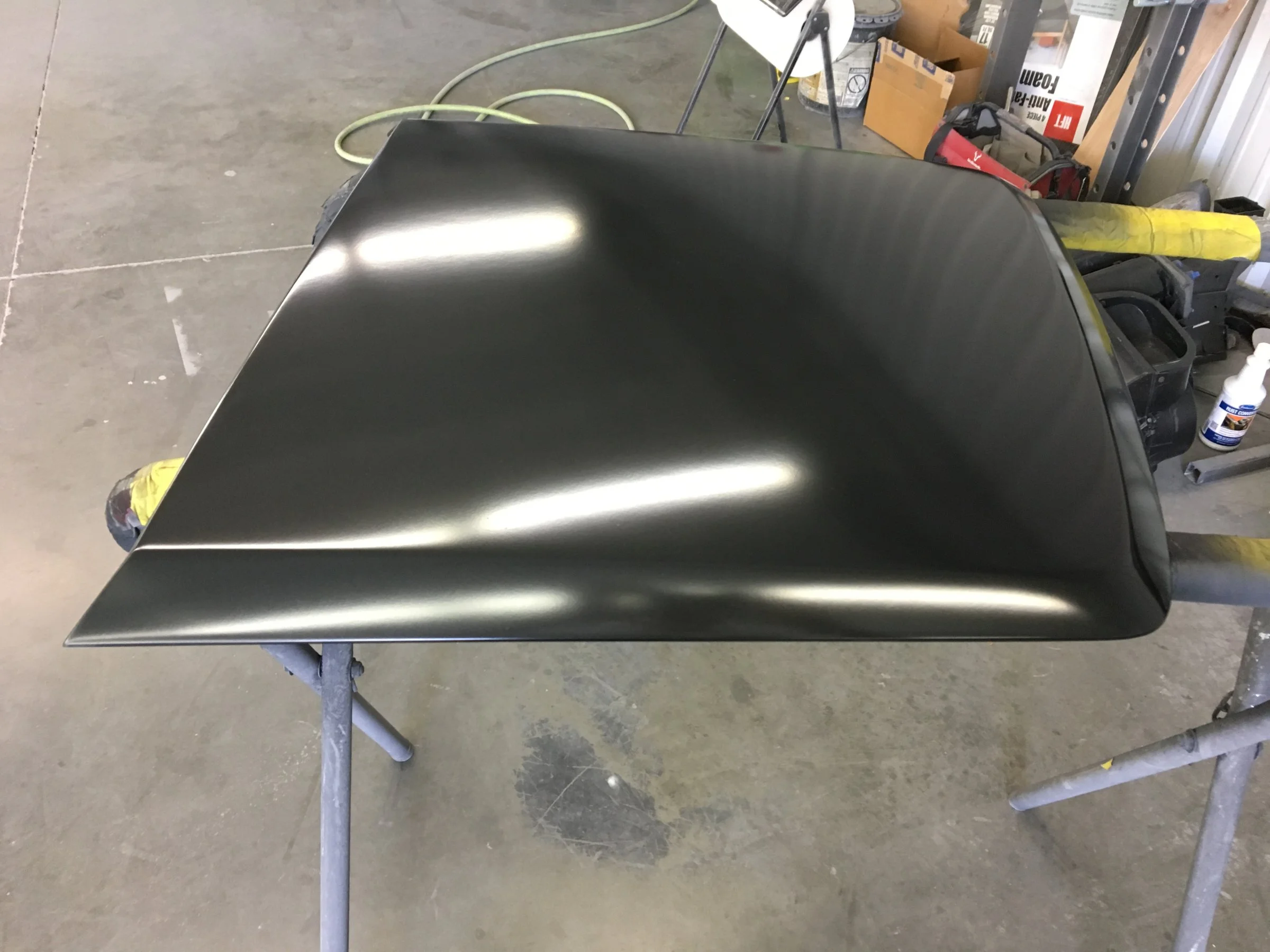

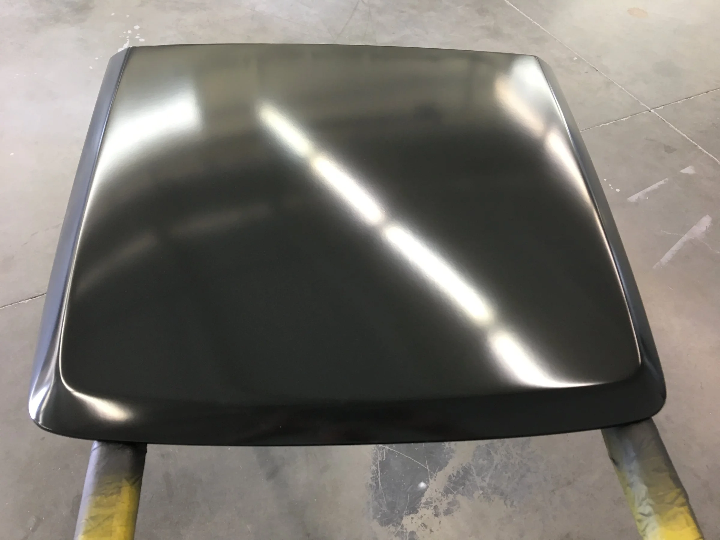

Did that, blocked it, reprimered, blocked it again with 320-400-600 and am getting ready to block with 800. It's nice and straight now.
I'll get it shot in just a little bit.
In this picture it has guide coat on it waiting for me to block with 800.
