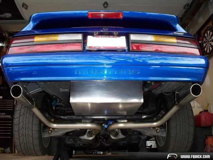

I went a step further and had Weldcraft widen my 97GT wheels to a 9.5. Also had them machine off 3/16 from the rear mounting face of the wheel to tuck the tire in a tad. This brought the tire/wheel in TOO far and I ended up having to remove the rear subframe mounting bracket and bushing. I made the rear mount solid on the sub-frame and it still bolts to the car for removal.
A nitto 275 on a 9 inch wide wheel will look perfect. I might have been able to mount a 275 M/T drag radial if the rim wasn't so close to the rear frame bracket now.

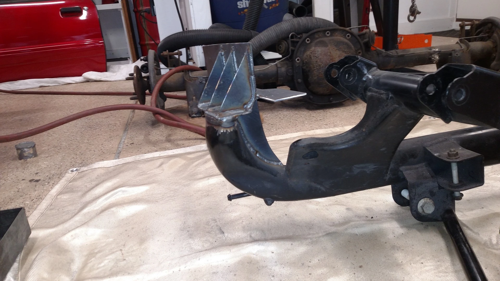

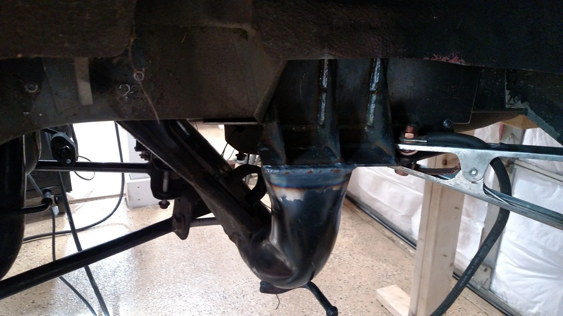

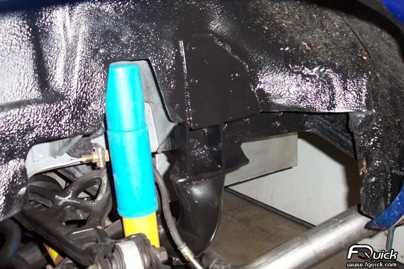

Here is the hard tail mount I did on my IRS cradle. If you happen to ever decide to go the IRS route, I have dimensions and progress pictures on how I did this and can send them to you. You wouldn't have to go as overkill as I did, but could easily modify my design to meet your needs and make the fabrication a little simpler.
I'm not trying to sway you either way, both setups have their merits. Just need to make the decision as to what fits your needs (and budget) better.
