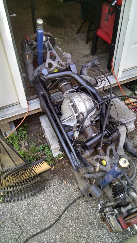

It could be done... with enough work...
If you lay the shock inboard it might contact the sway bar. That attachment point ( rear ) could be moved to inside the rear frame. Gas tank would have to move. The next challenge would be the spring seat location on the lower control arm.???
The front mounting location could be easily moved.
Looks like a different lower arm would need to be fabricated. ( way beyond my skill level )
Would the front mounts need to be changed at all?
Aren't the main contact points for larger wheels/tires the rear mount and shock? Would there be contact with the lower front connection?
I would use coilovers if I did this, so spring mount wouldn't be an issue. Might even consider new lower control arms from KB or MM that has the lower spring mount removed.
As for the shocks, I would think moving the upper mount in and back would still allow clearance from the sway bar. In my mind, that would be the challenge. I'm not sure because I don't have an irs to do any measuring at the moment.
Why the need to move the gas tank? I'm asking this because I really don't know the problems I might have with it.

How much does this thing weigh as a complete unit anyway?
Where does the fact that this thing looks to be at least 200 pounds heavier than a SRA come into play?

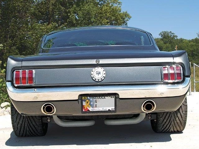

How much ground clearance do we sacrifice to accommodate 3" tail pipes that run under the rear end?
I'd make two individual 1" tall X 5" wide rectangular tunnels under the rear seat that would solve the "where do I run my exhaust?" Possibly even running them far enough back through the trunk under a false raised floor, and the redirect the exhaust down and out after that.

I'm really starting to lean toward doing it. It seems to me the factory used bushings so it could re-use mounting locations and allow for some flex in the design since the fox chassis is not always consistent from chassis to chassis.
The issue with running exhaust above IRS is that there's no room between the sway bar and rear of cradle. The fuel tank sits right at the back of the cradle. If the fuel tank want there the mounting points could change to inside the rear frame rails and the exhaust could easily run over it.

Maybe I'm strange in that I LIKE the look of the IRS tailpipes. It's certainly the lowest hanging thing on my car and mine sits pretty low, but there's enough clearance that it hasn't been a problem. Things like speedbumps aren't an issue as the lowest point of the exhaust is in between the rear tires so it goes up when they do.
You won't need to do anything with the front mounts on the cradle as you'll be able to fit whatever tire you could fit with an SRA. Up and over the IRS for the exhaust is not an option without cutting out the floor pan and going inside, plus you'd have to come back out the trunk around the gas tank... sounds like a PITA to me.
The IRS is heavier as mentioned but reducing the unsprung weight is key here. Also having the weight in the rear helps to better balance it front to back. And also as mentioned already, you'd certainly want to use a coil over for it. But if you were to cant the shock inboard you'd have to move the shock mounts in the trunk as well and make sure they can carry the load now going through them. I'll keep an eye out for an IRS down here in DFW... if you're going to do it you really should only look for an 03/04 as it's stronger/better than the 99/01.
