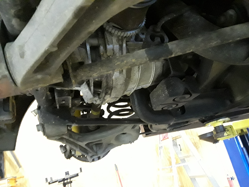

Turns out it's Waco, how far south is that of DFW?
Couple pictures, he hasn't pulled it yet.

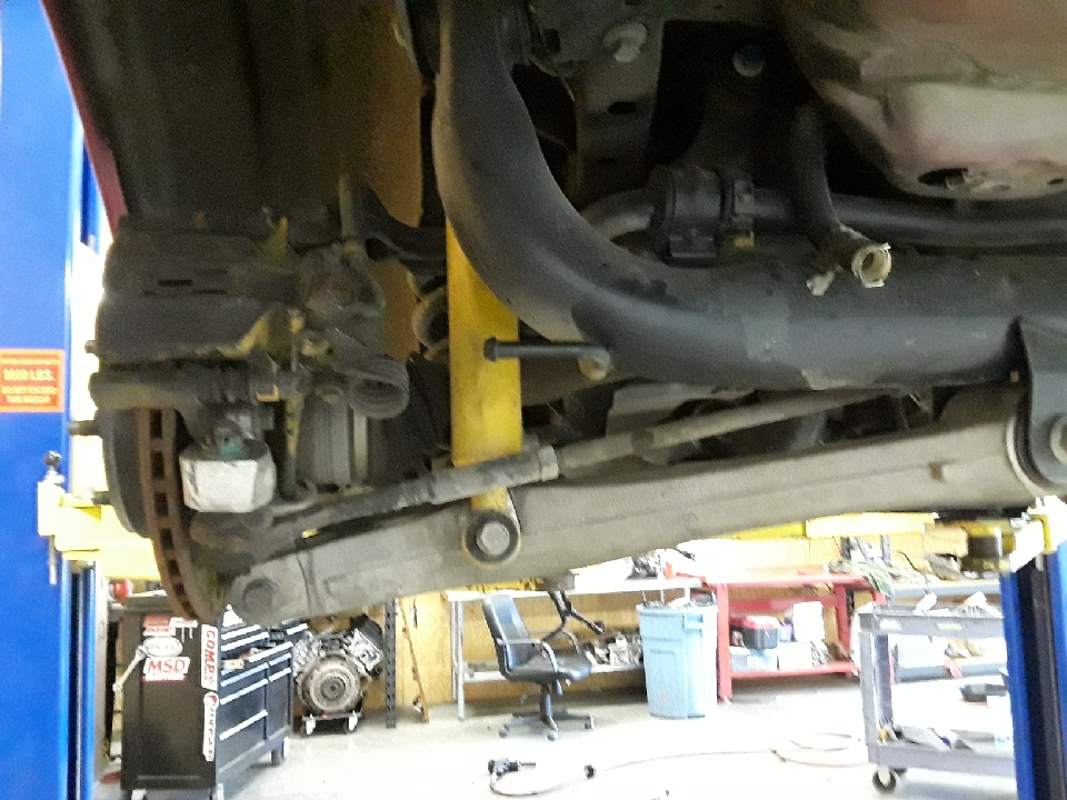

If anyone buys any IRS.... that's the way to do it. That's the best way to buy one. You get everything, even the e brake cables. Every nut and bolt.
That's a good deal !!!!
Mine didn't come with shocks or e brake cables.
That rear already has the cover brace... saves a couple bucks. You'll need to find an 8.8 pinion flange. The fox driveshaft won't bolt up to the cobra IRS.
Looks clean. I've never seen one in a car that didn't leak from the rear cover.

I still have the new FRPP differential I bought for Doby and a new pinion flange too, I think they’ll both work on this.
Isn’t it a different r&p set for this differential that I’ll need? I had a set of 3.73’s for Doby. If the 3.55’s that are in the cobra are still good, I’ll just reuse them when I rebuild the rear.

Can't you shoot him money via PayPal? Send it as a business transaction so you're protected that way he can hold it for you. If the deal falls through because he's not a man of his word you're protected and you get your $$ back.
Be sure to not over gear the rear end. I forget what you're doing engine wise but I made the mistake of thinking I was staying naturally aspirated and when I add my twin screw my 3.73 r&p became too much. Car is still fun but a 3.55 or even a 3.27 would keep me in boost a little longer and possibly make me hook better in 2nd gear.
Another thing is when/if you go to pick this up bring a pallet to set this rear end on and bring a couple heavy duty tie down straps. You can use the straps to attach to an engine hoist to pick the rear up and place in back of your truck. Assuming that the shop and lift is owned by the guy selling the IRS, he should likely have a hoist handy to make lifting it easier. Hope you have one at your destination.
