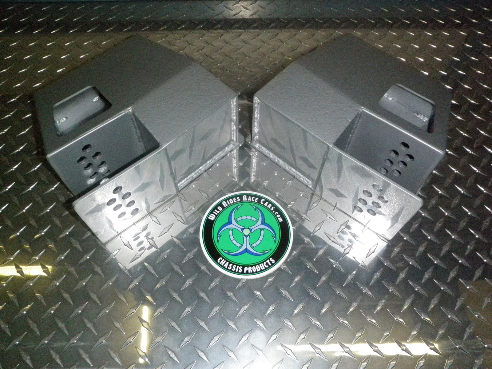

I'm also going to order these. I know that i don't need them in any shape or form, but.........they're so cool!
Berate me if you will, i'm getting them. These with the through the floor subframe connectors kind of like what @Hoytster has will make my little t-top pretty solid.

If you insist on going IRS, axle torque ends. There will no longer be a need for a SRA reinforcement like those Wild ride battle boxes when there is no longer a control arm trying to pull that mount out of the floor. All the mounts do now is hold the cradle, and the cradle twists as a unit,.....which comparatively speaking would be non-existent.
Reinforce the boxes by all means, but if you're gonna insist on pissing your money away, I'm gonna move your thread around so many times here that you'll spend so much time trying to find it you'll be exhausted.
And maybe you'll forget about about doing dumb stuff.
