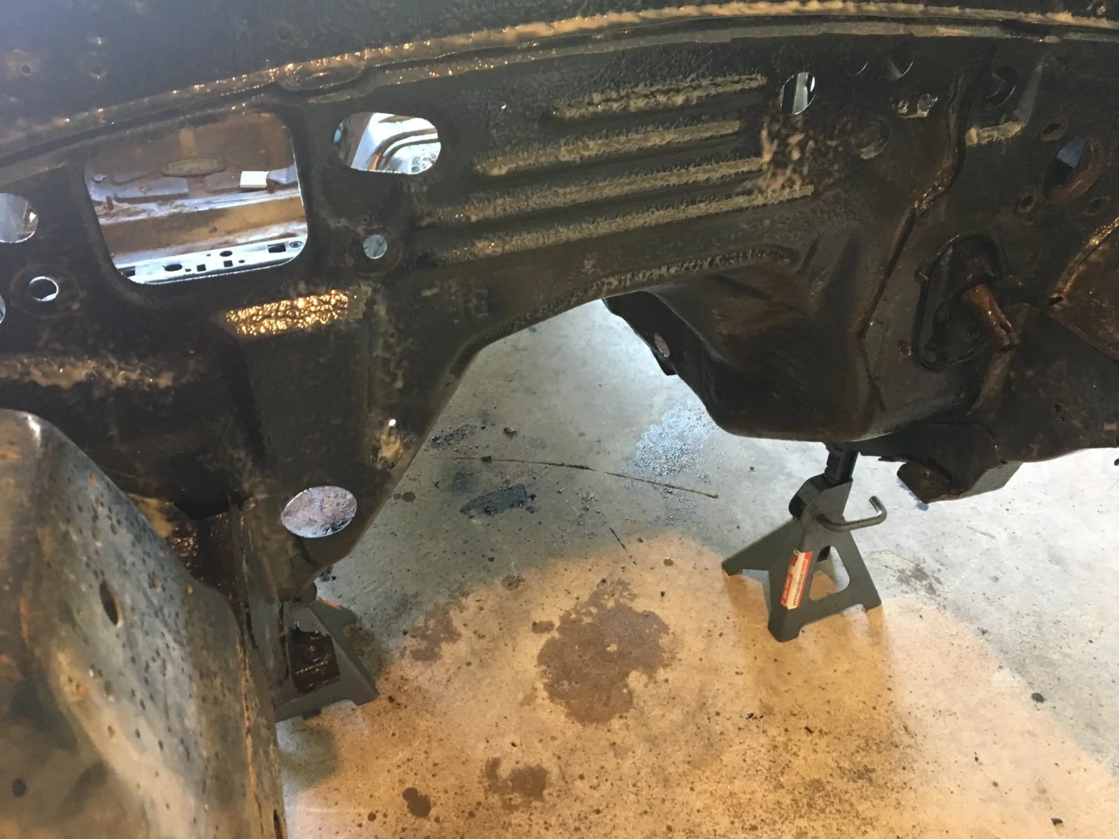

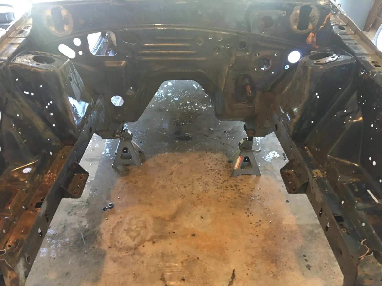

K, first wave of scrubbing is finished. It's degreased.

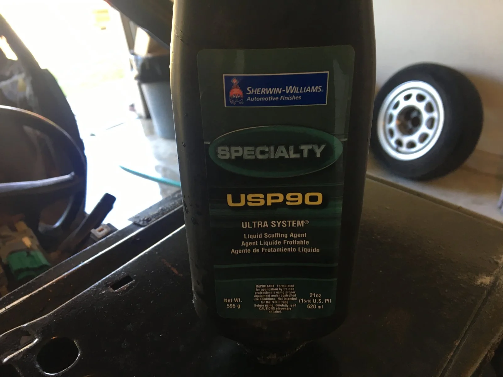

Next scrub will be with this stuff. It's a gritty soapy paste that i'll use on a scotchbrite and give the whole eb a good scrub-down, this stuff is great to prep a clean panel for paint using a grey scotchbrite, btw. Just remember to scrub the hell out of the panel.
I don't have any scotchbrite pads like I thought i did, so off to the store. I needed to pick up some spot weld cutters anyhow.
Off I went to get the spot weld cutter bits because every store has them, right? No, that's not true.
I didn't want to go to HF because that's about six miles from my house, so I went to another four stores closer to my house to try to find them, driving about fifteen miles in the process.....:nonono: Then I went to HF and bought some.
I did get about an hour in my nice air conditioned truck.

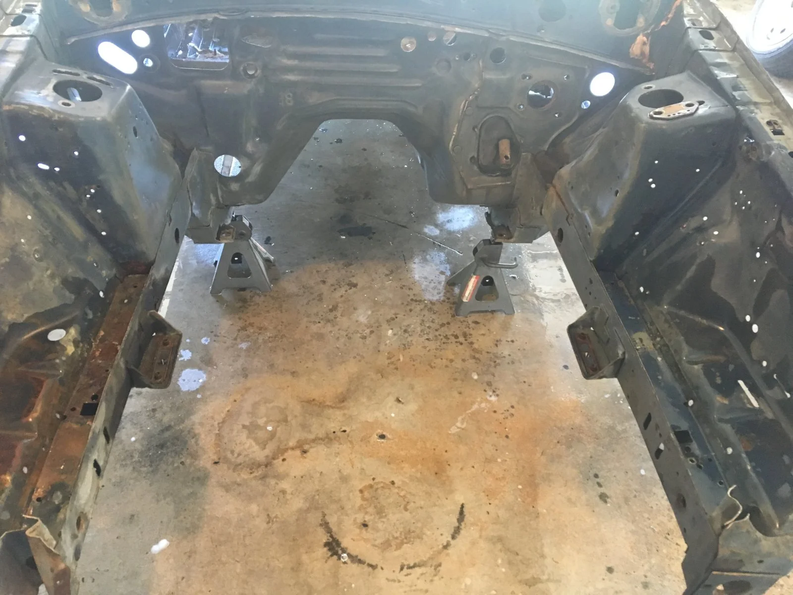

Anyhow, got back home and scrubbed the entire bay, its real clean right now. I would say pretty clean, but it's not going to be pretty for awhile yet.
I'm going to go do the measurements next. I got to make a little drawing first. If my printer worked I would just blow up this picture and write the measurements on it.

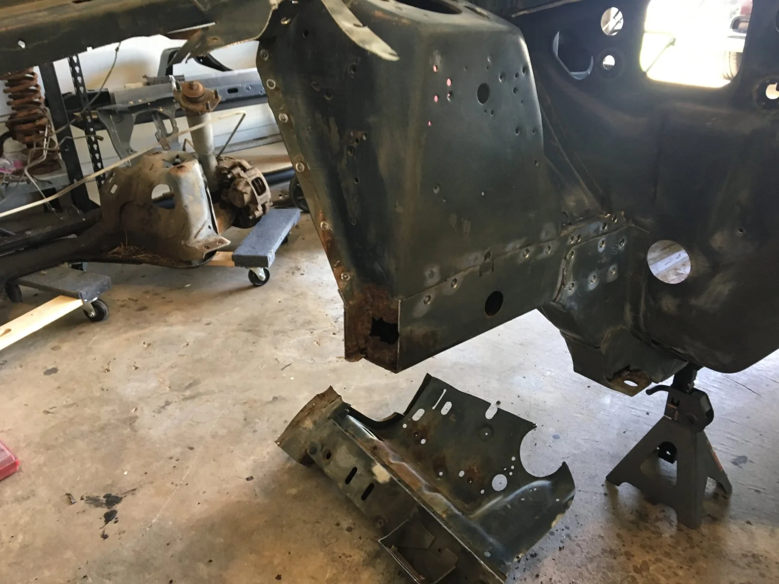

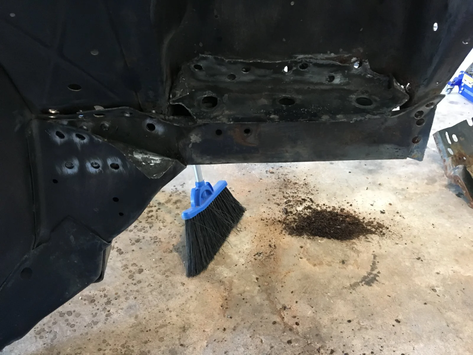

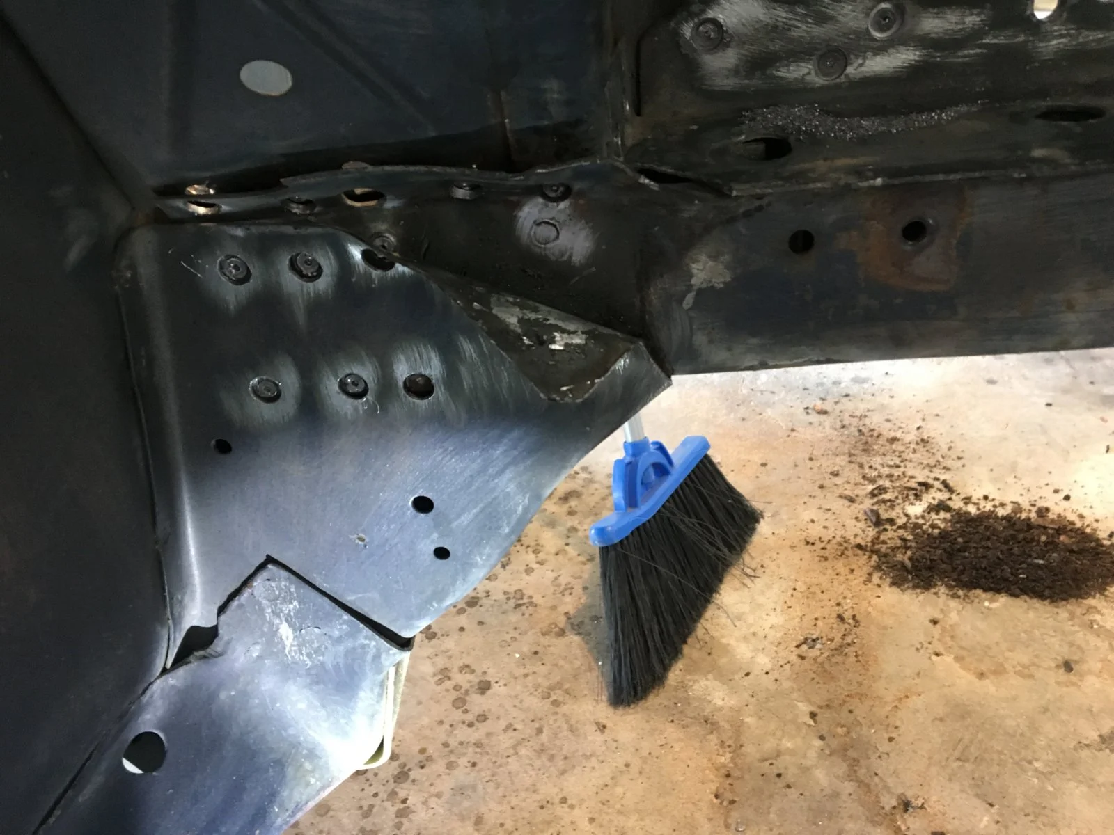

How about the end and work my way back a little. Here's a picture or two with the rail out.
For those wanting to do this, be patient and work slowly through it. I cut 52 spot welds doing it this way.
The shock tower was interesting to me, the bottom is folded under and becomes the base for the crush tubes. It also has two tabs on the sides that are folded and pinch welded twice on the front and back of the tower. The factory crush tubes are welded to the shock tower, not on the bottom or top. I don't know because of the rust there if the bottom was welded to the frame rail or not. The pitting was too deep to tell. It may have been bonded by the rust. One way or the other I had to cut the bottom off the shock tower to get the rail out.

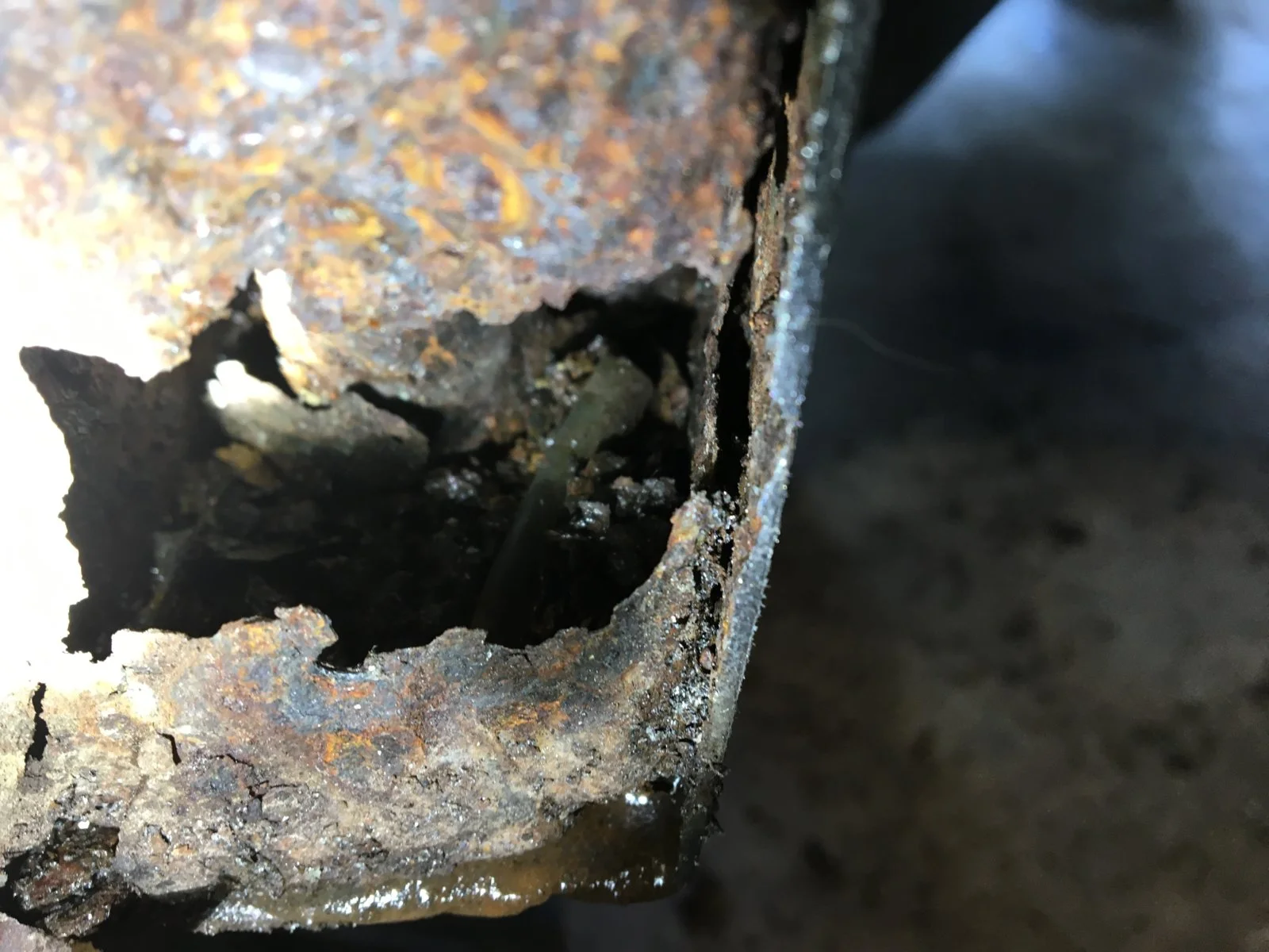

Speaking of the shock tower, it has a little rot issue.
I'll need to cut off about four inches of the bottom and replace it with new metal. That'll have to be the next thing I do. I can't put the new frame rail on until that's fixed, obviously.

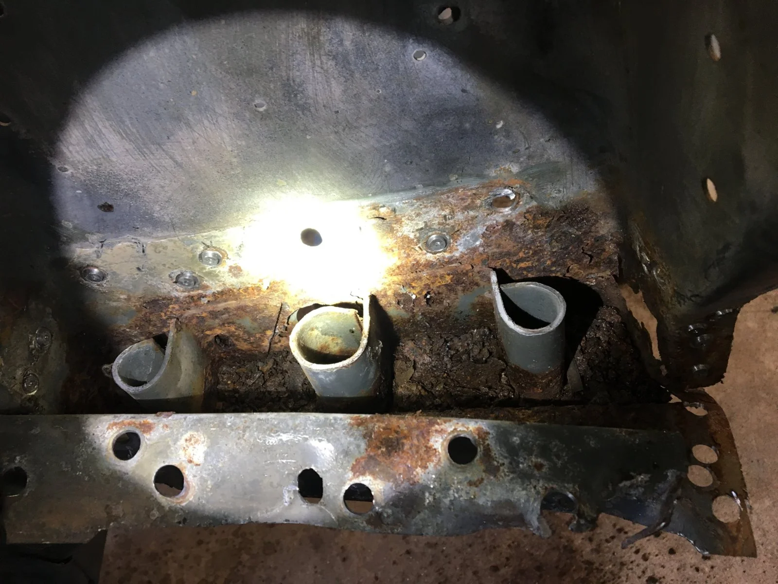

The crush tubes weren't terrible, hard to believe though. Here's the pile of rust that came from around the shock tower area. Amazing how much there is. That's mainly ex-shock tower metal I guess.
