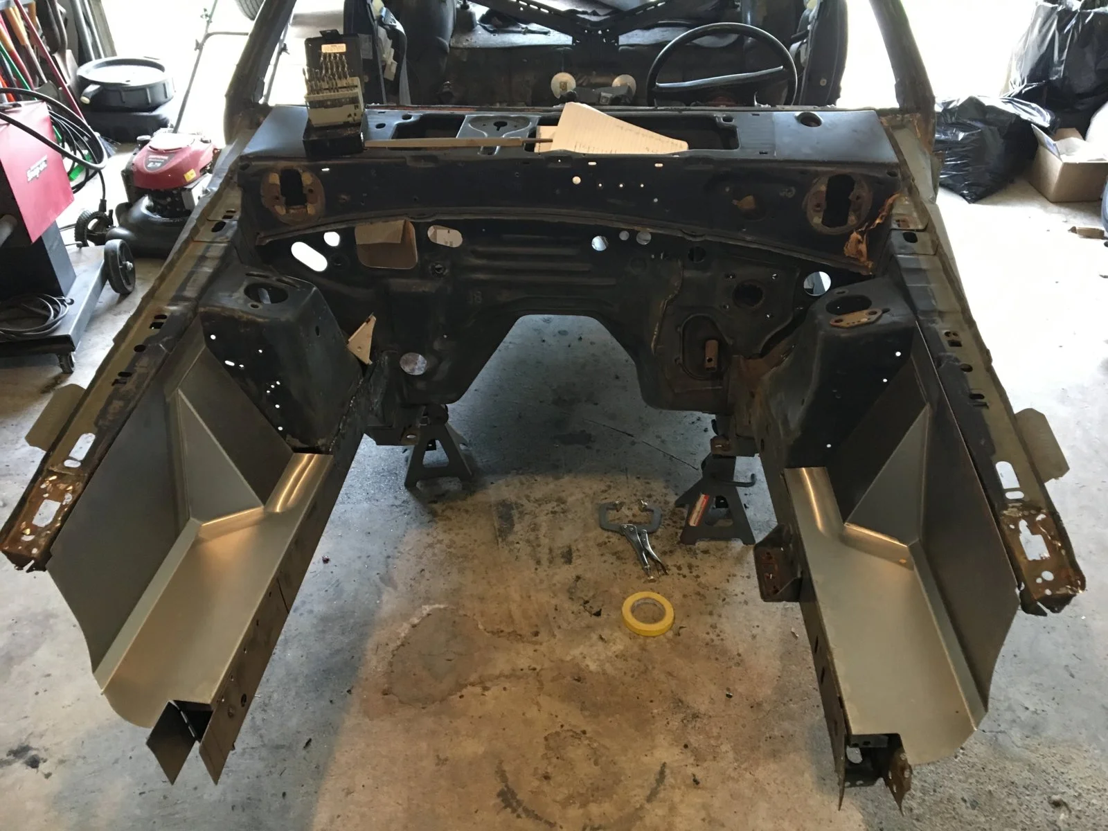

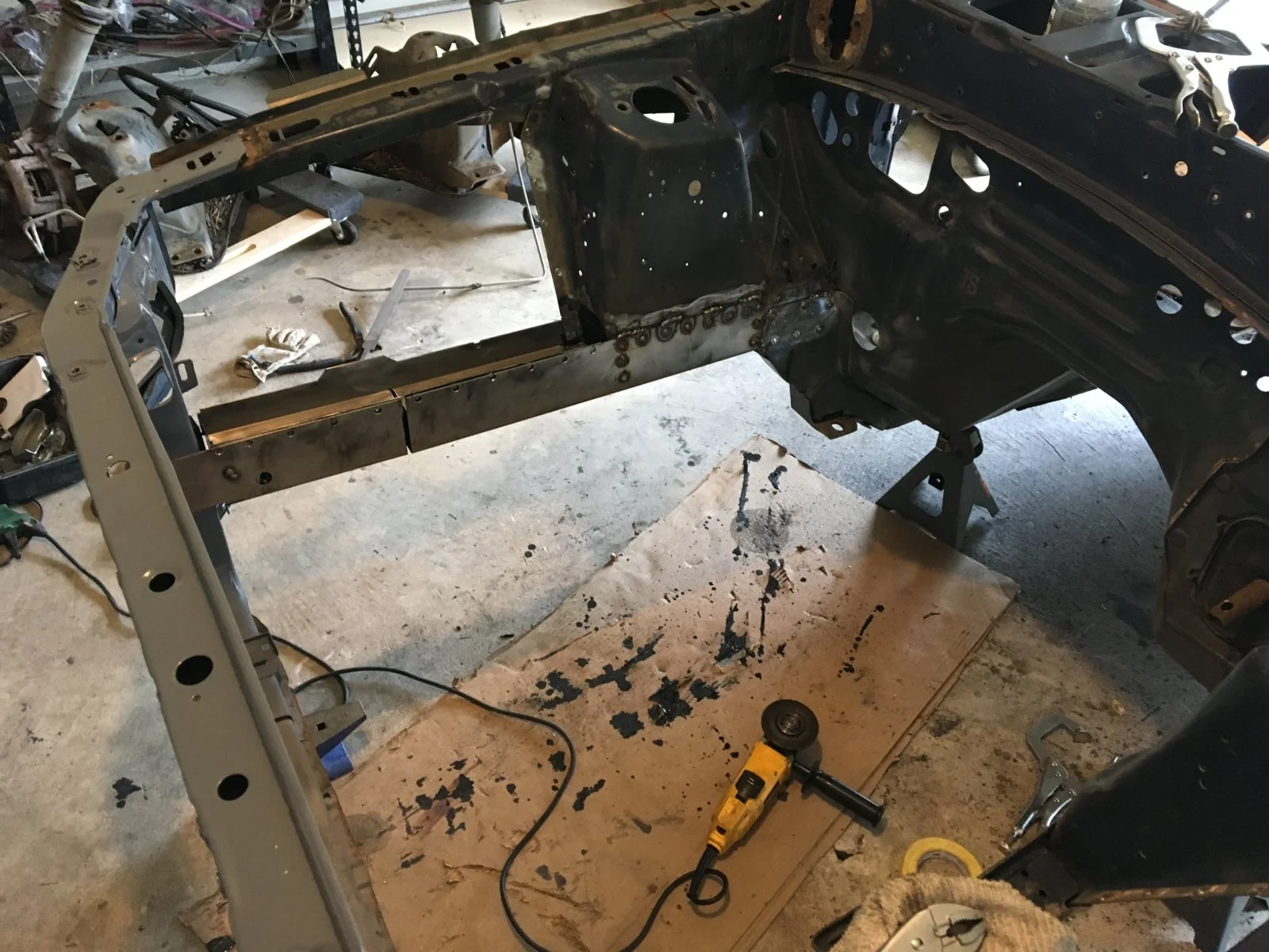

I'm out in the garage, happily plugging away. Got the rear of the new frame rail welded in, things are golden. I swear the Swedish Bikini Team was coming up the drive way...........:rock:
I just wanted to do a perimeter weld around the rear bracket on both sides. Got the outside done, come around to the inside and my welds go nuts. Sputtering and popping, I literally had hot pants. Luckily no flames.
I ran out of argon......I though I was pretty low. Oh well, I'll get a new bottle monday and finish welding the rest of the rail. Mainly the new front upper cap and the line that's used to allow the slight arch in the rail.
So the rear area up through the strut tower is welded, probably good enough, but again I will finish the perimeter weld around the rear bracket. Also the upper crush tubes plate and sway bar mount. I'm close.

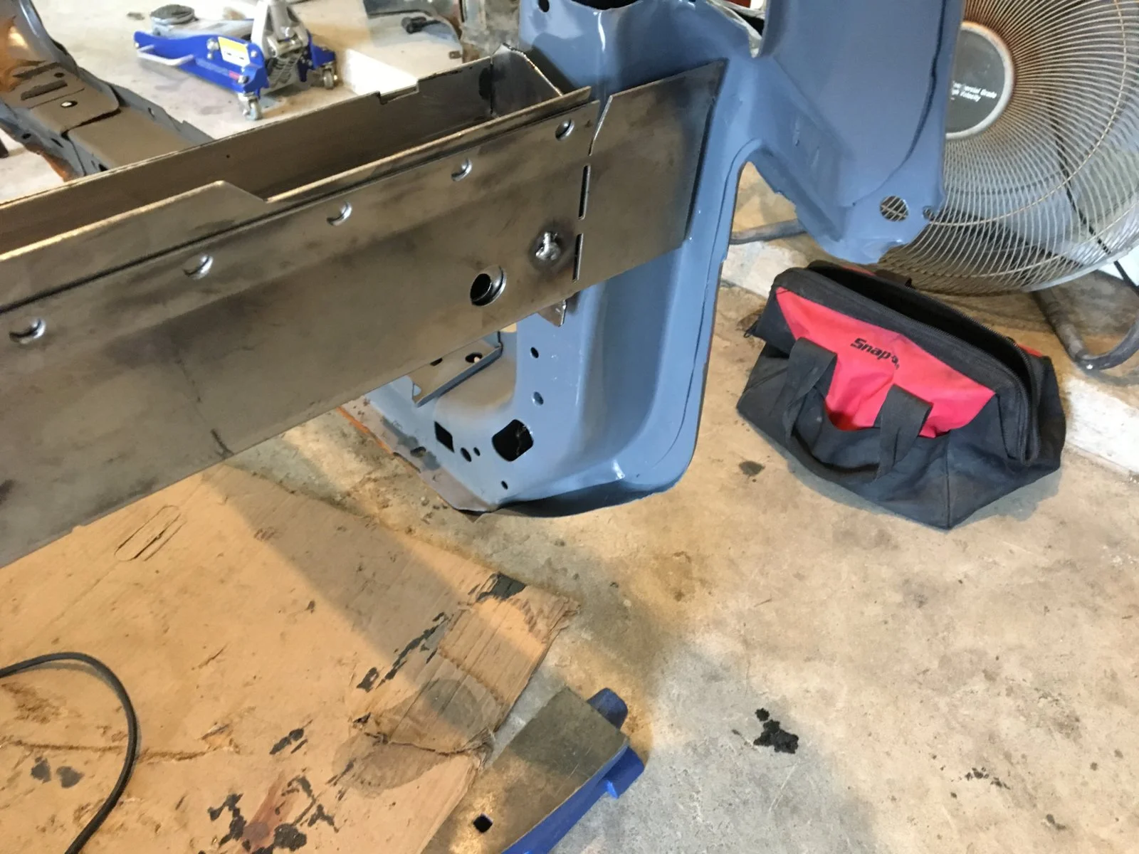

The top cover for the crush tubes fit nicely, I didn't get it welded on yet. Holes line up fine though. If someone buys this kit, the instructions talk of bending the rail down to match up to the top cover, it's pretty easy. I used vise grips mainly.

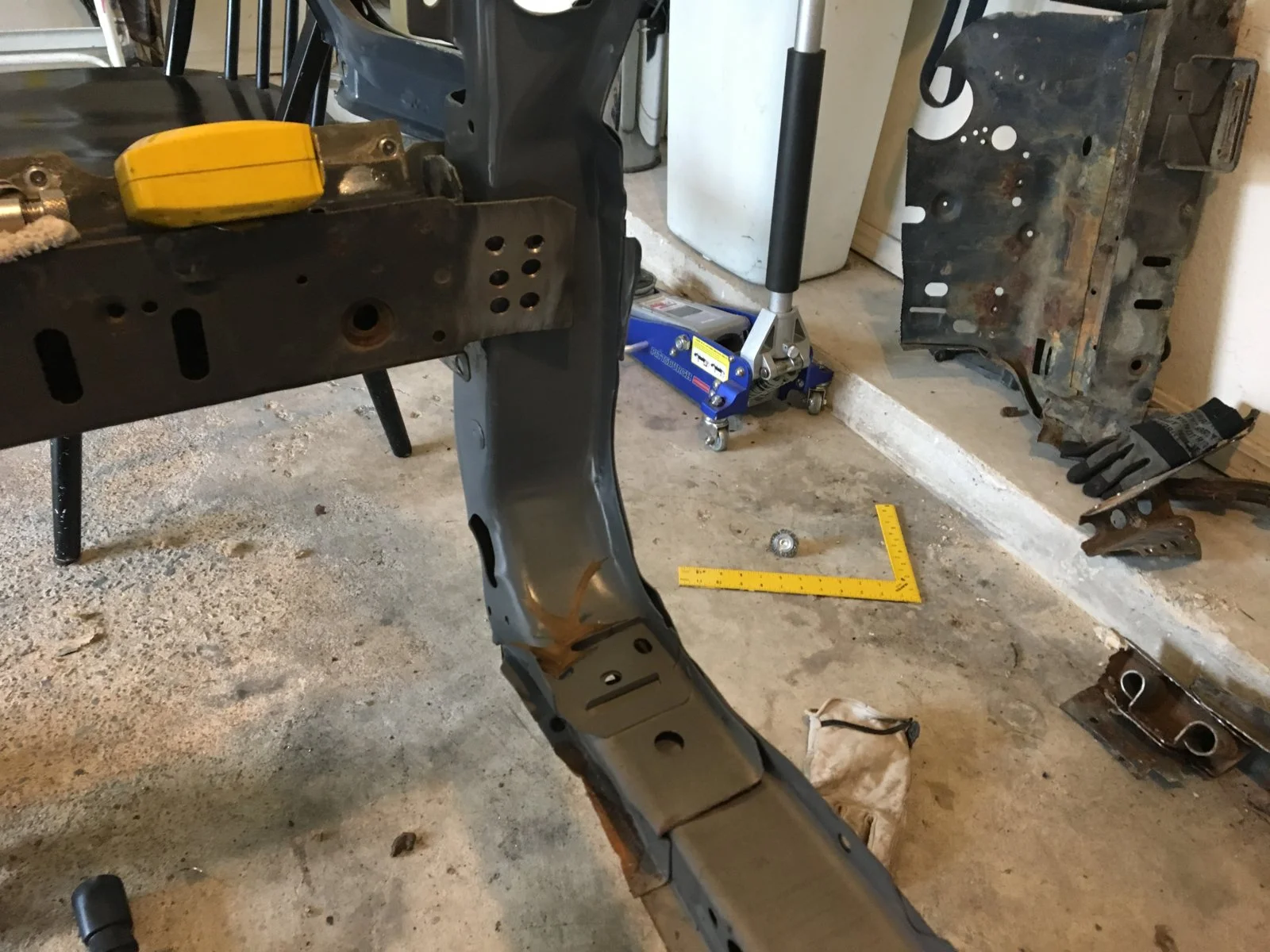

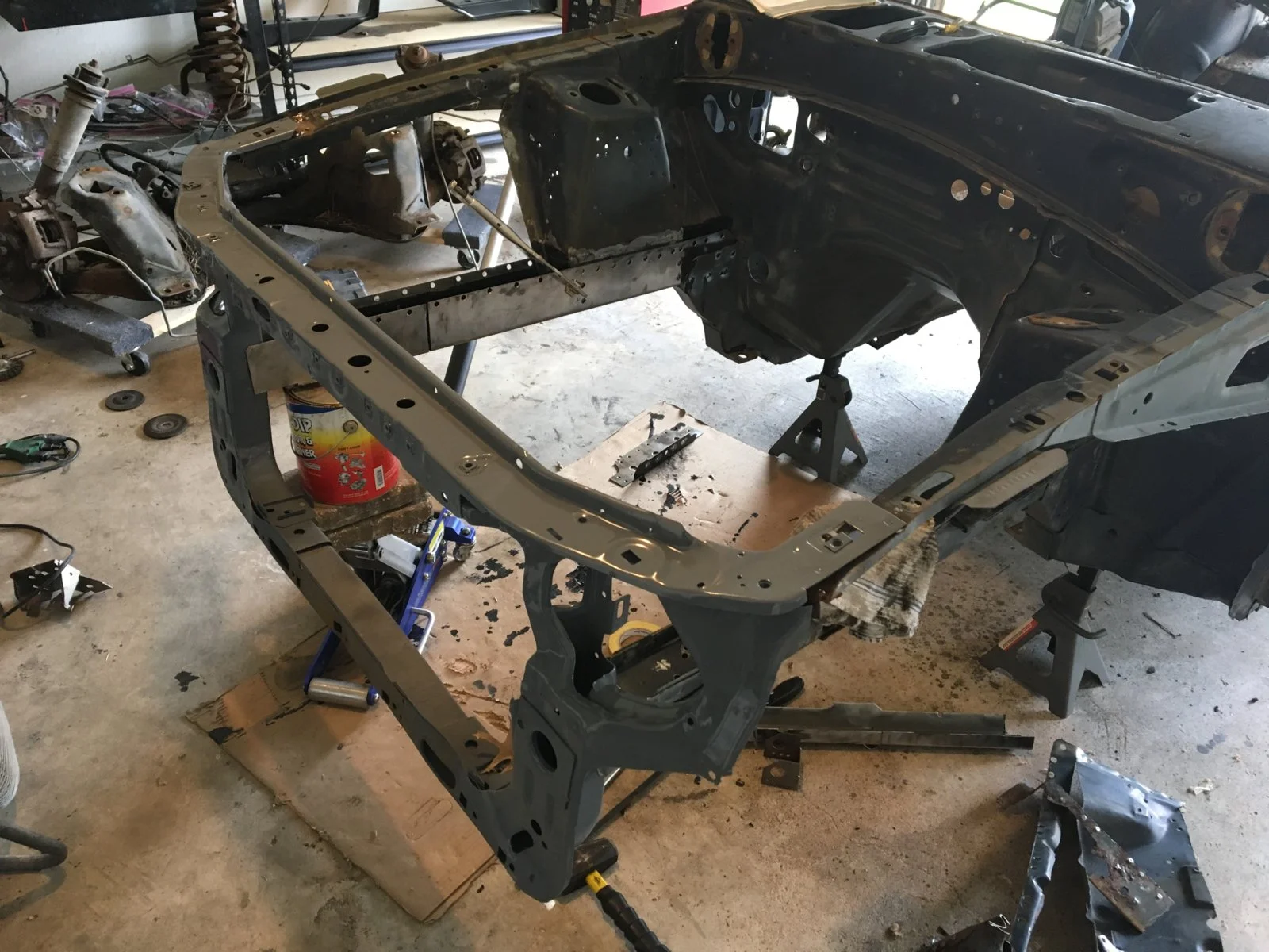

By his stage I knew I was screwed for anymore welding today, so I fitted up the radiator support one more time and check my measurements again.:nice: Funny how good they are to the original.
You'll notice the ears that wrap around the radiator support are longer in the new frame rail than the original. I ended up cutting a half of an inch of them

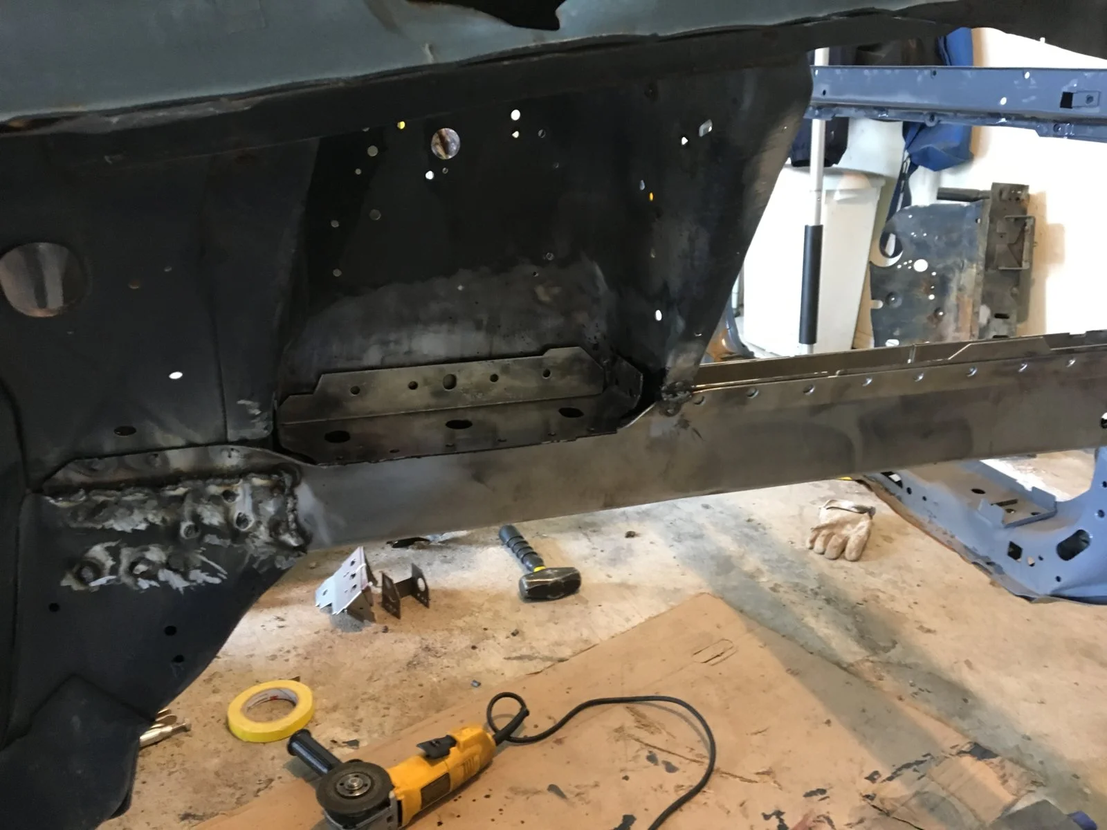

I ground some of the welds, but I tired of that fairly quick.
I need to bring home my body hammers tomorrow to straighten the upper radiator support mounts and weld up some holes and tears there.
One last picture with the Scott Rod panels sitting in place. Luckily I know what to do to make these look nice after having done Doby's.
So here's my thinking in the repair of the left frame rail.................In an accident the passenger may die due to the frame rail piercing their body. The welds will still be holding though. So a double thumbs up to Dave and his dead passenger!:nice::nice:
