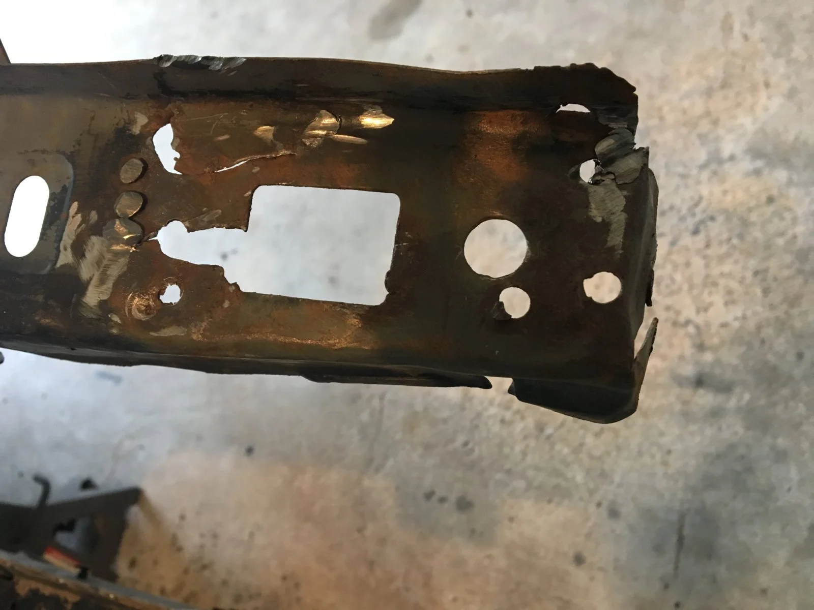

I just spent the last hour doing what might be considered a little task.

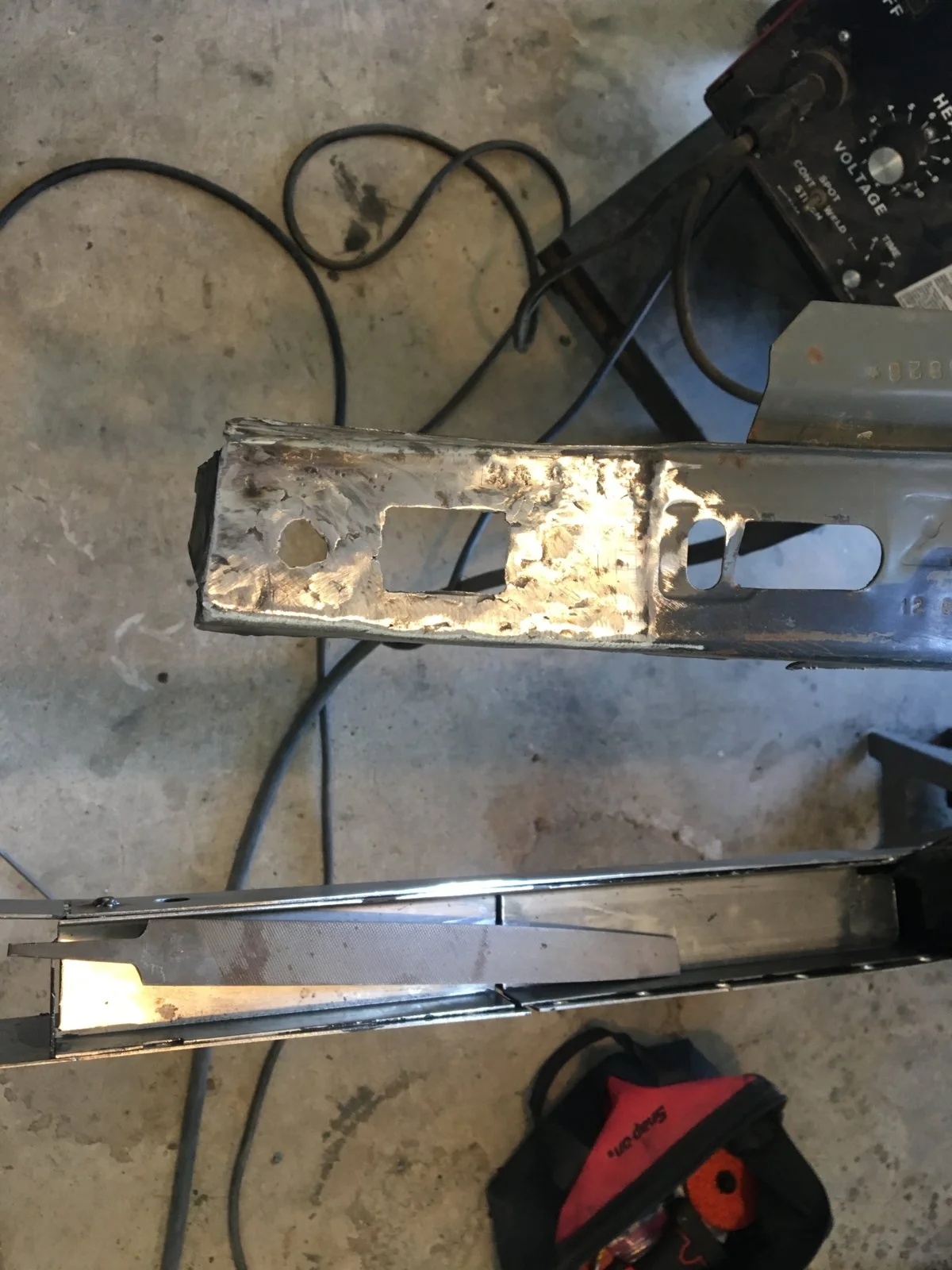

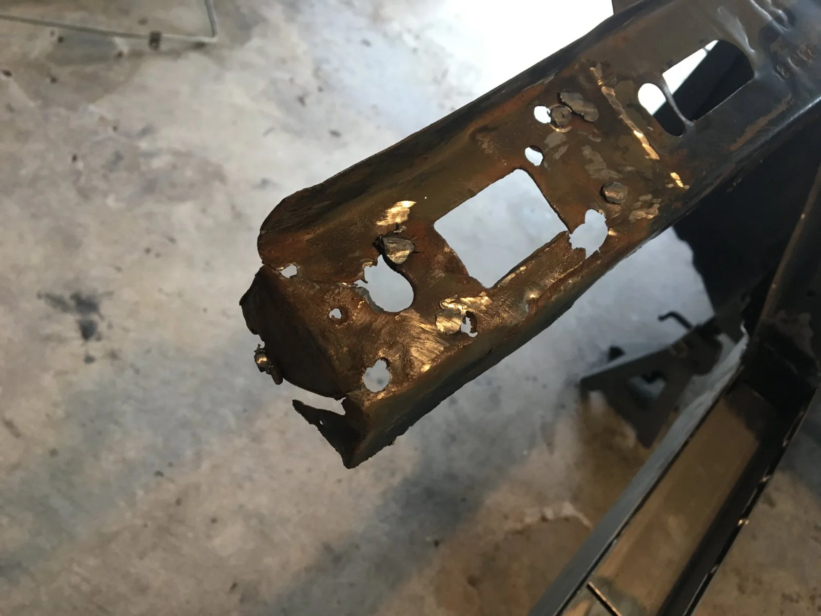

I straightened out the upper mounts the radiator support gets welded to.

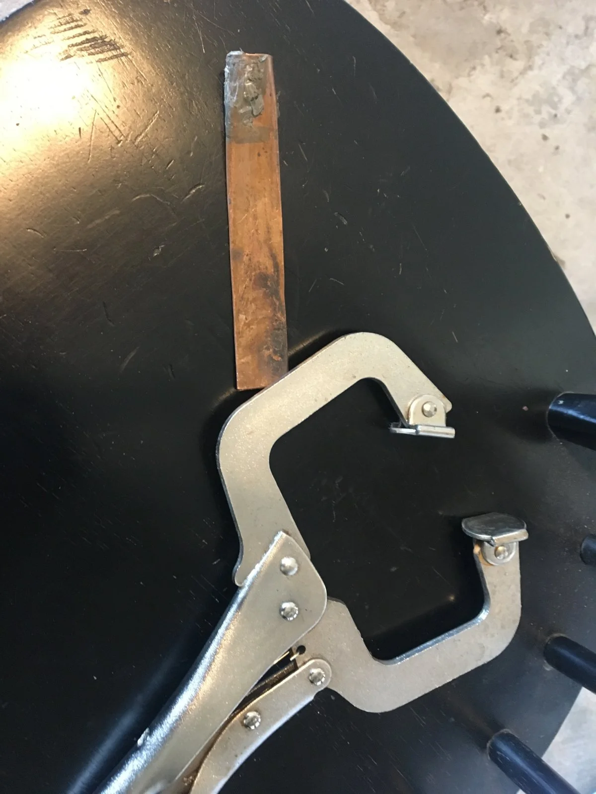

Tomorrow I’ll have argon again and I’m going to fill in all of the holes that have been drilled into them and weld up the tears. If anyone cares I’m just going to clamp my chunk of copper to the backside and erase those holes with my welder. The copper is just a flattened piece of copper pipe.

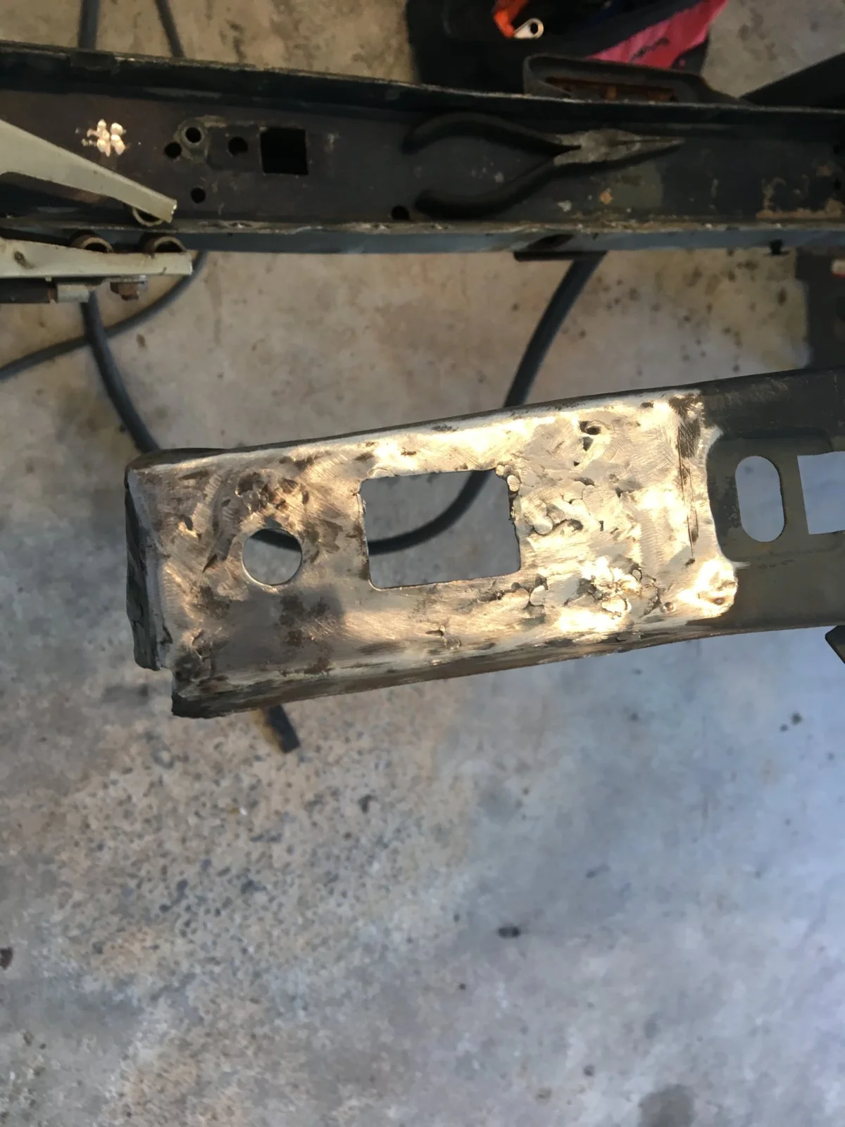

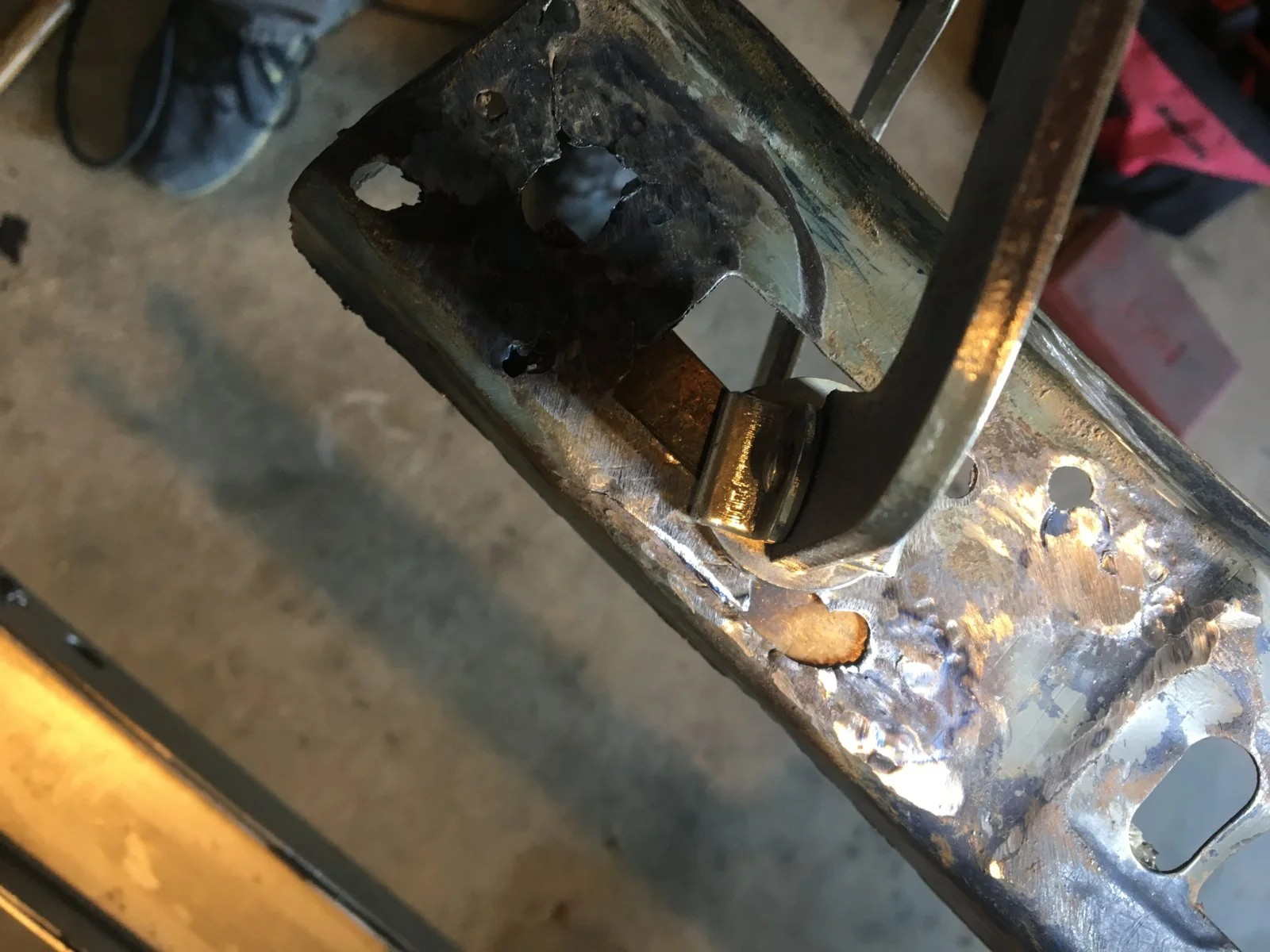

I said I was going away AFTER I fixed the radiator support mounts and finish welding the frame rail!
Radiator support mounts repaired: check
Right side.
Left side.

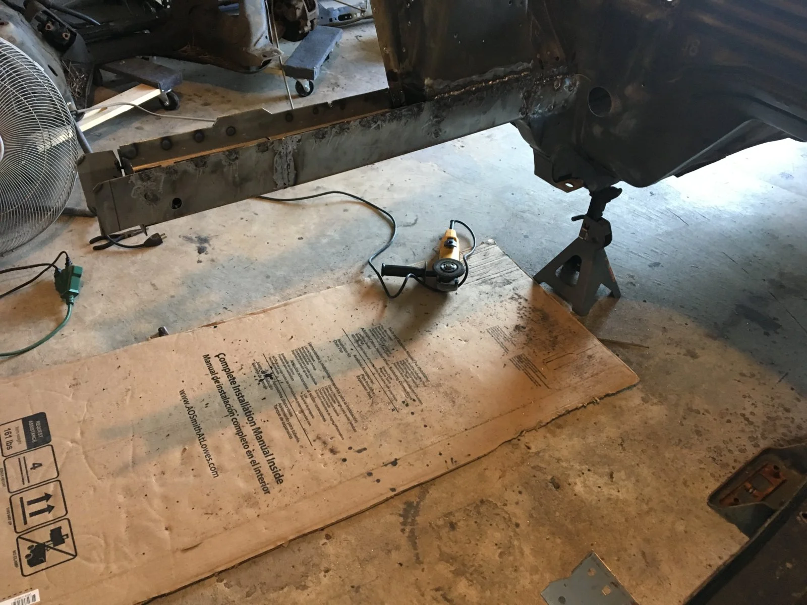

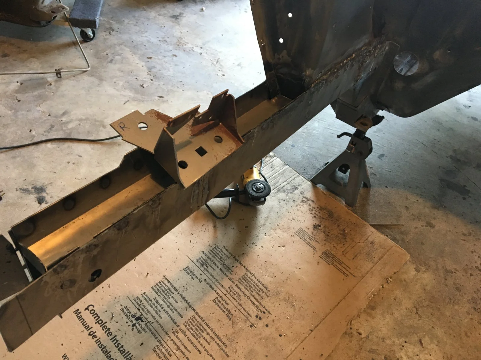

Okie dokie, The frame rail is welded in. It took a little longer than I thought it might (surprise!:nonono:).
I started by clamping the radiator support back on and measuring it out so it was in the correct place. Then I welded up the slot in the middle. After welding that I slobbered some more POR15 on the inside to coat the weld. Then I slapped the front top cap on, clamped it down and welded the living hell out of it.
Then I welded the top cover over the crush tubes.
I dressed (code for grinding, this way I can tell my wife how much I hate dressing:nice:) about fifteen welds and grew weary of that and stopped. Only 50 or 60 to go, plus my perimeter welding.
BTW, if you're tired in the first place, welding pretty only happens about every third spot weld. Whatever, they're good welds and I would have had to dress them anyhow even if I had @Hoytster himself in my garage welding for me! Don't mean to keep picking on you, but DAMN, you weld nice!
So I won't start my double knot, super secret idea until at least friday, probably Saturday. I got to dress all of those welds and still weld in the sway bar mount as well.
So it might be a couple of days before you don't hear from me, you got that @Noobz347 ?

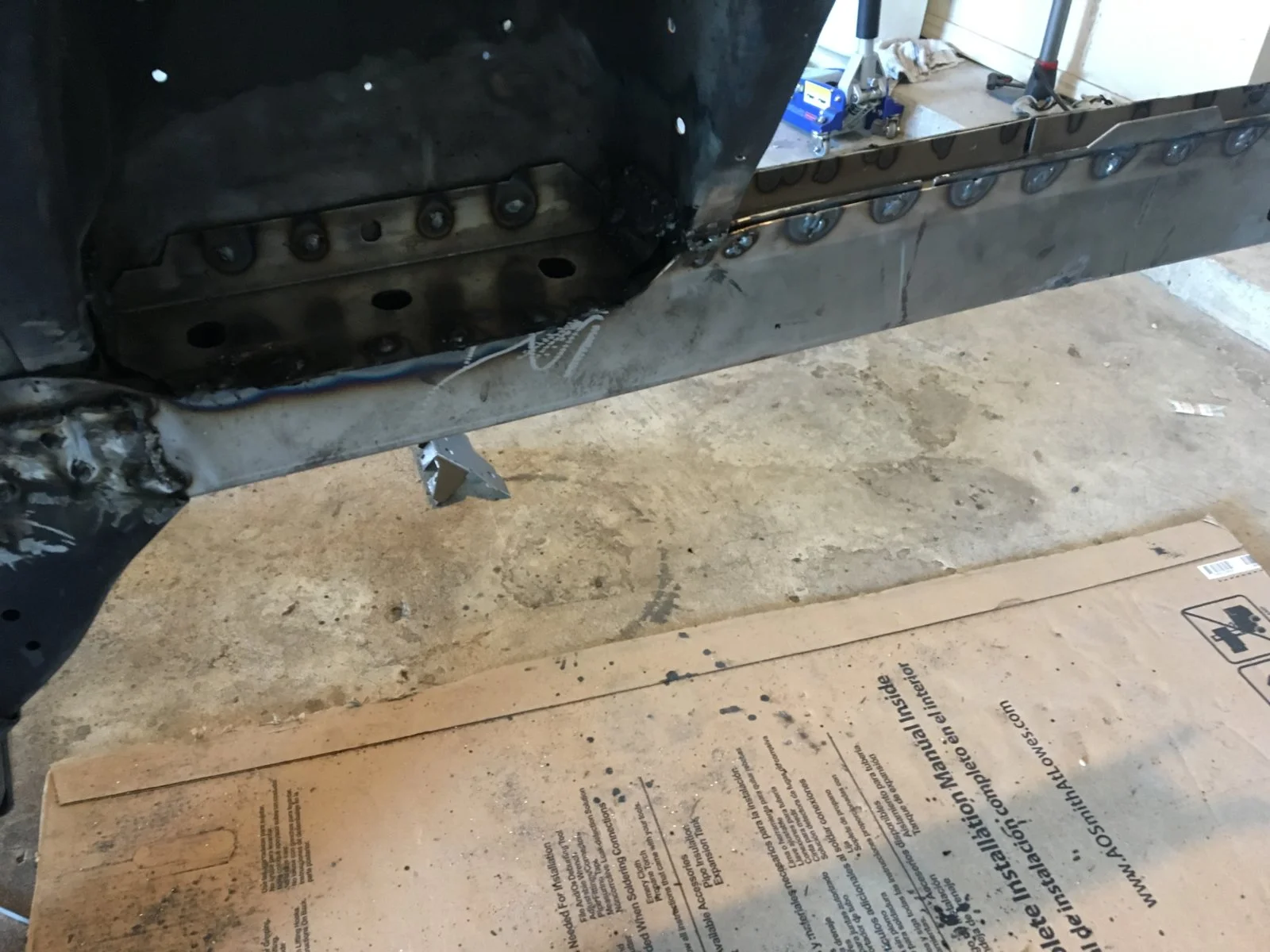

Kinda wish I would have welded all the way across the frame rail where it meets the strut tower, as you did. Cant help but wonder if my patch job is as strong as I hope it is. I focused more on looking original than going for strength like I probably should have.
It’ll be fine on yours Nick. I’m just paranoid about the quality of my welds, so I figure the more, the better.
