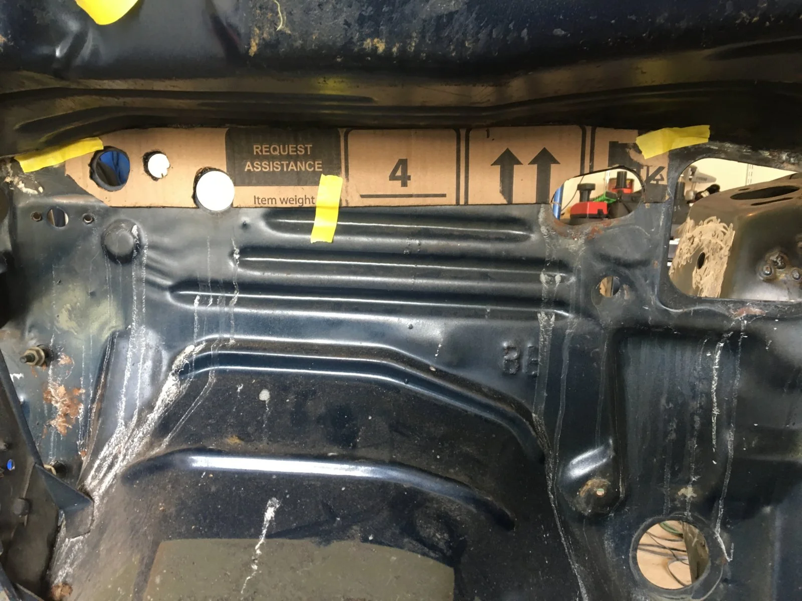

Just a little note about a slight modification I'll be adding since I cut the pinch seam out.
I'm going to take my leftover 14 gauge steel and make a firewall reinforcement that I'll weld on the inside of the firewall. It'll have a 90* "bend" that will get welded to the bottom of the lower cowl panel. So it'll be two strips really that I will weld together before installation.
I'm going to make a template out of cardboard today so I can take the steel to work with me tomorrow and use my plasma cutter to cut it out.
This is to provide extra support for that day that I install a strut tower brace. What do y'all think?
Excellent idea. You cannot possibly do enough short of a full tube chassis to ever get one of these cheese whiz bodies stiff enough!

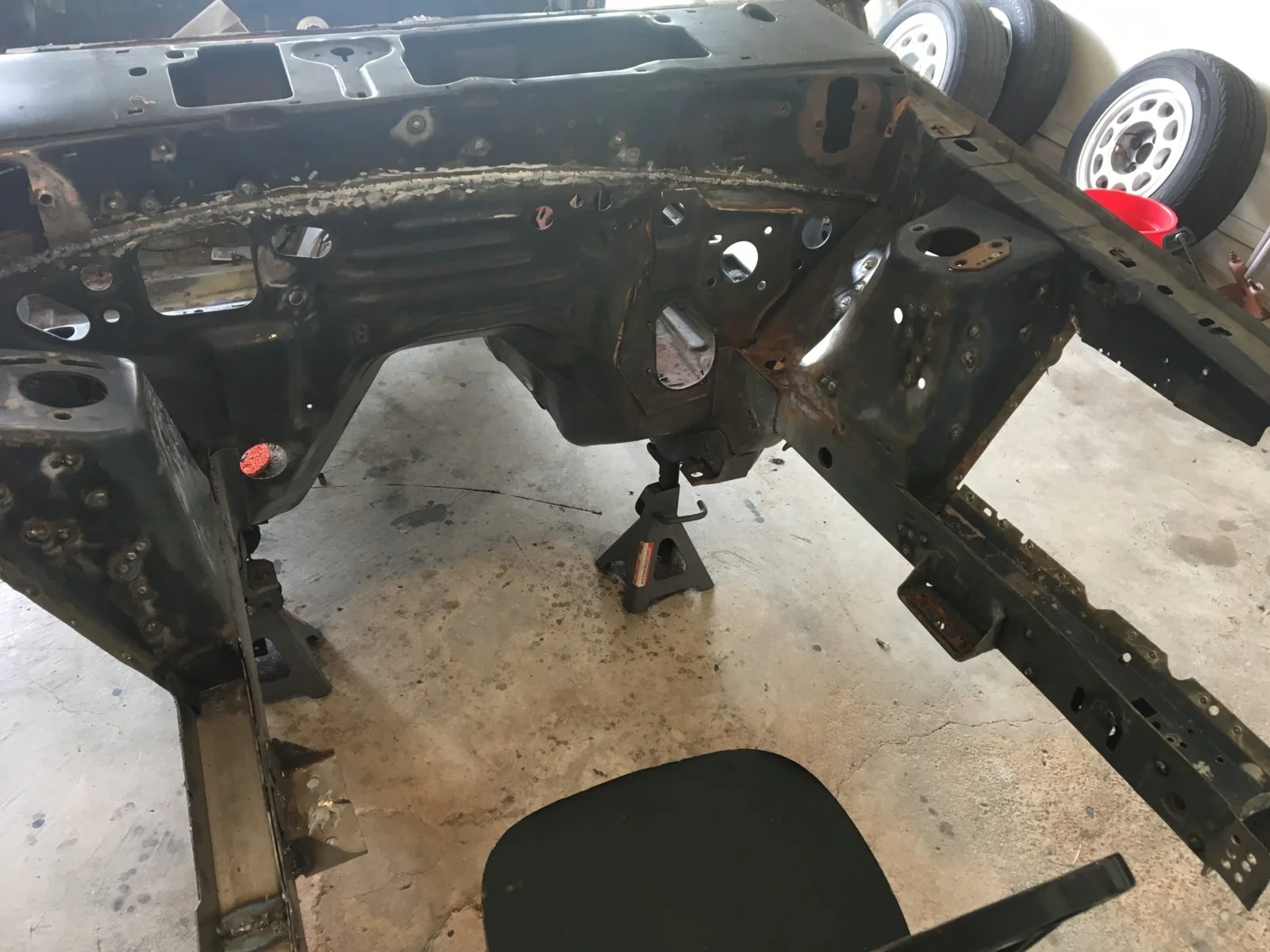

All I did today is weld up the holes I wanted welded up. I did not break my grinder out at all. Tomorrow night after work though I'll get them dressed and I'll get after welding in the radiator support. It may be tuesday before I get to that though.

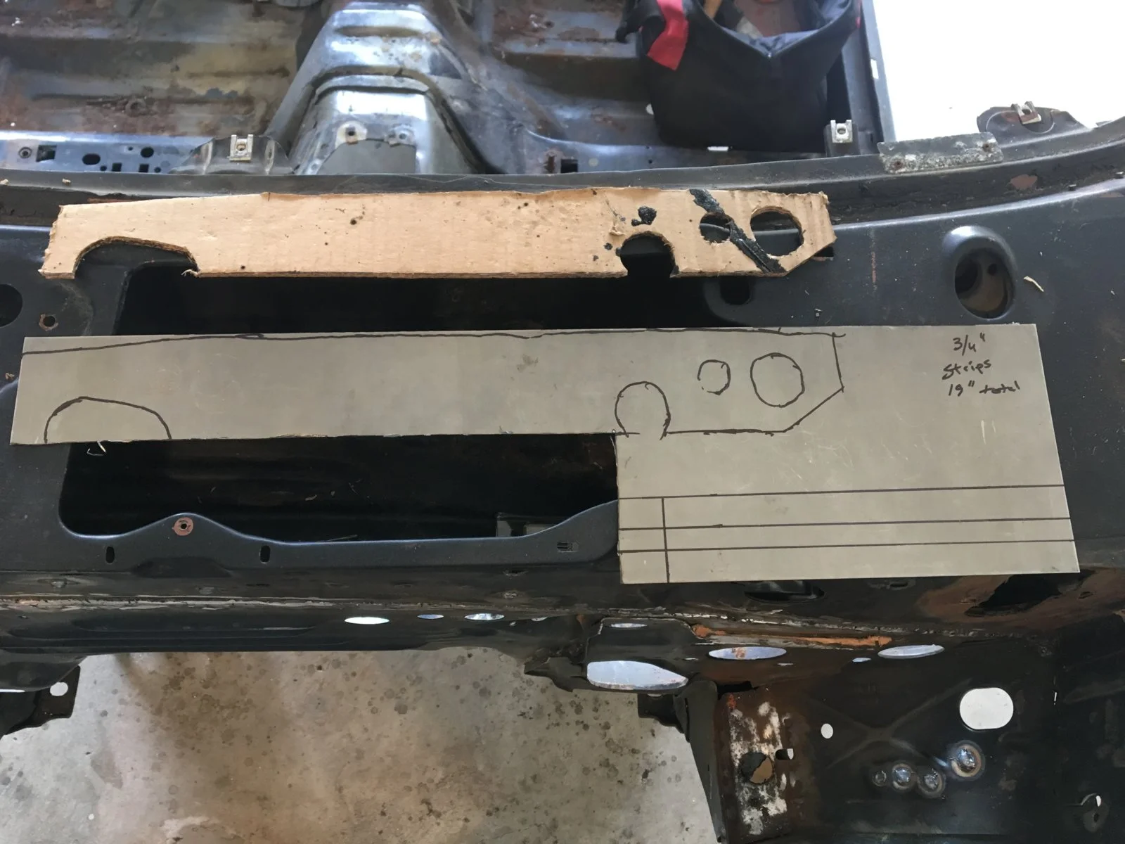

So I made a template out of cardboard for my small brace.
Then I transferred it over to my scrap metal. It'll be three pieces, the main plate and two 3/4" strips to weld at 90* to the plate against the lower cowl panel.
Tomorrow I'll cut that out with my plasma cutter and bring it home to do the final fitting, then weld it in.
