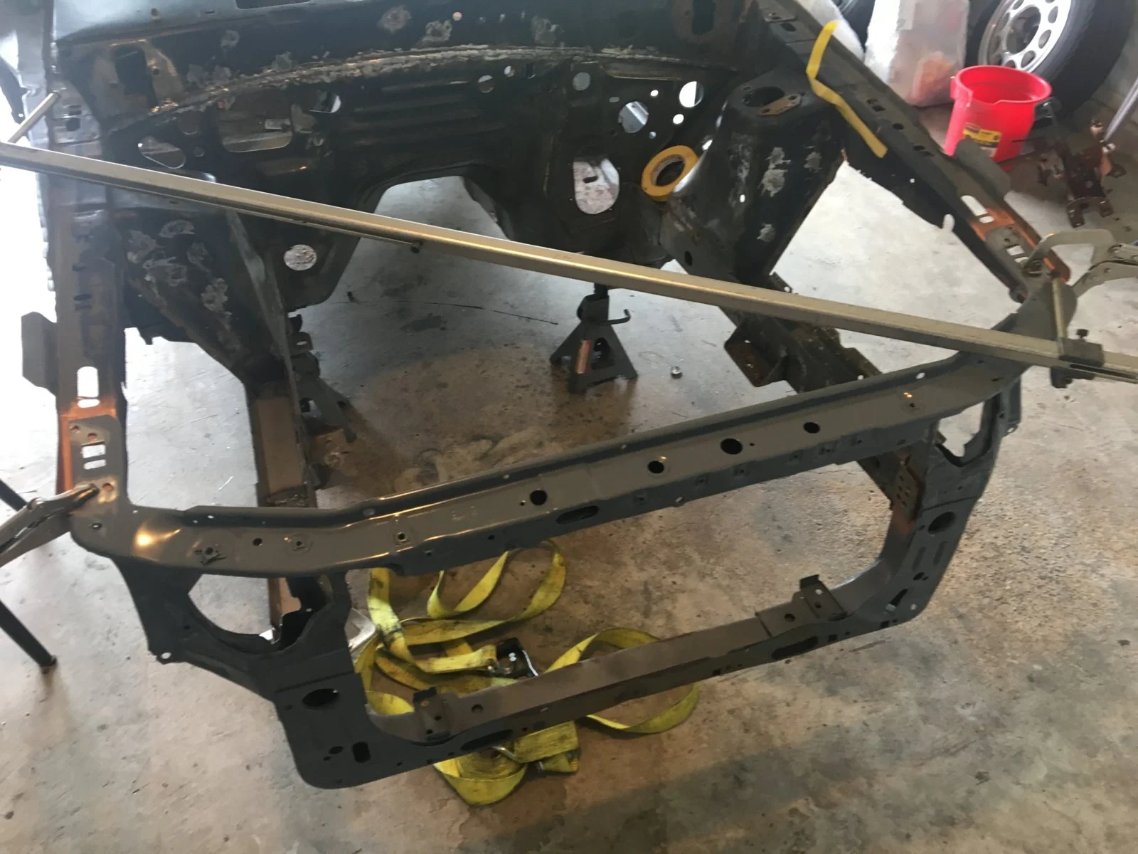

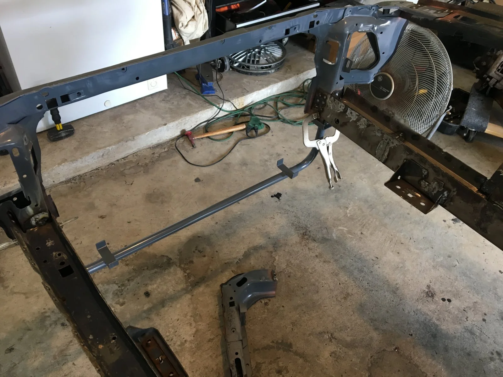

I’m out in the garage fitting up the radiator support. I brought home one of the measuring rods (tram gauge) from work, it’s a lot easier measuring the squareness of it all this way instead of a tape measure.
I got to clean up a couple of the welding areas and then it’ll be on there for good! Yay!:banana:

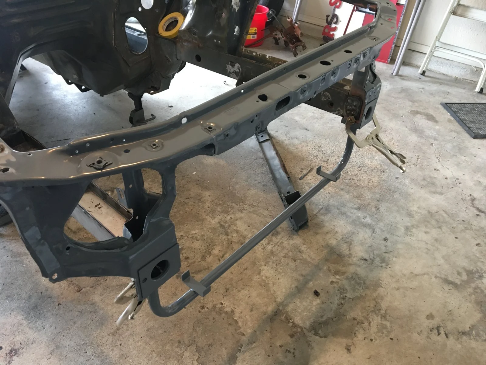

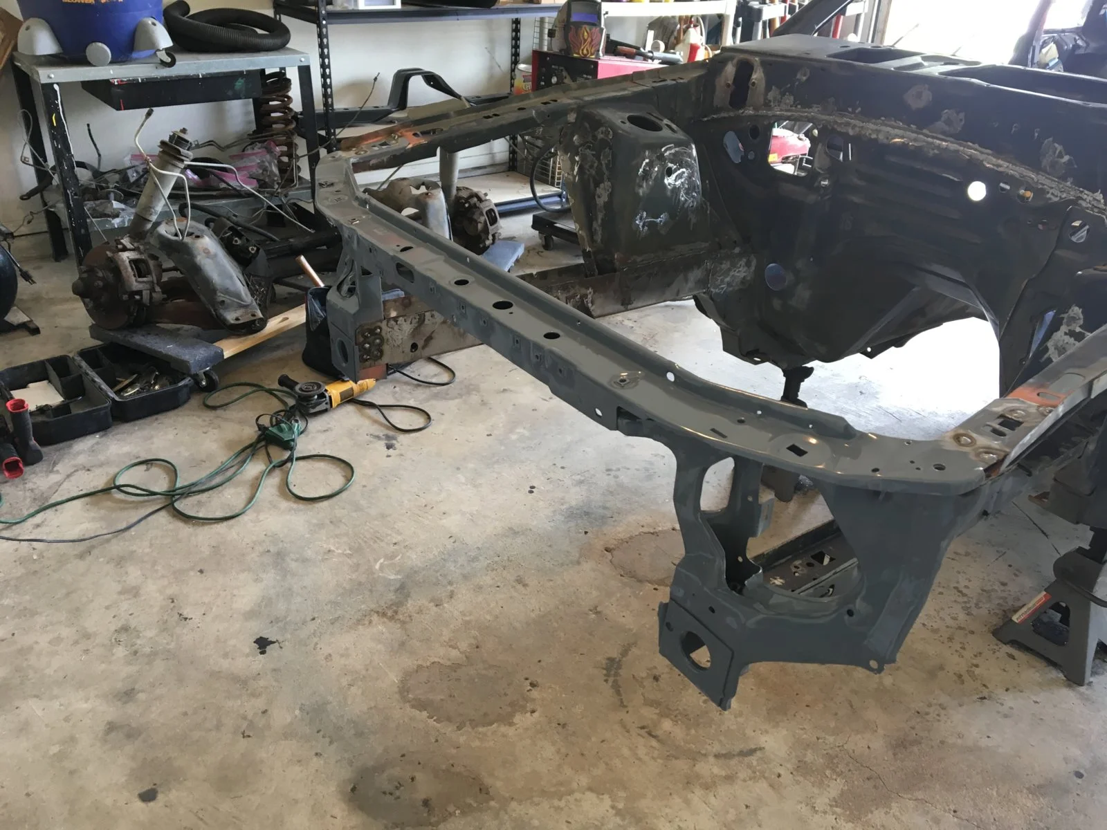

So the next thing is to cut the lower part of the radiator support off and weld this in. I’m not sure if I’ll get it done today. I also have the firewall brace I made to weld in.

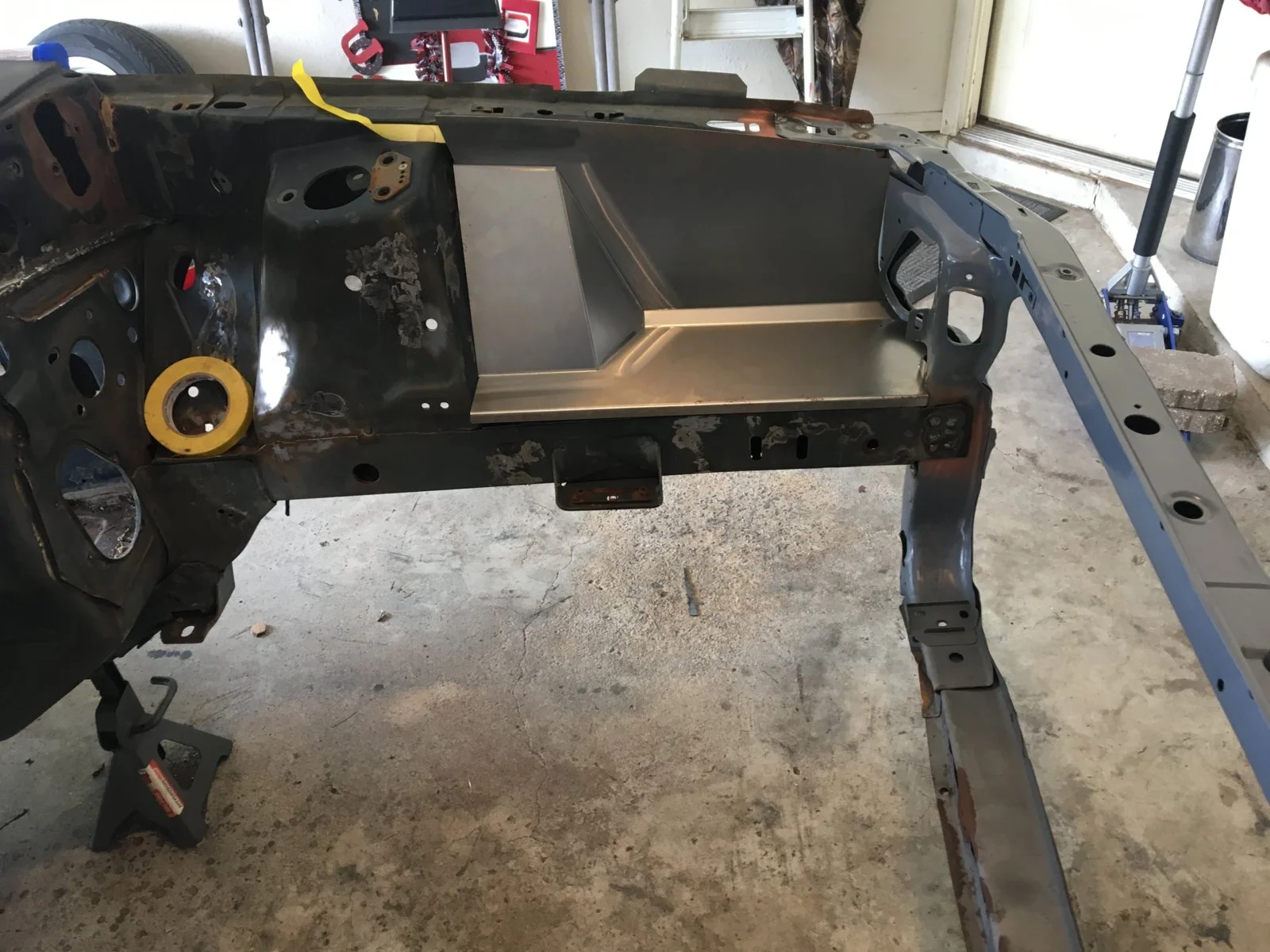

Here’s one with the Scott Rod panel, that’ll be after the lower radiator support.
Starting to look like an engine bay again, huh?

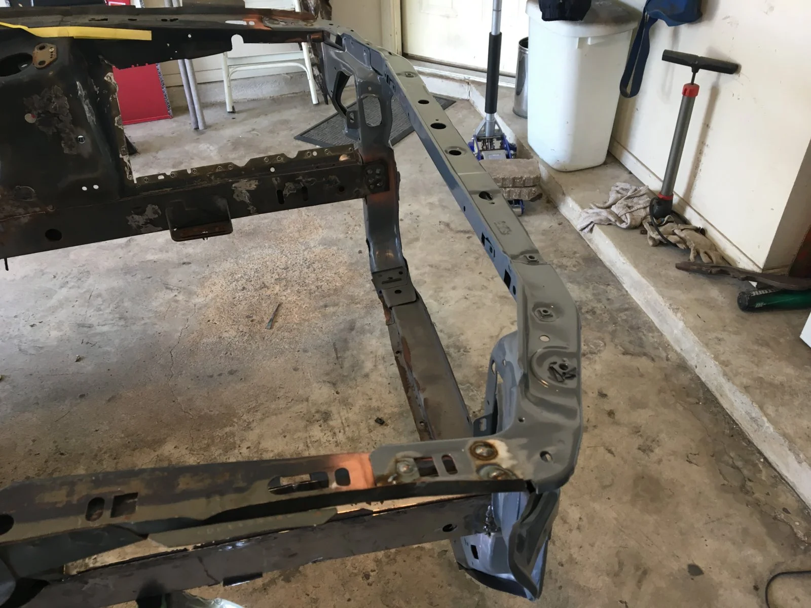

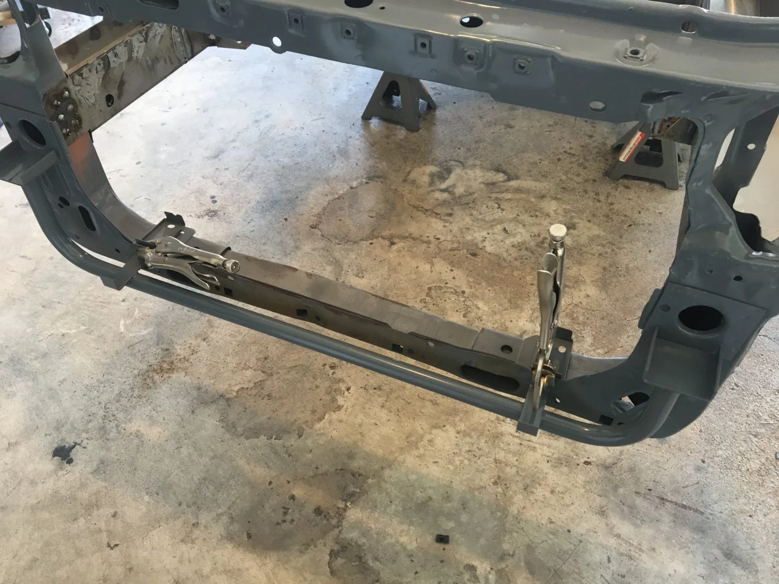

Alright, I couldn't stand it! I got the reciprocating saw out and cut off the lower part of the support.:fuss:
It's not trimmed up to where it needs to be yet, but I had to see how it would look with the Team Z lower. I like it bunches.:rock:
I believe that I'll leave the lower off till I'm almost done smoothing the eb. It's easier to get in there and work without it in the way. I will get it all fit up though.

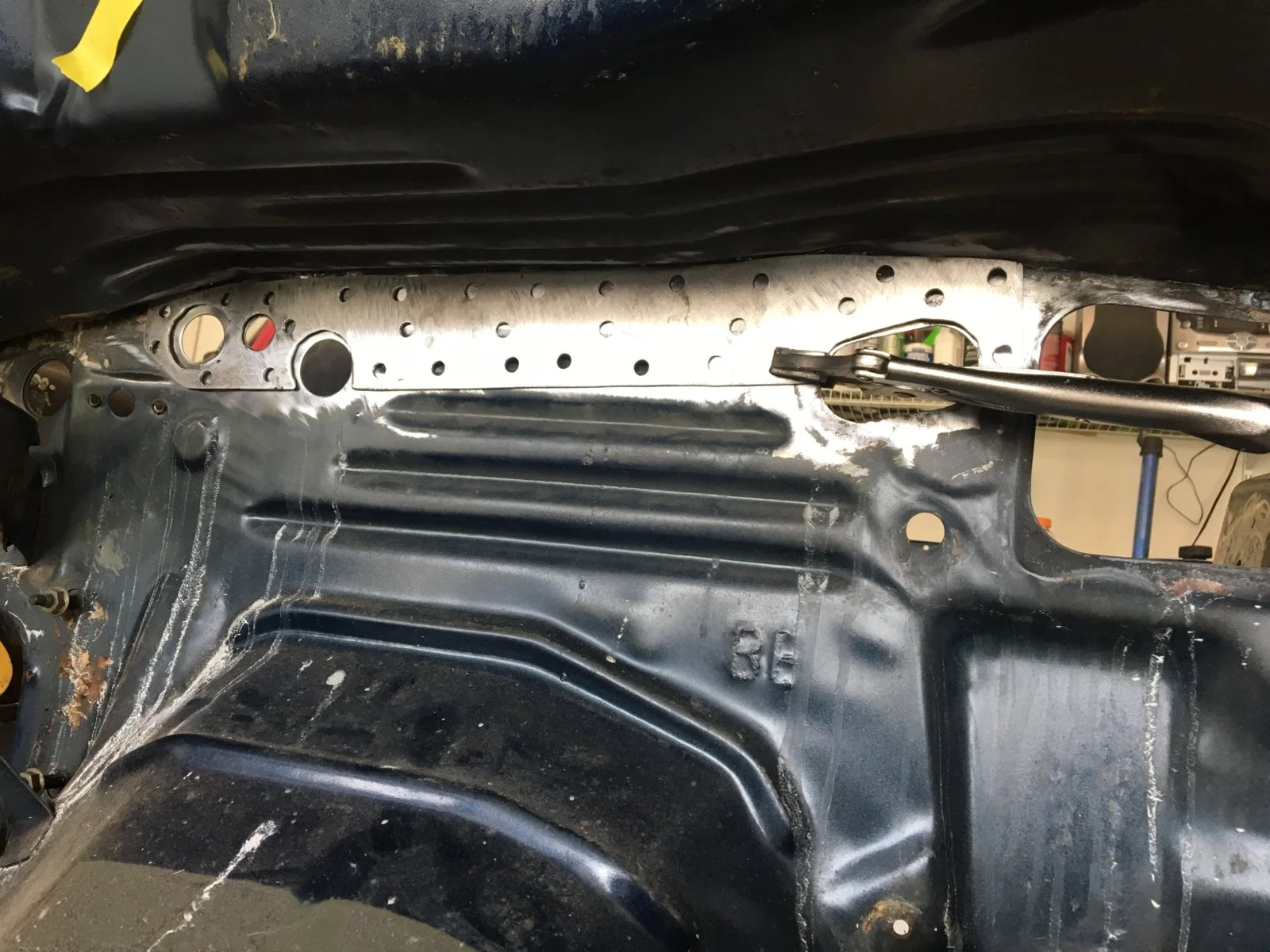

I trimmed the firewall brace and got it fitted. I know that's a lot of holes. I'm not going to weld everyone of them. I wasn't sure exactly where I would be welding it because of the contours in the firewall, so I just drilled the hell out of it at work. I still have bits there that will cut a hole in steel, lol. My ones at home are now good for wood and some plastics.:nonono:
if you remember in my thread, i had to re-make those radiator mount tabs with the same piece. don't know if it was just my situation or what, but just an fyi. if i hadnt dropped the front end of mine and crushed the lower bit, i wouldnt have even bought/installed it.
I’m out in the garage fitting up the radiator support. I brought home one of the measuring rods from work, it’s a lot easier measuring the squareness of it all this way instead of a tape measure.
Tram bars Dave! Loving the progress man
