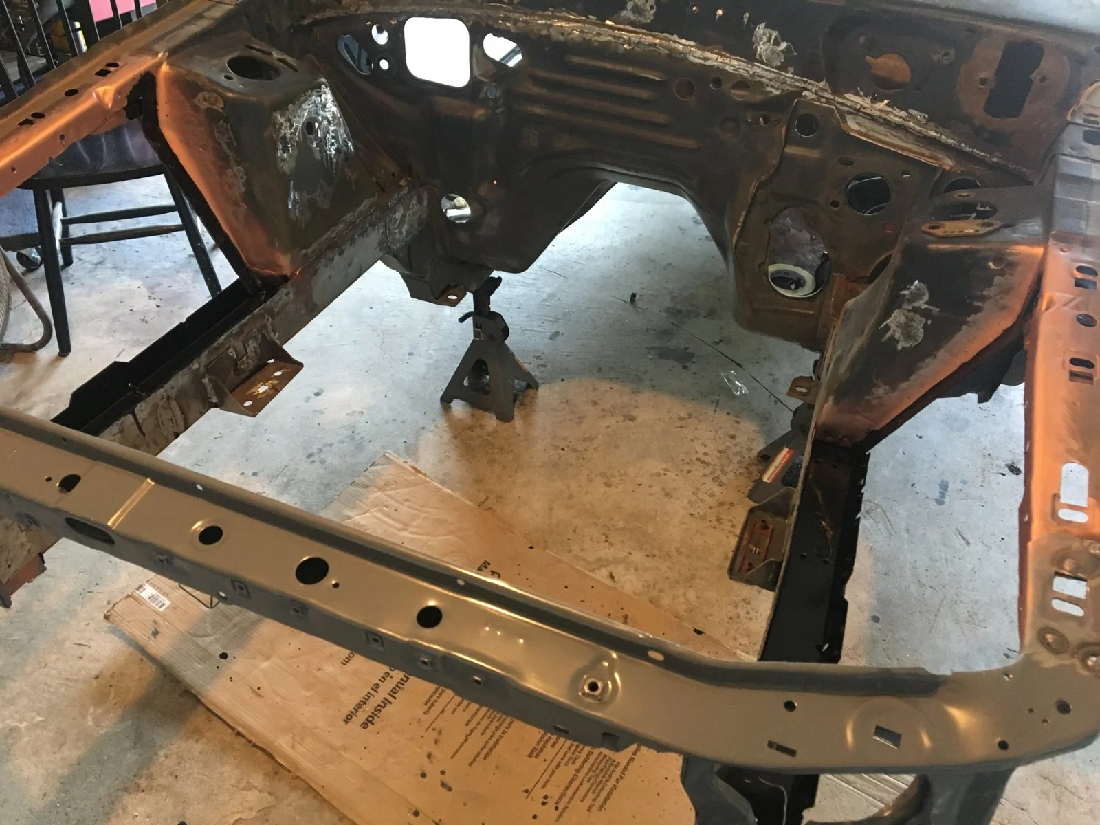

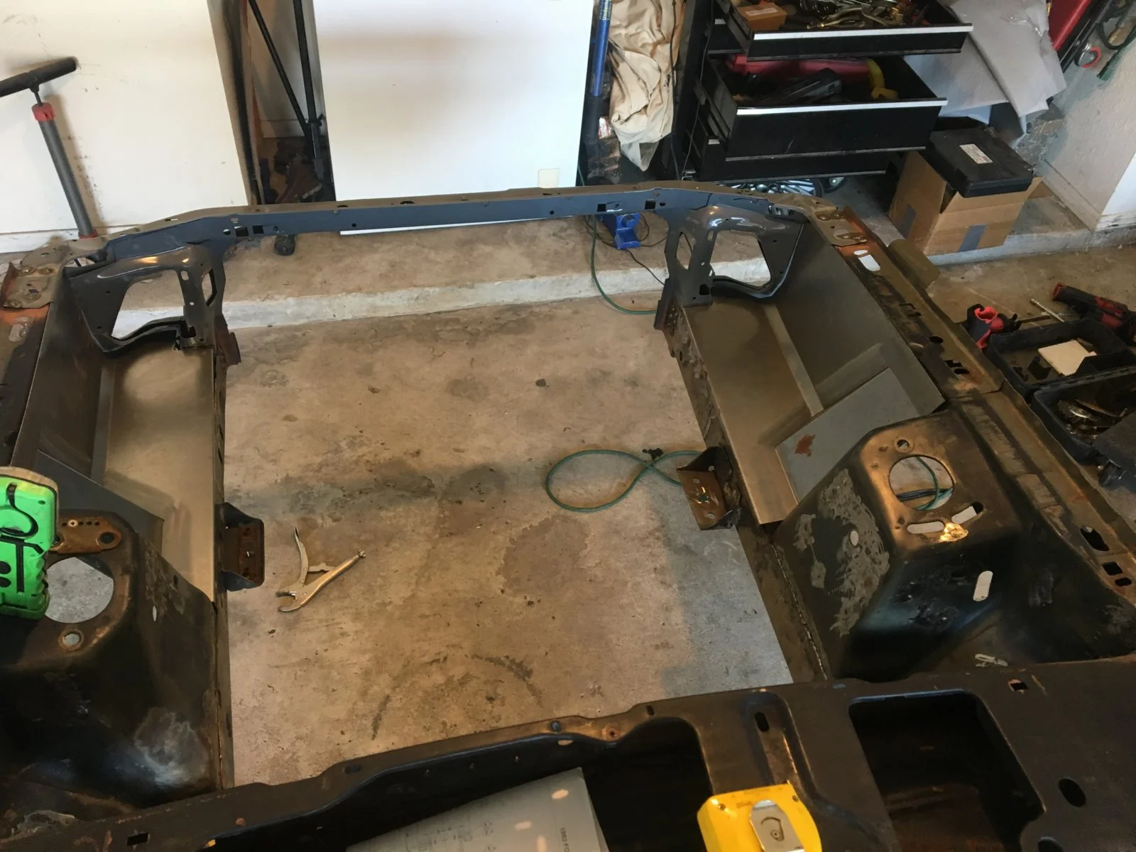

The mounting tabs are a bit wide and will need some modification to get it to fit correctly.if you remember in my thread, i had to re-make those radiator mount tabs with the same piece. don't know if it was just my situation or what, but just an fyi. if i hadnt dropped the front end of mine and crushed the lower bit, i wouldnt have even bought/installed it.
Nice work... as always Dave !!!!
The mounting tabs on my team z lower were ok. I had to trim the factory rubber insulators a little and it all fit together. You will have to make brackets if the ac condenser is going in.

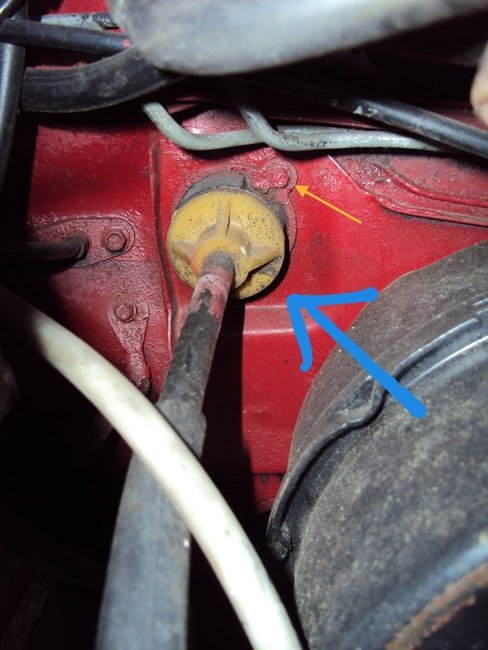

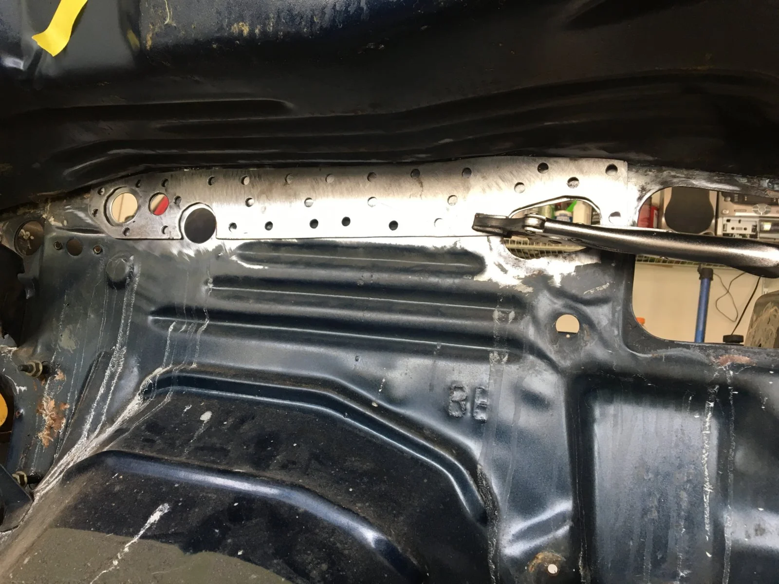

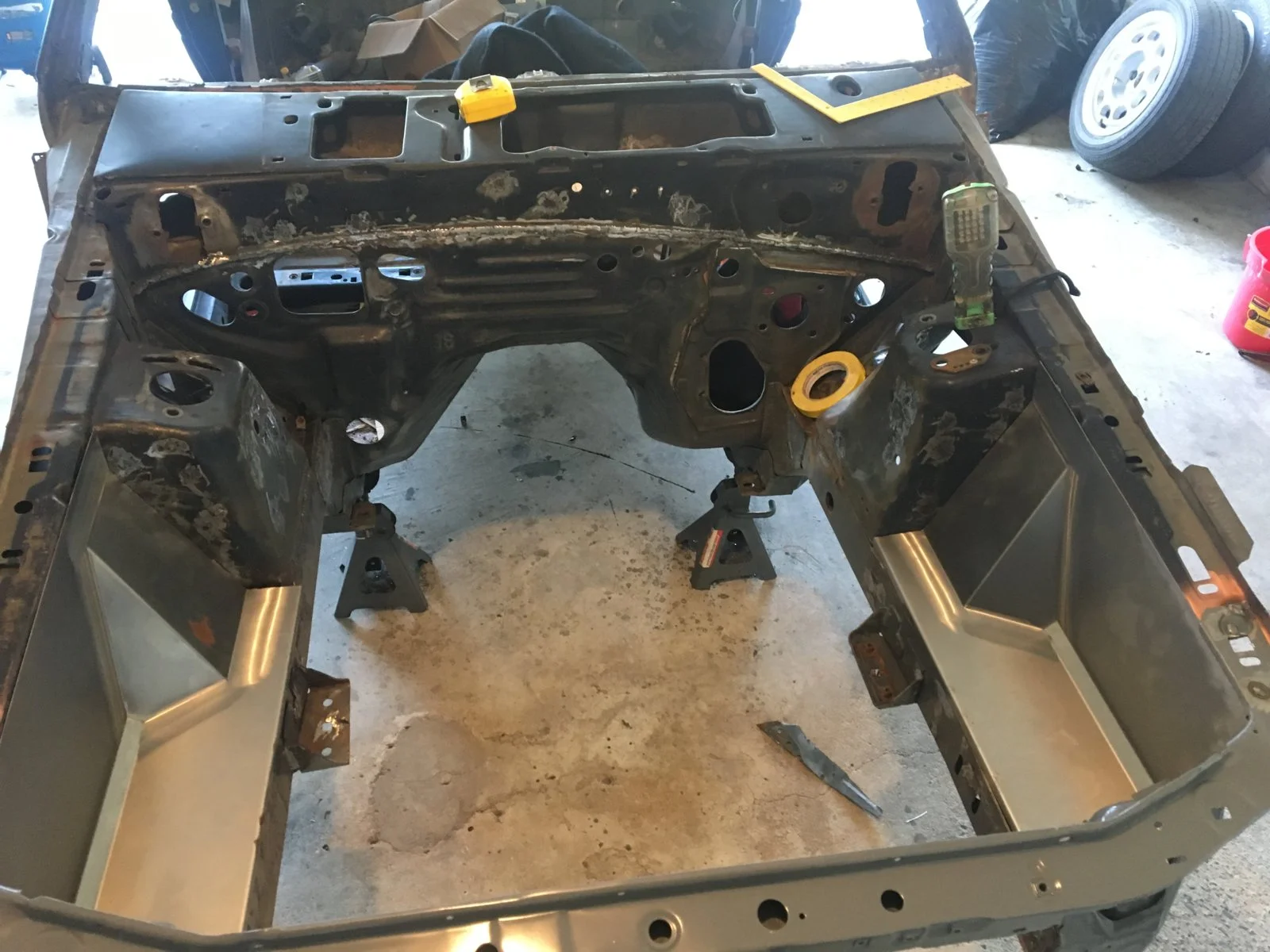

If you're going standard shift now is the time to reinforce the area the cable comes through the firewall. It's the hole to the top right of the booster location. I've had several personal and customer cars with collapse in that area.
I’ll take a look at that tonight, thanks ScottIts the hole just to the left and a little lower than your extra support. It shares the same reinforcement as the power booster on the engine side. Most people just weld a square piece of sheet metal on the engine side with proper sized hole drilled in the center.
Your reinforcement plate doesn't touch that area.![]()
