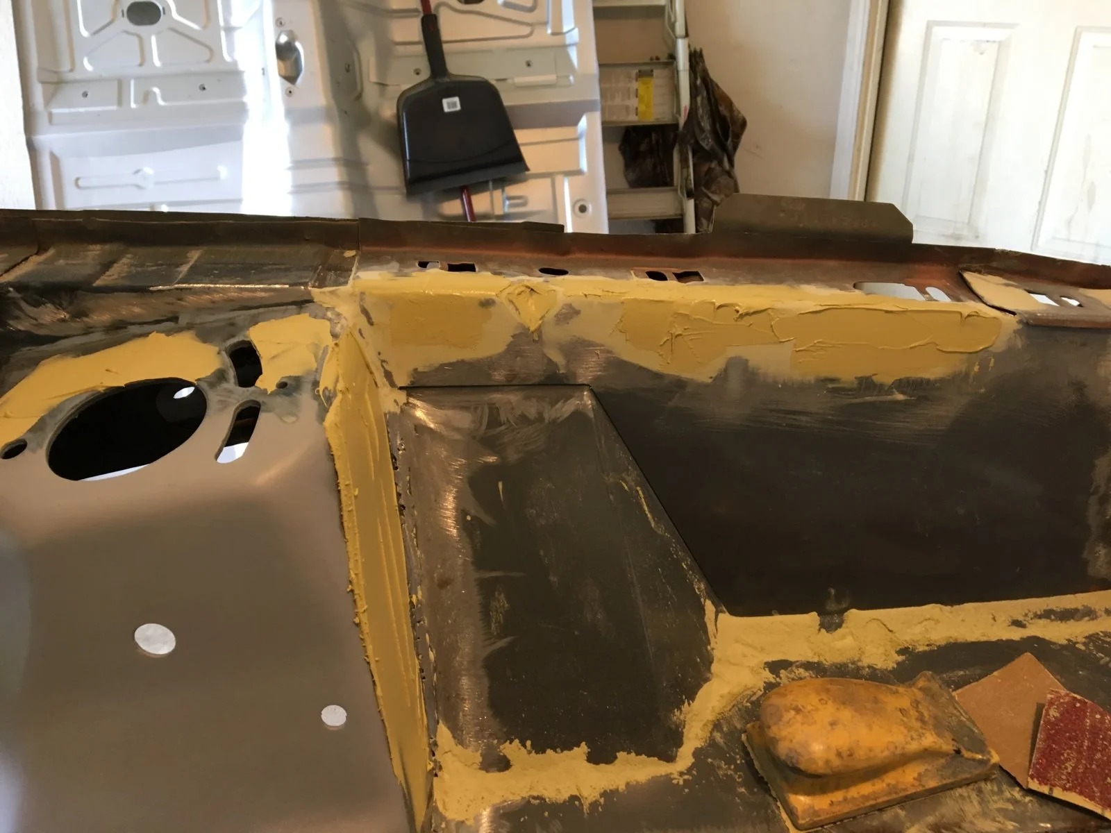

I'm going to have to remember that. There is a tear in my '95 Cobra's rear bumper from a stray piece of copper on the road that I need to fix someday.That was Panel Bonding Adhesive, monster strong glue. 8115 is it's 3M number. Polyflex bondo, it's flexible when hardened.

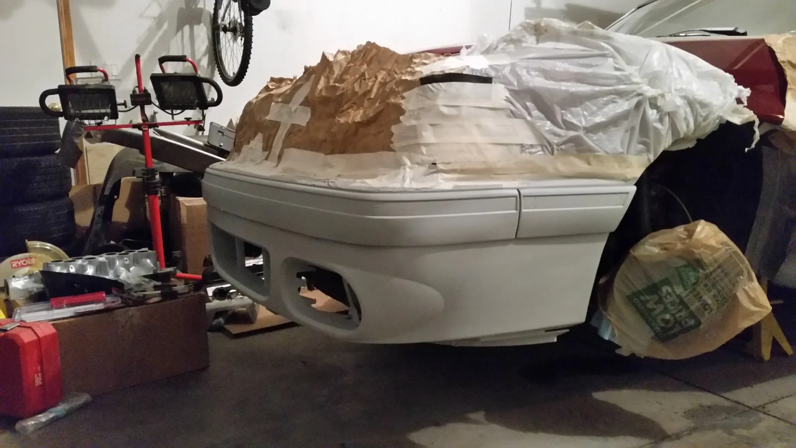

Yay me!I built my front bumper using the 8115 as Dave suggested, and its awesome stuff. Bumper seems like its one solid piece.

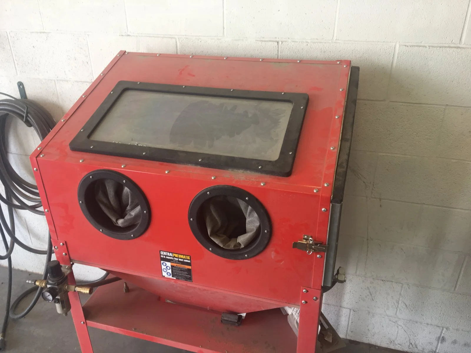

Apparently these use shtloads of air Noobz, that’s the biggest problem I hear about these.I keep threatening to buy one of those. They're cheap, even. What I've not done is wired my garage (workshop, I can't get cars in here) with the 220v my compressor needs.
That and away to keep any moisture out of the lines.

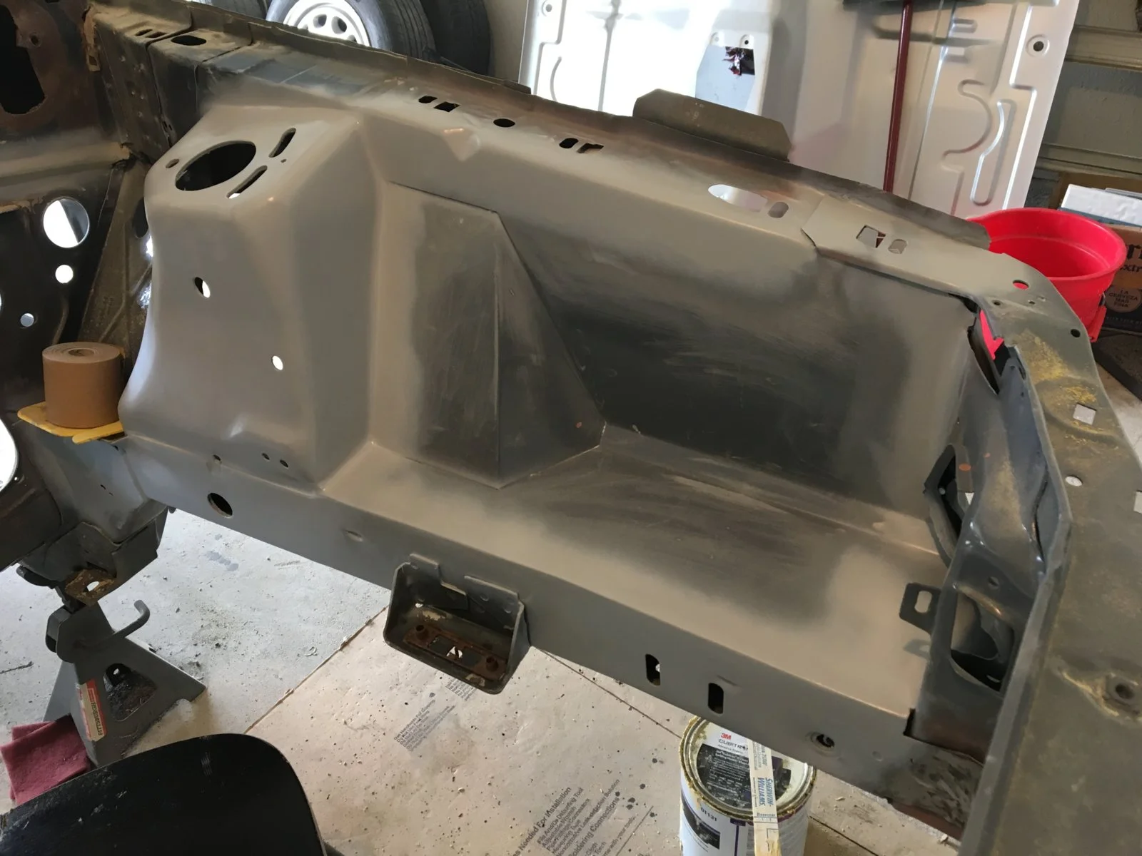

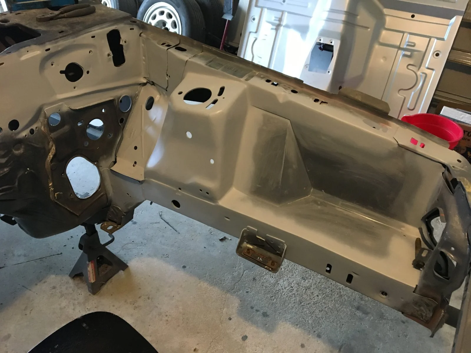

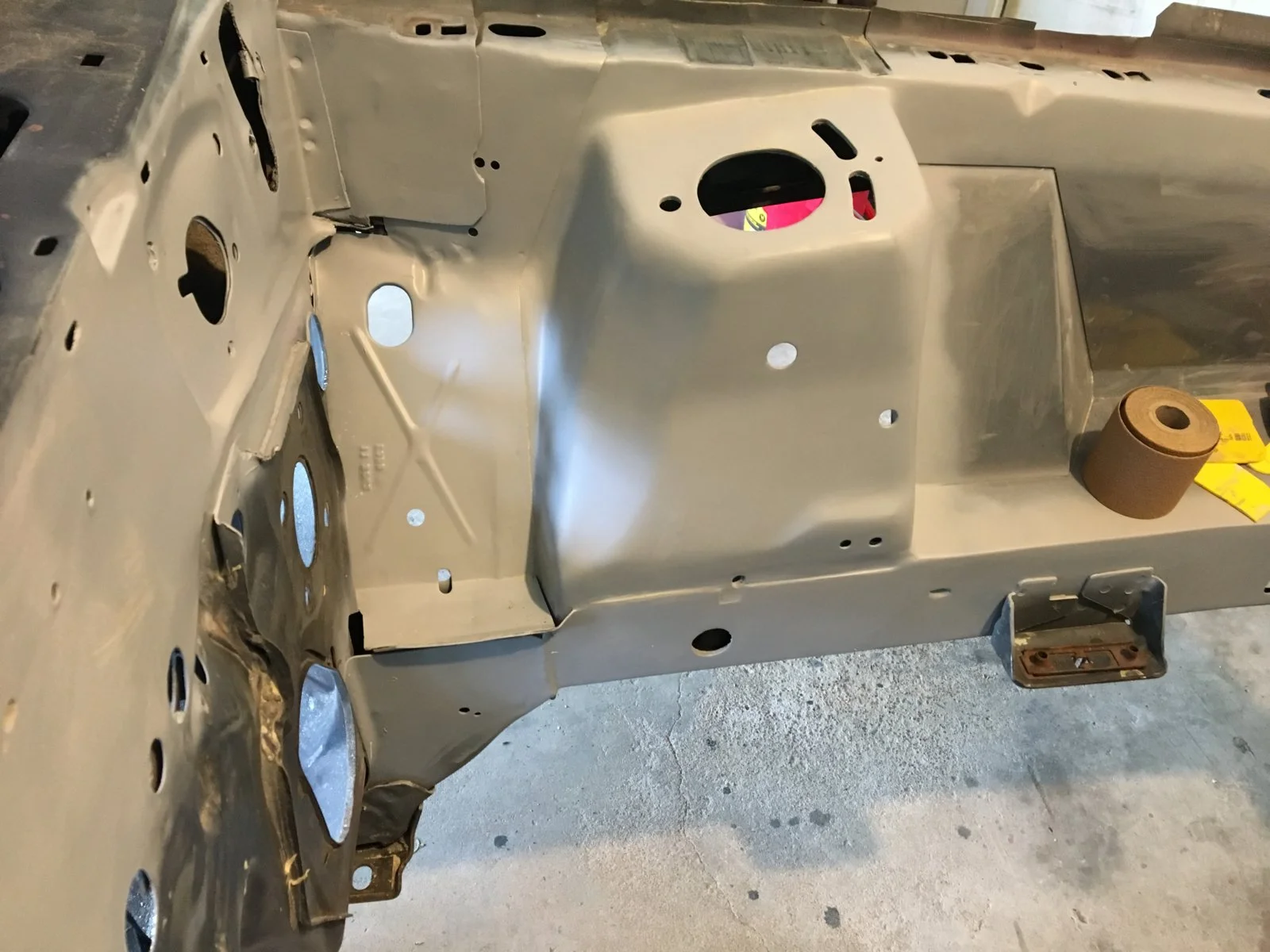

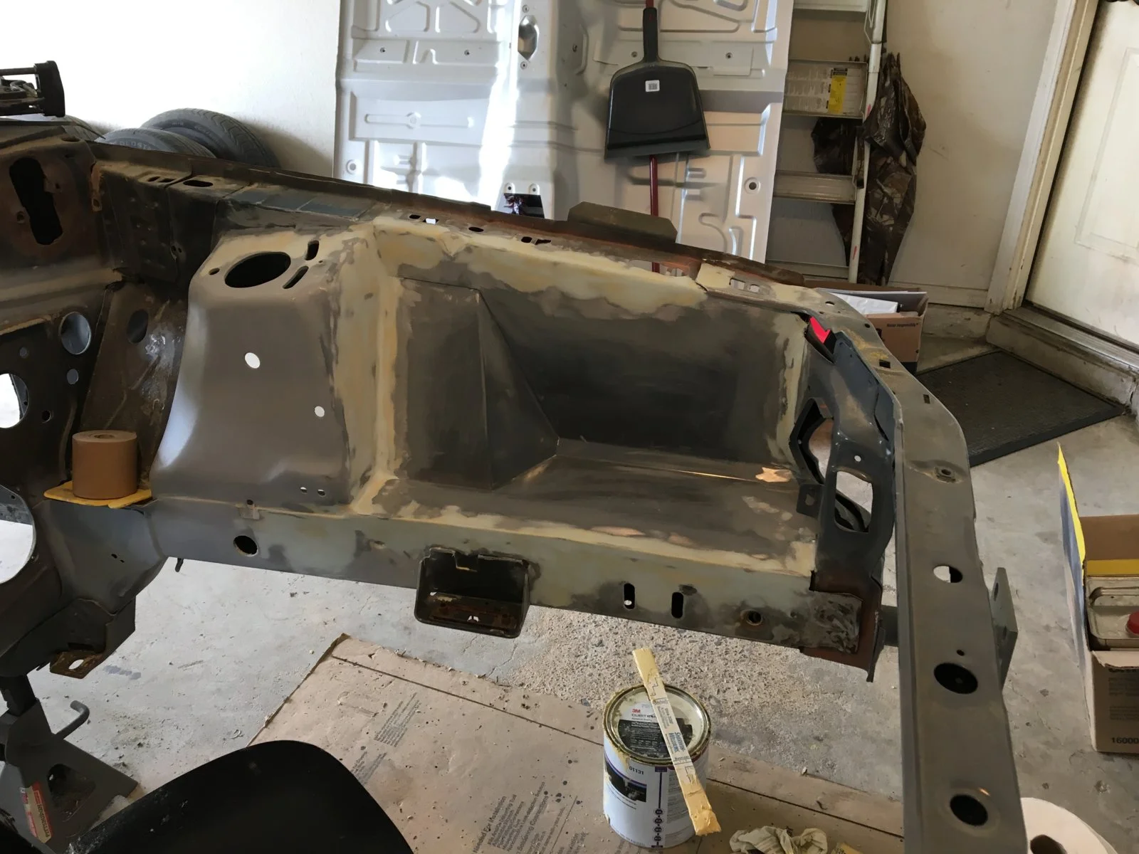

It made the seat so much stiff when driving. It felt like I added spring rate to the suspension.It's because the SR panel comes out to the other side of the frame rail.The flat part looks really deep compared to the stock apron..is this an optical thing Dave?
Wait....you're gonna get all anal on the engine compartment, then blow off capping the frame rail area behind the strut tower?Ok, I only made it through the area behind the strut tower and part of the firewall just past where the wiper motor goes.
