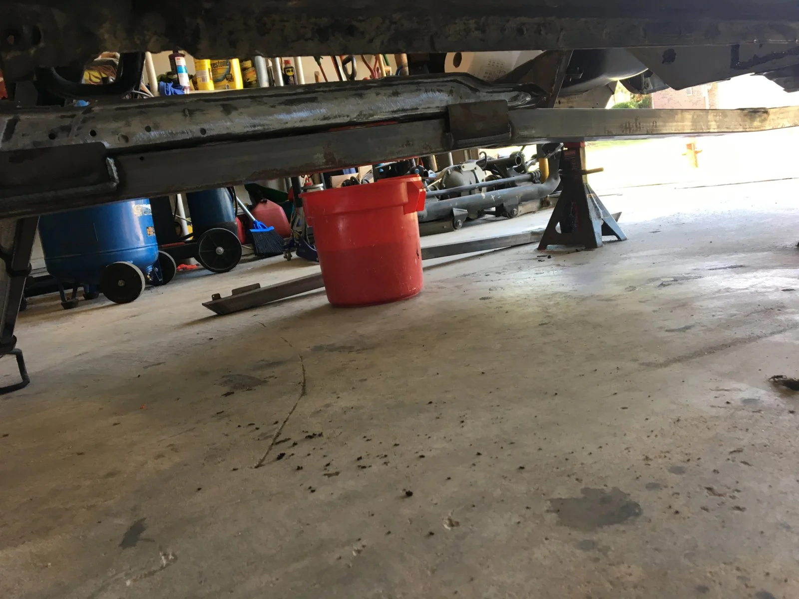

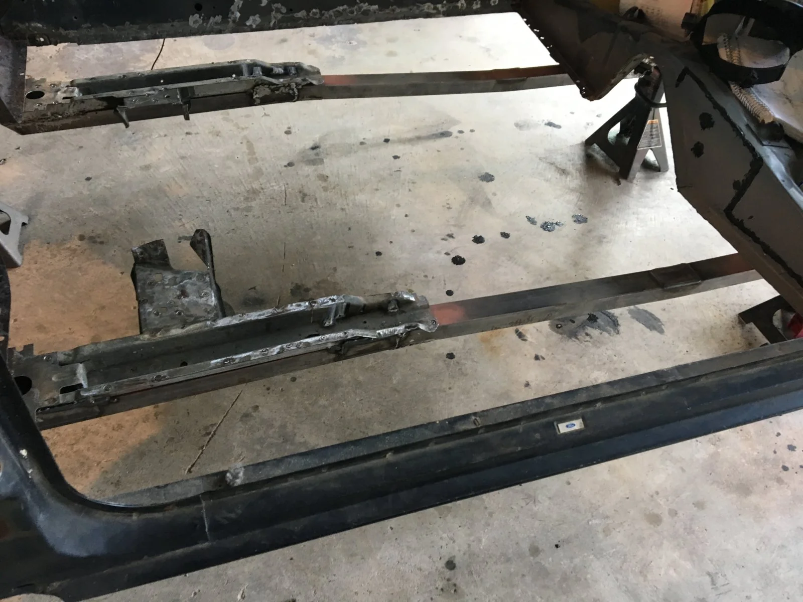

Today is subframe connectors day.
I moved my jack stands, swept the floor and laid down to take a look at my subframe rails. They were filthy dirty, I'm shocked!
The left side looked like a tar truck made a deposit. So I spent about an hour cleaning. The trans mounts were particularly gummed up. I had to use my knife to scrape the goo off before I could clean them out. Bright side is that Booger is just a little more clean now.
I ground off most of the paint I'll need to for welding and probably even more.

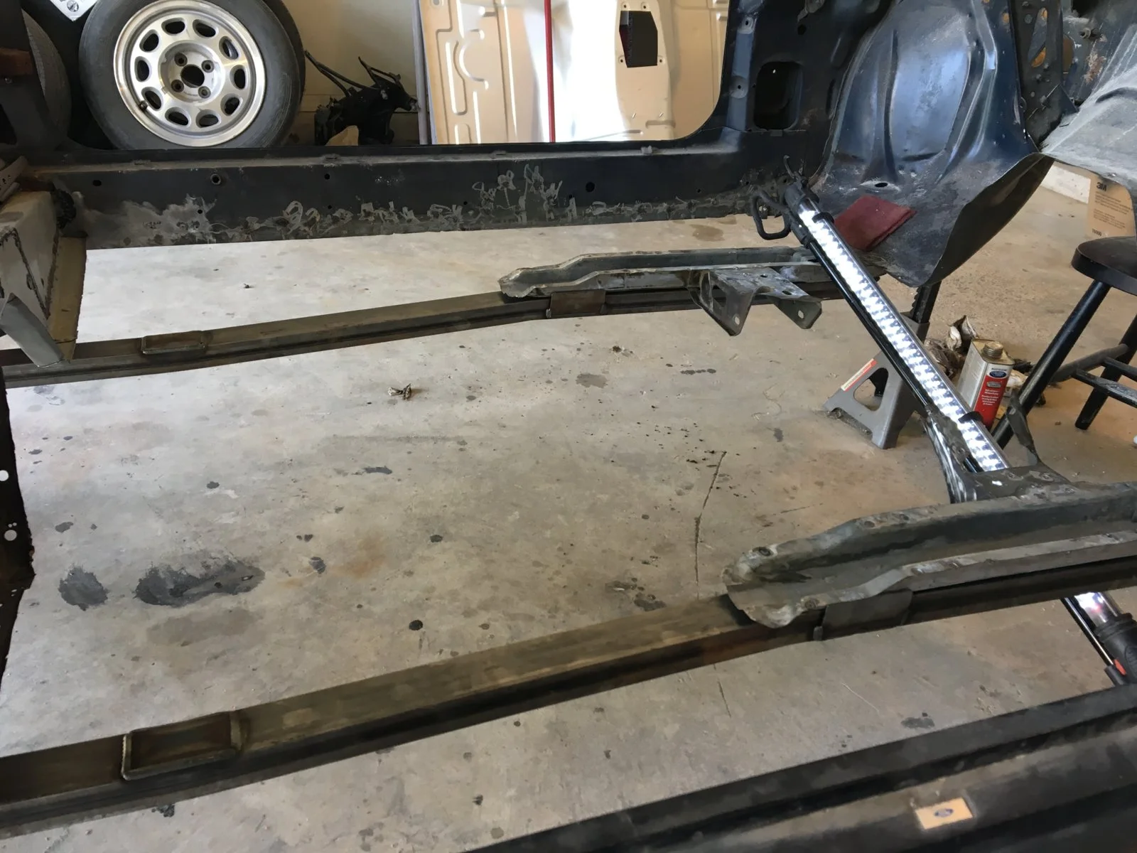

So for the beginning of pictures, and for were I am now.
First picture, this is the beer I'm drinking while I type.

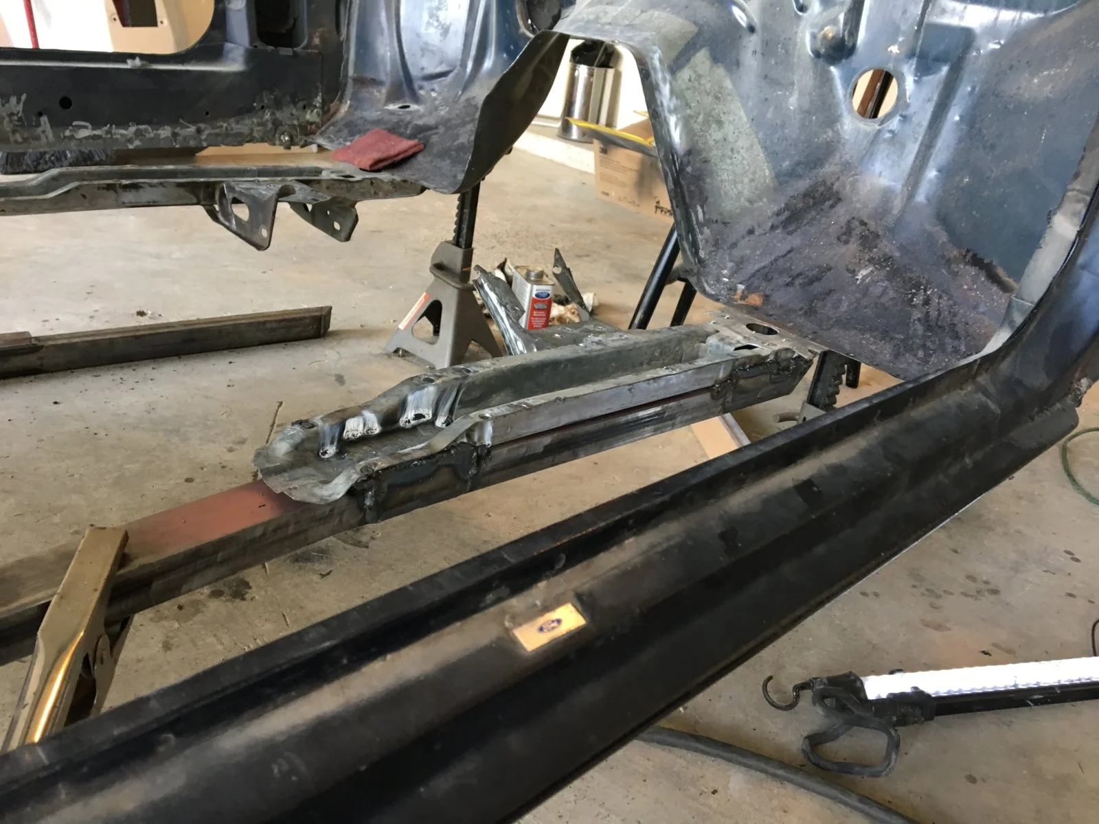

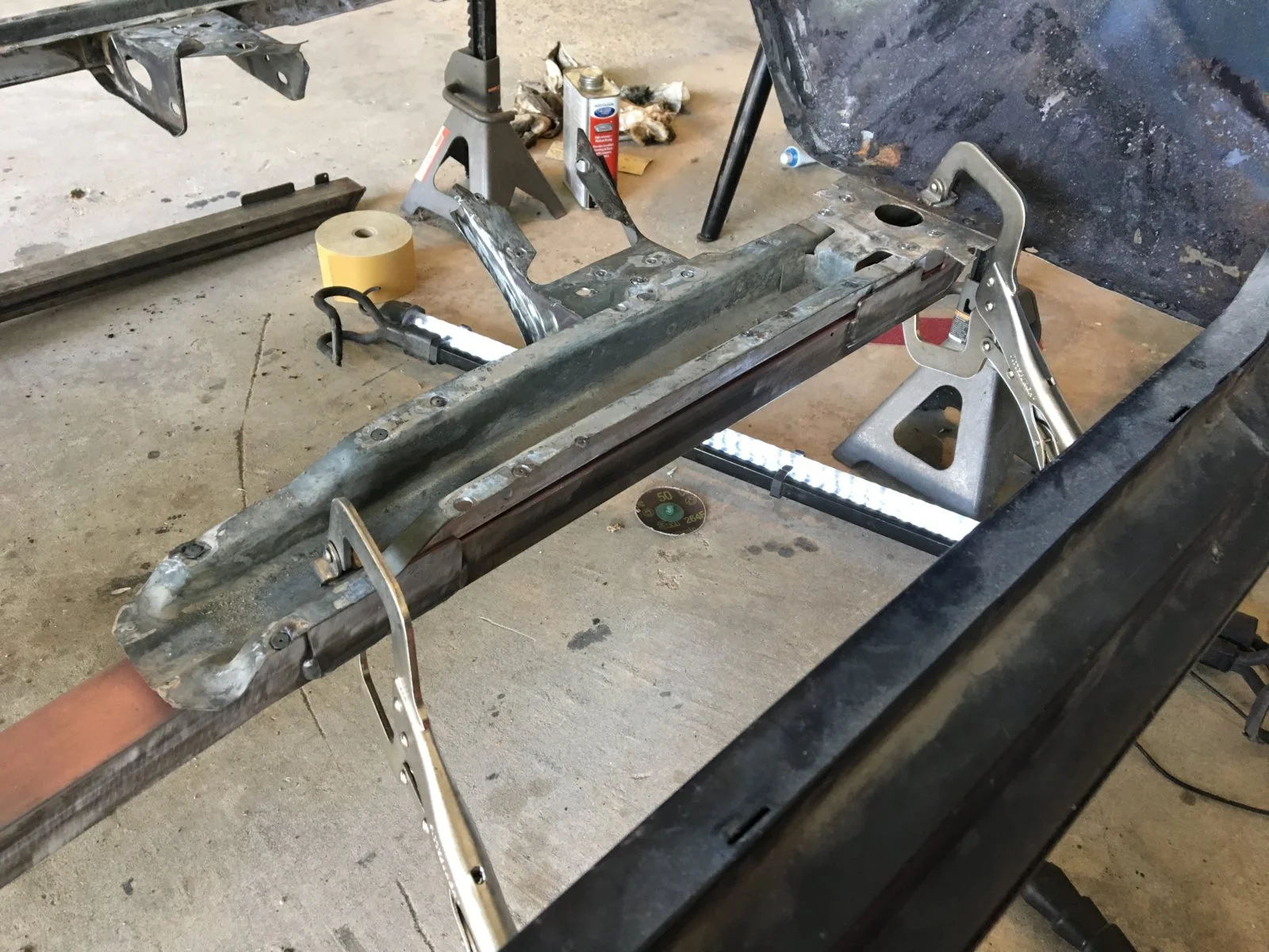

Here's the right side connector, isn't it pretty? MM has nice stuff. This side looks to be a breeze. It's just being held up there by the middle supports. It should weld up pretty quick.
Now for the little problem child. The left side. Look toward the rear of the car, the gap is so big you may not even think it's a gap and just not on there properly. It's going to take a little tweaking. Really nbd though.
Here's just a gratuitous view of the floor area with both sfc's.

I got the right side welded on, here’s to hoping I can make prettier welds on the left side.:nonono:
It’s super easy with the floorpan out, I recommend that to everyone, lol.

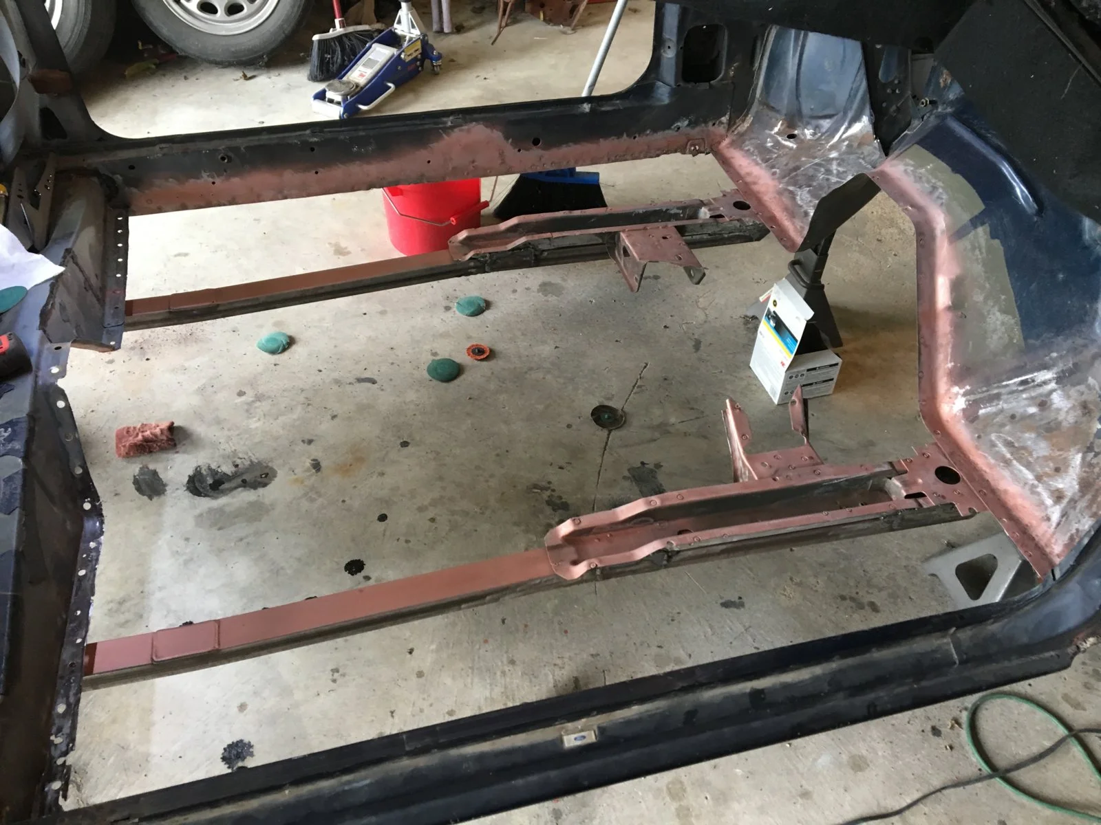

Alright, I got both welded in now.
Then I dressed my nasty welds and cleaned up the garage.

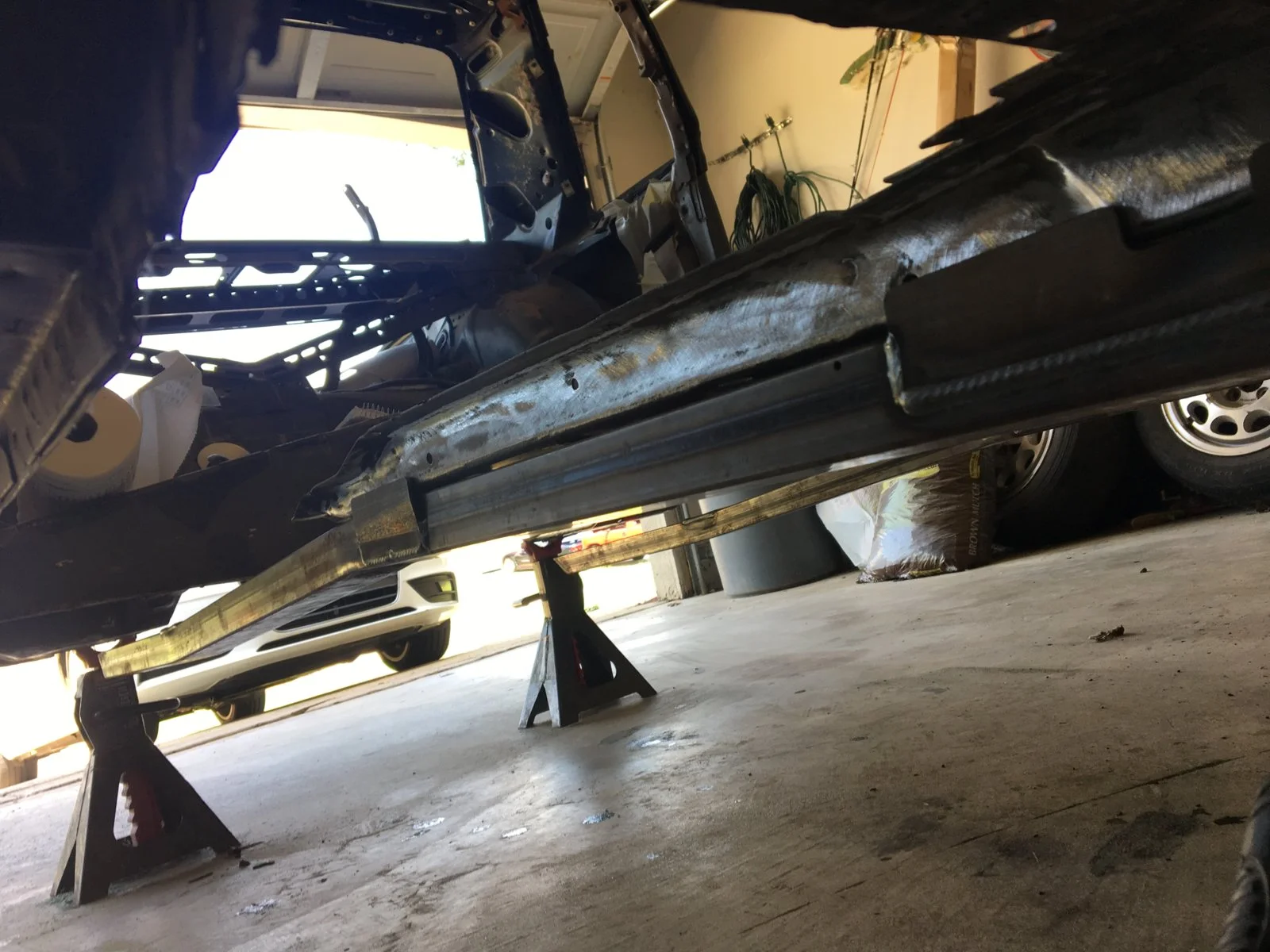

Here's me standing on the sfc's. It's amazing how more solid the car feels with them in there! No bouncy feeling even in this state.

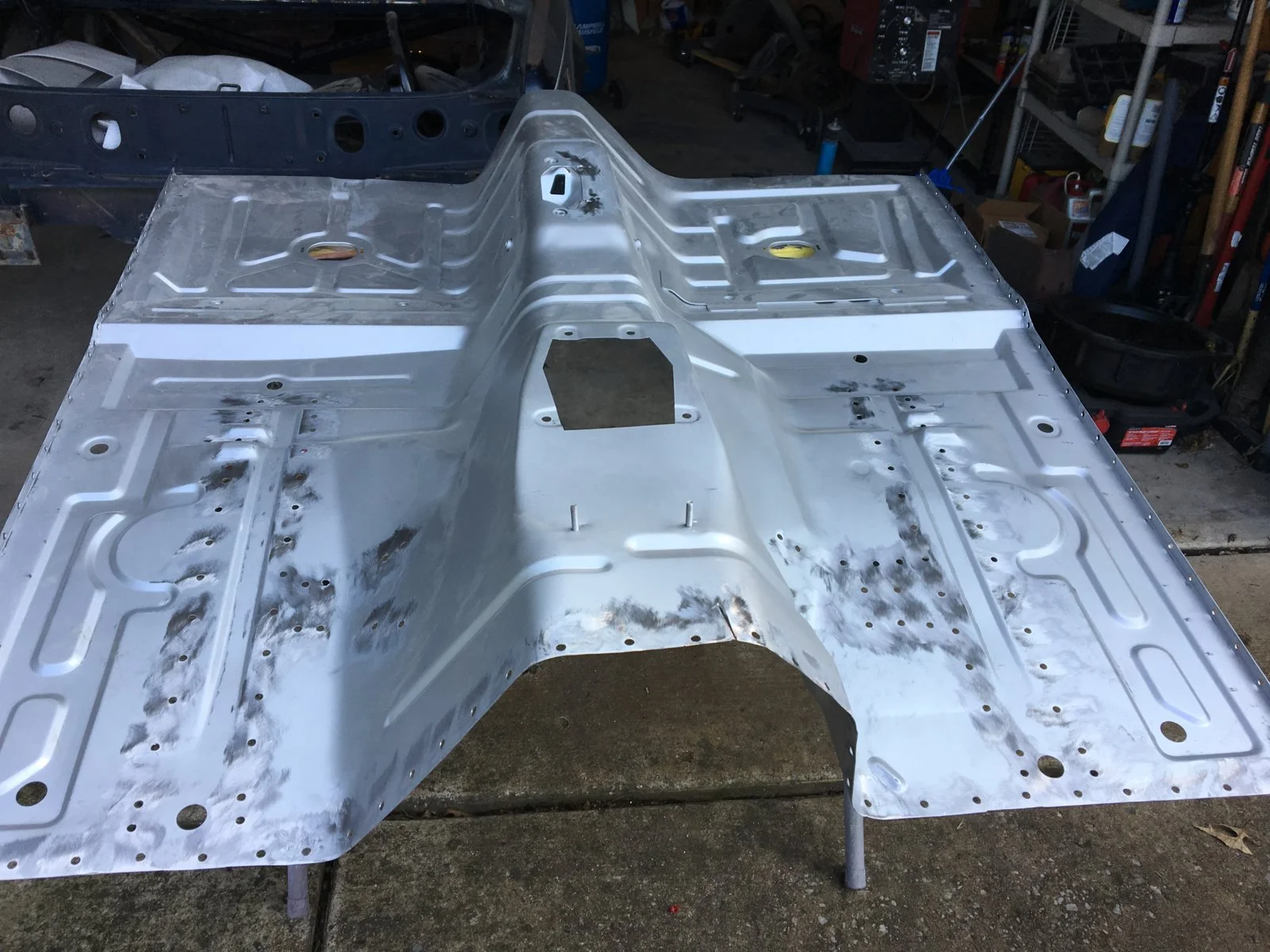

So far I’ve drilled out the sixty spot welds on the perimeter. Thirty per side.
I need to trim off almost exactly an inch on the front of the pan, but I won’t do that till it’s noon here (noisy stuff there!).
In the mean time I’m going to clean up the bodyside for the welds and drill the spot weld holes in my patch panel.
I still need to drill the welding holes for the front subframe area as well. I can’t do that until I can fit the panel in to mark where the holes need to go. There’s a crapload of them in that area though.

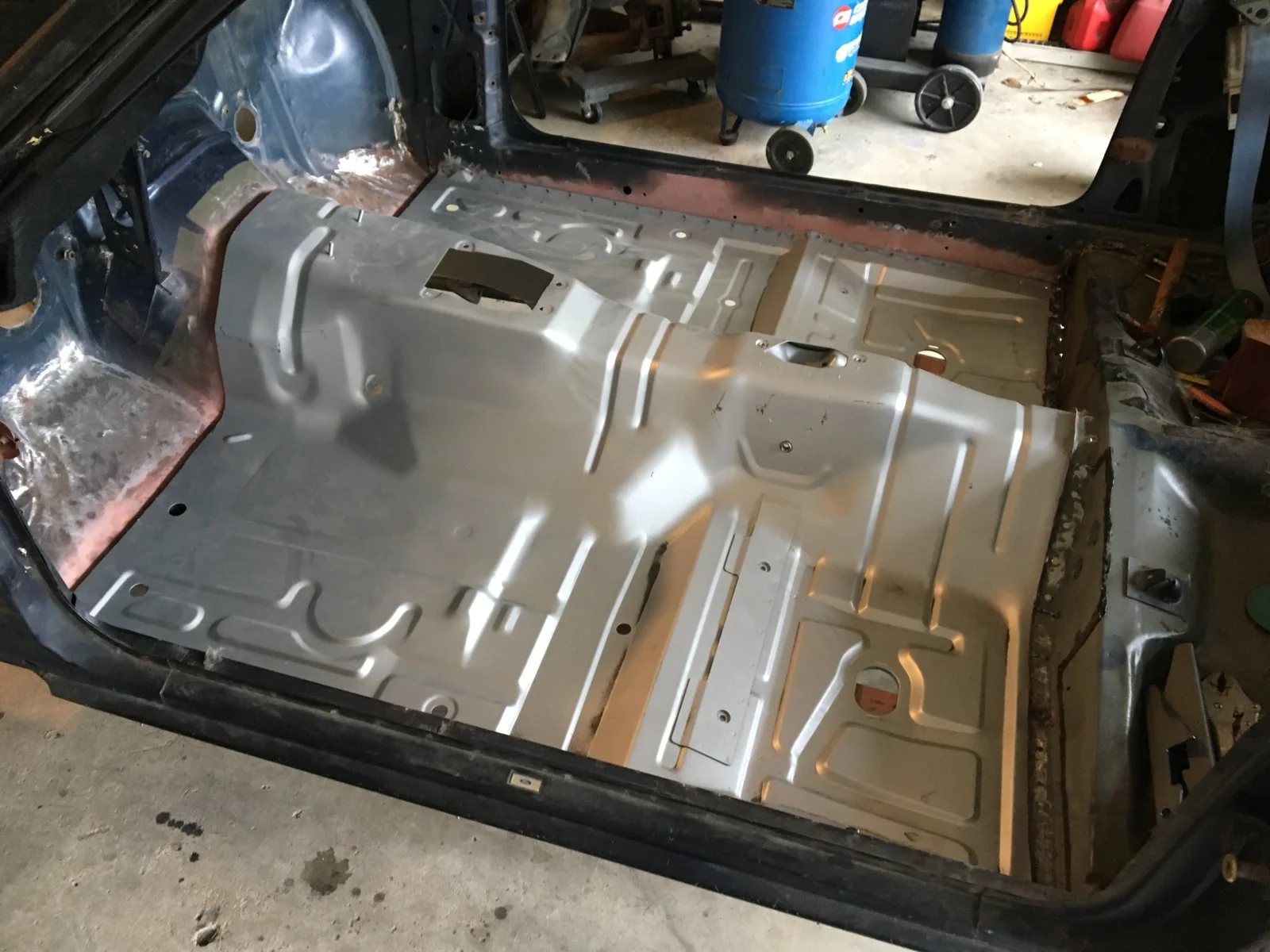

So far I cleaned up in side the cabin and got any holes I needed drilled and ground down to metal wherever i'll be welding. Then I sprayed weld through primer over those areas.
Then I trimmed off the inch of floorpan I needed to.

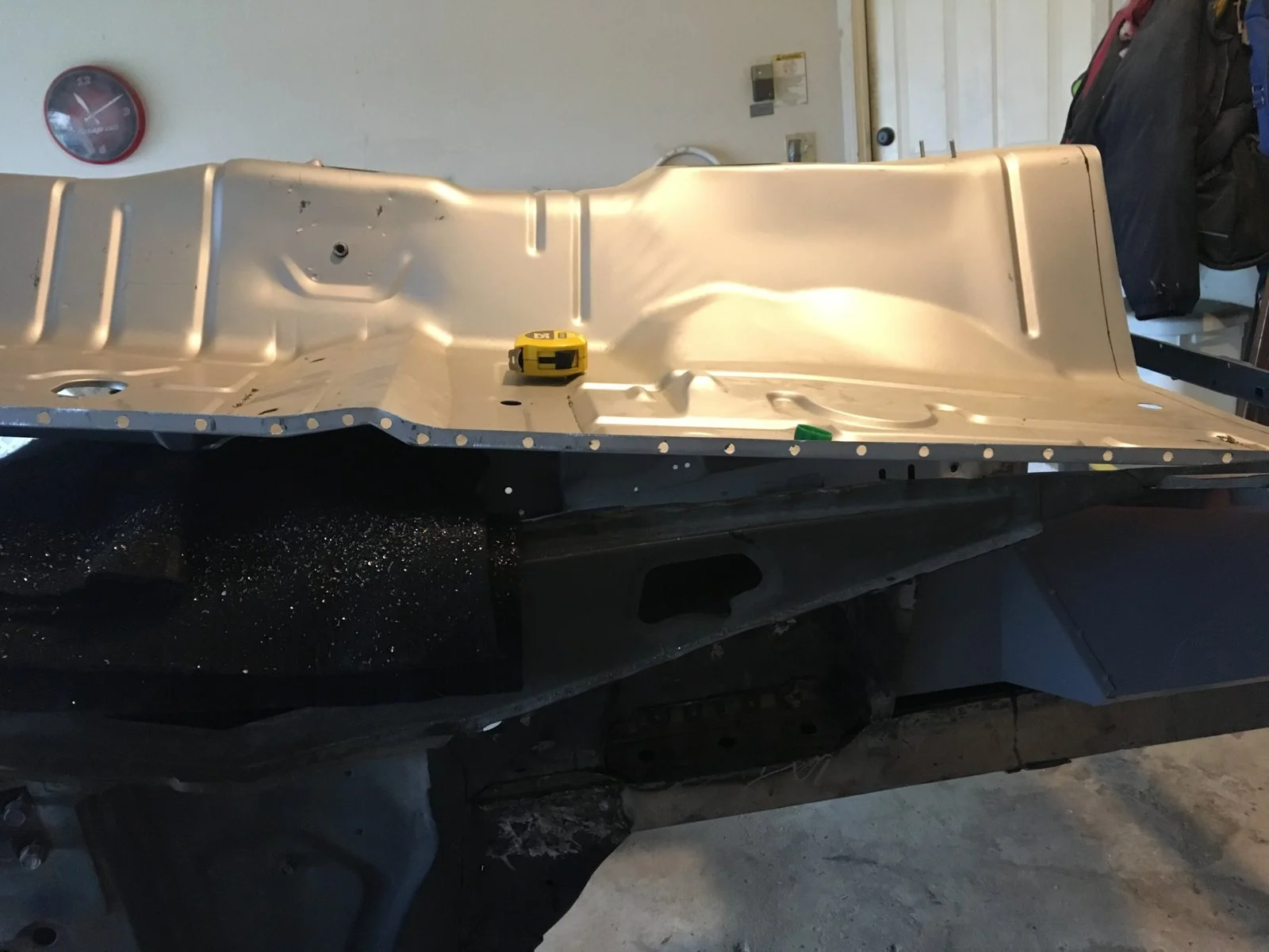

Then I slid the floorpan in and am about ready to do the final fitting and draw out the shape of the frame rails on the underneath side so I can drill out the other fourty million holes I'll need to weld. Plus the holes on the front of the floorpan too.
I might be welding it in today, I really want to. I'll see how easy it is to finish the fitment.

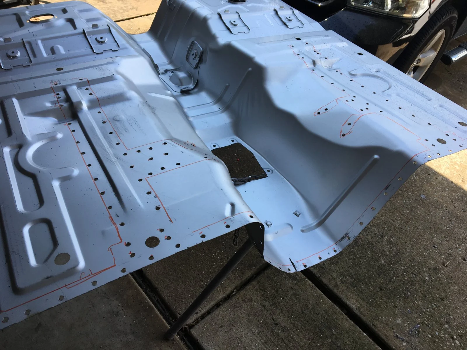

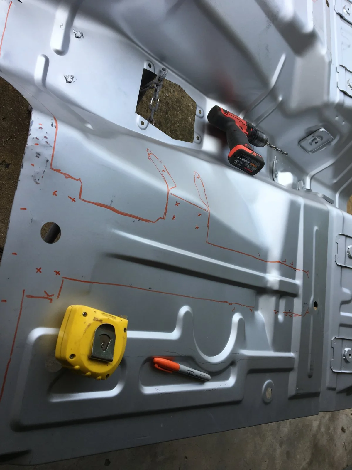

So I crawled under and used a marker to mark the outline of the frame rails onto the floorpan.
Then I marked all of the spot welds for them and drilled them out. Another 112 spot welds added to the floorpan. That makes for a grand total of 204 spot welds required for the pan.
You would think by the time I’m done welding it in I’d be pretty good at spot welding, wouldn’t you.:scratch:

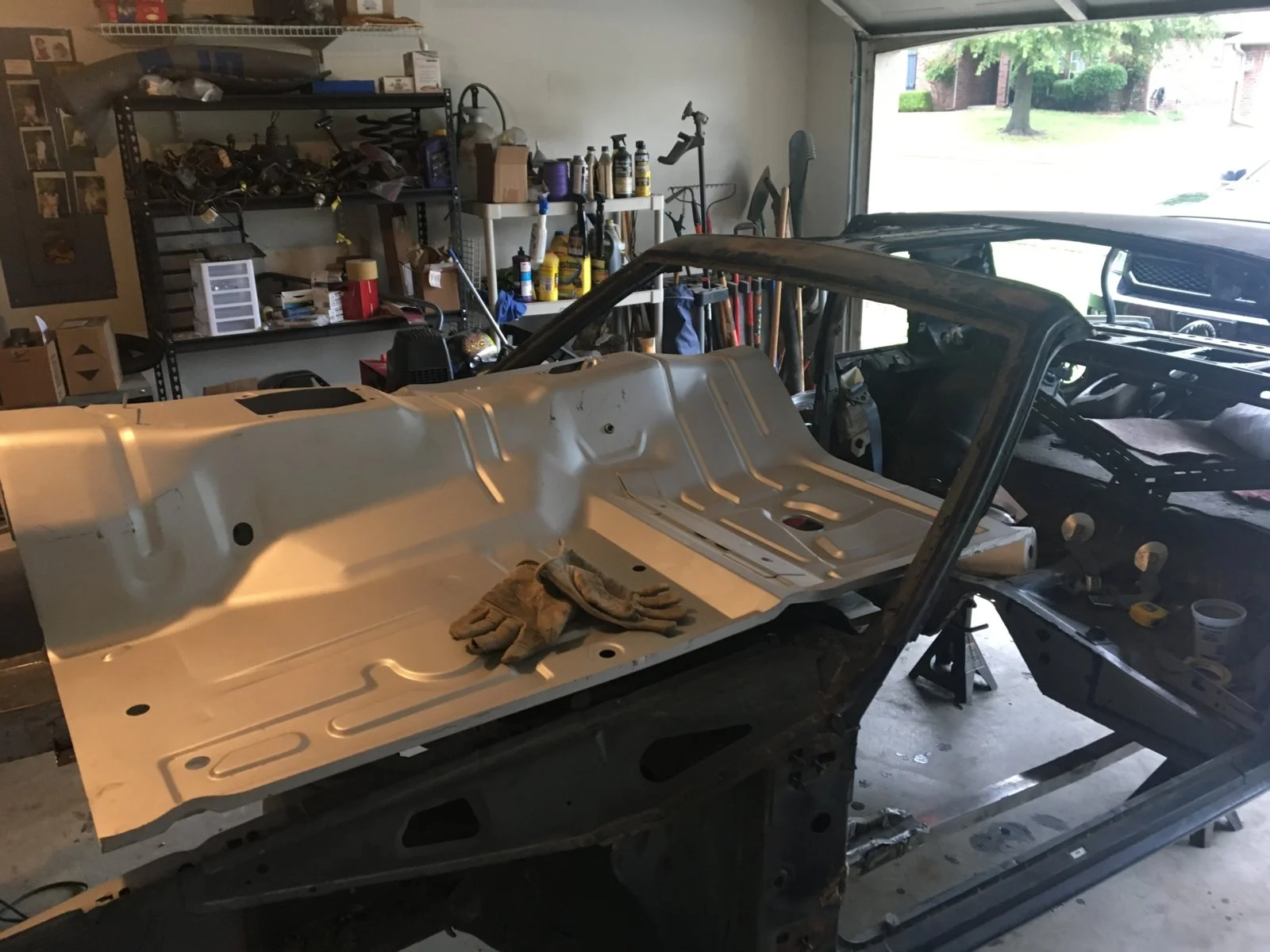

This is the last thing for the day. I'm tired.

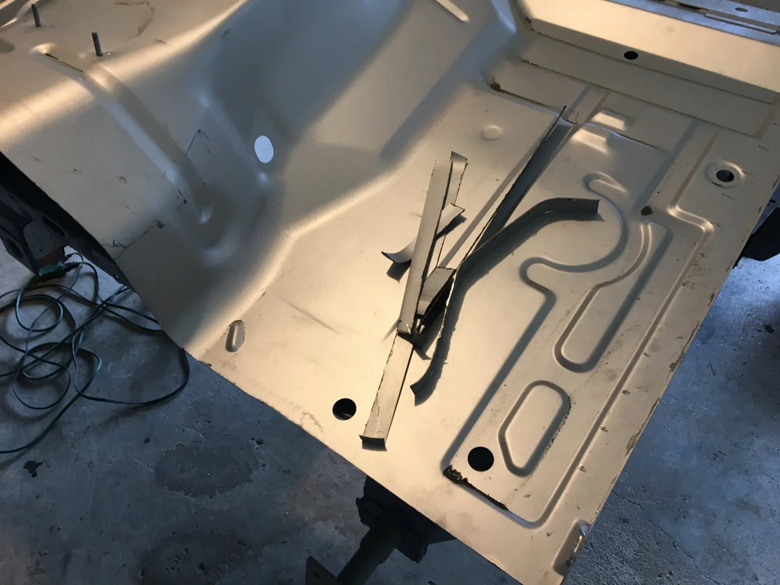

I cleaned up all of those holes I drilled and measured and drilled holes for the eb handle.
You'll notice the slight slice in the front of the trans tunnel. The left side of the new part doesn't have the same shape as the firewall attaching area. It'll only take a minor bit of modification. I'll do that while I'm welding in the pan, hopefully tomorrow night.
