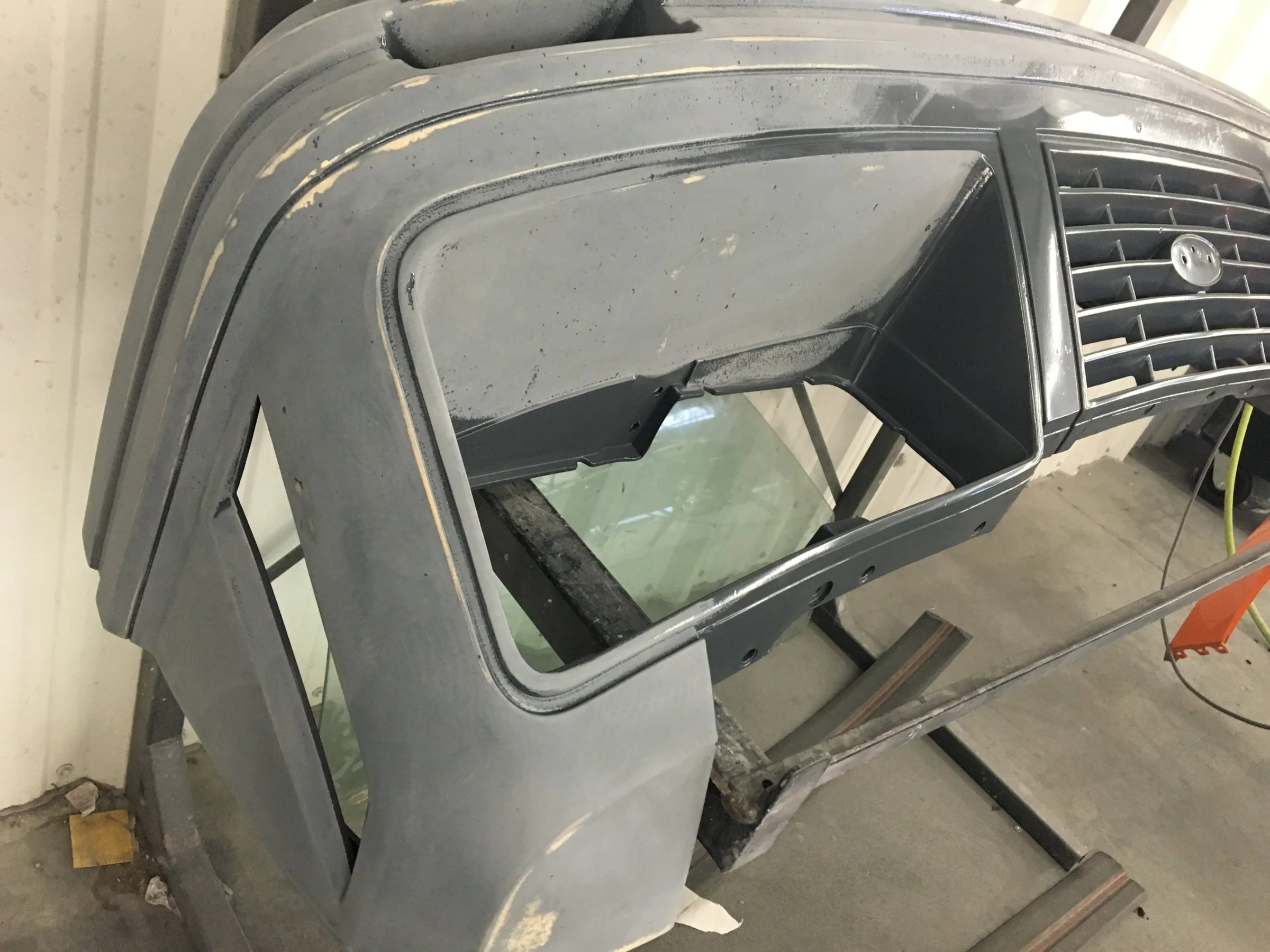

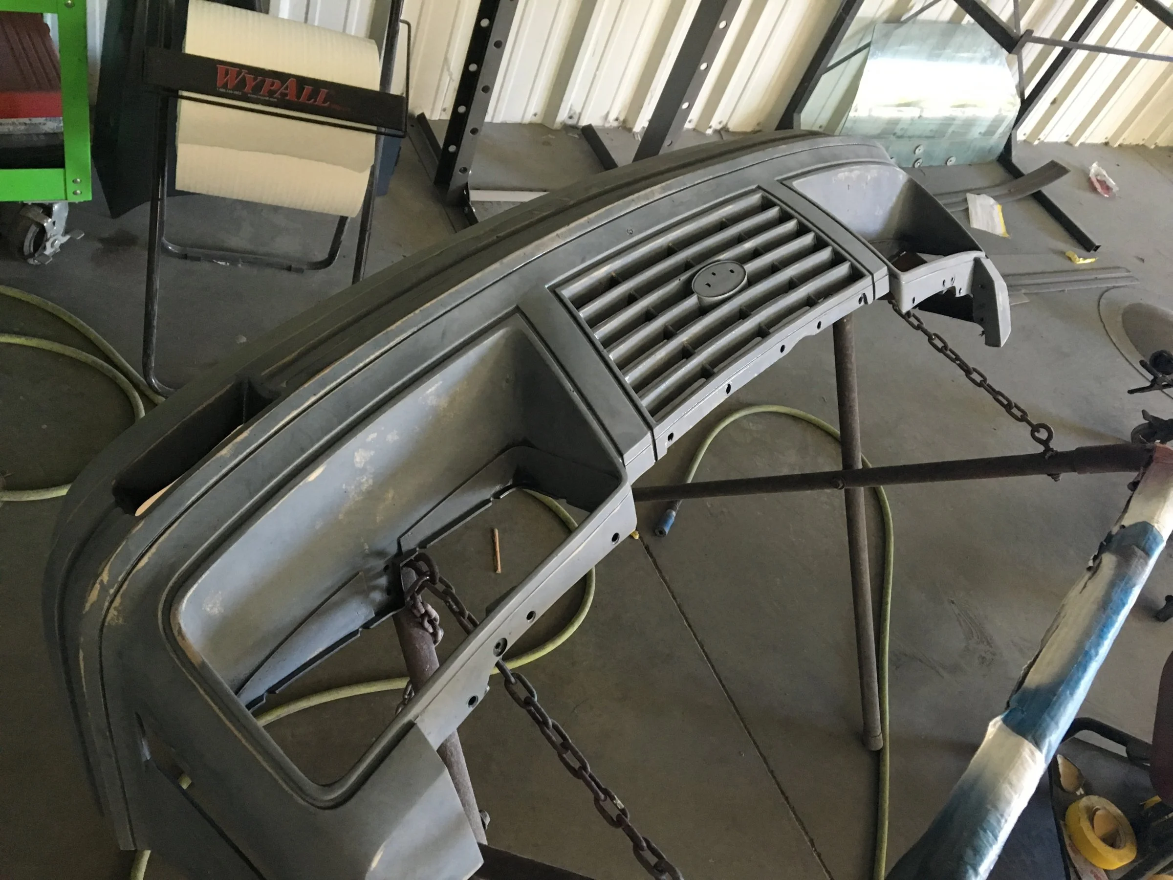

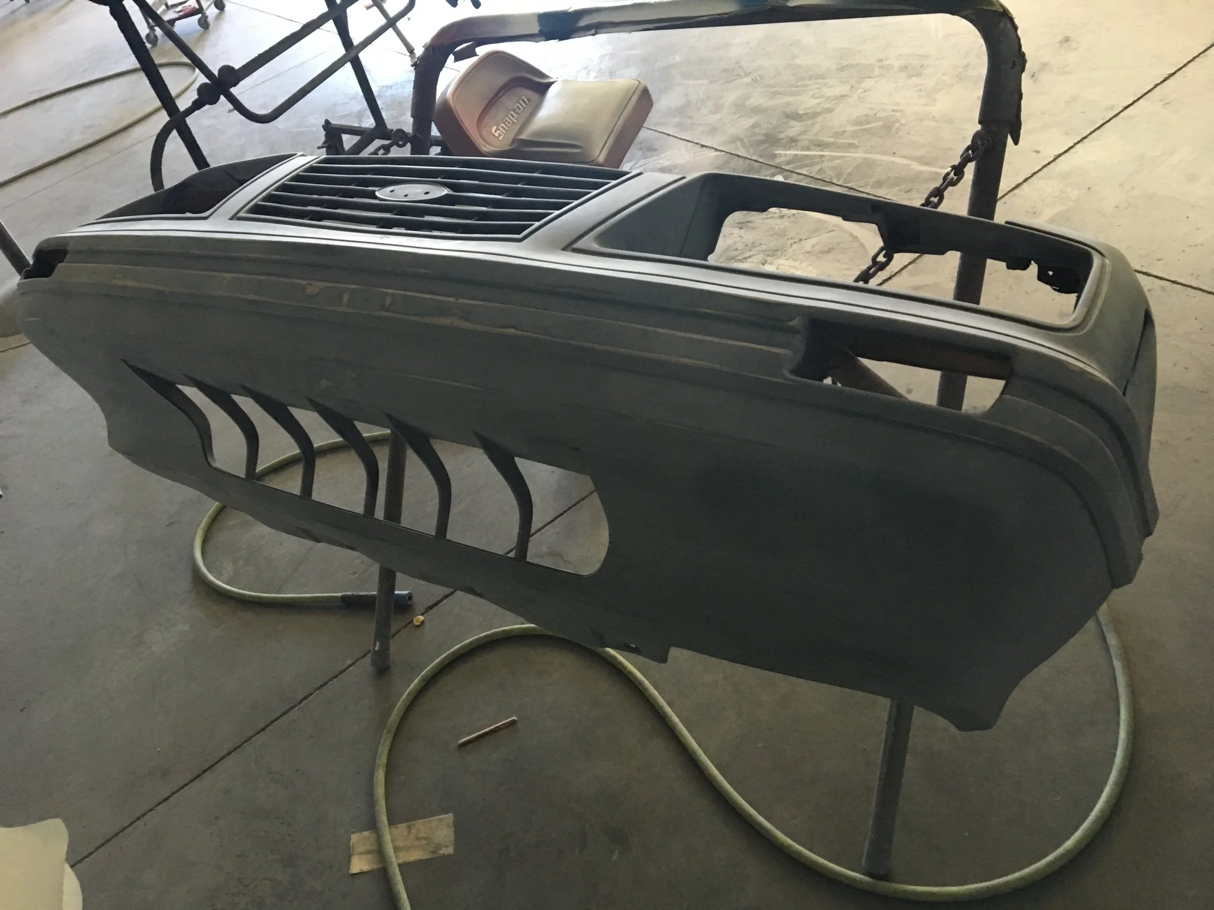

There are just so many small chips that I decided to primer the whole bumper first or I would be wiping the entire top surface with the polyflex.
I used a plastic adhesion promoter first and then put four coats of primer on it.

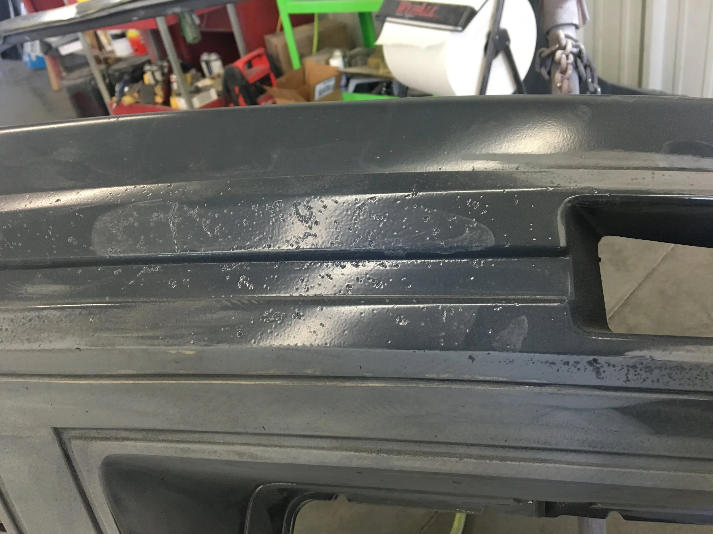

I'll sand this smooth first and see how many gouges are left to be filled. It'll be a quicker repair this way.
I sanded a little just to see how much the primer has filled, turned out it did quite a bit.
I'll have a little to fill here and there. This won't be some phenom bumper when done. Things like the tag reinforcements and the such cause the bumper to be a bit wavy. If I remember rightly, they were like that when they were new.

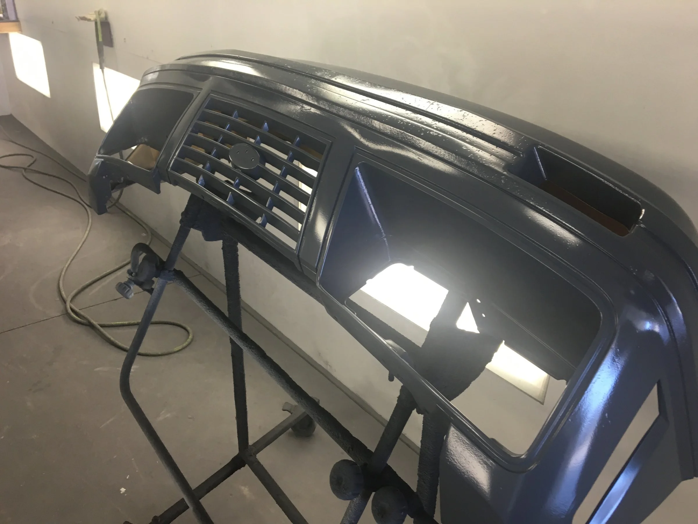

Ok, I've sweet talked my jobber into giving me a whole quart of mystichrome black.
I want to use this as my trim color over the black (dark grey really) usually on the trim. Then I will spray a semi-gloss clear over it to give it a different look.
What do y'all think of this idea? I think it might be pretty cool looking.
