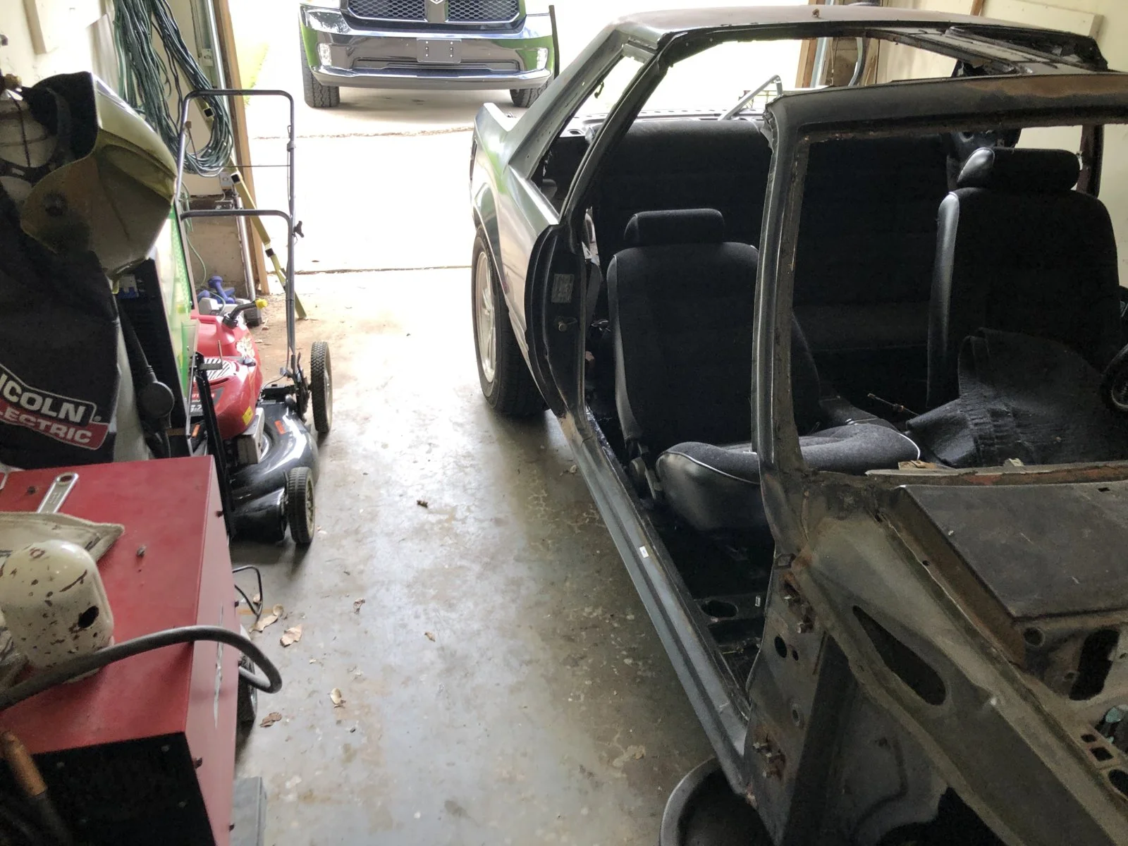

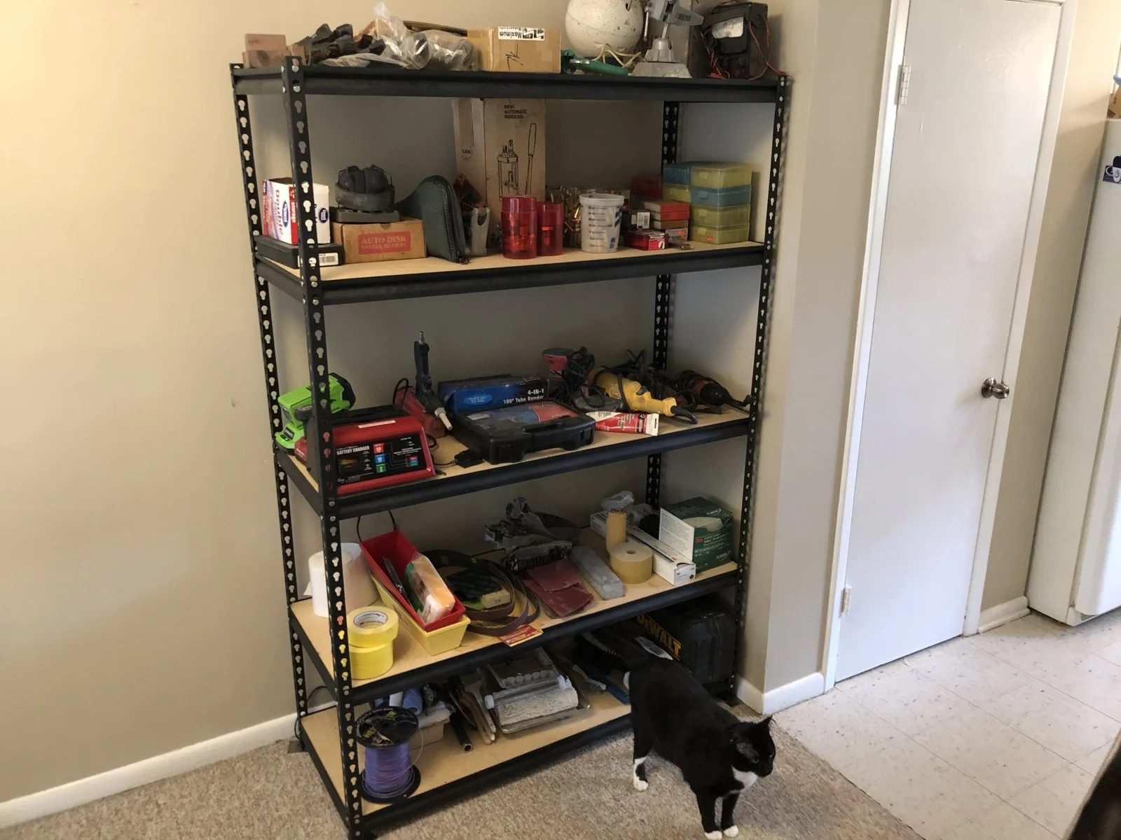

I got the last of the big shelves out of my tiny little garage and into the house.
The dining table that was there had to go. It’s heading to the storage unit in just a few minutes along with some other odds and ends.
First off, I don’t want to hear :poo:from y’all when you look at this picture, I did move a lot of stuff today. Just about to the point of doing things to Booger.
I intend to move the lawn mower to the back yard.
What this means is that the next move is to throw Booger back up on jack stands and drop the IRS and k-member out.
Then weld the right side chassis support on.
Once the chassis support is in place I will build a little rig/cart that I can set Booger on to move him around in the IB (Itty Bitty) garage.
I was thinking of a simple rectangle wooden frame with same decent casters at each corner. Give it a total height of about eighteen inches. Booger will have those nice strong SFC’s and chassis supports to set it on. What do y’all think of this idea?
Here’s some pneumatic casters I was thinking of getting for the “cart”.
I’m thinking the H-3329, they’re rated at 470lbs each. They should be more than good.

As long as you properly gusset the legs, I'd say a wood cart made out of either doubled 2x4s, or single 4x4's will be fine.
( it's what Scott used on his beauty) The casters you've selected only support between 300, and 400 lbs per. That means that combined, the things are maxed out at 1600 pounds. ( probably about what your stripped chassis will be give or take a few hundred pounds)
I had harbor freight casters on a self made rotisserie when I was in my street rod phase. I had some goofy looking Studebaker on it. Those wheels were hard rubber with a blue outside and rated to 600 lbs ea. Seemed to roll fairly easy.
They're under 20.00 ea.

Hf it is then. I was thinking of 4x4s for the frame.

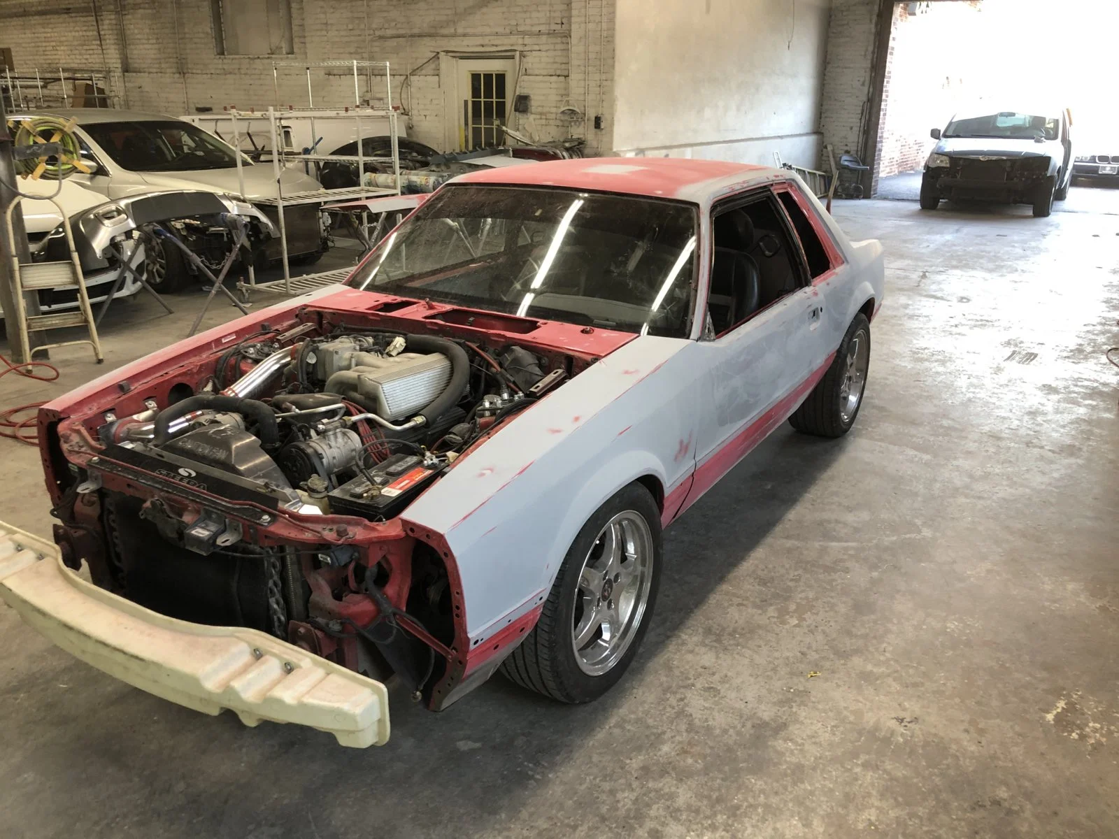

I don’t think it’ll get painted today. It’s getting warmer than I would like. I’ll get up early tomorrow morning and get it shot.
I found a couple more dents to fix and some bonus odds and ends.
I got it prepped and cleaned up though and I’ll get it masked before I go home later on.
I’ll have to take the wheels off in the booth so I can get the wheel wells pretty.
