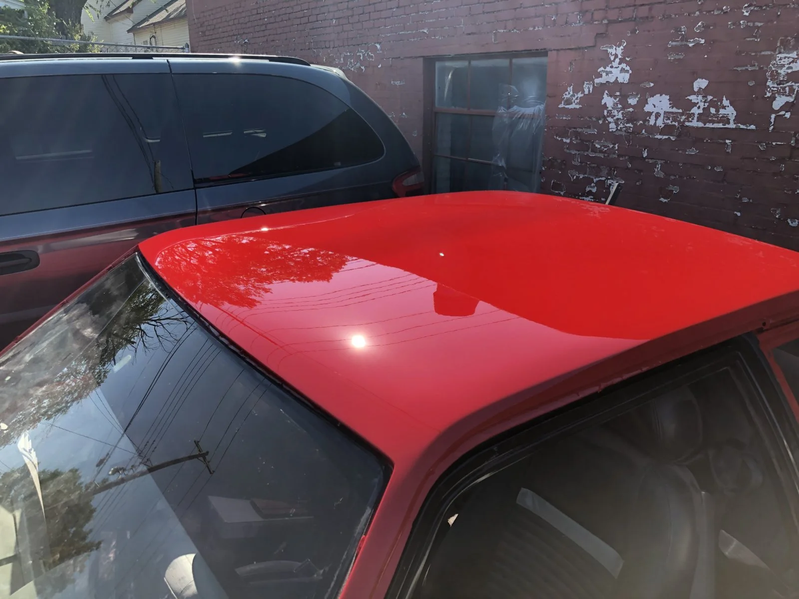

This thing looks wet. Awesome work !

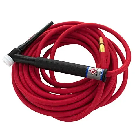

I bought a larger version of the other flex head torch for my tig welder, a 17. I needed the ability to go to at least 125 amps to weld in the chassis support. It’s a CK. Good to 150 amps.
The CK 9 was good to 125 amps, which is what I need to weld the cs in. Have y’all ever tried using an air cooled tig torch at it’s maximum rating over an extended area? It gets really, really hot. It becomes very painful. So, the new torch.
