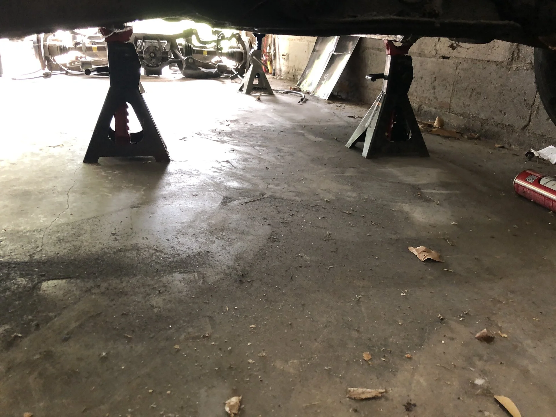

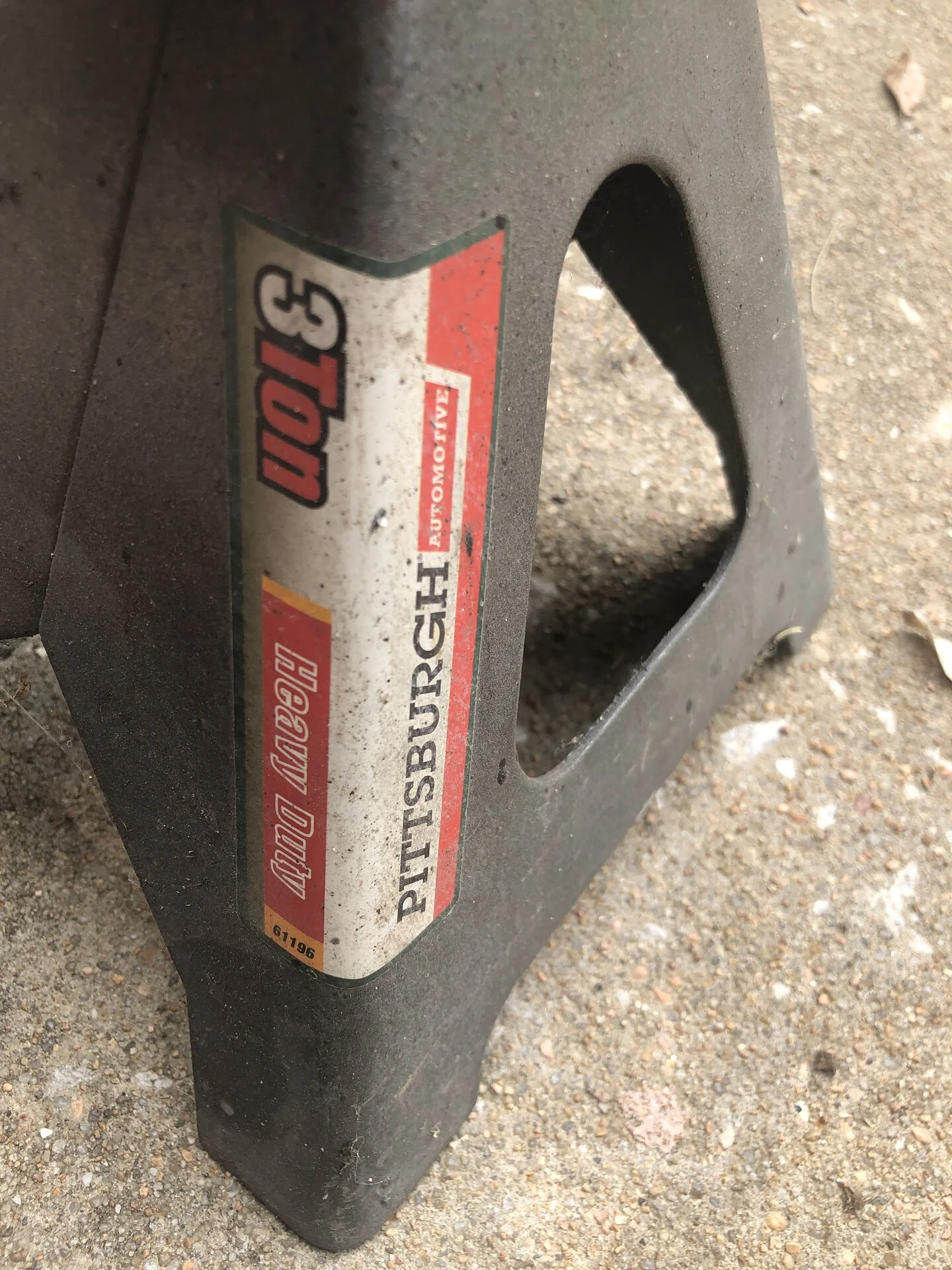

After joking about the hf jack stands, I thought i should check the two I have. Guess what? Lol, holy crap i did a LOT to Booger with these being a main support.
I‘m off to hf to do an exchange.

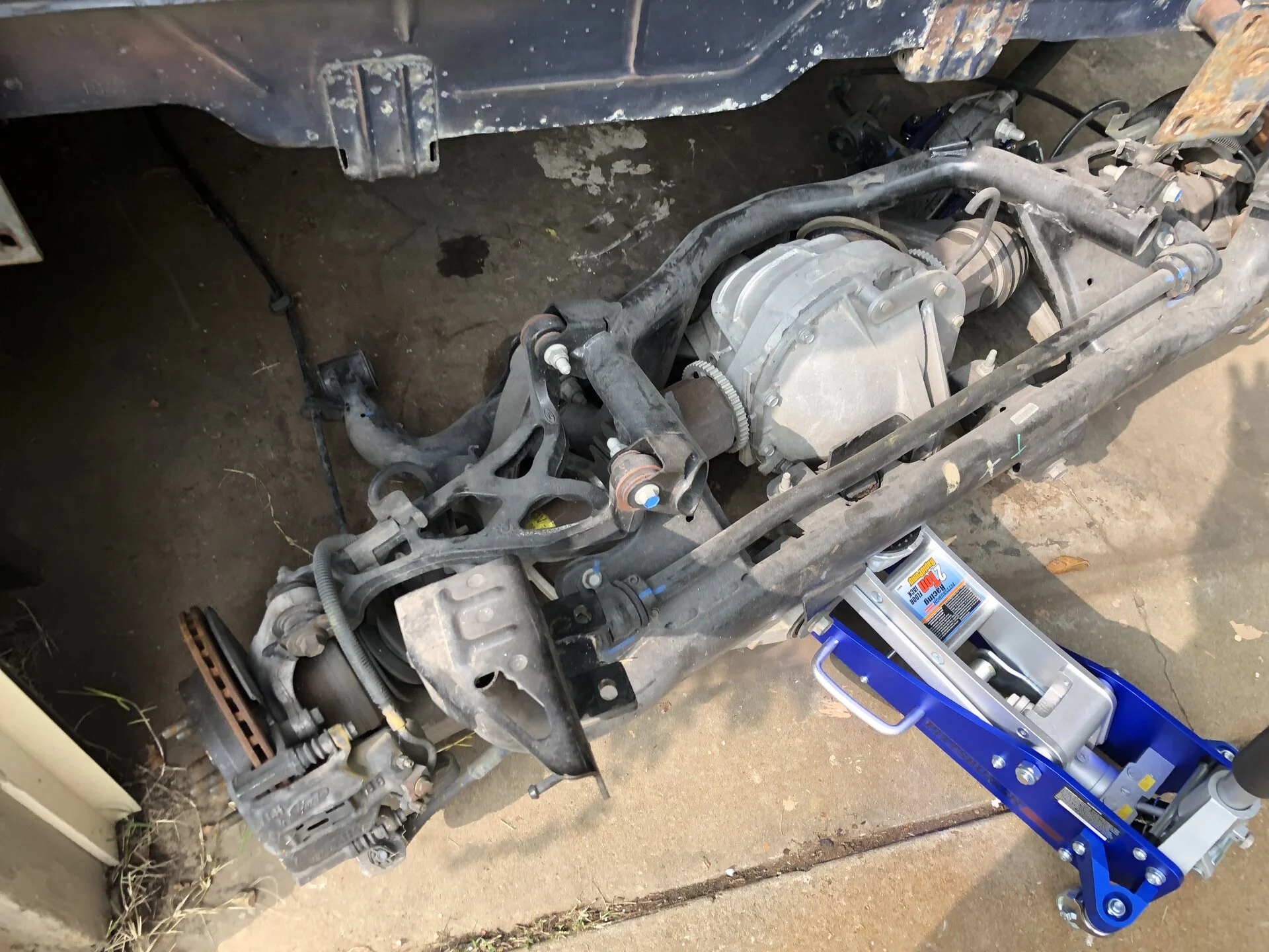

Ok, I finally got the IRS dropped, yay! That last bolt on the front left was the only one that required me to be fully under Booger again. I’ll get it stripped down tomorrow.

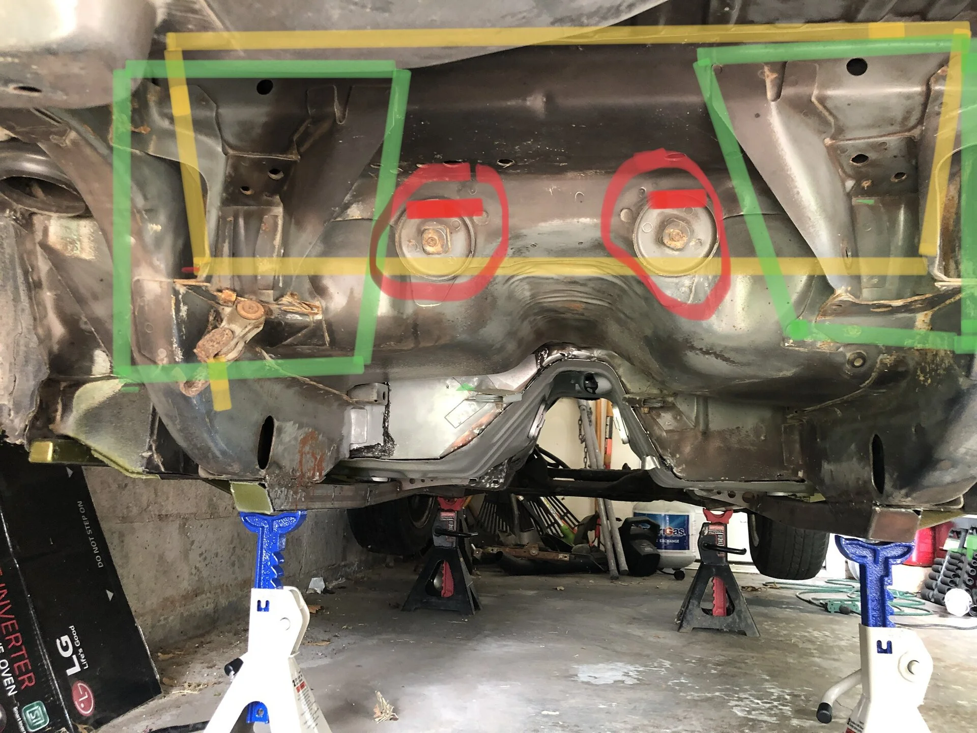

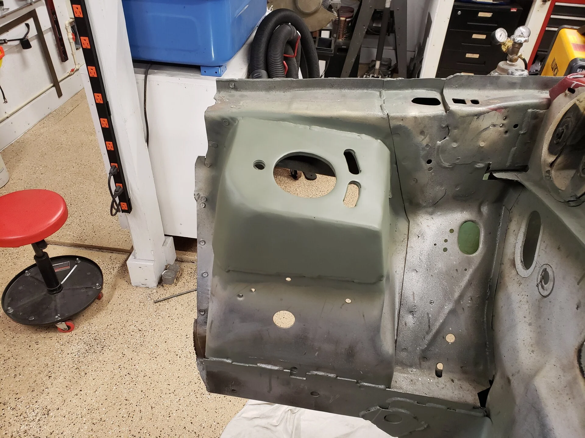

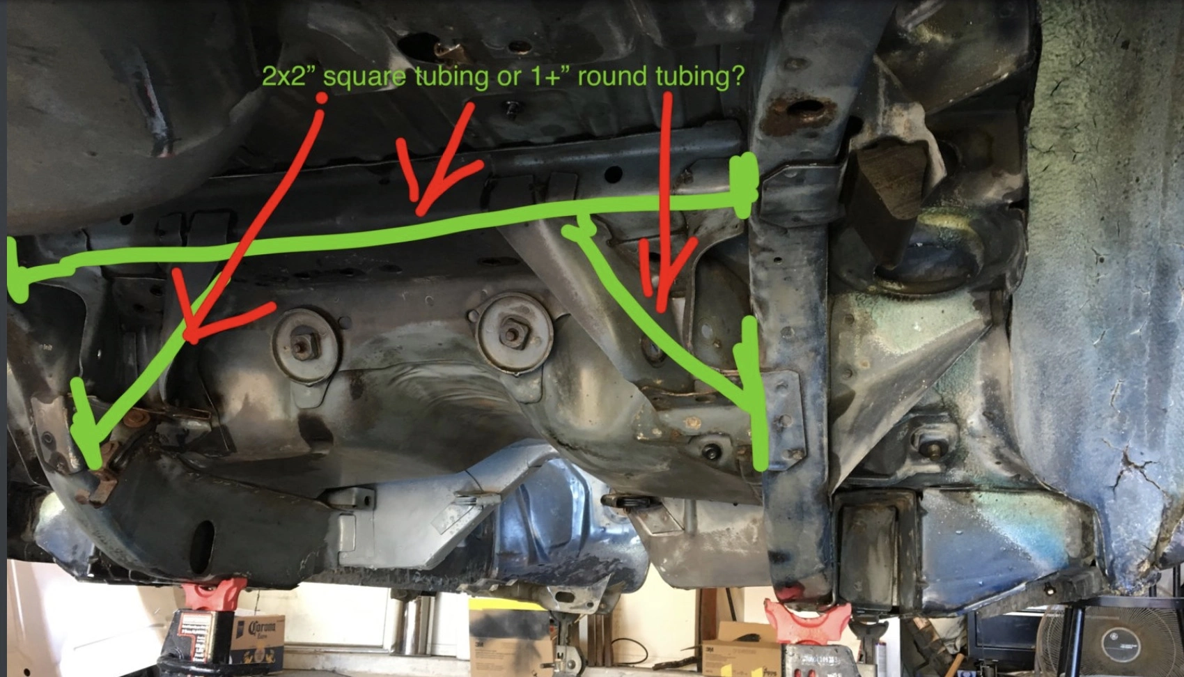

Now, here’s the next area of modification. The upper control arm mounts. You’ll notice five different areas of concern for me. First in green are the dumbo ear mounts that normally clear the IRS by the narrowest amount, and I mean narrow, like 1/4” separation. They’ll be gone. Got to go back to hf and get a few spot weld cutter bits.
Then comes the other three that I want to keep and maybe slightly modify. In yellow is the backing plate that’s welded to the floor pan. I think it’ll stay.
The other two in red are the support plates for the rear seat belts. I need to maintain them. Though they may be slightly modified and trimmed at the top so the 2x2 tubing will fit. Then I’ll weld the trimmed part to the new tube.

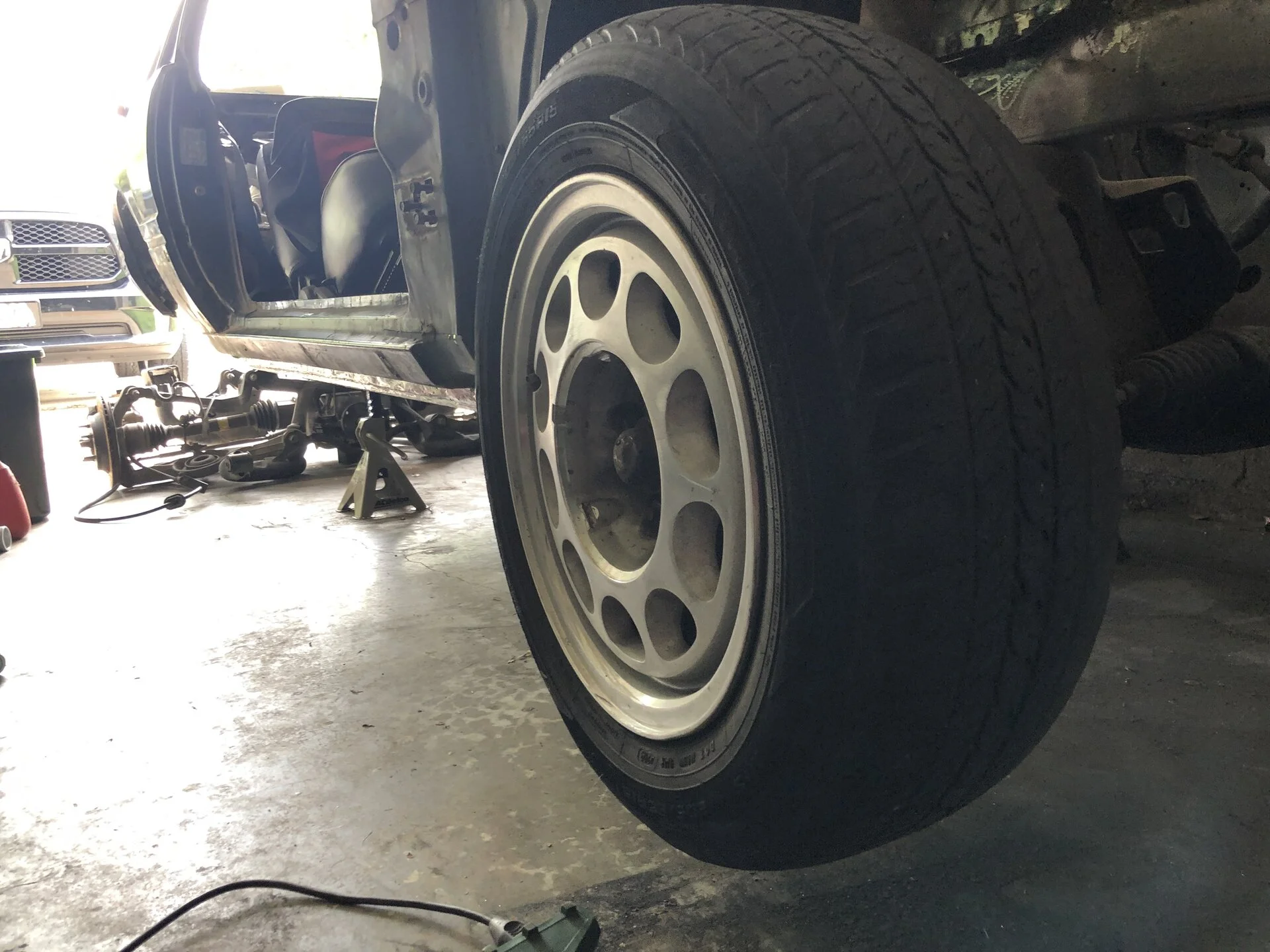

Here it is higher up in the air than it’s been in a long time.
This final picture just seems to excite me, lol! I’ll be playing under there for a bit. I’m looking forward to making that trans tunnel all green.

I was thinking about stress areas in my coupe. Since I’ll have coil overs in the rear, I thought more about that upper shock mount.
Maybe replacing it with a new box that welds deeper into the subframe wouldn’t be a bad idea? Much heavier gauge than factory too. I‘m strongly leaning towards replacing the shock mount. Plus an additional tube between the upper mounts since the full weight of the car will rest upon those and transfer a bit of twist under hard acceleration? Since I’ll be replacing the uca mount with tubing, I don’t know if that’s really necessary. It’s just a few inches away from the shock mounts. Yet the new X-brace inside the cabin will have a strut going to the shock mounts.
I luckily came across some heavy gauge flat steel that I can make gussets, backing plates, rear upper shock mounts maybe out of.

Help me think here guys. Tomorrow the IRS will be out and disassembled and the rear mods really begin. I’m starting by removing the factory upper control arm mount and replacing it. Speaking of that, do y’all think I need more than just a tube welded between the rear subframes? Like angle supports welding from the tube to a lower are on the subframe. Would that Just be a waste of material and add weight, or be helpful?
I’m taking a hard look at those dang torque boxes too. Remember, there won’t be any movement of the lower IRS mount like there would be with a control arm. Maybe it could be redone, maybe completely?
You're correct, the IRS itself adds a fair amount of lateral support toward the back of the car. Especially with the hard tail conversion, the IRS cradle essentially becomes part of the frame when bolted in. I don't think you will need to add anything else back there. The main point of adding the bar after removing the upper control mounts was to add support to the floor since that was removed with the upper control arm mounts. The added lateral support was just a benefit of the whole setup. If I ever went back to a SRA, I was just planning on buying aftermarket upper control arm mounts and welding them in.
Plug welds from the floor to the top tube for support.

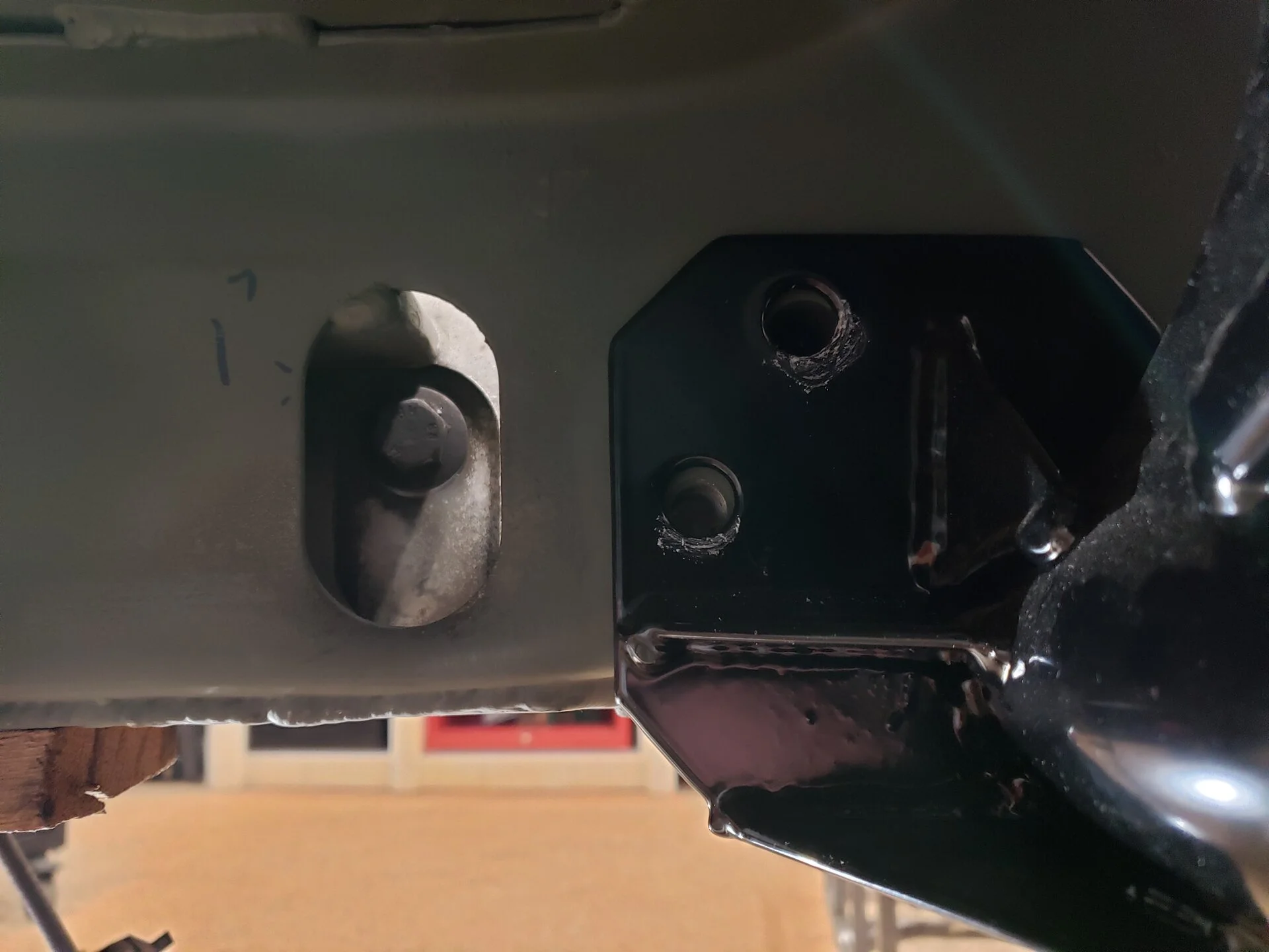

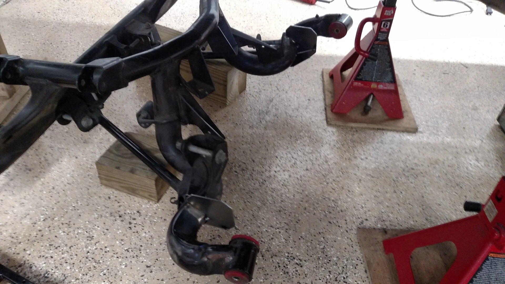

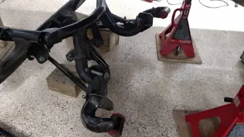

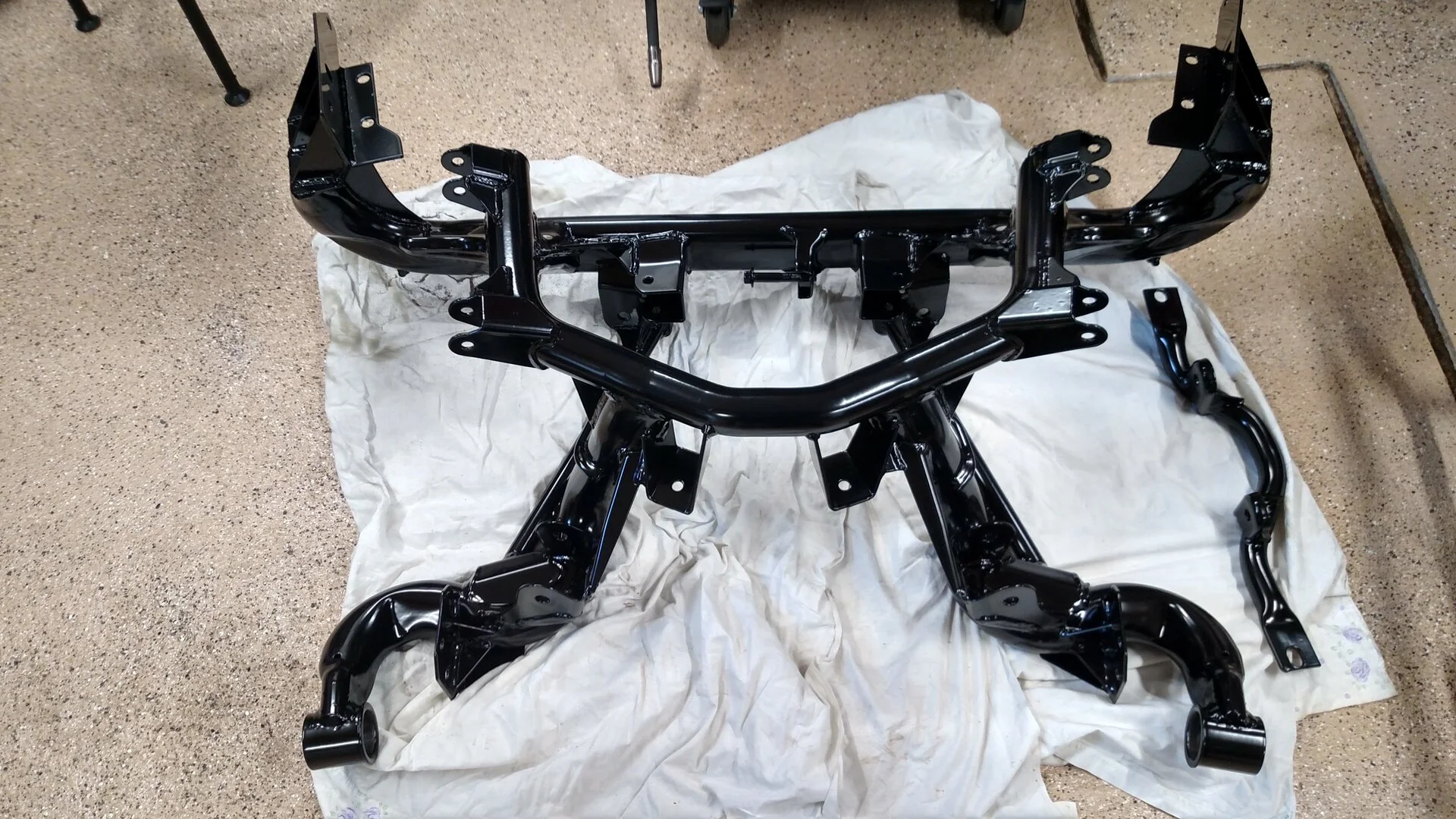

I did hard mount the front of my IRS cradle as well. Do know that doing this will probably add a large amount of NVH to the vehicle, especially if you are running Delrin bushings in the IRS like I am. There will be almost no isolation between the control arms, diff, ect and the body of the car. I maintained the torque box mounts and added reinforced plates on the IRS that through bolt to the frame rail right by the torque boxes. I'm replacing the bushings on the torque box mounts with aluminum ones so everything is solid. The whole point of hard mounting the front of the cradle in my situation was to reduce the amount of deflection that occurs in the IRS cradle at the point it bends to engage the torque boxes. This only seemed to occur when corner forces exceeded 1.2g's in my simulations.
In this pic you can see the front mounts added to the cradle.
I am aligning the front hard mounts for the through bolts in the frame rail in this pic.

I also stitch welded the rear shock mounts on the inside and outside, and have them boxed out and reinforced on the inside to handle the future coil over conversion. I will be running a bar between the shock mounts on the inside of the car, and the whole system will be integrated with the cage. Just stitch welding the shock mounts is usually good enough, but there is some inward deflection on the frame rail that occurs when REALLY hitting a bump that the bar between the mounts help to control. The tie into the cage helps to control the deflection of the entire rear of the car (basically the frame rail/back half bending).
Did you consider leaving the backing plate of the upper uca mount for attachment to the floor?
