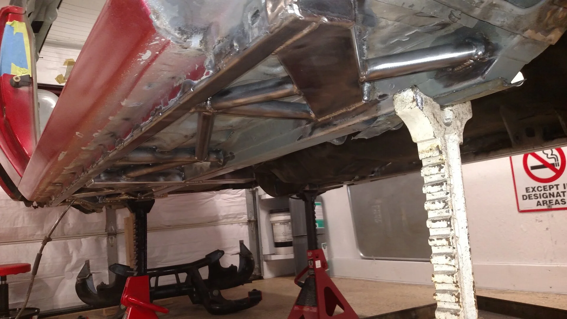

I thought I read somewhere that you could use a tig torch to burn off the junk between the pinch welds? Yes? No?
What is between them that makes them such a pain?
Nah, I tried the Tig thing.
I believe it’s factory seam sealer that melts.
If I was just using a pinch welder, it would come out nice and neat. But the longer time at high heat and going along where the bottom of the seam where the melted seam sealer will flow out just makes for a pita.
Yeah, it's the factory seam sealer that is in between the pinch welds. I tried to burn it out before I welded that area but the amount of heat it was taking just to cook a small section was ridiculous. Plus I was getting pretty high from the fumes. I just stitched my way down the pinch weld keeping the electrode on the tube and worked the weld puddle into the pinch weld. This kept the majority of the heat off the pinch weld and kept the seam sealer from melting too much.
