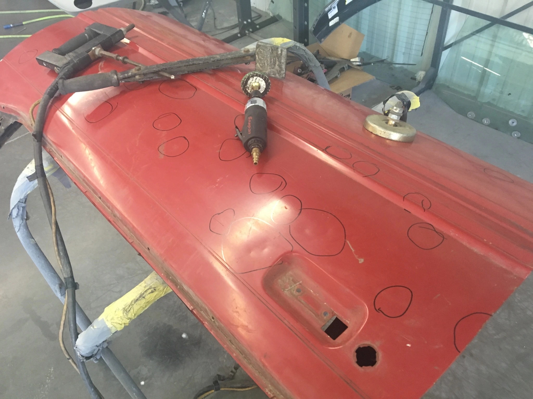

Anywho.... Here's some pictures of the equipment I used to take out the dents. This little machine is wonderful, it's anode tack welds to the bare metal of the dent and has a small slide hammer weight to pop out the dent. There is also the lever that you can use to be more gentle pulling out dents. I didn't use it too much, I just want them out enough to primer over and block them out. It has a magnetic ground, btw. You just need bare metal to have it stick to.

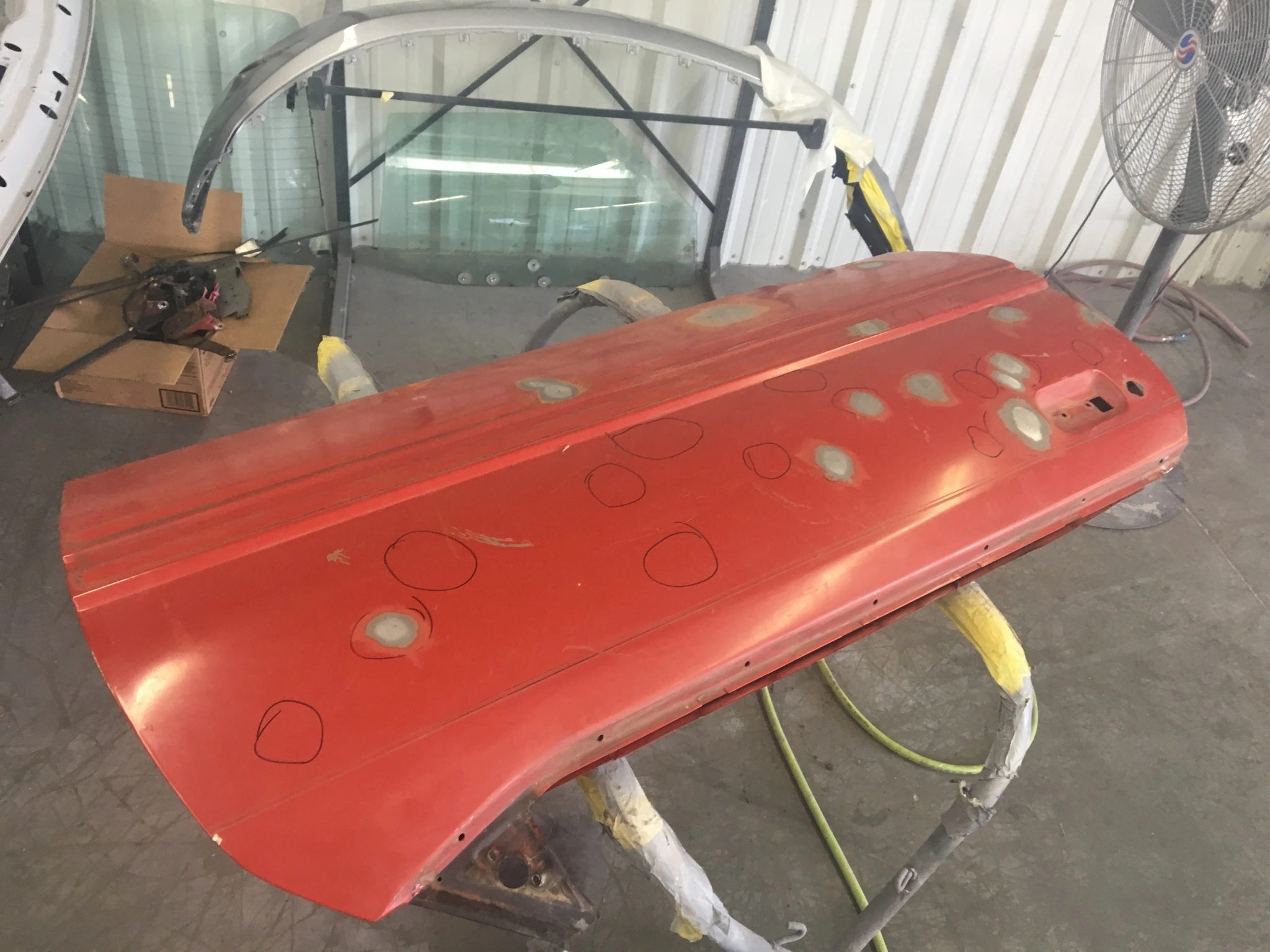

So, pictures: I circled all the dents with a marker
started to sand the dents to the metal so the electrode would attach
You can see I didn't try to pull every dent. Several of them are small enough that primer will cover them up.

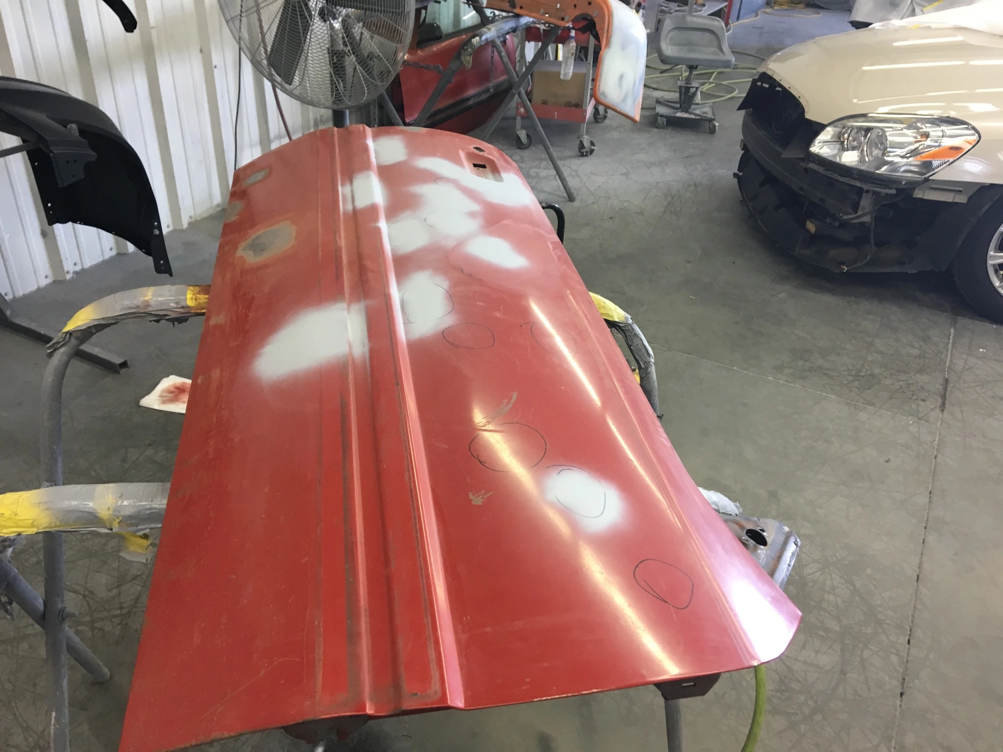

then I sprayed the areas with rattle can etch so I could see if the dents pulled out properly while the primer was still wet and shiny, I got a few more after this photo. Tomorrow, at lunch, I'll drop the door off to be media blasted.

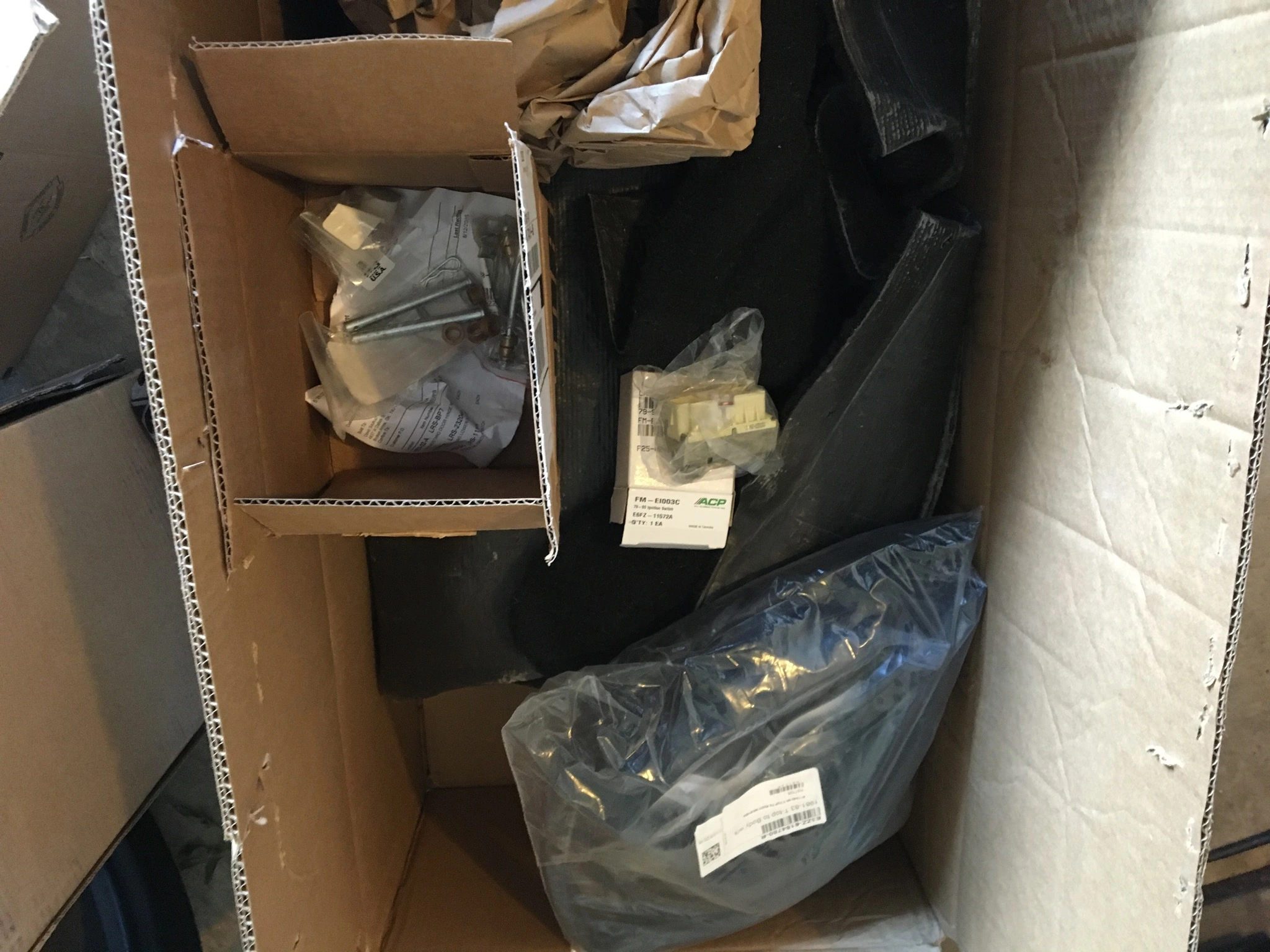

So I opened the box from yesterday and got a new one today. In with the carpet is the right t-top to body seal. The new itty bitty box has my new hinge pin kits and a new ignition switch.
