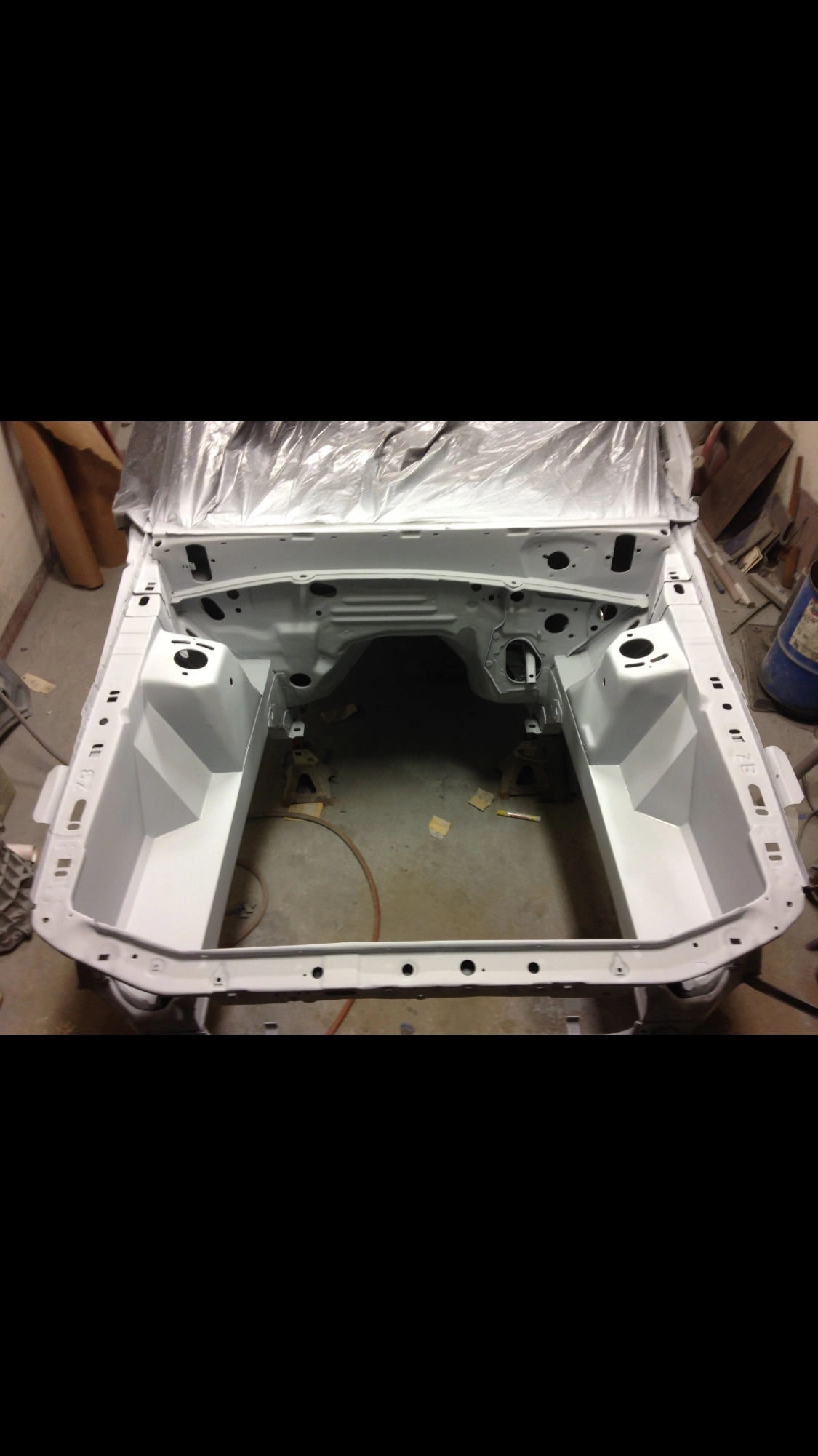

That is my buddies car yes ! But bondo ? There was almost none . That bay was 99.9 percent metal as was the rest of the body ! Where the patch was done in the corner of the roof was literally filled with lead . Once that was almost perfect it got the very lightest skim coat with rage . Then it was sanded to death with a long block until there was literally nothing left . Same with the engine bay . The fire wall where the wiper motor goes I think had 14 hours alone in it getting it straight .
That's was what I intended to point out. Beautiful work, lots of time involved in that project.
I meant my note about that car to mean, "Oh my God" that takes a lot of work and patience.
