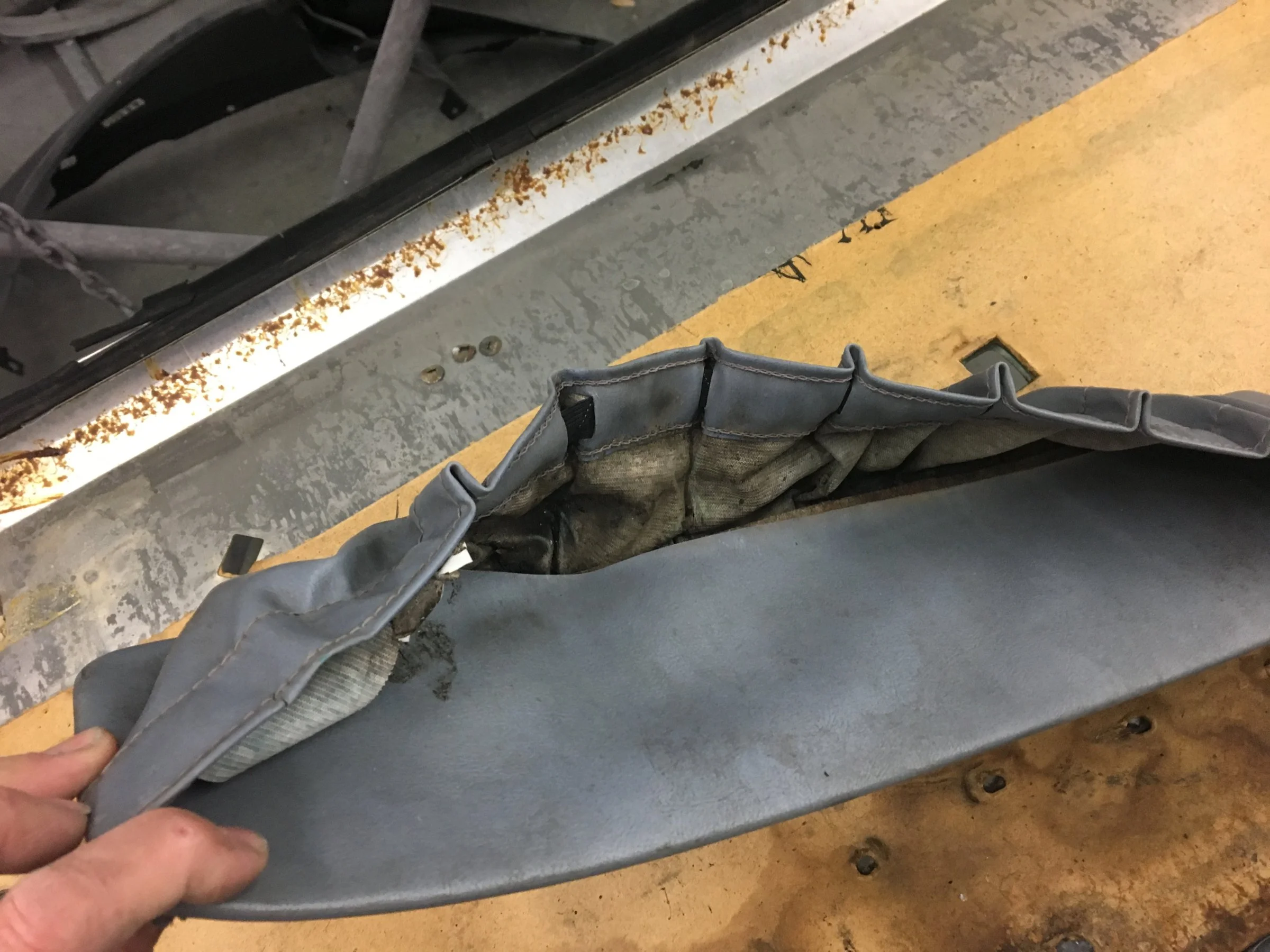

Nothing big, i just introduced the door panel vinyl to the washer, a cup of bleach and some laundry detergent. DEATH TO MOLD!!!
Silly, mom wouldn't want her sweaters bleached....Did you wash it with your mom's sweaters?

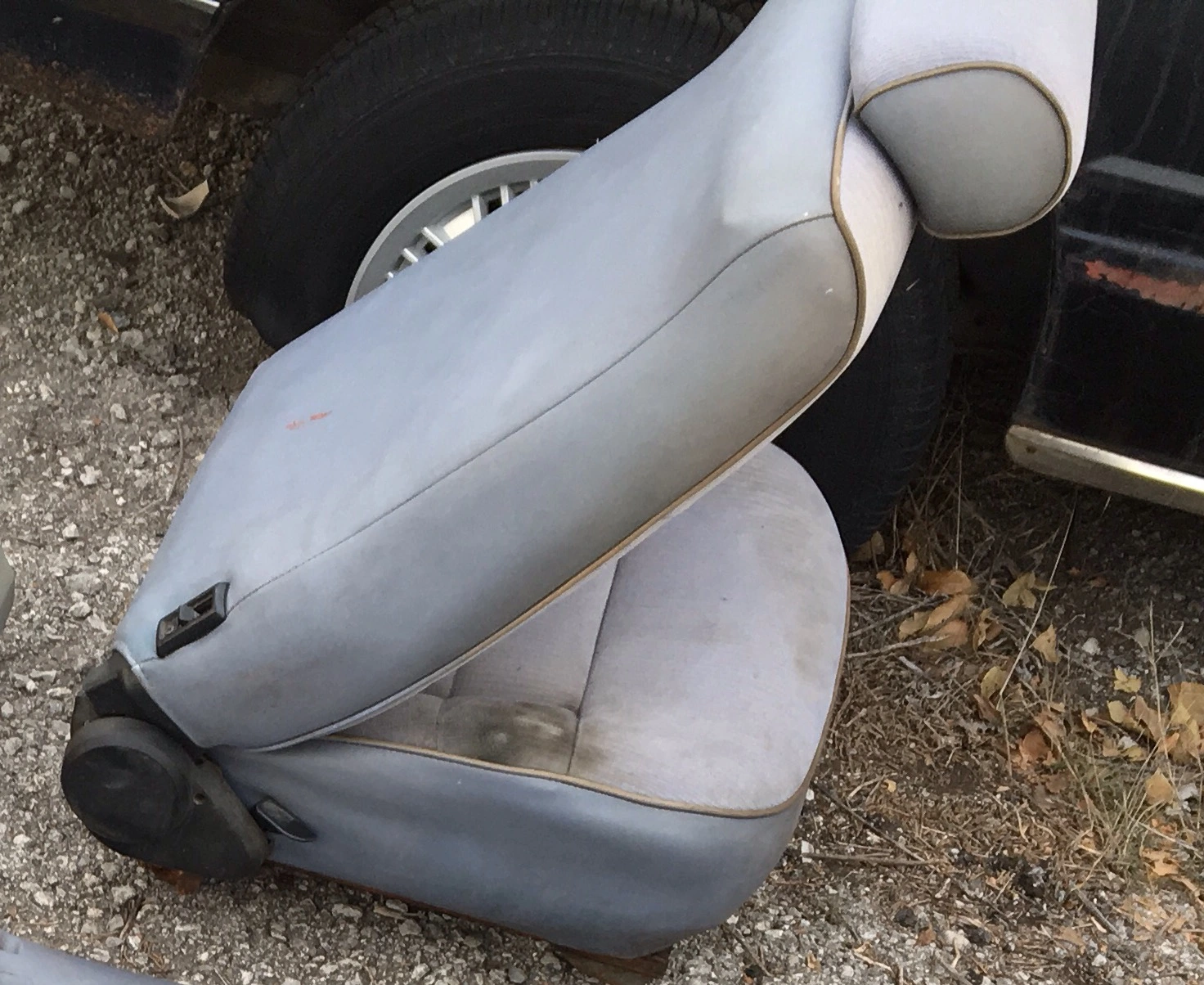

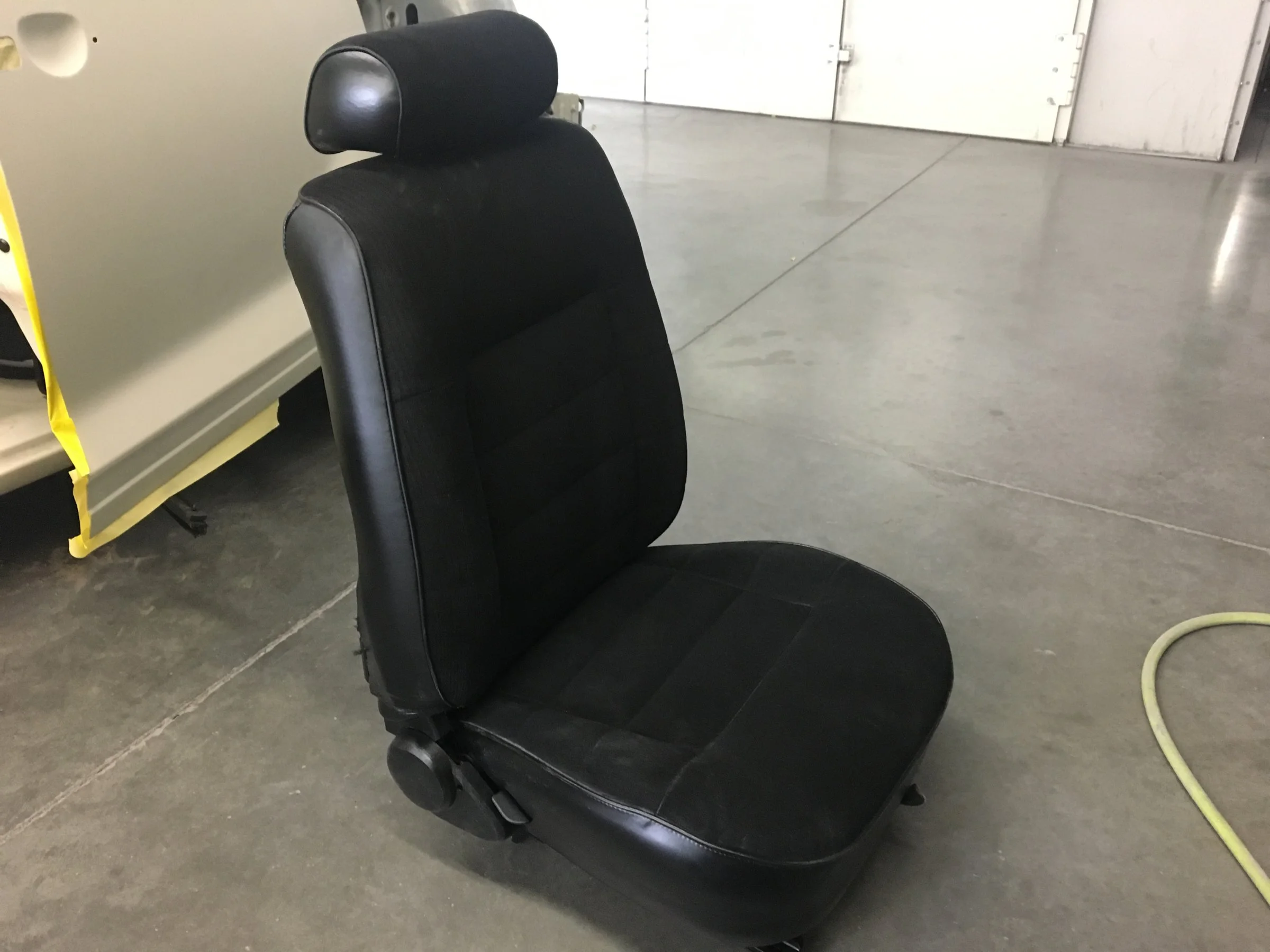

The finished passenger seat, before and after:
Daaavvvveee!!!Uhmmmm......I think this is going in the trash

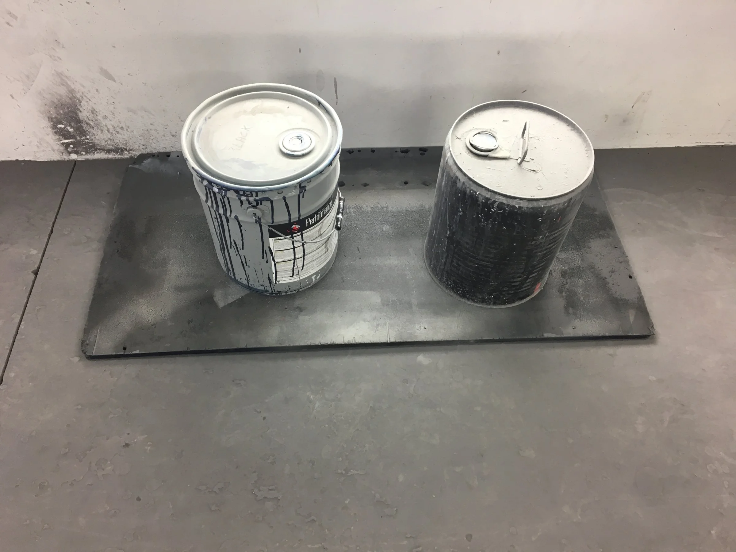

Anywho, this is what I'm doing to flatten out the original boards. I had to soak them in water really good, let that sit for about an hour so it was pretty dang soft. Wet them one more time, then SLOWLY shape them flat again. Then into the booth and put this board and two full five gallon cans put on top. Now it'll sit in the booth for the rest of the day through all the bake cycles. Tomorrow morning the board comes off and I'll have a really good pattern board for making my new ones.
