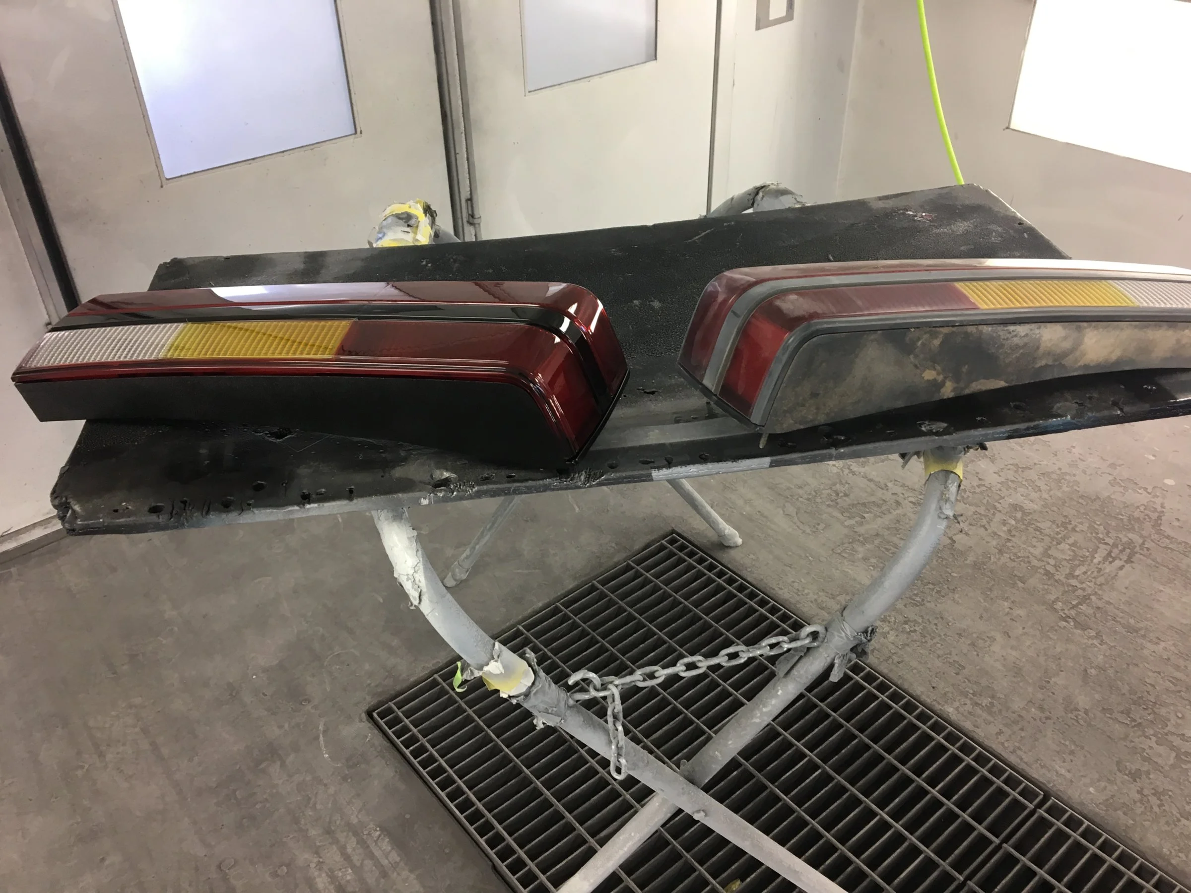

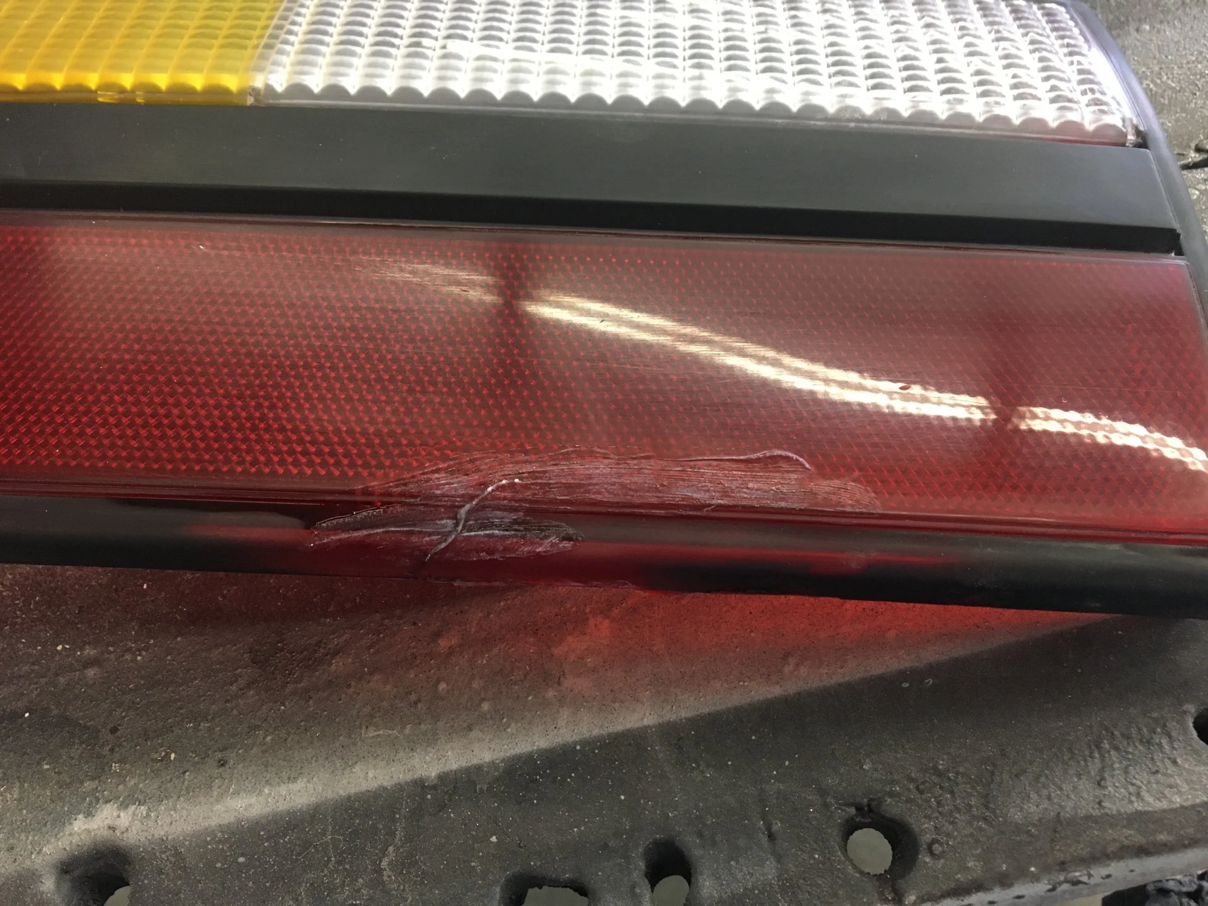

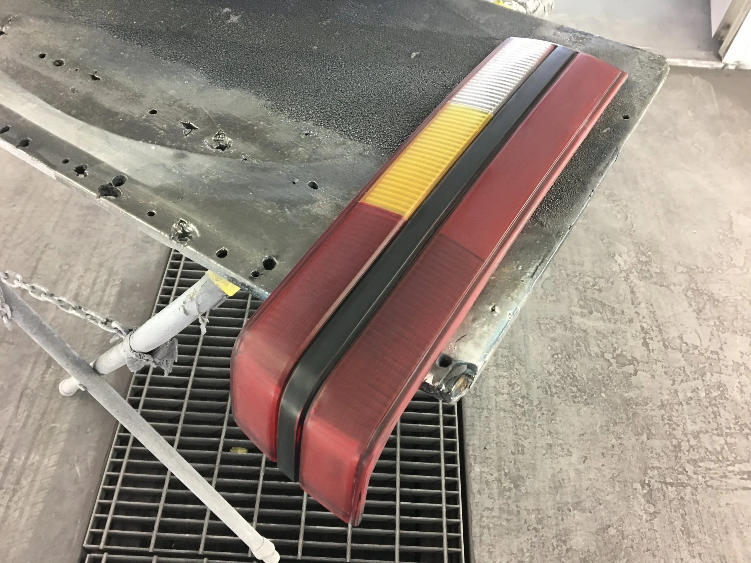

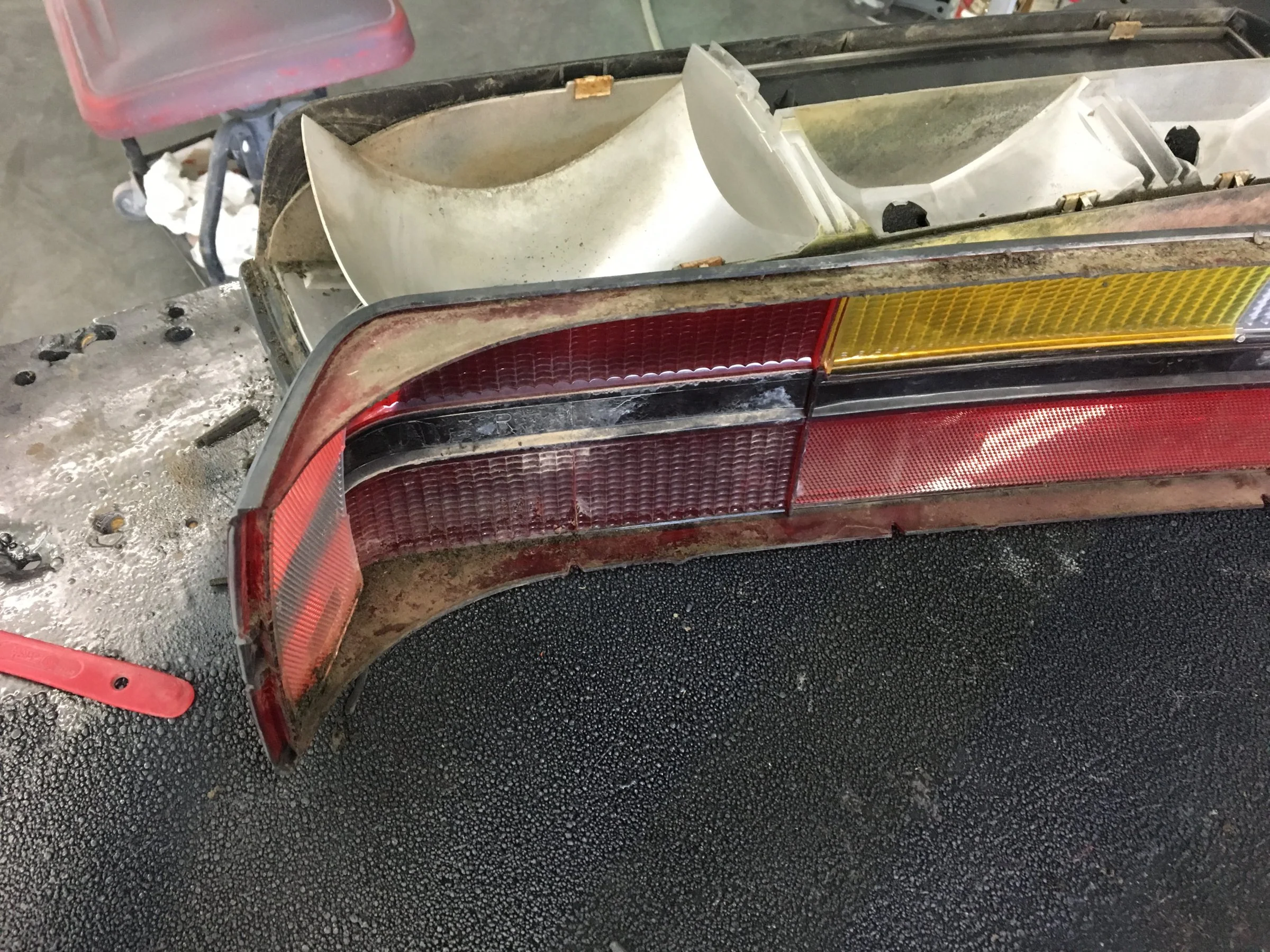

Sure Steve.Sorry Dave could you explain again how you're keeping the paint that you're spraying on all these panels from chipping or peeling

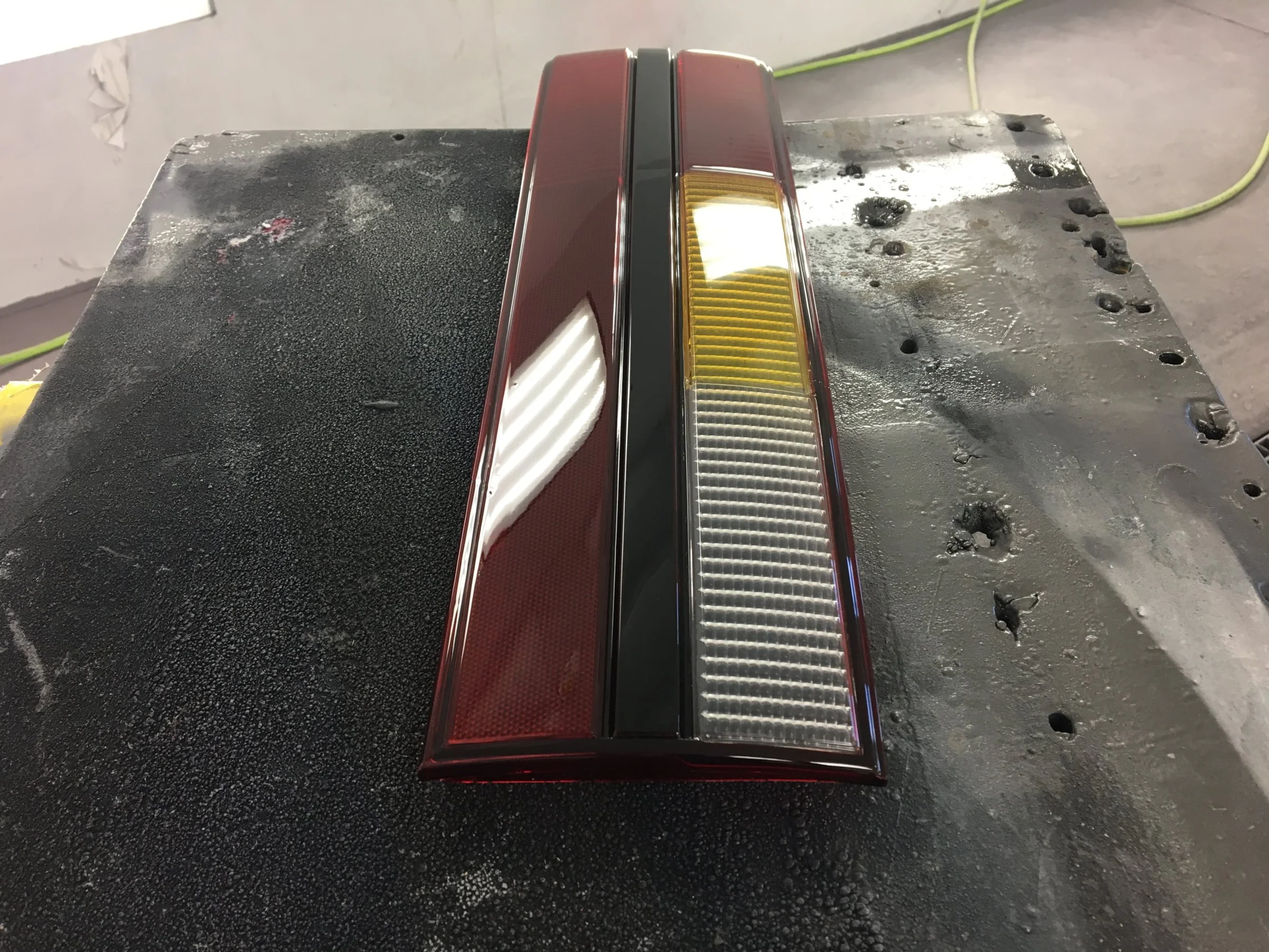

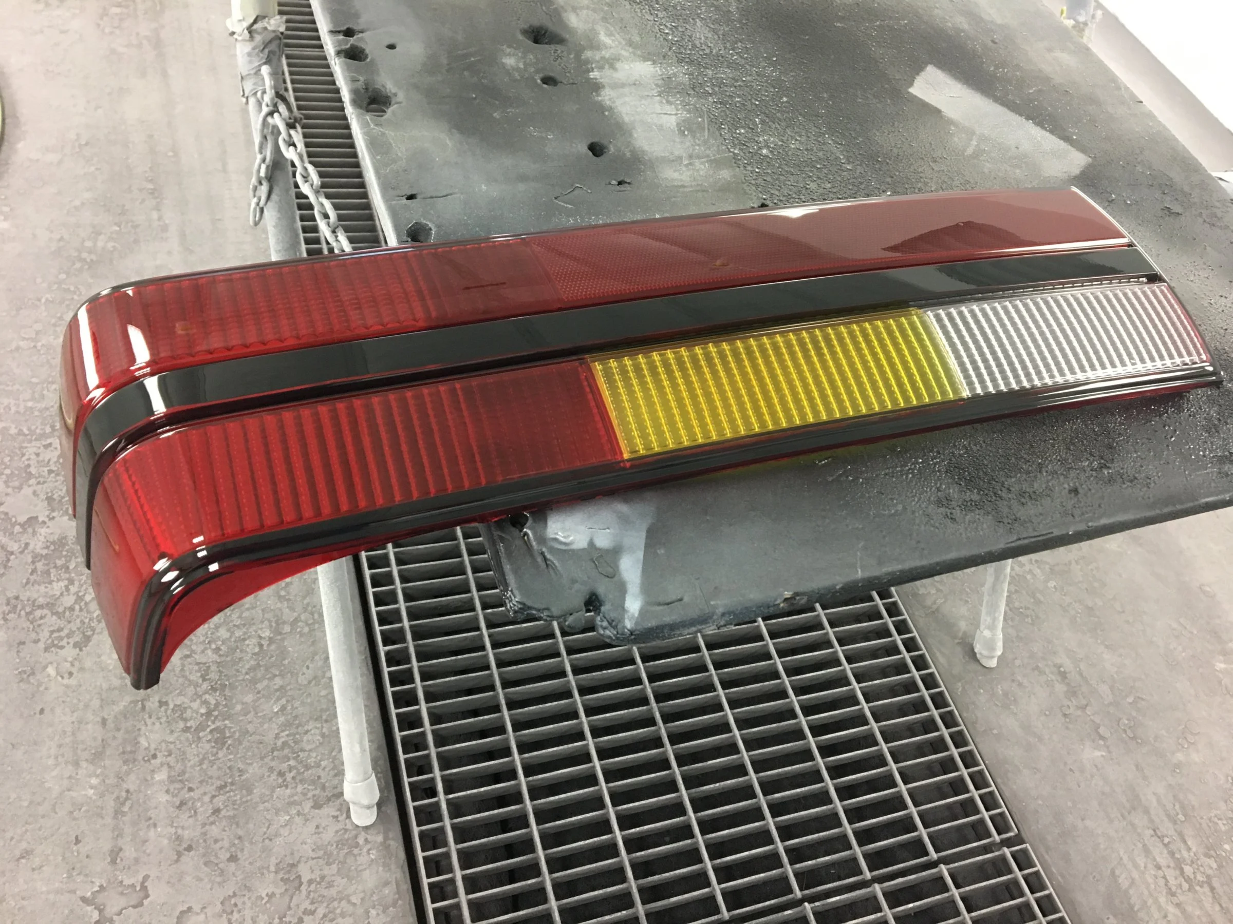

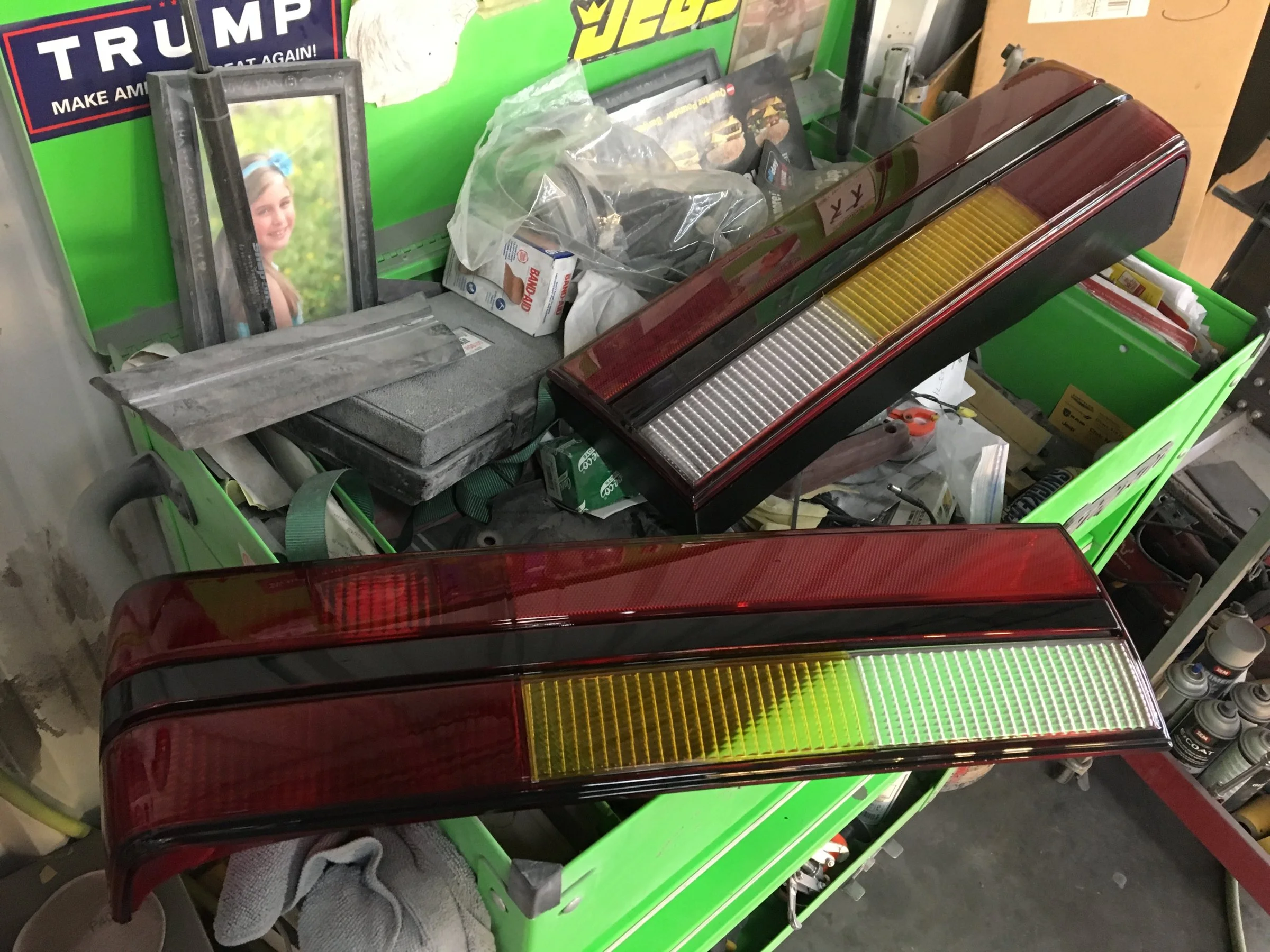

Thanks man. Of course i used an adhesion promoter prior to clearing them, just as a side note.Those taillights look awesome. I never thought and knew you could clear the lenses to look like that. WOW!!!!!
I always thought you had to wet sand and polish the lenses. Another new thing we have all learned from the Master Painter Dave.
When I can finally get to the painting stage of mine this is definitely on the list of to dos
Does that adhesion promoter come in rattle can? I don't have access to a paint gun nor do I have the experience to use one. But I really wanna revive my taillights like you did. So if everything needed comes in rattle can I'll do it. I have buddies that paint but trying to get them to do ANYTHING in a timely manner is practically impossible.Thanks man. Of course i used an adhesion promoter prior to clearing them, just as a side note.
I'm really amazed they turned out so nice though. I've clear coated headlights, taillights and the sort for other people and have seen a milky film on many of them because of the plastic breaking down deeper inside the lense. That didn't happen at all with these. They really look brand new.
