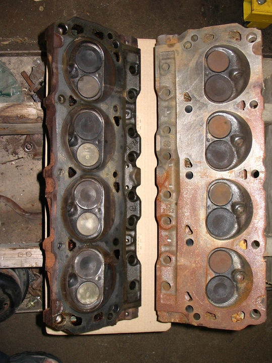

On the underside of the head
I searched for an hour this afternoon. I found all sorts of posts saying the '86 F150 5.0 has E5, E6 and E7 heads on it...so no idea what to think.
There is precendece for Ford using an engineering p/n a year early before it's debut. The 1997 explorer intake comes with an F8 lower intake, and 1992 4.6L injectors come with an F1 p/n on them. So basically i have no idea what heads came on an '86 f150
