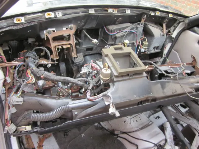

I performed this swap as well. I did an 87 2.3L to a 92 5.0. For you, the dash harness should be swapped as well. The stock 91 gauge cluster probably wont work for your swap for a variety of reasons. Some of them being your airbag, the speedometer and a different gauge configuration. I tried using my 87 gauge cluster when I swapped to a 92 engine and it didnt work. Its easiest to just do it all at once. If your 91 engine harness has the WOT and fuel relay switch in the engine bay then, you will run into problems because the 88 harness has the fuel relay under the drivers seat. This would cause there to be two fuel relay switches and the pump wont turn on unless one is bypassed. Also, dont forget to get that extra vaccum canister in the passenger side fenderwell! You need that too. If you take the dash out, replace the heater core and a/c condensor :)
Thanks for the replies!!
I am now replacing the dash harness, engine harness, headlight harness and trans harness.

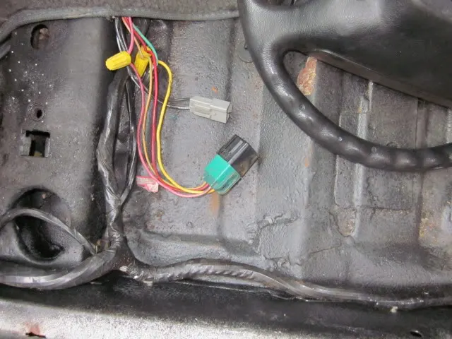

I believe it does have the two fuel relays. To bypass one just twist the wires together?
Thanks!!
If you swap all the harnesses, no need to bypass anything. It's the cleanest, less problematic way to do it. A little pita, but in the long run it's a better option for future troubleshooting
I didnt replace the harness that is under the seat with the fuel relay on it though.
Or do I not need to??
edit: I dont know if these are the relays?? They look the same lol
