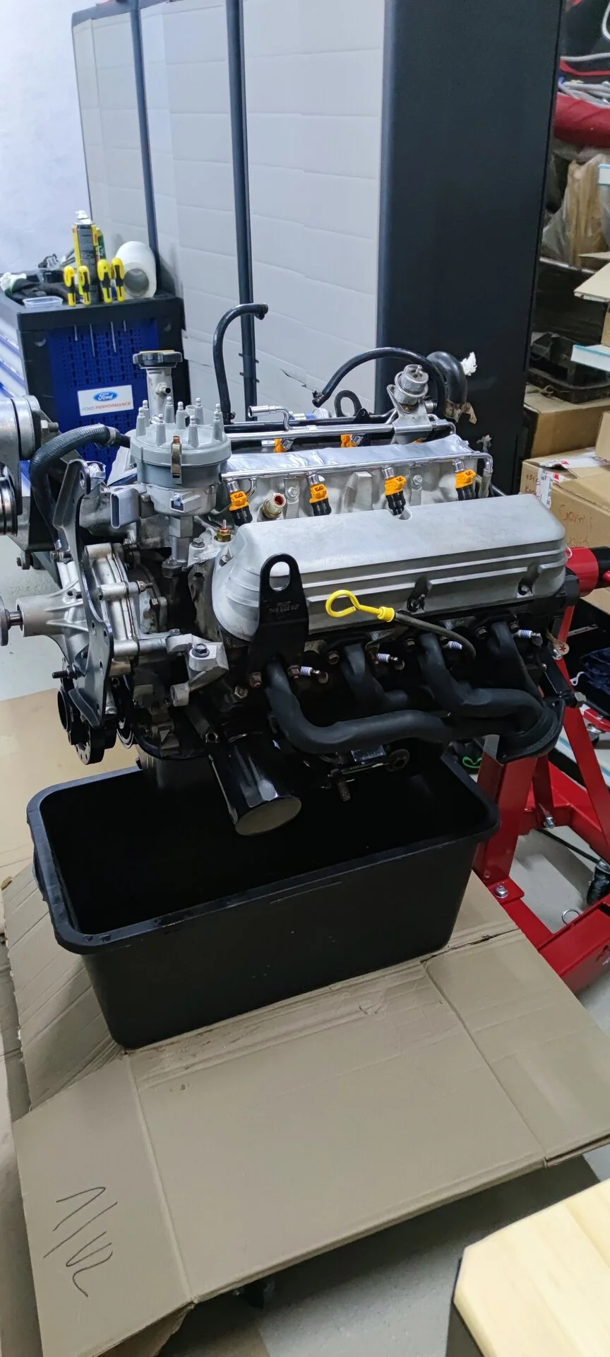

Now I will slowly take everything apart again and pull the engine...
I won't be pulling the tranny so if there is a way to move it a bit back and avoid pumping that ATF out again, let me know....
For example: If I leave ATF in and disconnect cooling lines will I have leak from tranny or the line connectors are above liquid?

P.S. This engine comes out piece of cake... so anyone hesistating - pull it out now!!!

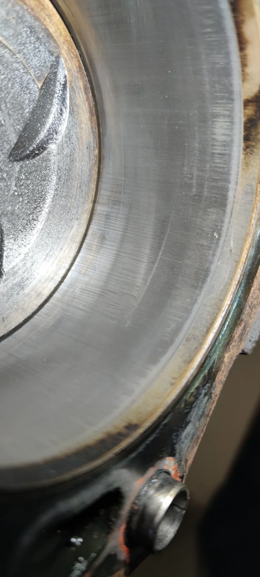

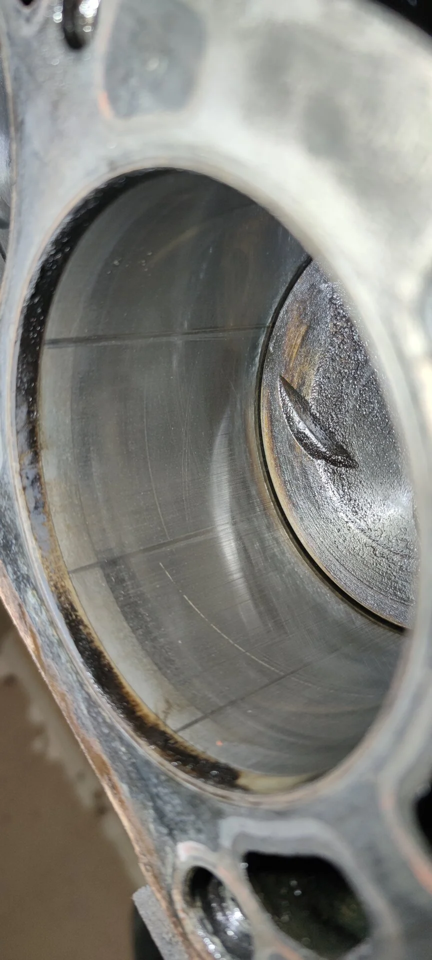

Heads are off and I have distinctive click on #5 downstroke....but still need to see if damage was done to piston itself or rod... goddamn strongest part in engine (pressed wrist pin) was damaged...
Furthermore:
- #5 has slight scratches and ridge from piston skirt I suppose, about 1" into the bore...
- #1 has scratches on three places.
We will need to bore the cylinders to 0.020".
Any recommendations for good quality/durable pistons and rings?

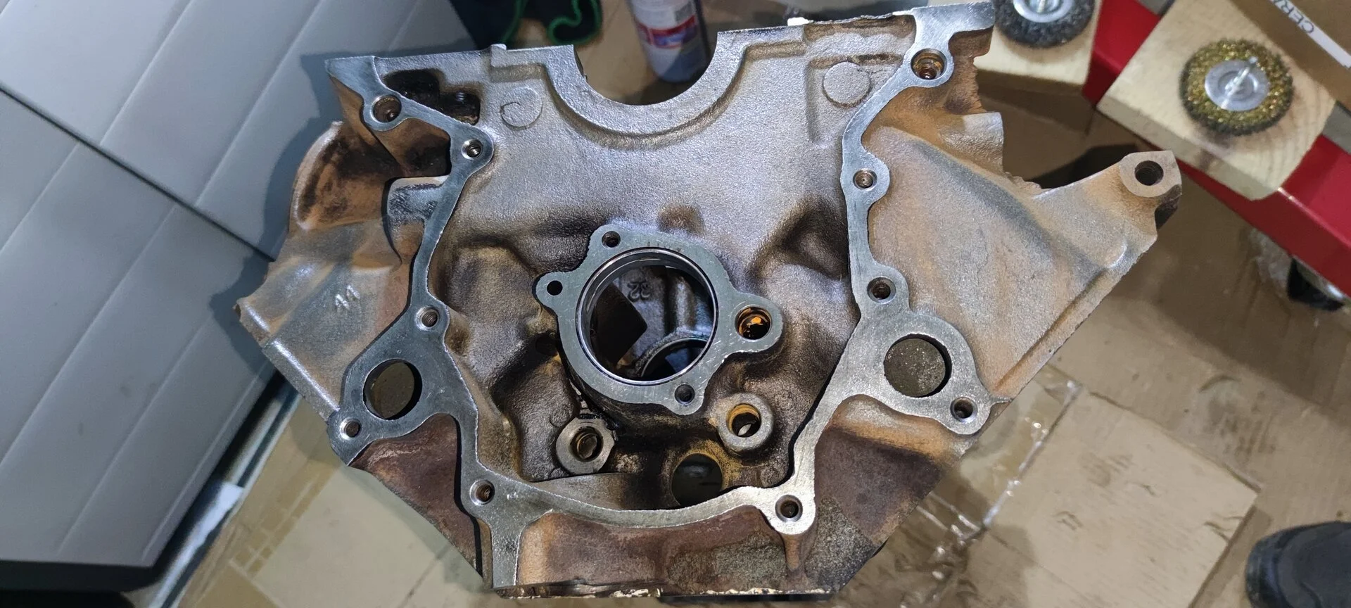

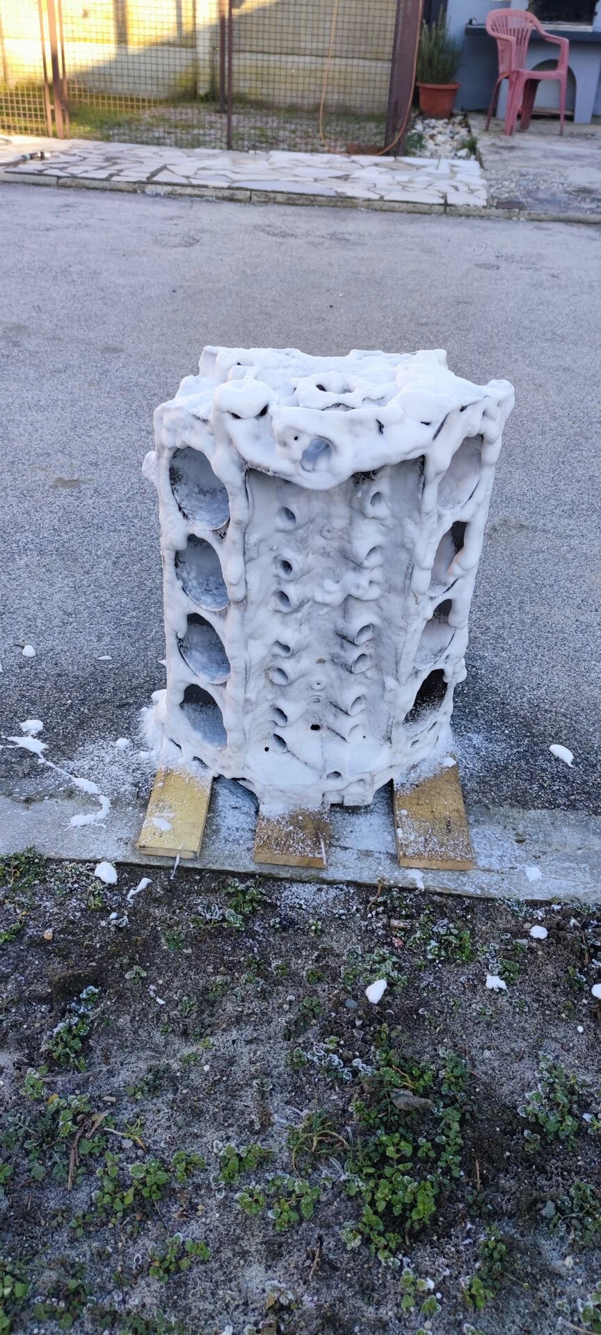

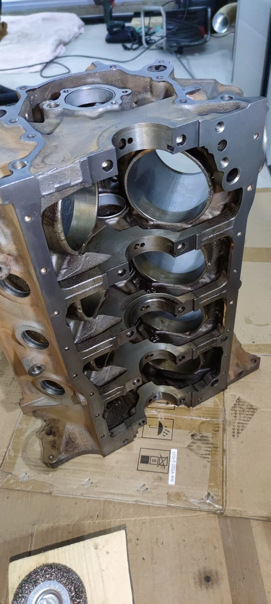

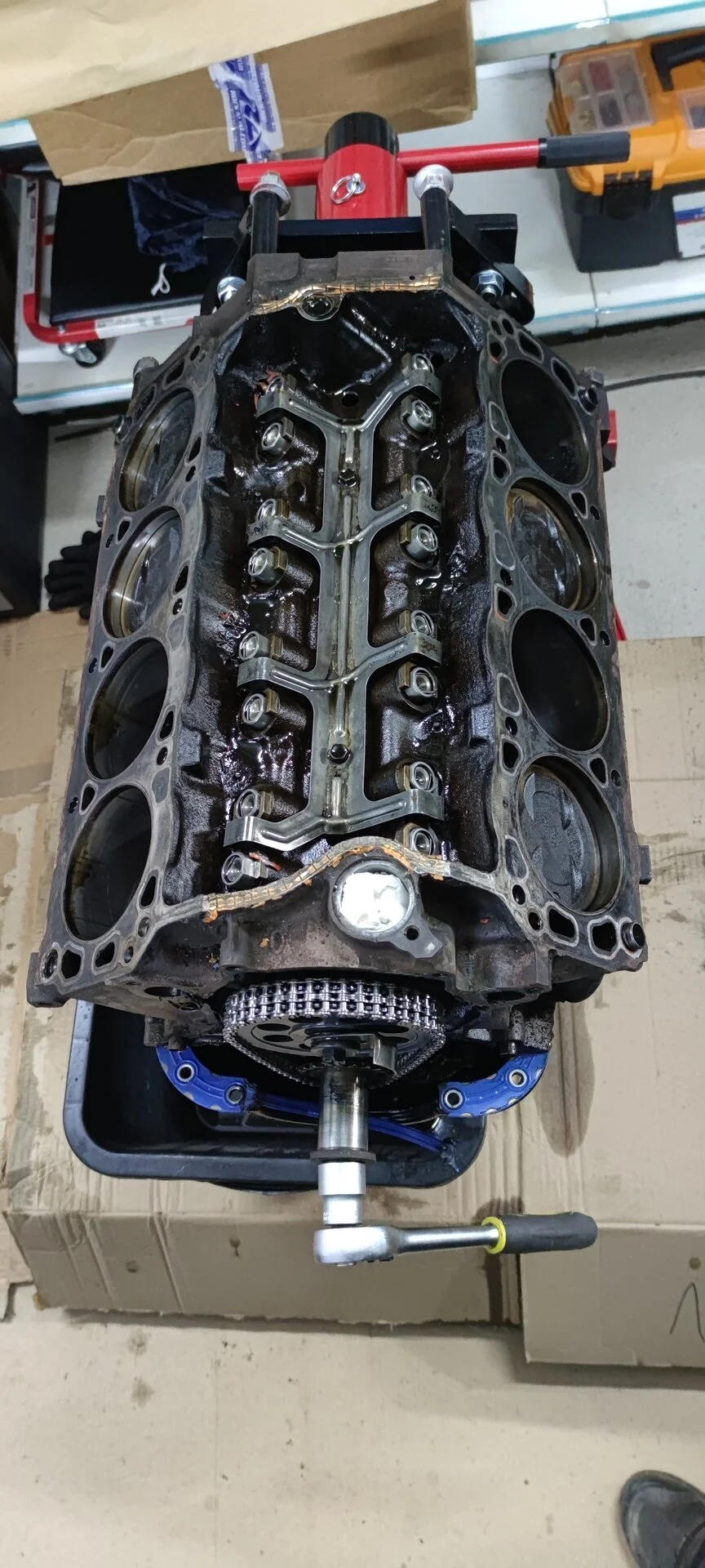

Long time no report... I had family vacation in between tearing down engine... currently I have powerwashed block and I am scraping all the crap from block and heads to paint and protect them before machining.
This is what we've seen in the way to here:
- both new main and rod bearings have dirt wear marks (lines in motion direction), so we suppose it is due to dirty redneck bottom end rebuild/refresh (from underneath)
- block was all covered in thin layer of black oil residue (I am talking about inside), but oil passages are cleaner than I expected after peaking under lower intake for the first time and in bottom end (maybe seafoam did it's job)
- camshaft had slight marks you can barely feel with fingernail on two yournals, I hope I will manage to polish that out

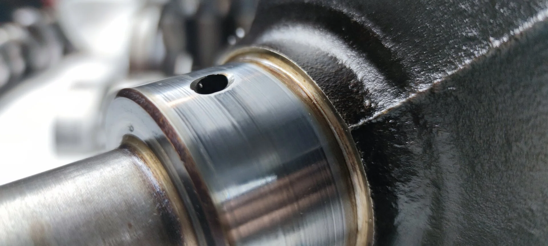

- crankshaft has scored #1 main journal exactly in the area of oil hole

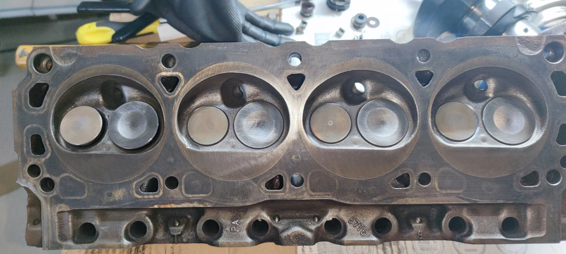

- combustion chambers were dirty as hell, but few valves I took out have nice shiny contact area, so they should be fine after cleaning and polishing
- piston #5 (the one that was knocking) has a to naked eye visible ring wear (piston ring gap is like 0.1") and cylinder wall is worn to side of outside wall. I suppose there was piston slap which may have escalated when I got the car... block was on the way to let the piston out for a walk - for sure....
- piston #1 (opposide than one that knocked) has three vertical lines in cylinder wall, and piston rings follow that "contour" and there are three embossed "nipples" following scratch marks. reason unknown.... only sign is more dirtier piston ring grooves than #5 for example
When I sum all the dirt I took out from the engine in last year, I suppose it was neglected for a long time, and I gave it too much TLC so maybe I disturbed some 30 years old crap which caused damage to #1 main journal and #1 piston wall.... allhtru #5 ring wear is still a bit unclear...
I gave all the external engine/accessories/bracket/intakes/timing cover.... etc... set of bolts a nice sandblasting and sparkling zinc coating. Yeah, a lot of labor, but got no propper imperial standard hardware store here to buy new bolts...
For the heads I have new ARP bolts, and crank/rod bolts I plan to re-use if it is suggestable?
Anyways, I hope that You will guide me so I will measure all cam and crank journals and report them here within today or next day,two. I still need to learn how to use subito bore measuring device so I can also measure cylinder walls.
Is it a smart move to give AOD to someone for rehaul? It is "working" but now I have it all apart and I can take AOD in my lap....
I am carefully listening to any suggestions....

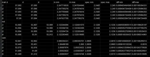

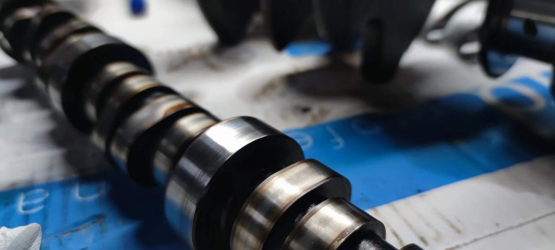

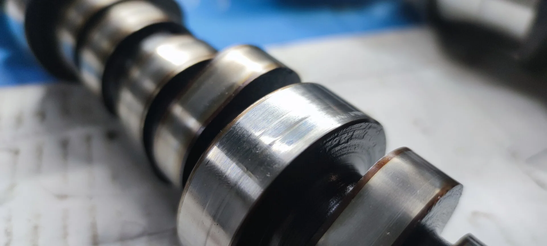

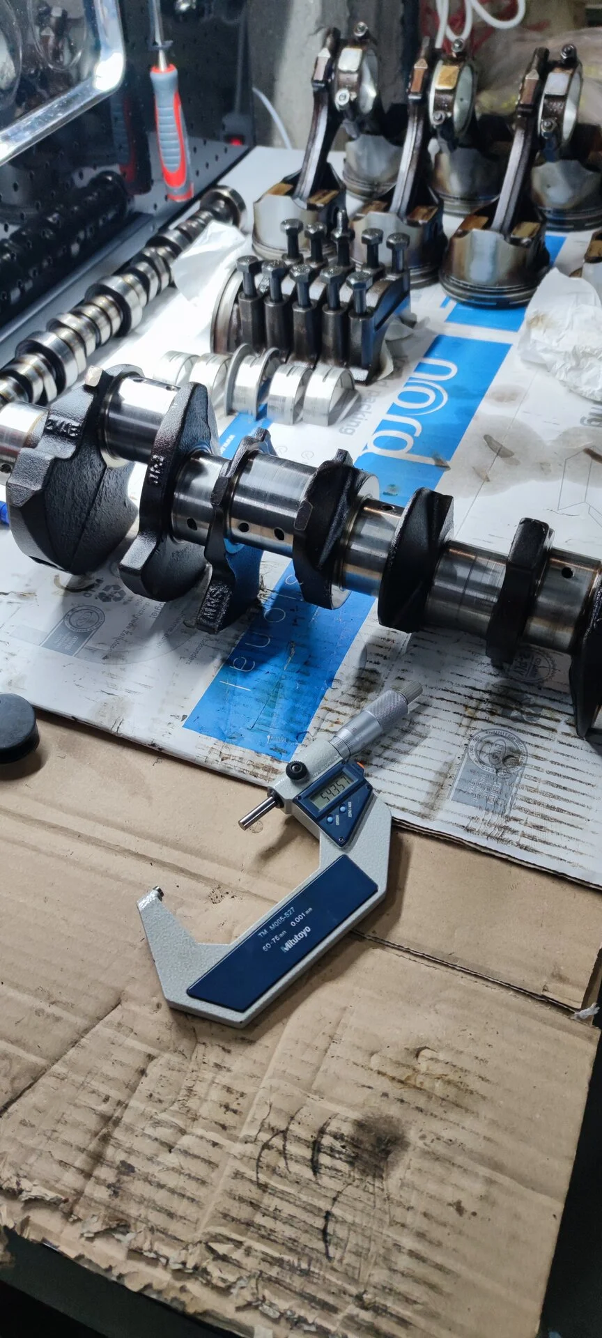

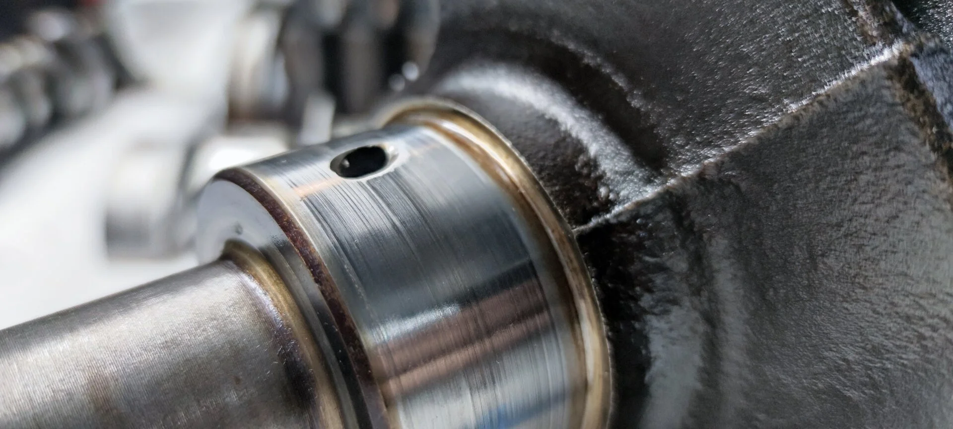

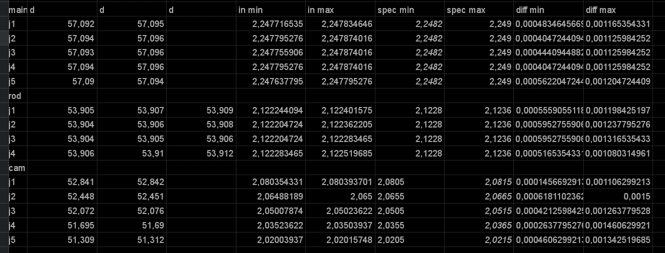

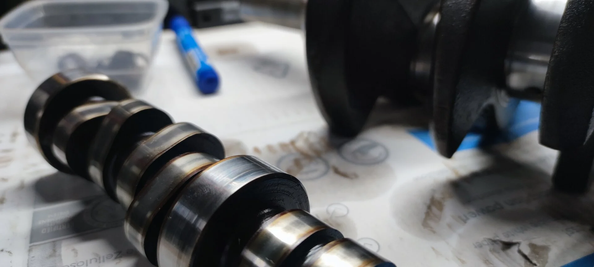

Guys, attached are all journals measures. Instrument was mitutoyo 0.001mm resolution, results are not rounded but I took 5-6 measurings and notes highest and lowest result. All journals are -0.0003-0.001" below tolerances.
Two questions:
1) This measures scream to mirror polish journals and use -0.001 main and rod bearings. Only concern is that first main has a little groove. So there is a risk.
2) Also there are no other than STD cam bearings...and two cam journals in middle have a small small groove. If I polish cam journals could I get away with it or I need a new camshaft?
Thnx and greetings guys!

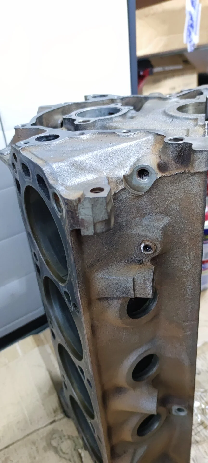

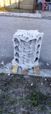

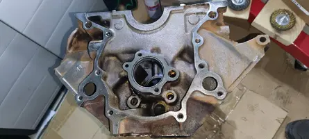

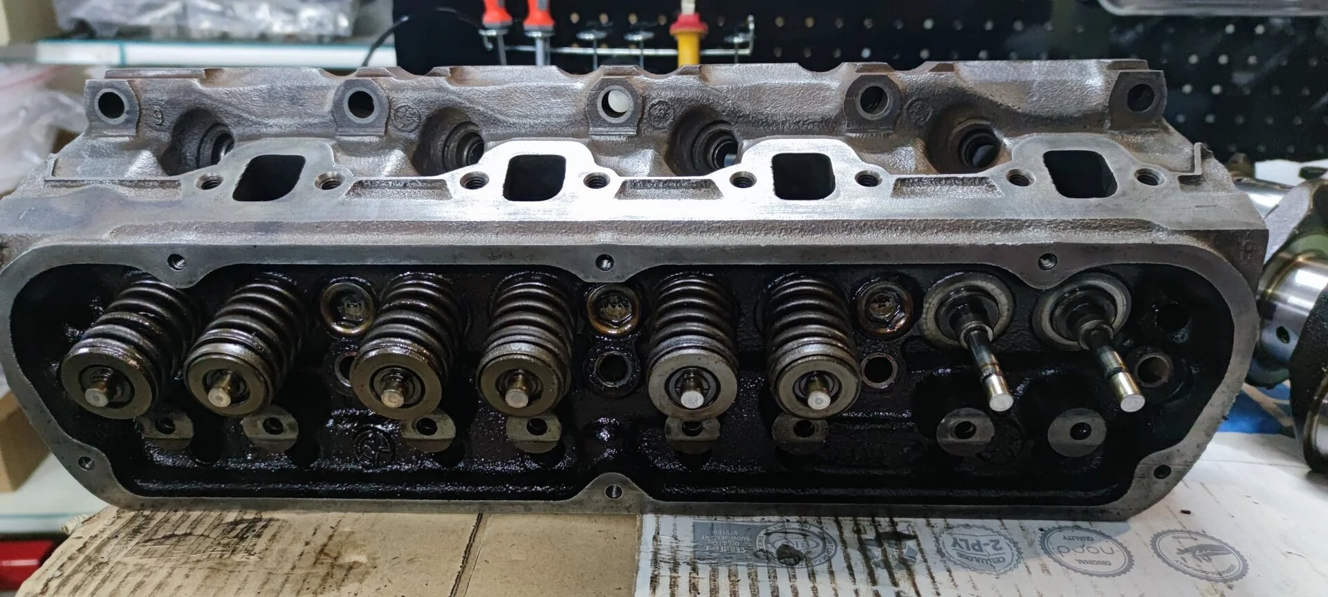

Some pics of cleaning progress also ....

Snovac,
If the block goes to the machine shop they will want to replace the cam bearings has always been my experience
Use a good inside mike (vernier dial caliper) to check the cam bearing installed size. Measure the cam bearings and journals individually
The cam bearings will loose all your oil pressure if they have too much clearance
How big a groove?
If you replace the cam bearings be sure to line up the oil feed holes
Hi!
Sorry, I had some health issues last couple of days... It's getting better now so I am returning to garage :-)
@manicmechanic007 photos may show up worse or better than real thing, but this is as close as possible I got.
See, I got a first crank journal pic and third and fourth cam journals...
Is this camshaft saveable by polishing?
