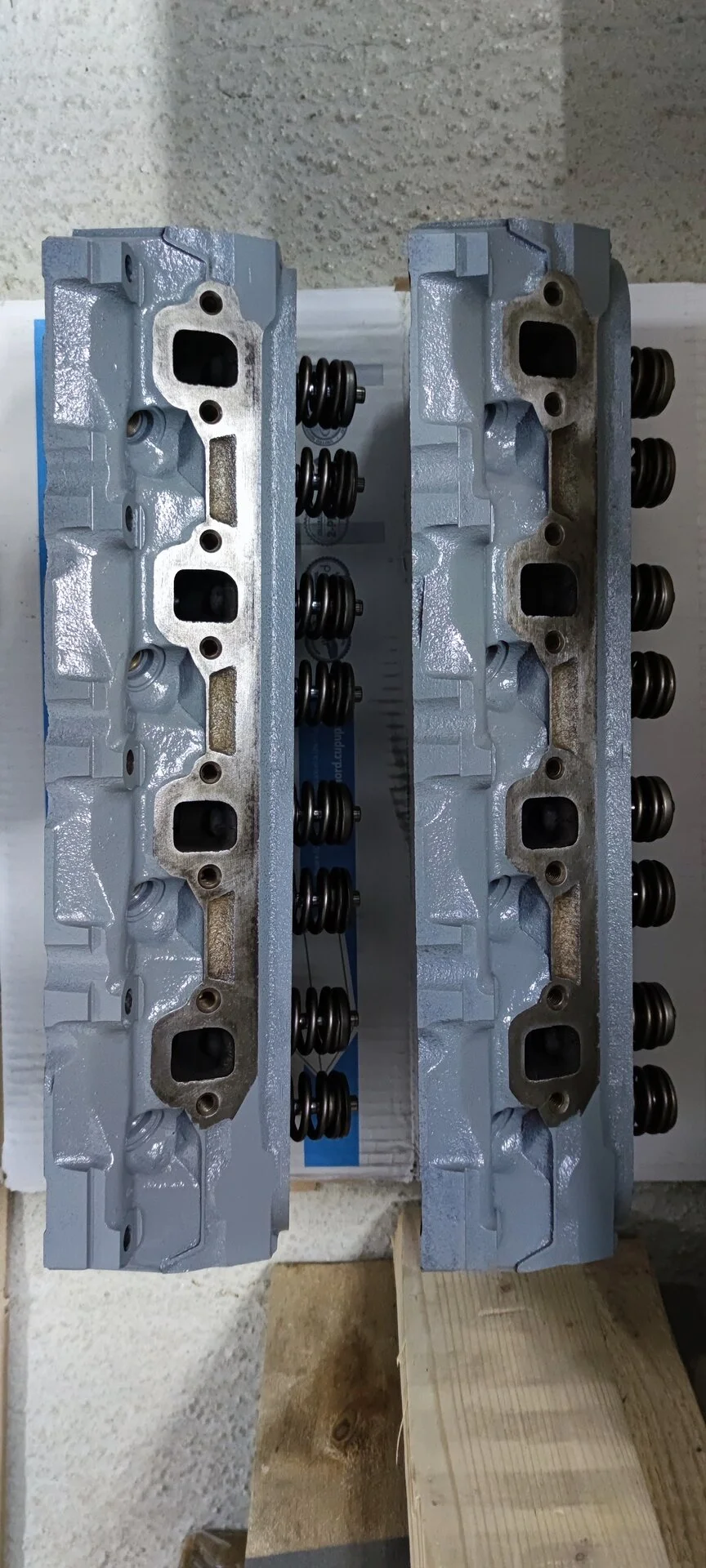

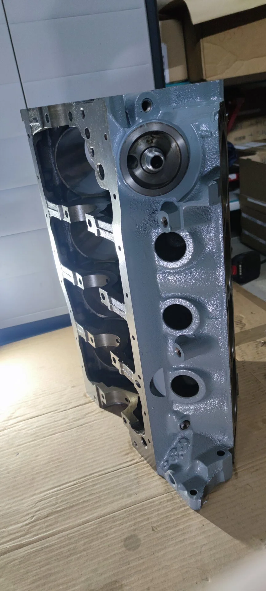

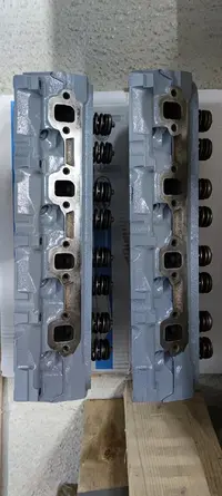

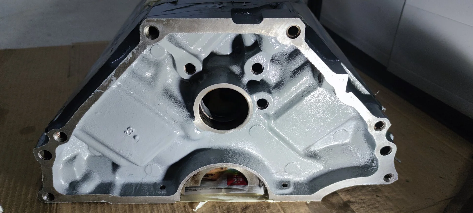

Head and block painted to prevent rust. I will use this gray after machining also. The code is RAL7005, I used 2k paint.
Similar to factory or not I don't know cause I found only a small traces of original colour...

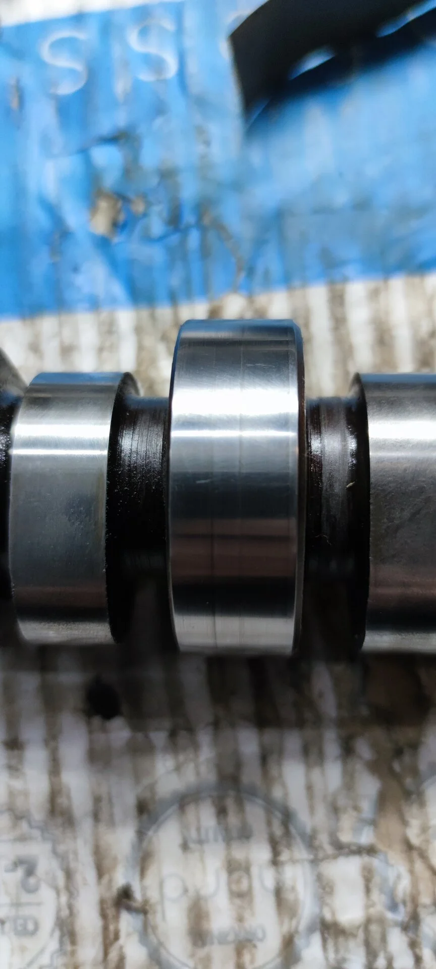

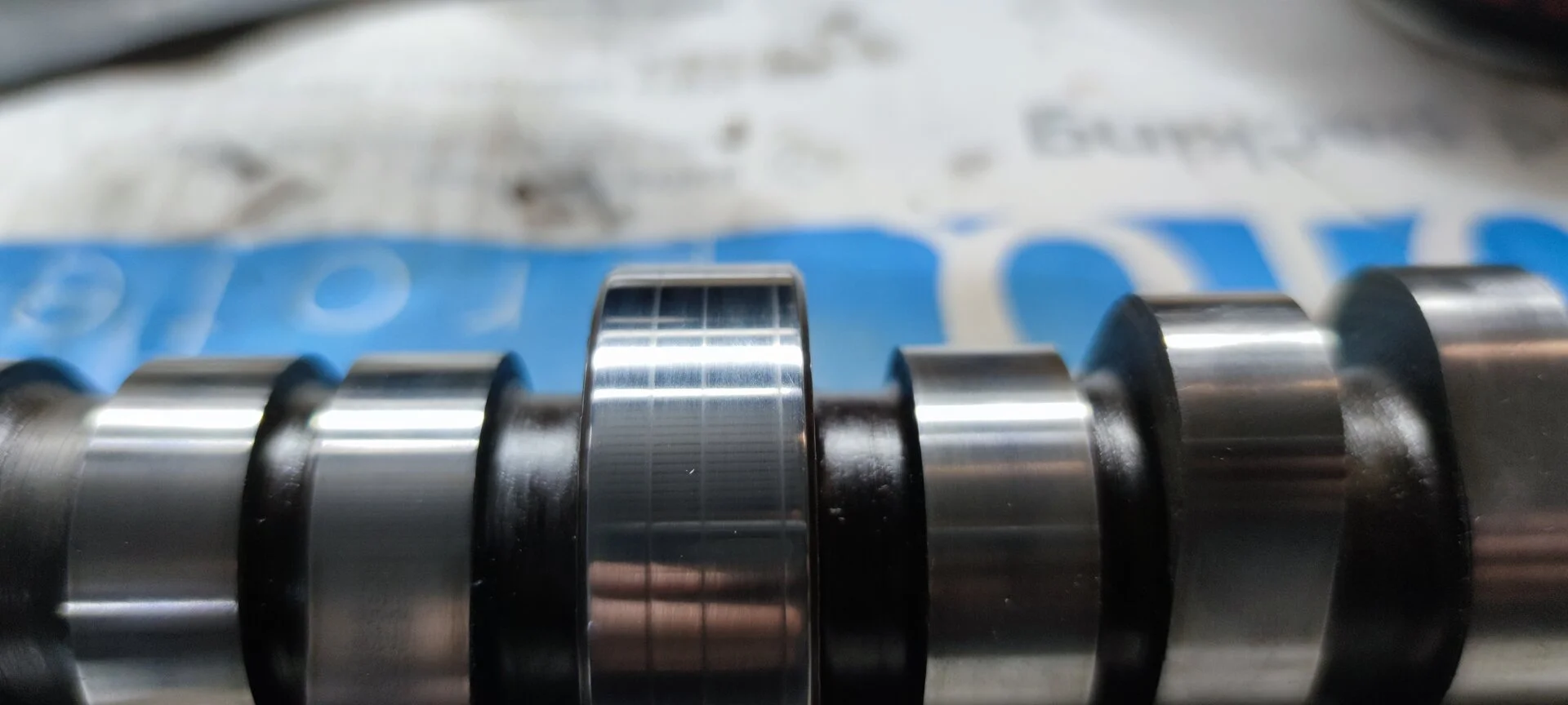

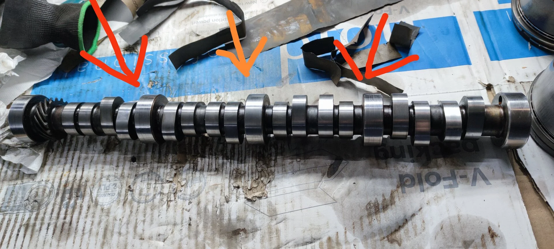

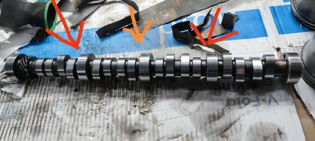

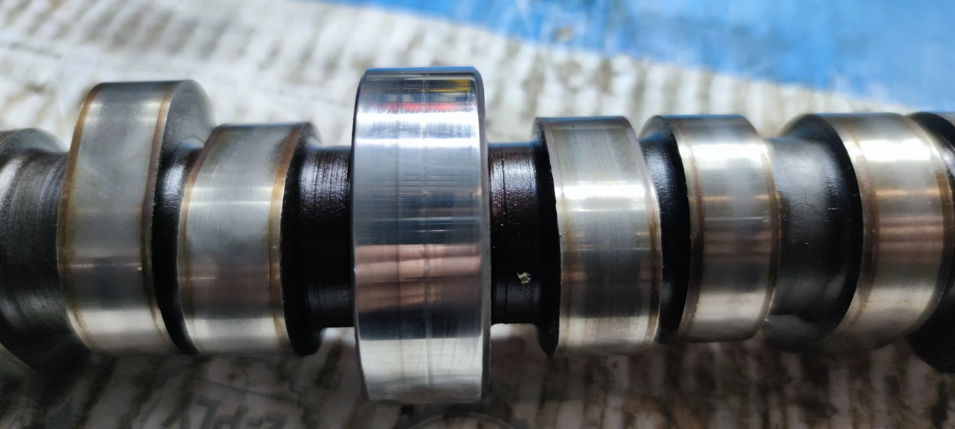

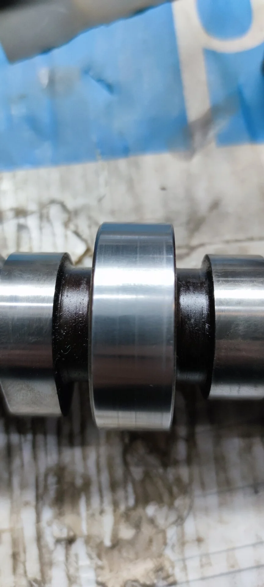

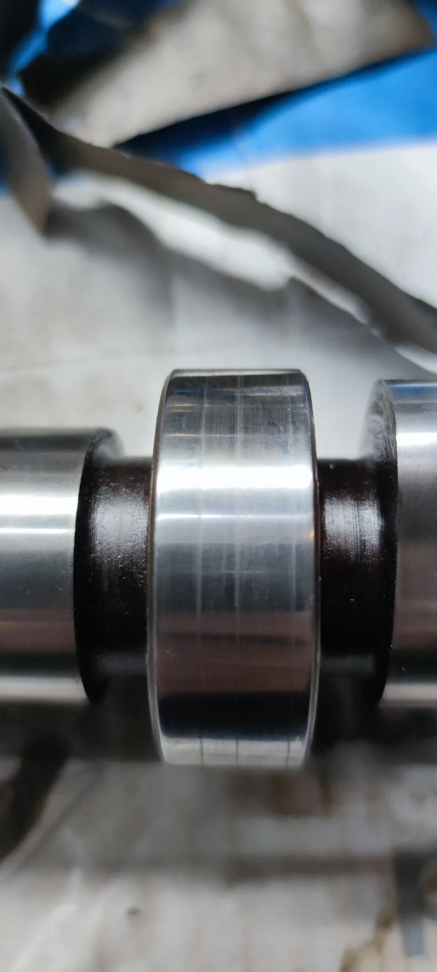

I started polishing camshaft.
Three lines You can feel with fingertip are present on second and fourth journal (red arrow).
The ones on third are more aesthetical if You like (orange arrow).
Is this safe to use?

- I polished journals to mirror shine, now there is no trace of nothing but bare nice shiny metal
- as I work in cylindrical grinding company (cutting tools) I put camshaft on one of our machines between centerpoints where cam was originaly made at least 34 years ago:

If you check a new cam that close you may find the tolerances are not up to snuff
Over here we can readily get a new Melling for about 225 from Autozone
I think if you were to measure out one of those brand new ones you would see similar numbers

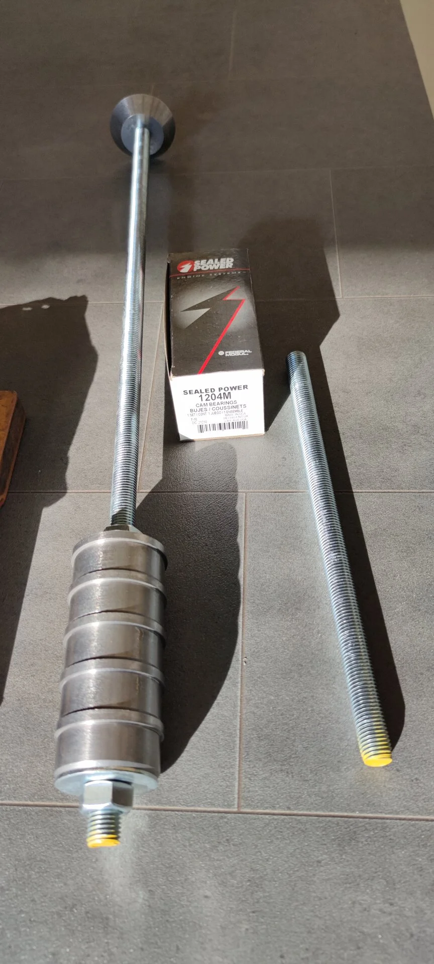

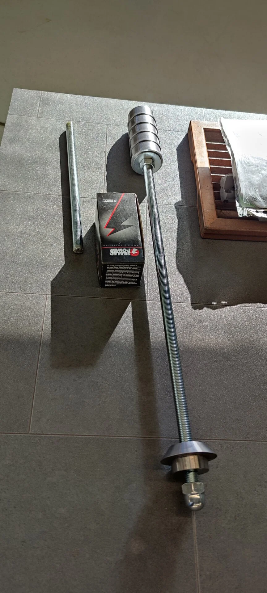

I also finished "home made" cam bearing install tool, pictures attached. I have 3D model files if anyone has interest....
