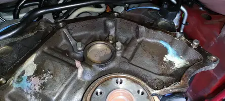

Listen to the timing cover behind water pump. If noise is there it could be the camshaft bolt has come loose or the oil slinger is hitting cover. The flywheel usually won't make noise travel to the front of engine.
Noise that loud should've given definite evidence of where it is. I'd expect bearings or pistons to be completely torn up making that type of noise. Video audio can be deceiving though.
@90sickfox and @General karthief You may be right afterall...

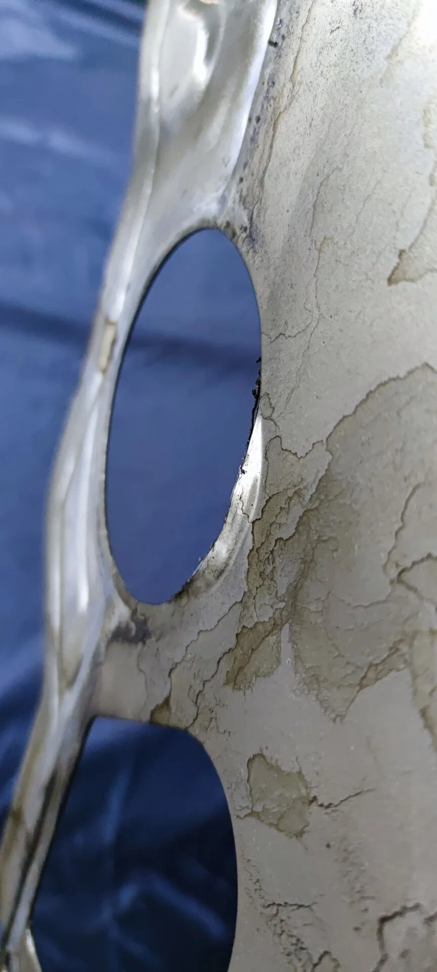

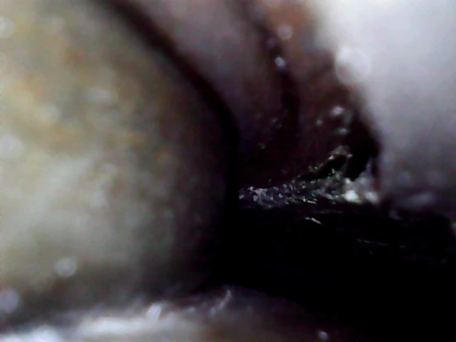

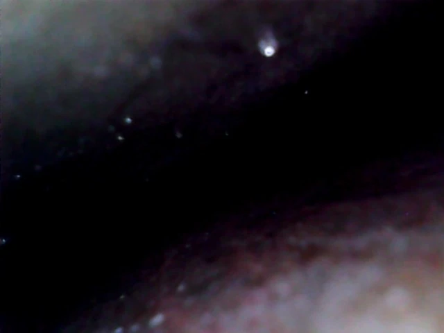

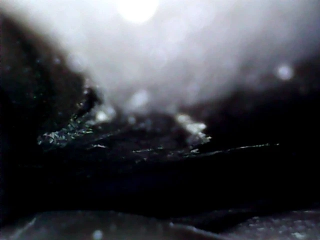

It's pretty tight there between flexplate and block plate (and I don't know there really boroscope went) but I clearly see aluminium scraping, and particles of plate when pulling boroscope out (third picture)...
Althru I need to separate engine and tranny, if this is what knock was, it would be a rise from the ashes for this fox and me...
Still need to confirm, but... how did that happen?

There really isn't anything that will cause the block plate to move. Im guessing heatvcoukd make it warp a little but shouldn't be enough to touch the flexplate. I've seen flex plates crack though just from use over the years. Doesn't happen as much on ford's but chevys do it all the time.
There's also a piece the sits at the bottom at the front of the bell housing. If something hit and bent it there it can cause it to rub.

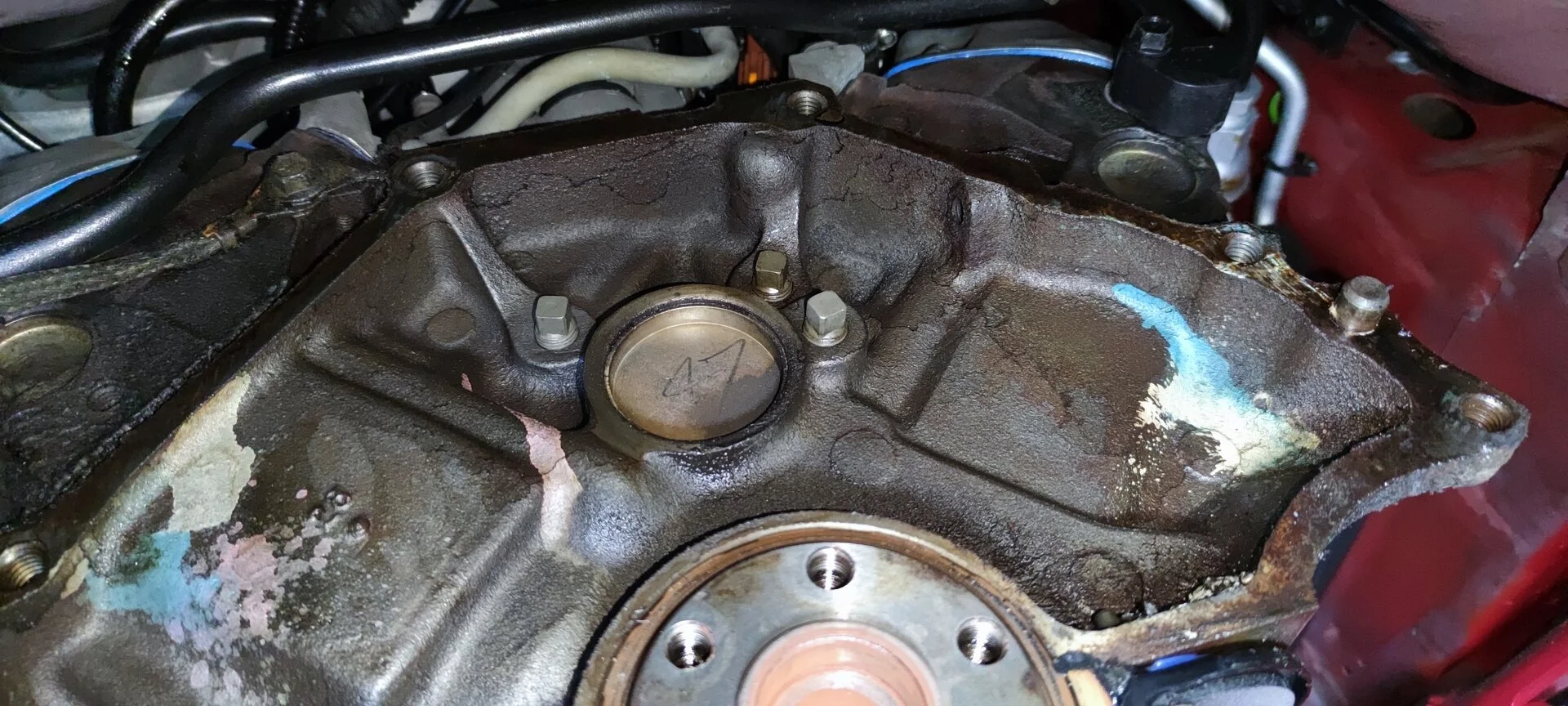

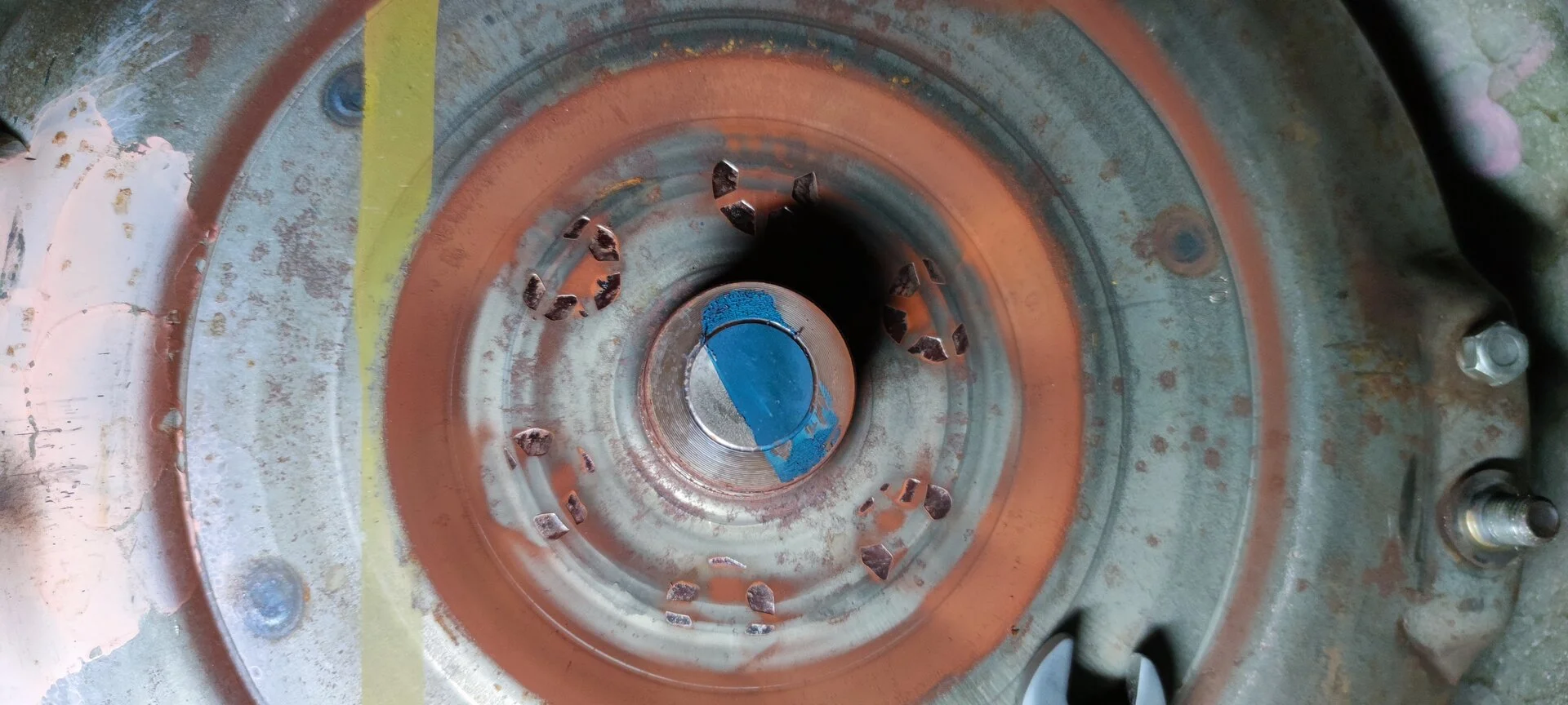

Update... I was having 'fun' putting back the front springs in their place (in order to stay alive, I used backside method with lowering LCA bushings towards engine with 100% success).
I still have some (maybe stupid) belief that the knock is outside of the engine. My goal is to separate aod from engine and start it without tranny before pulling the engine for rebuild.

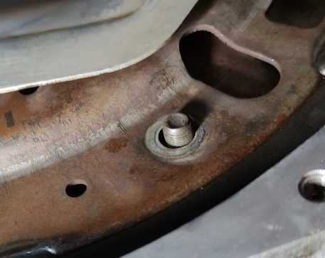

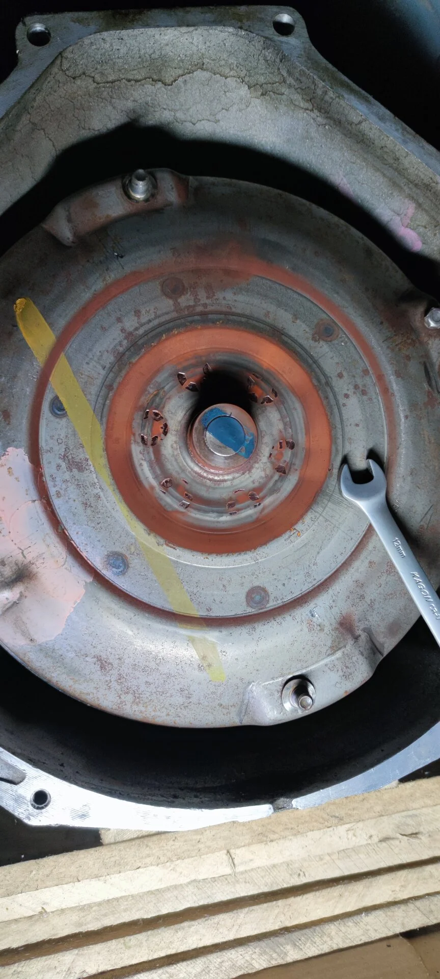

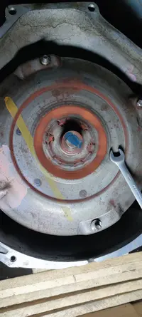

Today I took out the flexplate to converter bolts and as soon as I took them out saw some (at least) 1/4" play between flexplate/crank and converter (see pictures).
All four holes are oval and when turning the crank You can hear knock. The bolts were tight, one of them much more than others, but all of them are shiny at the back....
Is this normal or may I have some issues with flexplate/converter?

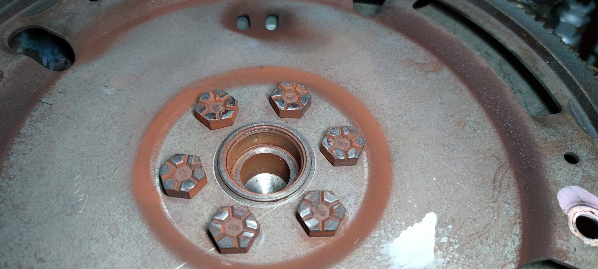

Got it apart.

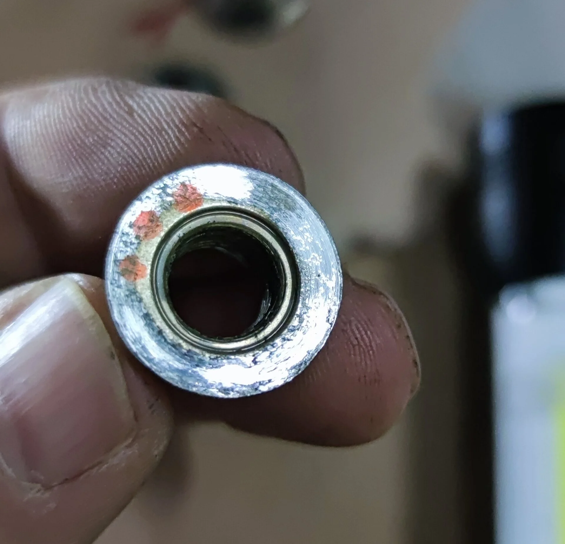

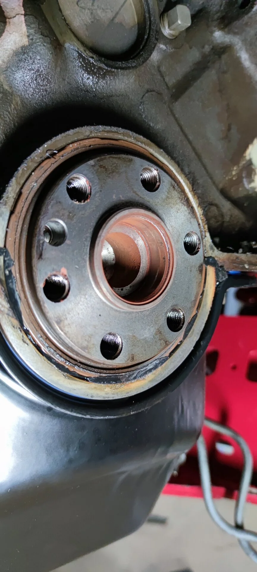

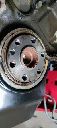

Okay guys, help: what is this? Flexplate to crank bolts pressed into converter face?

There is an old TSB for that
I think they were just putting washers between the converter and flex plate to begin with and had updated parts after that
Machine or grind down the heads of those flexplate bolts and that should do you
You could get technical and make them all weigh the same or buy some with not as thick a head
That is why they call it a flex plate
Early E4OD in trucks was so bad it punched holes in a few converters and made them leak fluid
Reactions: snovak
Thnx. Yap, got that part "flex"-plate but as I chase knock source after crank play fix I automatically saw this as a potential pushing of the crank too much forward or converter balooning or whatever...
By Your reaction this may be normal...
Put it back together and retest it after new or modified bolts
They knock real bad with those bolts contacting the converter
Not normal if they are knocking
Normal in the sense that they are so close that there are often witness marks where the bolts were
If they do not knock the marks are normal
Reactions: snovak

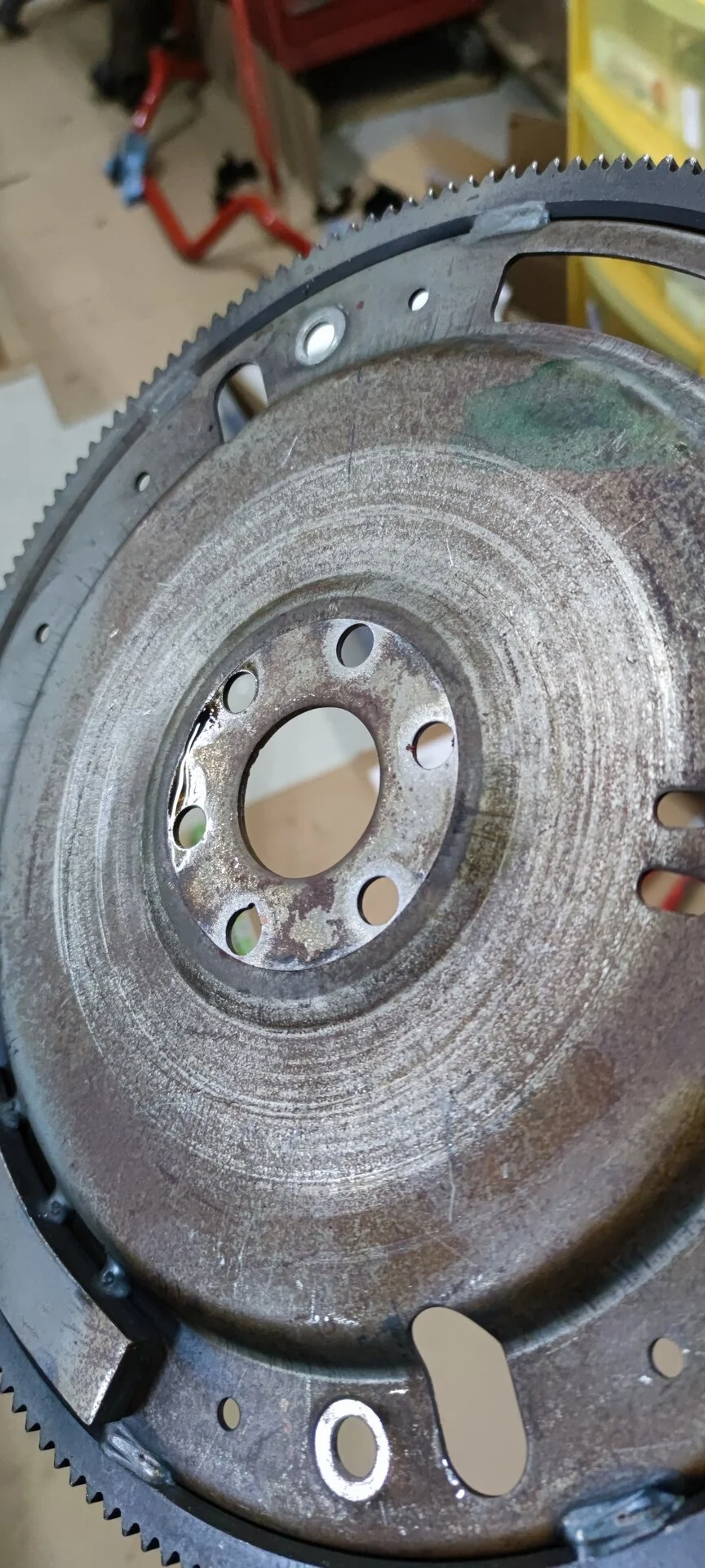

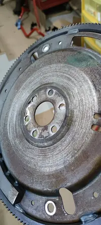

That isn't normal at all. You could install a washer between the torque converter studs and the flywheel. This would be the easiest way to tell if it's the problem. Seems like it is the knocking noise you heard. If the torque converter was bad it should've shown some other driving issues.
In one of the videos you posted it sounded like a scraping noise. The photo also looks like the spacer plate that goes between the flex plate and block is rubbing also. I'd pull the flex plate off and check the spacer plate and back of flex plate.

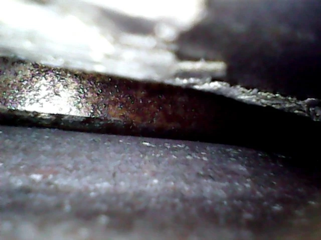

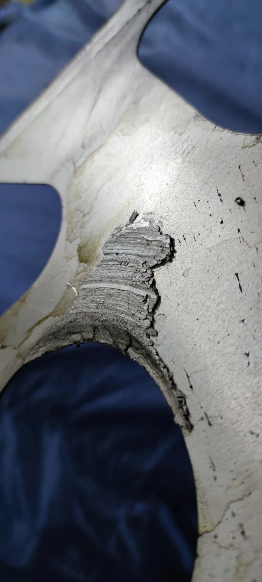

I found this behing flexplate...was this rubbing enough to make a knock? ..or to pull crank back so the thrust bearing was worn more in front?
Where did this aluminum came from?!
