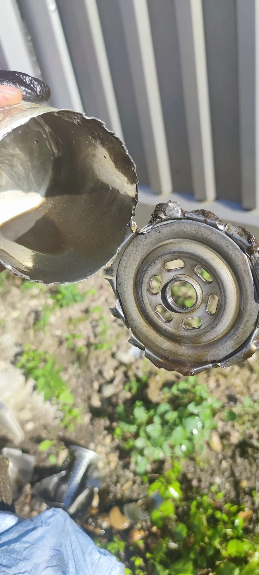

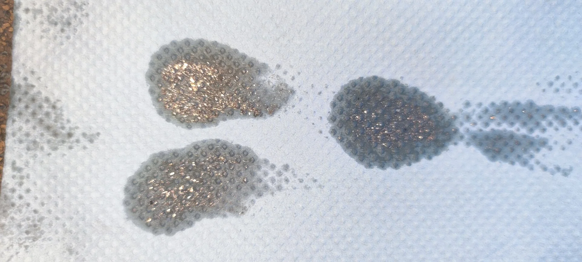

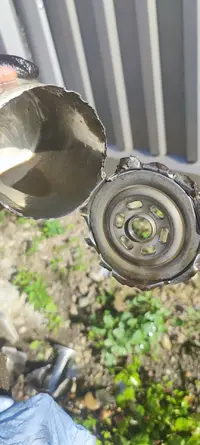

Opened filters:
First filter (two heat cycles) has "normal" running-in few shiny particles.
Second filter (300miles) is worth a gold... some bearing(s) on the way out...
I suppose main/rod. Cam bearing has no copper/brass, right?
1st rebuild fail. Damn I feel bad. It was possible scenario, but you know....sh**!!!
Will report when I gather strenght to dig in again...will also try to measure compression before pulling...

Ouch.... Me and luck? No way.
Opened filters:
The metallic sparkles would be pretty as paint. They are not schoen as oil contaminants.
If this was a non roller cam (flat tappet), I would suspect a chain of failure. With a roller cam, besides an out of round journal as I think you suspected, @General karthief ’s oil path issue idea needs examined closely.

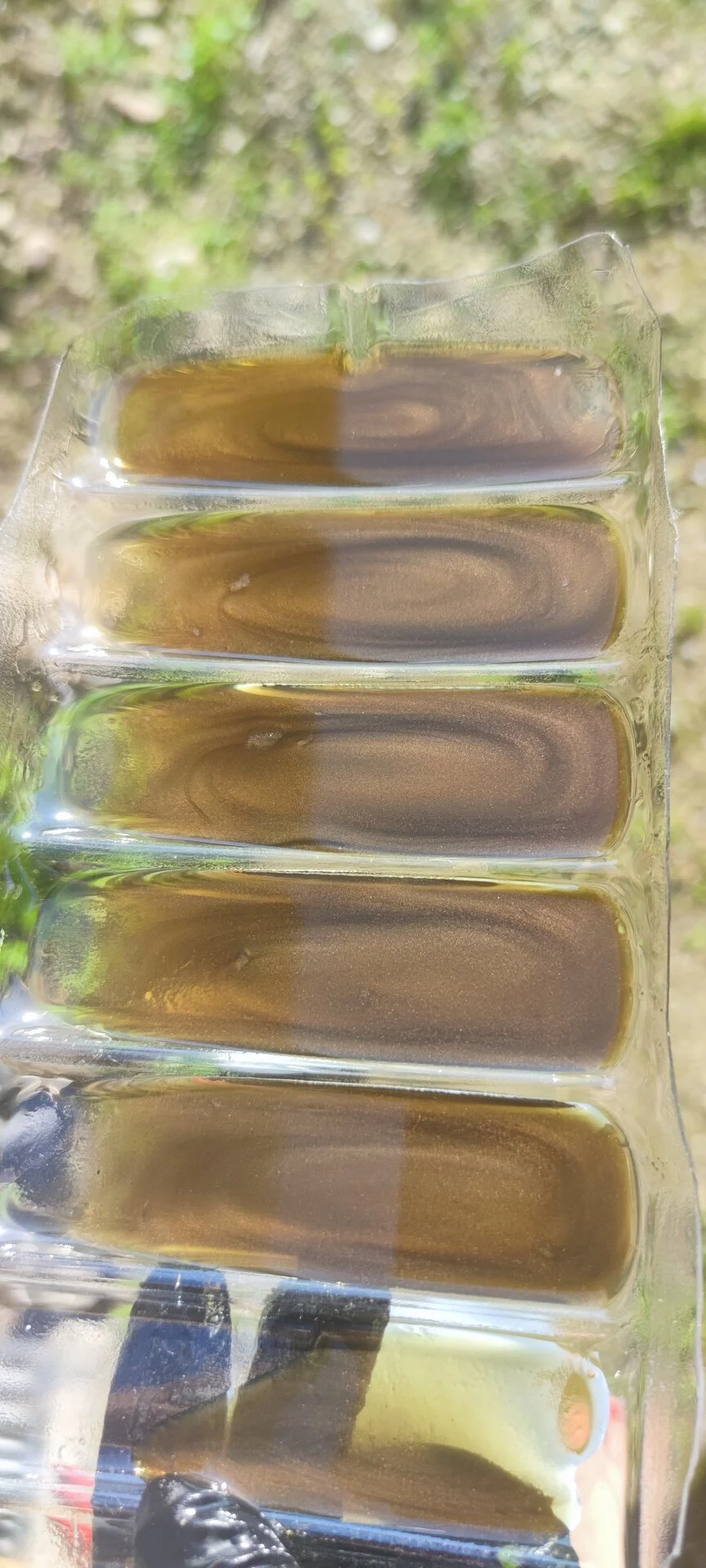

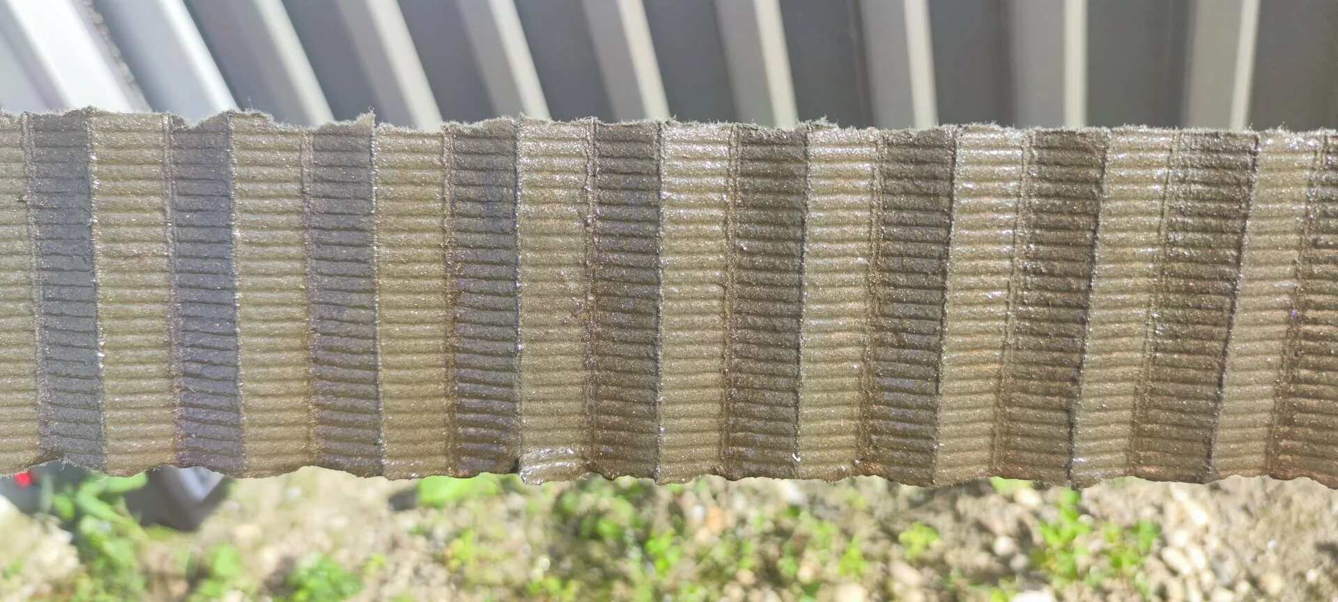

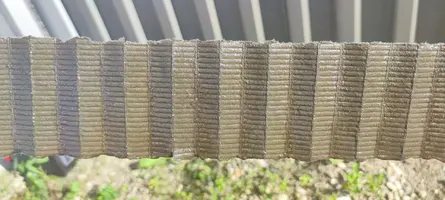

Grabbed courage and went to car before I get sick from PTSP.
Checked filter again. Copper or brass. Magnet does not pickup particles. Most particles were luckily in filter. Drained oil nothing to none.
Edit: added picture
I would say crank. Machining problem cause I plastigaged. @7991LXnSHO either out of round or taper.
Oil hits mains first, as I understand then it makes thru 3 long channels to upper part. I cleaned all of thoose very carefully (like a gun cleaning brush). Lifters disassembled and cleaned, cam new, cam bearings new...makes no sense. I would bet on crank issue.
Anyone has a good 50oz crank at home or to recommend?
Edit: added picture
