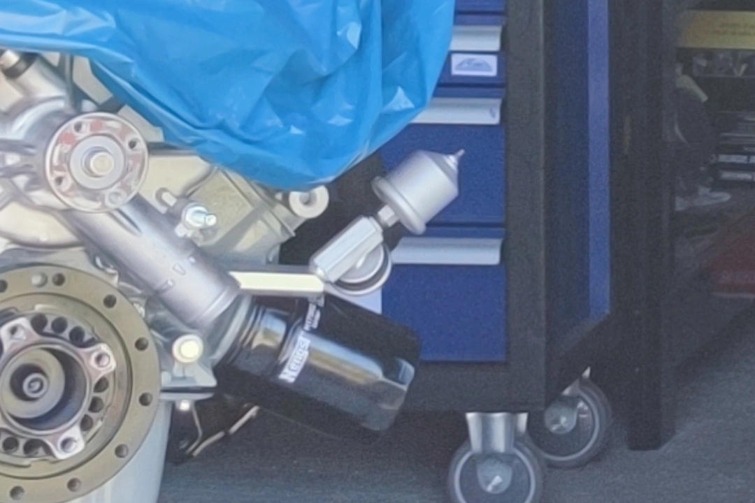

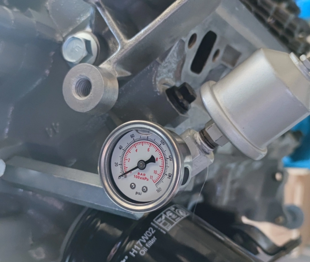

Ok what is between the oil pump and the gauge that would make the oil pressure fluctuate?
Stock extension -- T-fitting -- stock sender straight and gauge is pointed to driver (right above oil filter). I used teflon tape on setup.
Found it...very enlarged picture is exact setup. Second picture was first setup but I forgot about AC and steering pump (hahaha) so gauge is turned 180°
