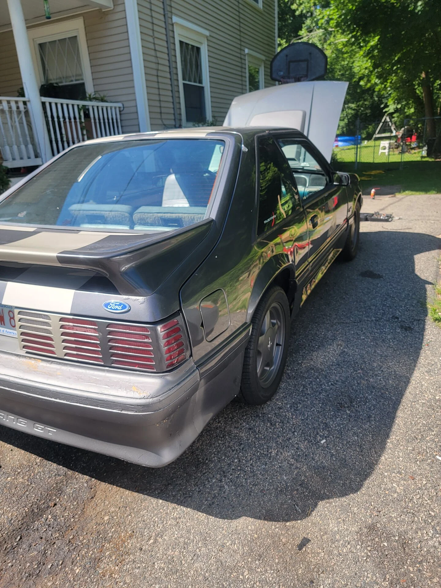

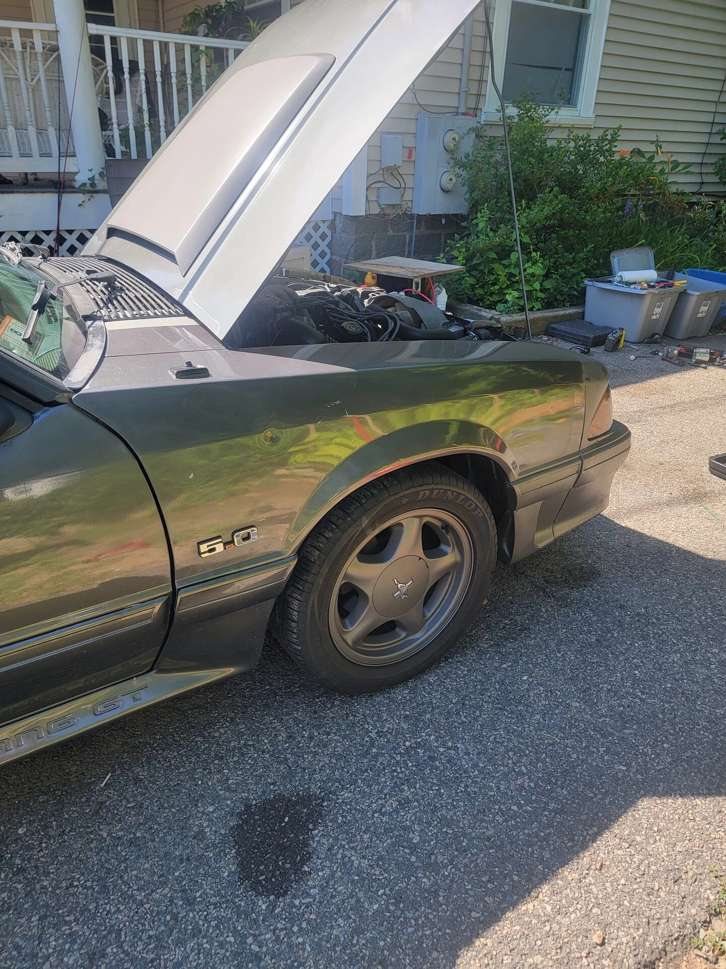

It's gray and the bumpers were blue so I gave it a quick prime with something close that matches,now I didn't paint this car I got it like this but I'd love a nano gray color,and I can paint I just don't wanna do it outside and a question I was sent a front pump seal I'm not sure ¹where it goes but is it worth keeping to give to the transmission guy next week cause it's dripping from the bellhousing

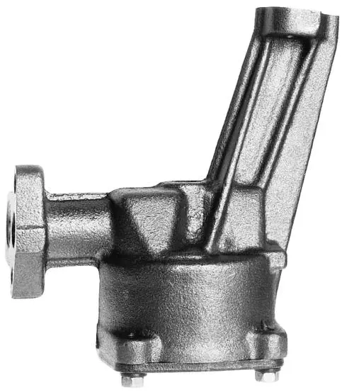

Put a high volume pump in it and be done with it
The longer rotors will require a pan mod on yours it looks like
I will post the pics of both pumps and the literature for the Ford SVO pump
I have a gap and roush roughly the same pump in my 69
I'm so lost what u just showed me idk it might be time for the car to go bye bye.ill never find another with a untrusted towers and frame rails it's mint just the motor needs a new one to many leaks and gaskets I try to think I can fix it and ppl are like ya I'll help ya and no help,I have so many parts for the car I already know I'll lose money
I just showed you the difference between a high volume and a standard oil pump
