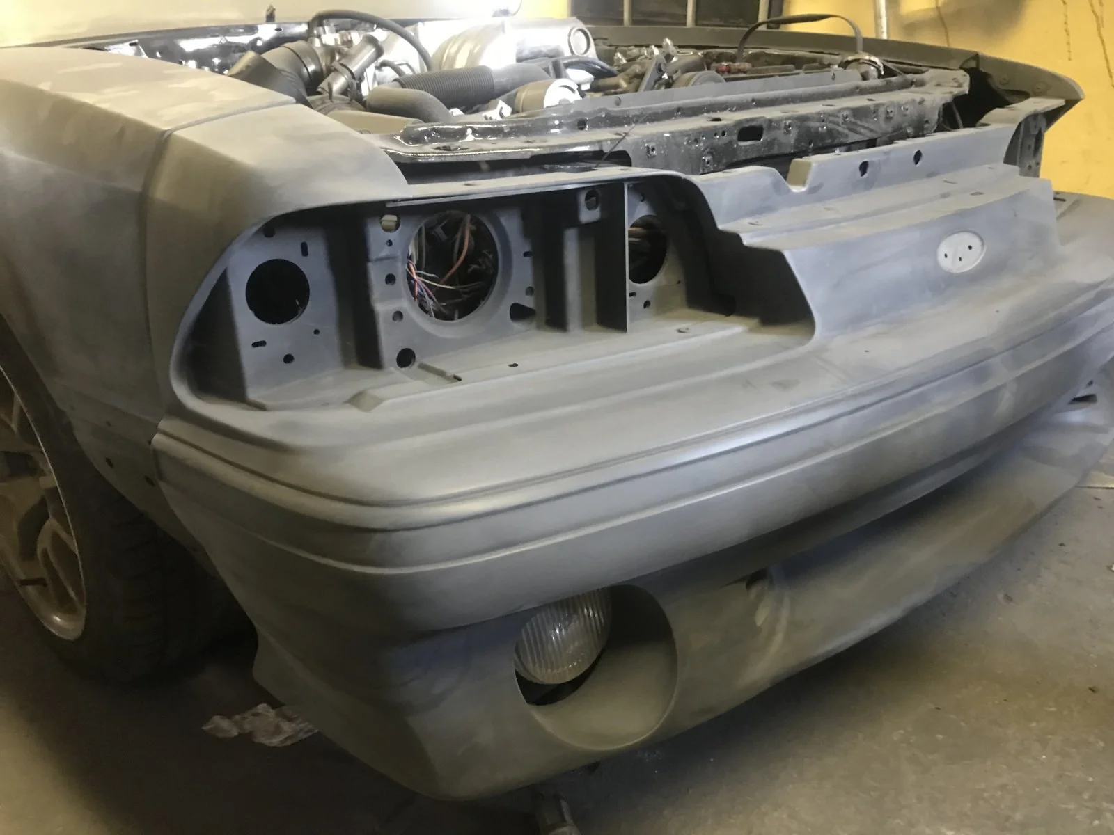

Just a couple dirty pics with some updates. Front bumper is basically done. Feels good to see the car with panels , even if they are just sitting there.

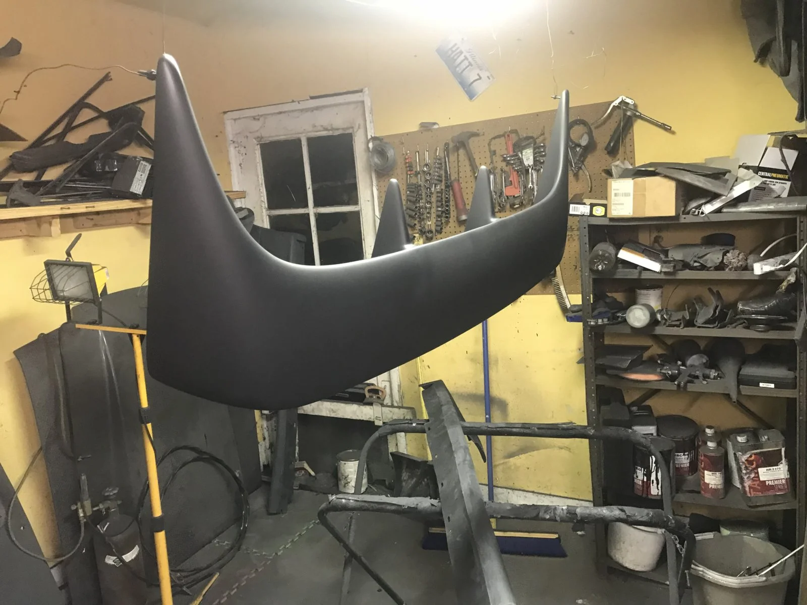

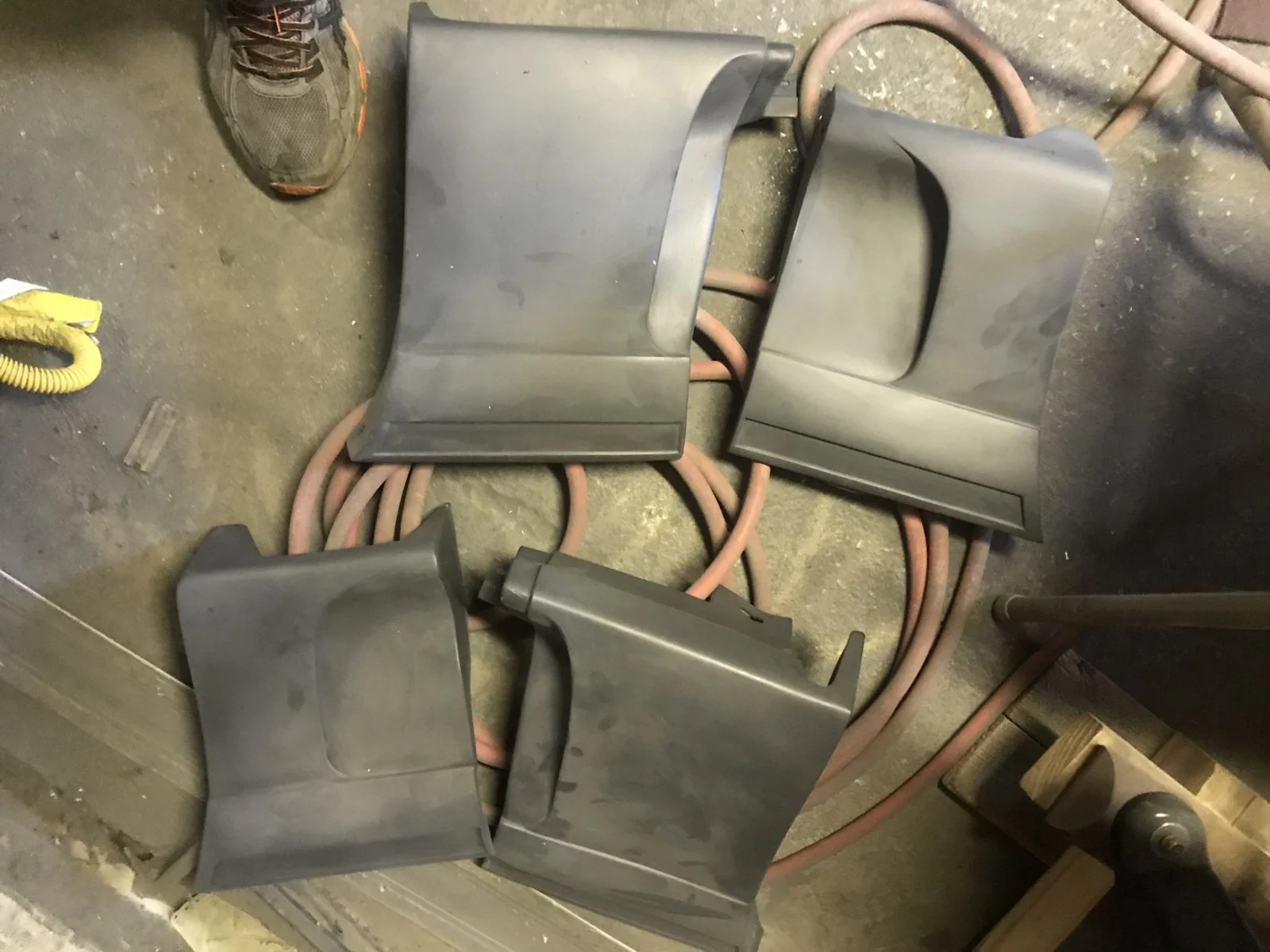

Fender extensions are just about done. I replaced the front two due to damage. Sanding inside the scoops is a blast.... they are blocked out and just need a couple spot primes in the edges.

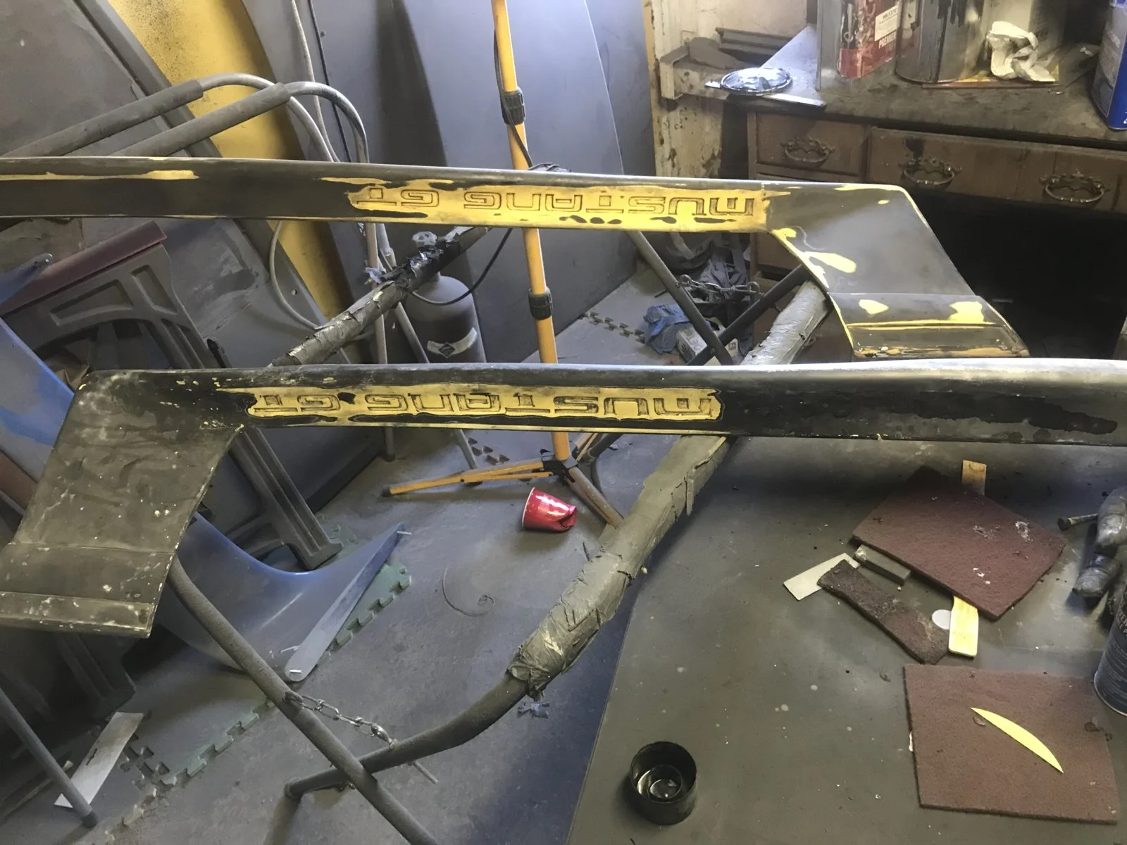

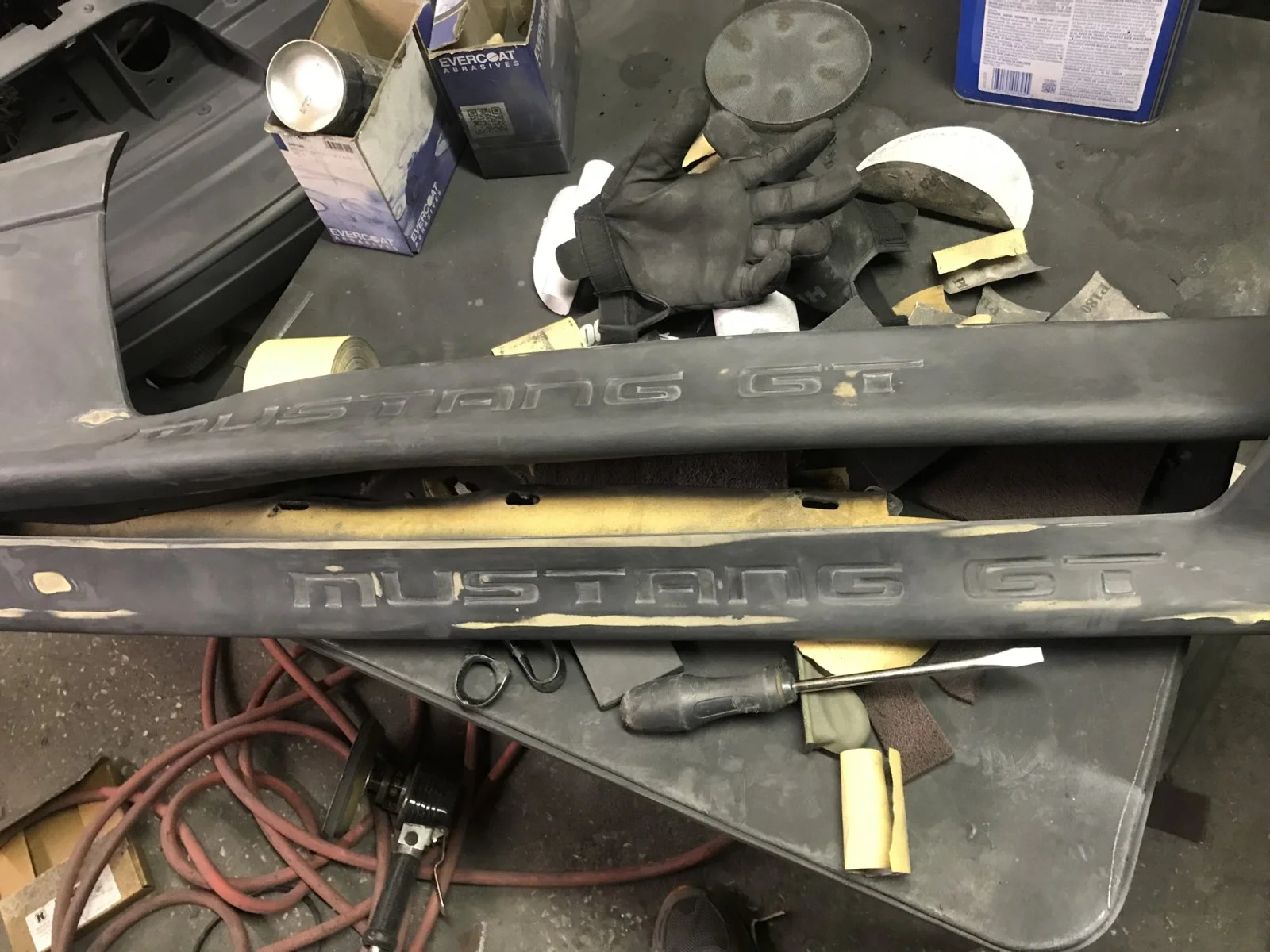

I’ve started on the side skirts. So far I’ve been focusing on getting the MUSTANG GT lettering as clean as possible. This is not an easy task. Hoping to have them in primer this weekend and start blocking.
Doing the side skirts tells me there has been 2+ paint jobs on The car. The factory black single stage. A repaint with black base:clear. Then I think it was shot with some kind of liquid body filler product along with various dent and ding fills over the previous coats, then somekinda sealer with the single stage white on top. I almost wish I would of weighed the car before I started. I read online that a paint job weighs something like 30lbs. I’m curious how much lighter it’ll be.

More slow progress. The side skirts are in primer and started the first blocking. These things get tons on tiny imperfections.

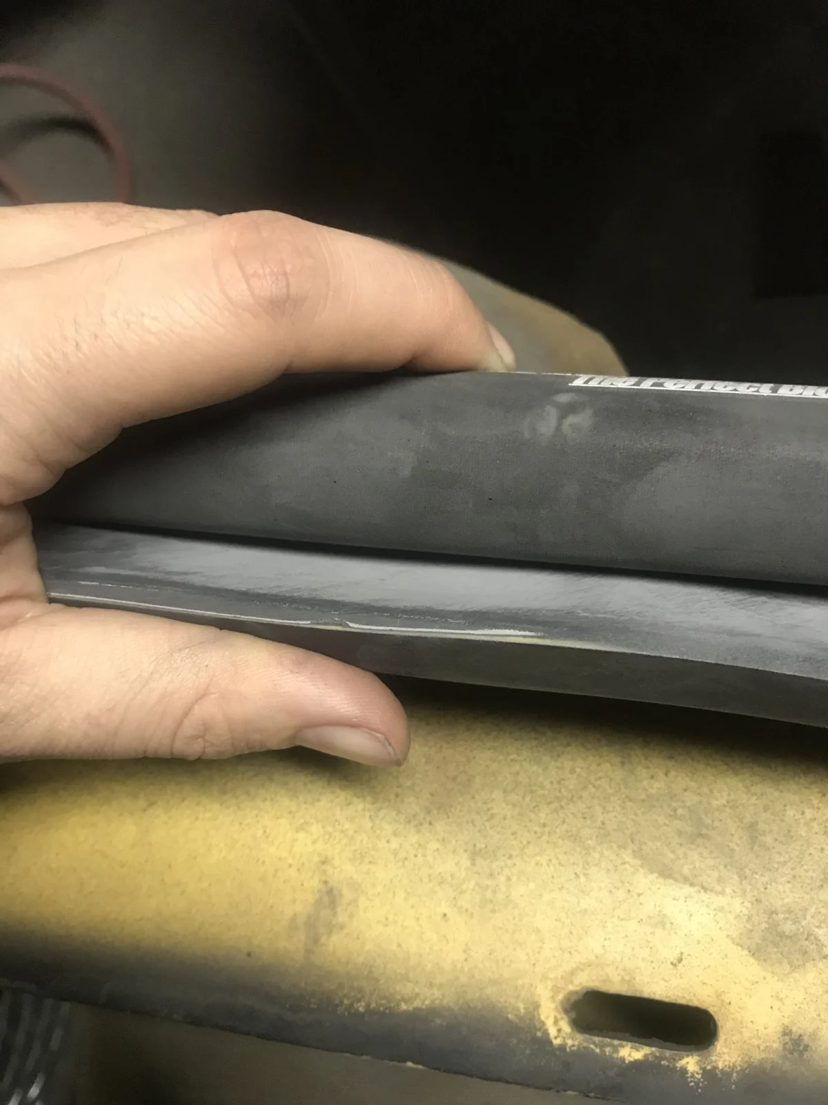

I had one large area I’m trying to deal with. Halfway past the MUSTANG letters was a deformed area. It had a ridge with a valley before and below it. This pics give an idea of what it was. Nearly 1/4” drop.

Using the heat gun I was able to work it till it was more of a wave and less of tsunami . Plus a pic
Of the overall progress. I’ll start on the letters here shortly.

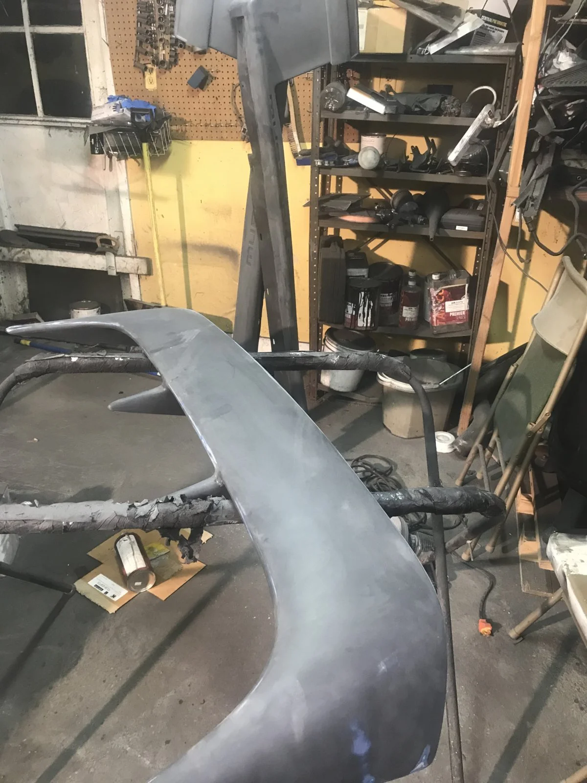

Ok. Basically finished the side skirts. Then life slowed me down a bunch. I was asked to coordinate a hotwheels rally for my church. We had a 50 foot track with prizes and everything. Good times, but ate up my time for awhile. Then I had to finish the laundry room floor to get the new washer and dryer out of the garage. So all that is done and I got my extra space back. For a first sanding of the cobra spoiler done and started filling the nicks and imperfections. Thinking this will go quickly.

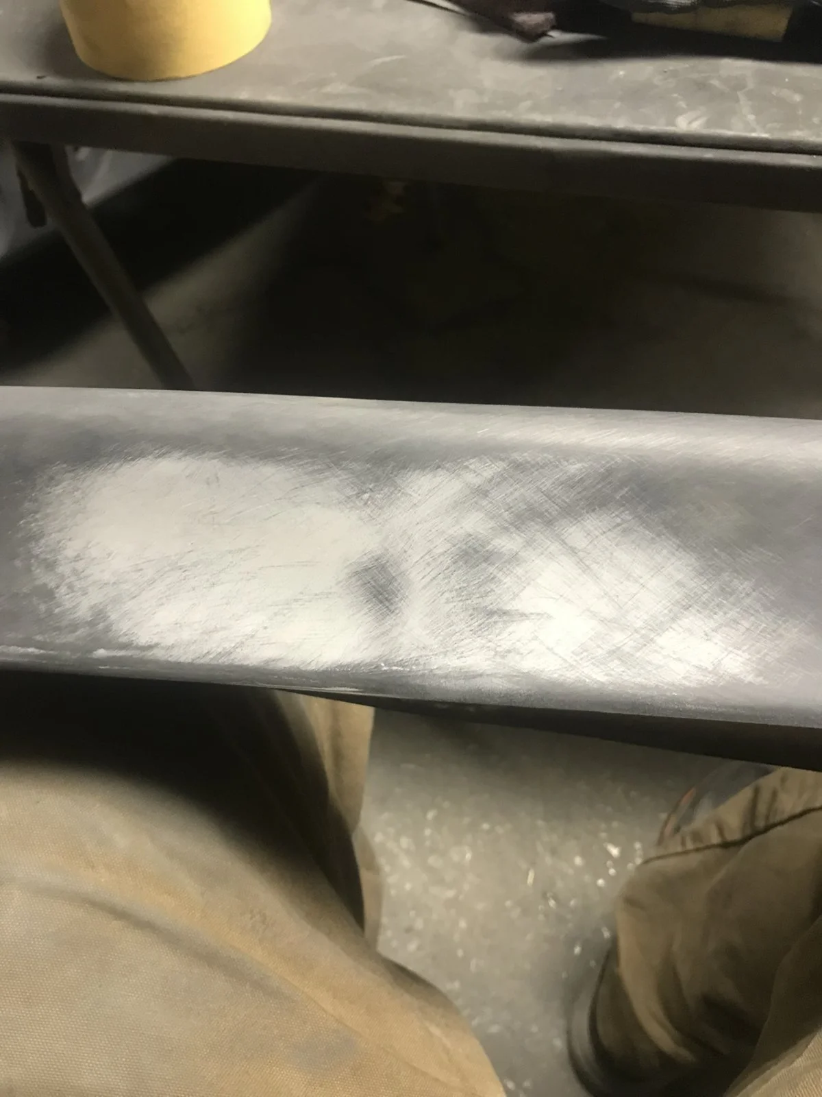

Reprimed the wing. Should block out pretty easy. I think the tips will be the hard part because they are not as round as they should be.

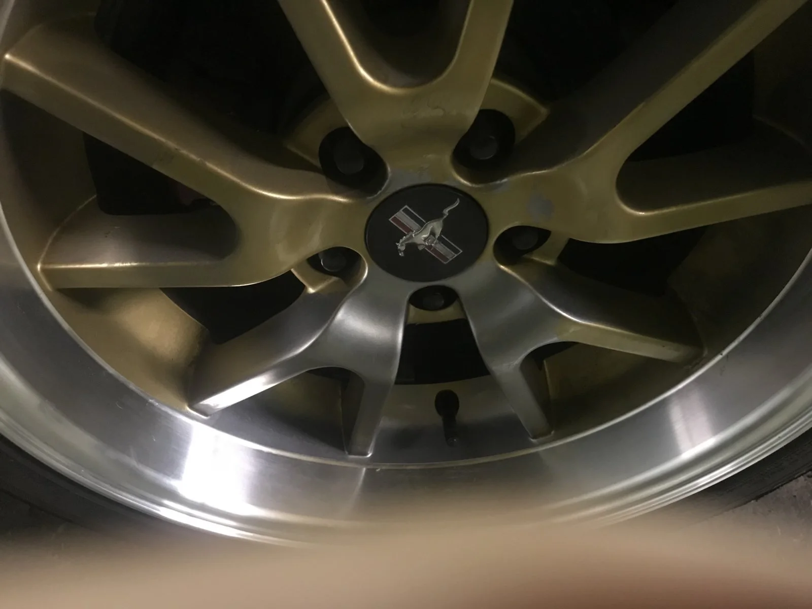

Found a crappy situation With a silver lining. My wheels were painted gold by the guy I got them from. I planned to redo them grey. Found the gold paint flaking off. The gold paint is coming off with reducer pretty easy. The paint underneath looks great. He didn’t prep them at all, so just a really deep cleaning with reducer and no more gold.
Man nothing easy or quick about pant/body work but looks like you're kicking some butt, nice job.
What a win on the wheels no sanding and painting needed.
