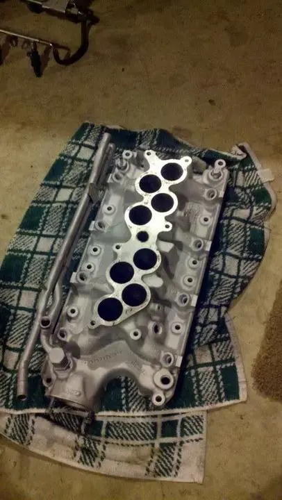

Got the heads back Friday. They'll be getting a coat of paint today. I also cleaned up the intake yesterday. Sand blasted it then threw it in the parts washer.
