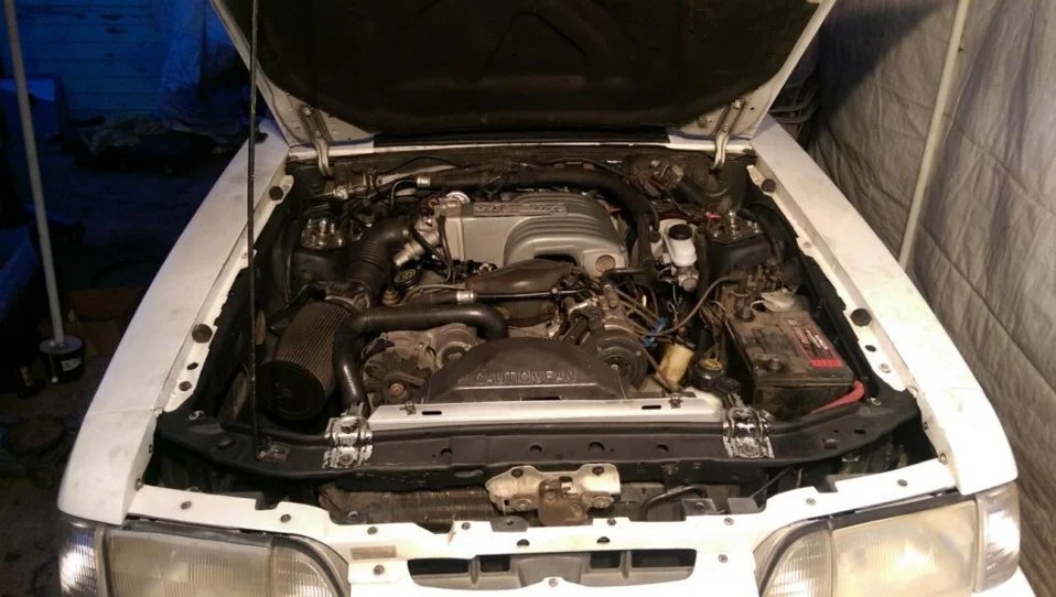

hello there looking to get some help, been running around in circles trying to figure out what is wrong with my coup,
Here is the back story
I bought an 89 4cyl hired someone to do the v8 swap due to no time and not having the experience to do it myself.
Used a 91 Convertable Lx automatic car to source everything,
The car is completely swapped , ended up looking for a 89 computer harness and headlight harness to make everything connect with the existing 89 dash harness.
The car wouldn't start so I ended up figuring out the computer was done for so I bought another A9P and plugged it in , car started right up , mind you the donor car I used sat for 5 to seven years due to the P/O ex wife destroying it and putting water in the fuel tank.
Now the issue at hand ,sorry for the long winded story. The car turns on , has no issues in park or neutral and even driving it at 15 to 20 mph , but as soon as I put some load on to it , it goes nowhere , it's very sluggish delayed response to flooring it and Boggs up at 30 mph its also running very hot . It has so much power loss it's ridiculous. At first I thought maybe it's the transmission but then again that wouldn't make the engine have no tow to it.
So far I have Changed out spark plug wires, plugs, distributor cap and rotor, thermostat , changed the k&n airfilter, cleaned the mass air sensor , checked the coil , checked fuel pressure , and no change .
I haven't found a thread with my issue so I hope you can help . Please call me and I can explain if you don't understand somethings 510-610-4907 Jaime
