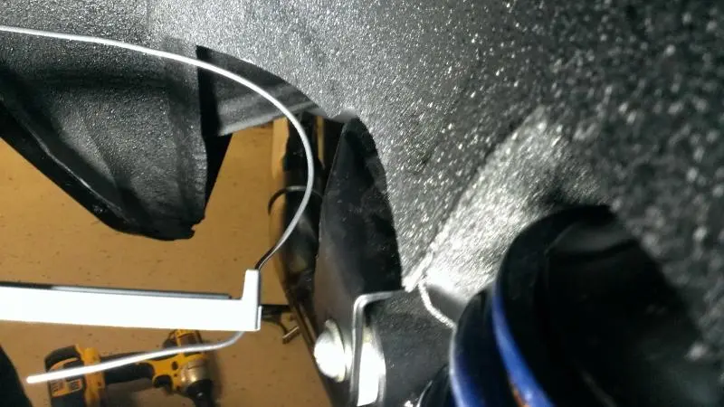

With off-the-shelf wheels, S197 wheels would probably be your best bet. Most of the factory wheels have 45mm offset compared to the 28-30mm offset of the earlier Ford wheels. That's not to say the earlier wheels won't work, they will just sit more flush with the fender. The tire size and brand can make a big difference too. Some run more narrow than others. The limiting factor is the upper subframe mount. It sticks out past the inner fender well. In hindsight, I should have welded my own bracket together to eliminated that upper mount to create more space.

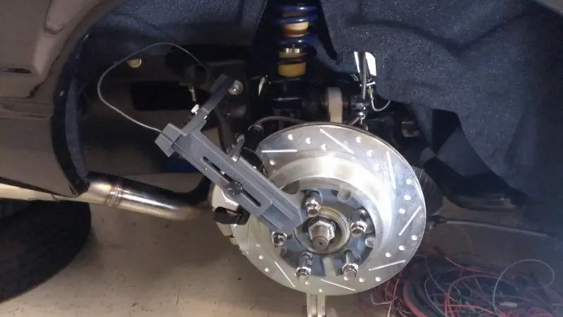

I was originally going to run 01 Cobra wheels. (17x8" 5.72 BS, et30). With a good amount of negative camber and 245/45/17 wheels, they fit pretty well. They sat out about as far as I would like. I decided to change my setup around and go with 18x9" wheels and a 275 tire out back. This required custom wheels. The 275's fit so tight that I had to use a wheel fitment tool to make sure I get the backspacing perfect.

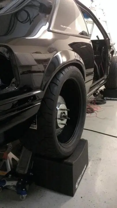

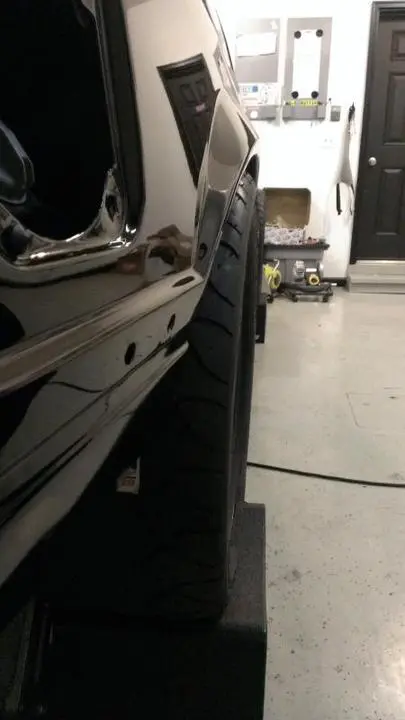

Here's the tire mocked up. No room to spare.
18x9" with 6.35" BS came out to be my magic number. Hopefully everything fits. We'll see once I get the wheels.
