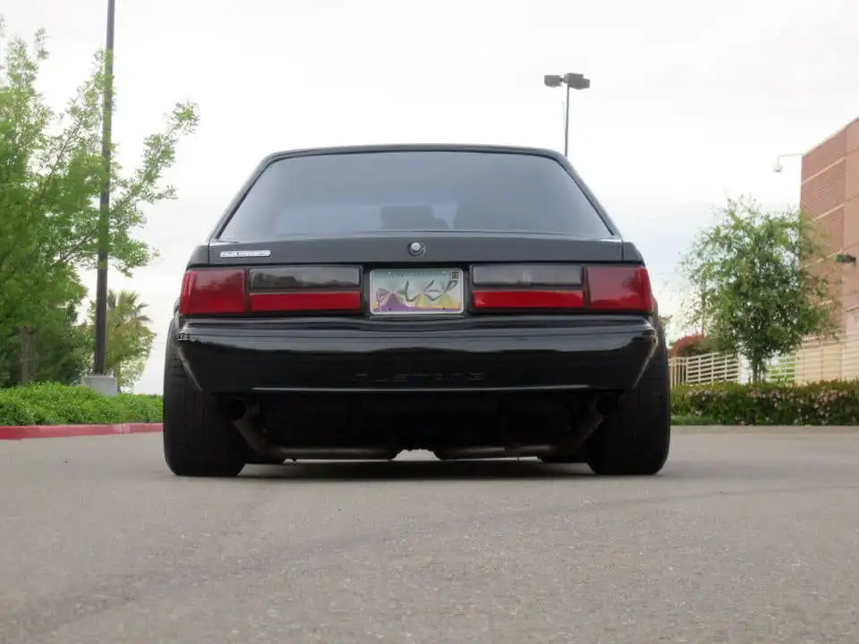

Here is some fat tire IRS eye candy
Not sure, looks like the tires are too narrow for the wheels, a lot of sidewall visible from rear on those.

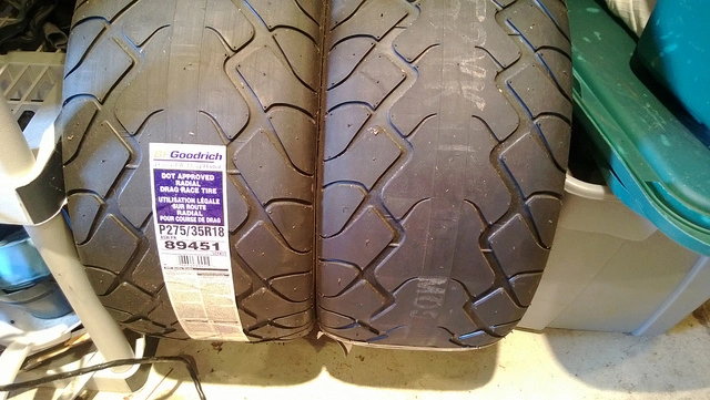

My 275's i've been waiting to put on. My current pair is a mess, just want to put on the PHB first.
Those are the same 275's I have waiting to go on mine as well. Such pretty drag radials.
They really are, so perfectly flat all the way across.
I got good mileage and years out of the first set for how i drive.
I actually get more mileage on drag radials because they spin less and i'm more conscious of wearing them down.
I've seen that car. It's actually on 255's all the way around with 10" rims and 25mm offset. I don't know how he did it, but he did lol
It works because the rim stretches the tire lowering the profile and taking the edge away that would normally rub.
Not the best for contact patch and traction. A 255 is way too small for 10 inch wheel.

They do look good!!!! might be my next pair, after going thru 3 sets of 275 nitto 555 drag radials the only good thing i can say about them is they last long on the street. Anybody know how those BFG hold up compared to the 555drs.

I've had the nitto's in the past.
Depends on how you use the BFG's.
My car never sees rain, so i wear them down to there is nothing left.
Try that on a car that is driven in the rain and you will get killed.
I'd say 5-10,000 miles depending on how you treat them.
Nitto's last a little longer, but not enough IMO to warrant less traction.
Last time i checked the nittos were alot more expensive too.
